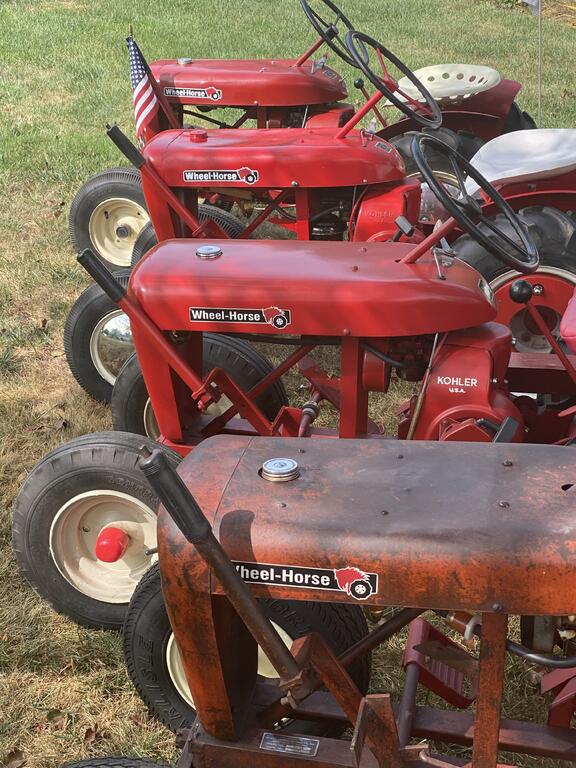

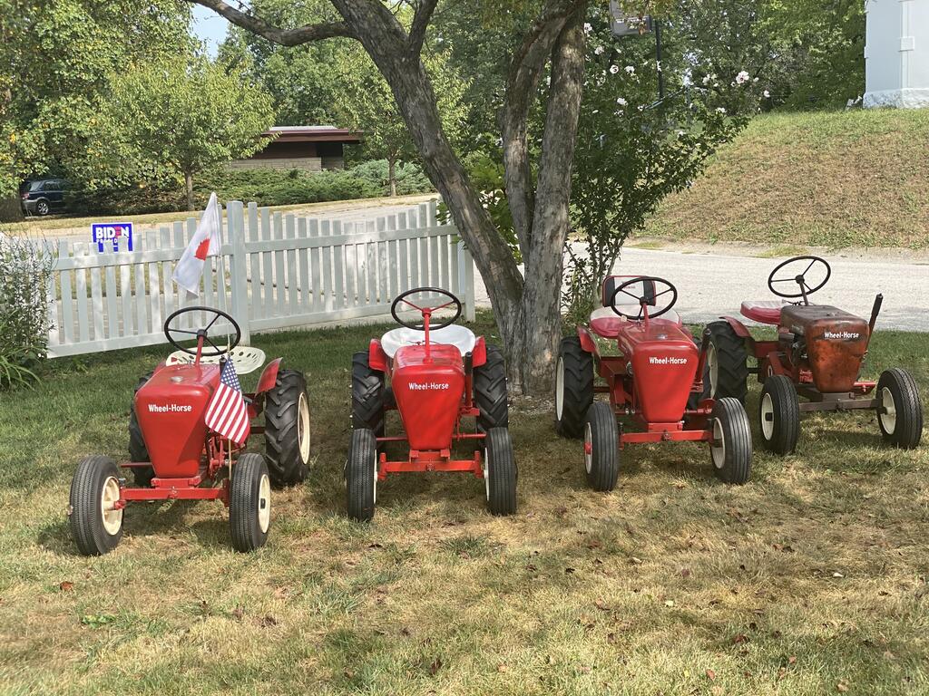

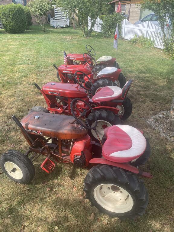

Lane Ranger 12,114 #77 Posted October 20, 2020 Frankenstein 58. - Yes let’s get off the Suburban’s and get back to the RJ’s ! Welcome to the addiction! 2 7 2 Share this post Link to post Share on other sites
ebinmaine 80,766 #78 Posted October 20, 2020 18 minutes ago, SylvanLakeWH said: That’s Mr. Nuthouse to you high fallootin My deepest apologies Mr Nuthouse. But I'm as low falootin as one could get. @Lane Ranger Niiiice... 2 1 1 Share this post Link to post Share on other sites
Frankenstein 58 213 #79 Posted October 20, 2020 That’s one nice stable of horses. 2 Share this post Link to post Share on other sites

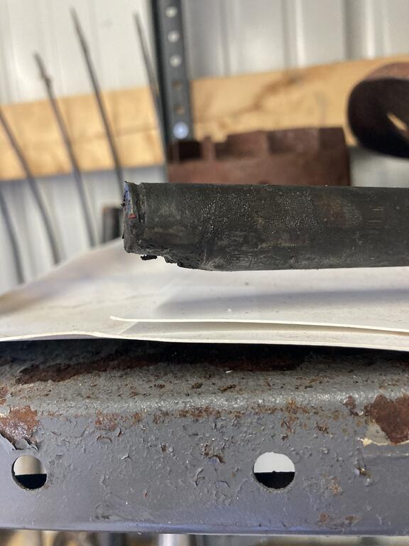

Frankenstein 58 213 #80 Posted October 20, 2020 Picture of the front wheel spindle. No wonder the tire kept falling off. Going to see if can be welded 1 4 Share this post Link to post Share on other sites
Lane Ranger 12,114 #81 Posted October 20, 2020 6 hours ago, Frankenstein 58 said: Picture of the front wheel spindle. No wonder the tire kept falling off. Going to see if can be welded One of our members remakes these spindles and sells on Ebay. Top quality . Share this post Link to post Share on other sites
Frankenstein 58 213 #82 Posted October 20, 2020 Yes I did see that. Thanks Share this post Link to post Share on other sites

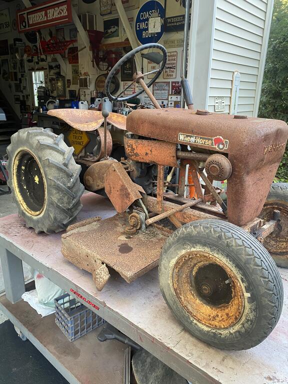

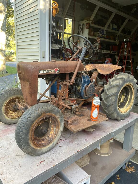

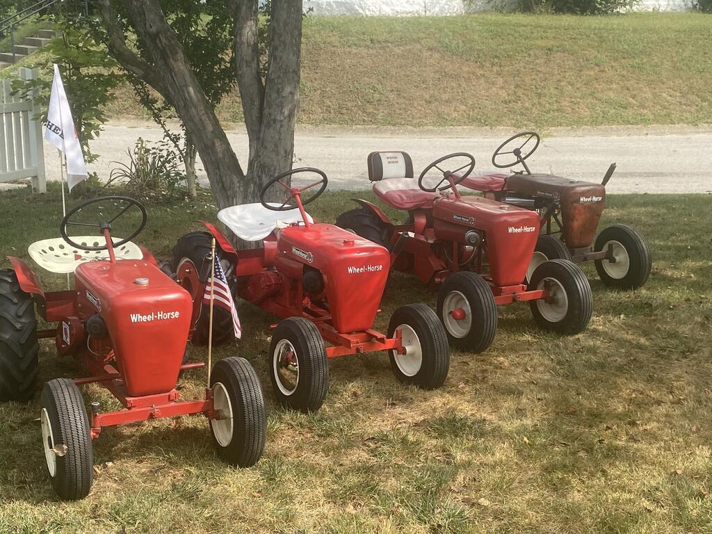

c-series don 12,484 #84 Posted October 20, 2020 I got bitten by the RJ bug with this purchase on Saturday! 3 4 Share this post Link to post Share on other sites
rjg854 13,383 #85 Posted October 20, 2020 Rusty and crusty, a true survivor 1 Share this post Link to post Share on other sites
Frankenstein 58 213 #86 Posted October 20, 2020 I did see that. I like it. 1 Share this post Link to post Share on other sites
c-series don 12,484 #87 Posted October 20, 2020 A true barn find. It was sitting in a barn for at least the past 18 years. The guy I bought it from only owned it for one day, he got it from the original owners family! 3 1 Share this post Link to post Share on other sites
Frankenstein 58 213 #88 Posted October 20, 2020 Thats funny. My story is similar. Kid I bought it from had it a week. He got it from the original owners estate. The kid lost his storage and sold it to me. He kept calling it a 57. I told him it was a 58 because of the 3 speed trans. He said the family said it was a 57. So I guess we were both kinda right. 1 1 Share this post Link to post Share on other sites
Jennifer 1,878 #89 Posted October 20, 2020 (edited) eBay has these... Edited October 20, 2020 by Jennifer 3 Share this post Link to post Share on other sites
Frankenstein 58 213 #90 Posted October 20, 2020 I’m going to see what I can do with mine the end of this week. If there is no hope. I will look into those. Thanks for your help 2 Share this post Link to post Share on other sites

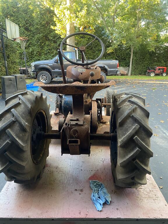

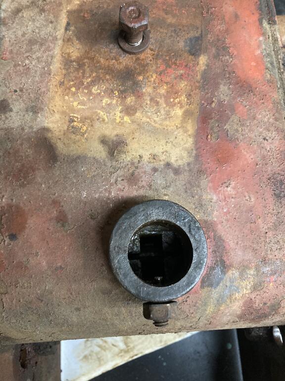

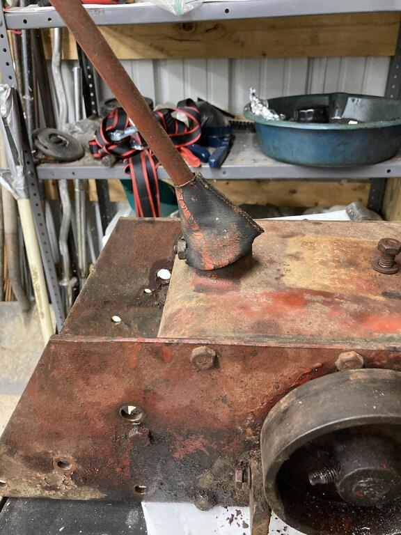

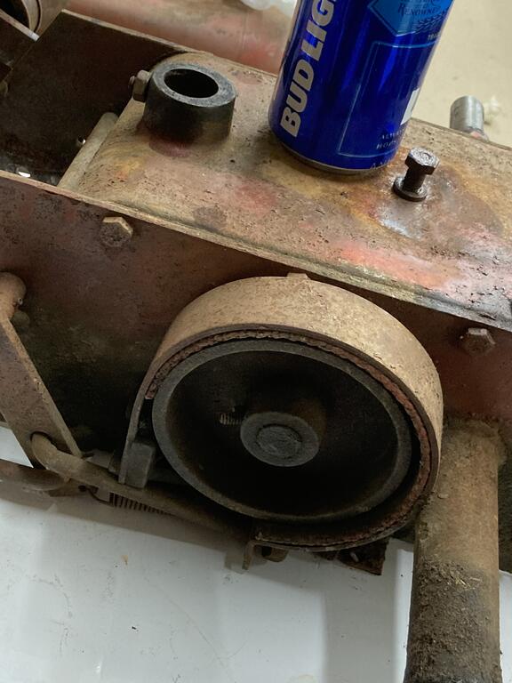

Frankenstein 58 213 #92 Posted October 21, 2020 A lot of miles or no grease. Or both. Pictures of the trans. It was bone dry. Looks like it is in neutral still frozen solid. I love that little leather shifter boot. And no number on top of trans 2 Share this post Link to post Share on other sites
71_Bronco 1,072 #93 Posted October 21, 2020 Looks like the spindles on my Lawn Ranger. Both were like this. Old wheels had steel bushings instead of a bearing, and killed the spindles. A-Z Tractor had a set he had just gotten in, but couldn't ID them as they are a little unique. Needless to say, I scoffed them up, and added a new set of bearing-wheels to the front to prevent this from happening again. 2 Share this post Link to post Share on other sites
Frankenstein 58 213 #94 Posted October 21, 2020 Yes my front outside wheel bearing was shot. Nice find for you Share this post Link to post Share on other sites
WHX?? 58,221 #95 Posted October 21, 2020 Nice muff on that score @c-series don if it is what I think it is! Any pics of the inside of the tranny Frank? 1 Share this post Link to post Share on other sites

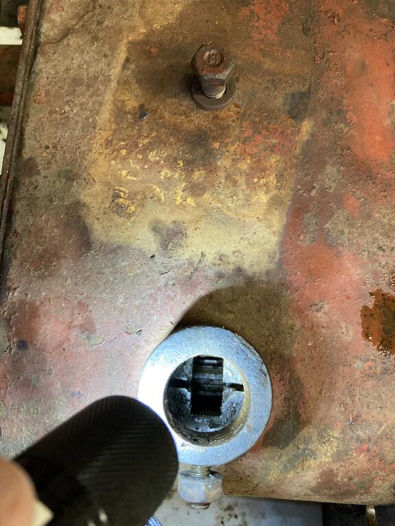

Frankenstein 58 213 #96 Posted October 21, 2020 I needa bigger puller to get that brake hub off. Share this post Link to post Share on other sites
Frankenstein 58 213 #97 Posted October 21, 2020 I was going to give it a drink to see if it would loosen up 2 2 Share this post Link to post Share on other sites
Eriks Red horse herd 133 #98 Posted October 27, 2020 Fill the trans with diesel fuel and wait a week . Each day check to see if you have any play. The diesel fuel will loosen her up. 1 Share this post Link to post Share on other sites
Frankenstein 58 213 #99 Posted October 27, 2020 Nothing could help this poor trans. Got it apart. All gears look good. Now good cleaning is in order 3 1 Share this post Link to post Share on other sites
