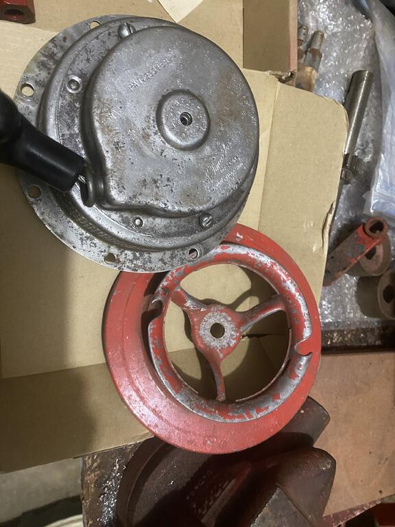

Lane Ranger 12,114 #8 Posted October 19, 2020 You found a nice one! Save it ! You also still have an old Schnacke recoil hex nut on the motor shaft if you look close! The Schnackes were used on both Clinton and Kohler motors on the RJ’s. 3 Share this post Link to post Share on other sites
bottjernat1 2,197 #9 Posted October 19, 2020 10 minutes ago, Lane Ranger said: You found a nice one! Save it ! You also still have an old Schnacke recoil hex nut on the motor shaft if you look close! The Schnackes were used on both Clinton and Kohler motors on the RJ’s. Wish I had that recoil for mine. Im not paying and arm and a leg for one tho. I have enough money in my rj58 3 Share this post Link to post Share on other sites

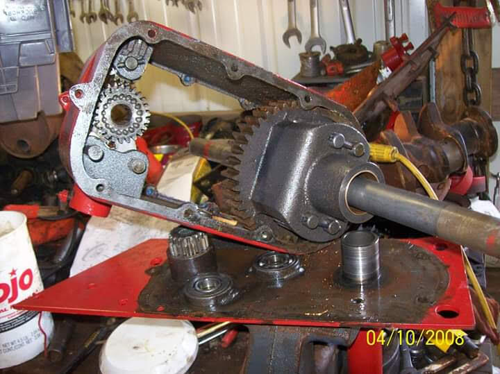

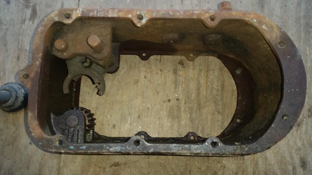

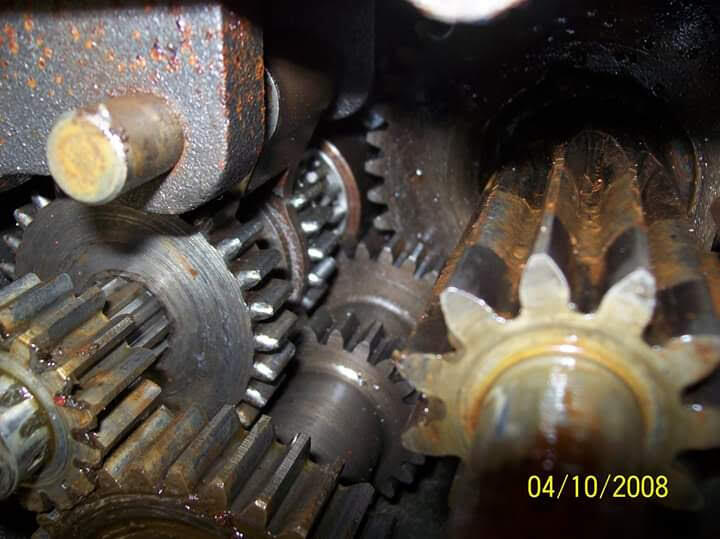

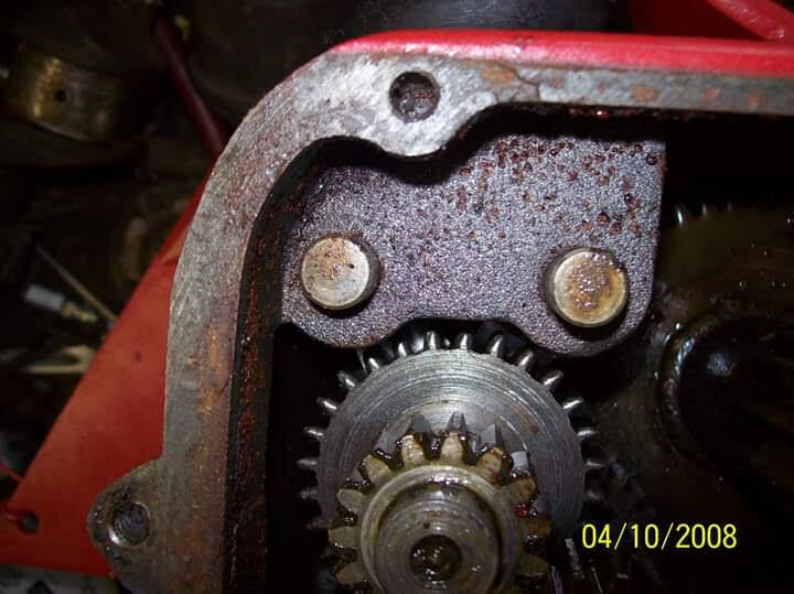

bottjernat1 2,197 #15 Posted October 19, 2020 Agree with @oliver2-44. These transmissions are simple. I had mine gutted. Most of my seals and bearing i bought threw motion industries many years ago. i bought american for pretty much everything i needed. They were built here so i bought from here. This is why i have a stupid amount of money in mine. LOL Here are photos of a empty case i still have and my tranny before i had it gutted and rebuilt Share this post Link to post Share on other sites

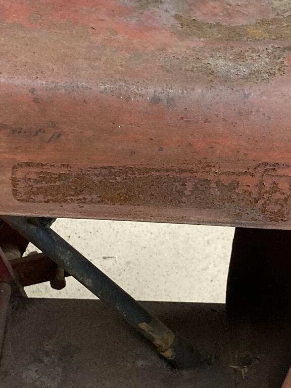

Frankenstein 58 213 #25 Posted October 19, 2020 A better look at the decal 4 Share this post Link to post Share on other sites
