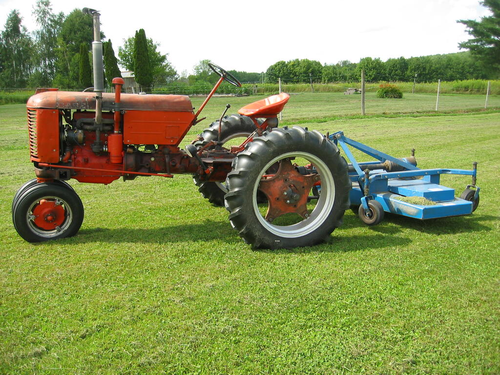

pfrederi 21,312 #5 Posted October 10, 2020 5 acres is a lot of mowing. As ex pasture it will also be rough...I have a lot of that... to save wear and tear on your equipment and yourself you will have to keep speed down. A hydro will let you fine tune speed to the terrain. You might want to think a bit bigger.. I use a 70 year old Case VAC with a 3pt 72" finish mower. Another choice would be a D Series Wheel horse with a 60" 3pt finish mower. They are a hydro have enough power and easily variable speed. Some may suggest a 520 WH with a 60 inch deck. Given the roughness of what you mow I would avoid that as the 60 inch decks are heavy and put stress on the tractor frame which would be exacerbated by the rough terrain. If you go with 48" I would stick with a hydro for the speed control advantage 2 Share this post Link to post Share on other sites

squonk 48,339 #7 Posted October 10, 2020 If were going into the "Farm Tractor" realm I'd say Farmall A or B or an Allis-Chalmers B or C. My dad had an old Allis B and I mowed circles around my B-I-L with his Ford 8N. I was staying away from Hydro's because of the long mowing time (Heat) and the amount of clippings that would get on the cooling fins. 1 Share this post Link to post Share on other sites

pfrederi 21,312 #9 Posted October 10, 2020 Just now, squonk said: If were going into the "Farm Tractor" realm I'd say Farmall A or B or an Allis-Chalmers B or C. My dad had an old Allis B and I mowed circles around my B-I-L with his Ford 8N. I was staying away from Hydro's because of the long mowing time (Heat) and the amount of clippings that would get on the cooling fins. I agree to look other than Ford 8Ns. They are popular and thus usually over priced. I have several acres of ex pasture. The 8 speeds are rugged but sometimes 2nd gear is too fast and first interminably slow. Share this post Link to post Share on other sites

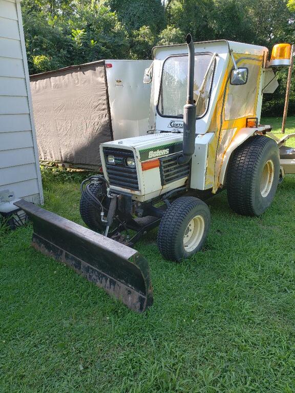

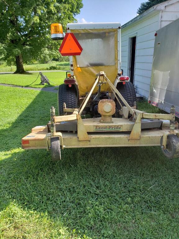

Pollack Pete 2,273 #11 Posted October 10, 2020 I'm sure I'll be critisized for this,but I'd save my money for something a little bigger than a garden type tractor.Grass mowing season is just about over.You have time to shop.With snow on it's way in a couple months,it should be a buyers market for grass cutting equipment.5 acres is a lot to mow.I've been mowing about 6 or 7 acres of the 25 that I bought a couple yrs ago.I use a Bolens model 2104 diesel 4x4 with 12 speed.I have a 72 inch Land Pride finish mower on the 3 point hitch.I don't mow as often as I should,but God.......this takes a lot of time,even though I'm retired.I sometimes do what I call my trimming after going though with the Bolens with my Wheel Horse C-175.Makes it nice getting around some of the trees.It's perfect for that,but to mow the whole area,the 17 horse Kolher just isn't quite enough.It can be done,but I think my C-175 would quickly get burned out.As well as me. Here's a couple pics of my Bolens 2104.I leave the plow on the front to knock down some of the taller stuff when I'm mowing. 1 Share this post Link to post Share on other sites
