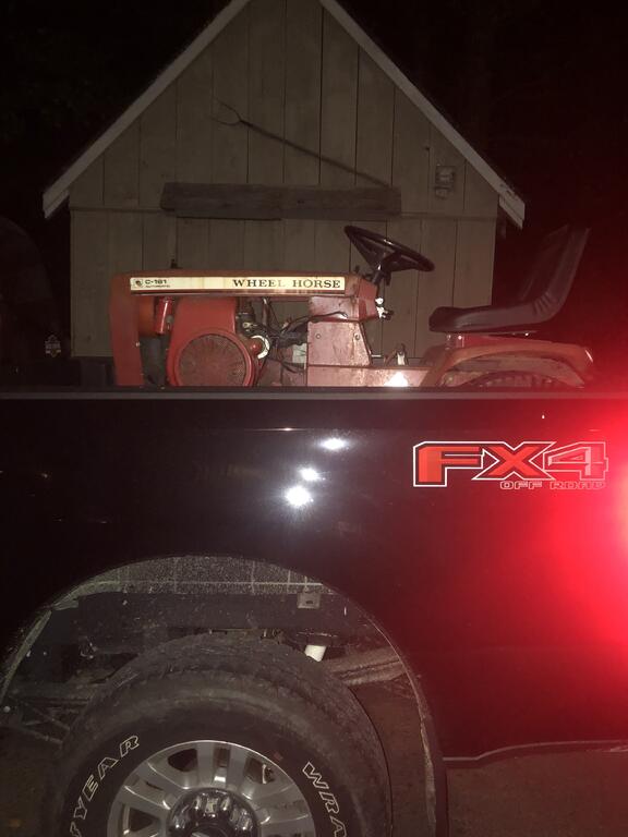

WheelhorseBob 1,550 #1 Posted October 9, 2020 Hi guys, I brought this unmolested 161 Automatic home tonight. I bought it with the intention of a full restoration, I like working on tractors. But.....I love the patina on this thing! It hasn’t been hacked up like so many. Only known issue is a leaky left rear axle seal. Runs like a top without smoke etc. what to do! 8 Share this post Link to post Share on other sites

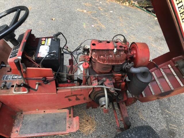

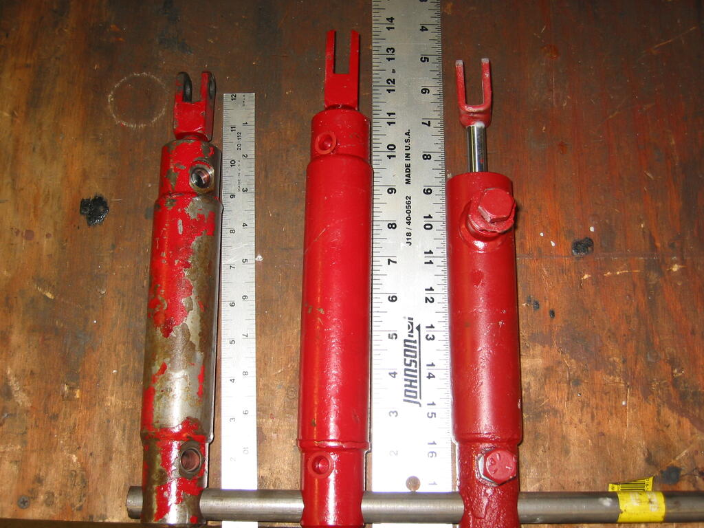

WheelhorseBob 1,550 #11 Posted October 10, 2020 Well today I did a much more thorough inspection. The motor runs like a dream. Fuel lines were awful, and changed. Engine oil changed and Hydro topped up for now. The bad, seems the piston on the lift cylinder is bent. Believe it should be straight? This one has a 15 degree bend one inch from the end. Seems to work fine but can’t be right. Left rear axle seal is leaking, appears to have been leaking for years. Really torn with what to do with it. A part of me likes the honest patina, and the other wants a full blown restoration. 2 Share this post Link to post Share on other sites
ebinmaine 80,623 #12 Posted October 10, 2020 9 hours ago, WheelhorseBob said: seems the piston on the lift cylinder is bent. Believe it should be straight? This one has a 15 degree bend one inch from the end. Seems to work fine but can’t be right. Left rear axle seal is leaking, appears to have been leaking for years. Really torn with what to do with it. A part of me likes the honest patina, and the other wants a full blown restoration Not sure about the lift piston but straight seems more logical. Others could comment there. Axle seal is likely a fairly easy fix. Hubs are well known for being a bear to remove but because that has been leaking ATF which is among the best penetrating fluids it will probably slide off without too awful much work. Seals on both sides should be replaced. They're available on the fleabay or local through Sanel/ preferred parts store. Numbers are listed in the Transmission section. I've come to the conclusion that there are 2 predominant types of tractor people. Patina People. And Fresh Paint People. Trina and I were the latter of the 2 but over the last couple years have been learning the ways of the Patina People. We both still far prefer a beautifully painted restored piece and are now more understanding of the mindset of the "others". It's a tremendous amount of work to restore a garden tractor. And VERY rewarding. What it comes down to... It's YOUR tractor. 1 Share this post Link to post Share on other sites
ebinmaine 80,623 #13 Posted October 10, 2020 10 hours ago, WheelhorseBob said: he bad, seems the piston on the lift cylinder is bent. Believe it should be straight? This one has a 15 degree bend one inch from the end. @953 nut @pfrederi Comments? Share this post Link to post Share on other sites
pfrederi 21,145 #14 Posted October 10, 2020 No bends left is Charger cylinder... 1 Share this post Link to post Share on other sites
