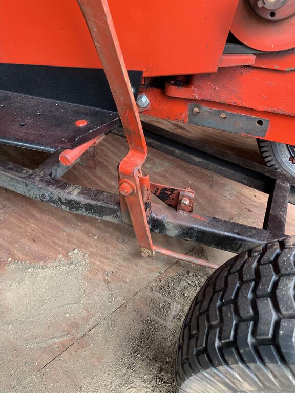

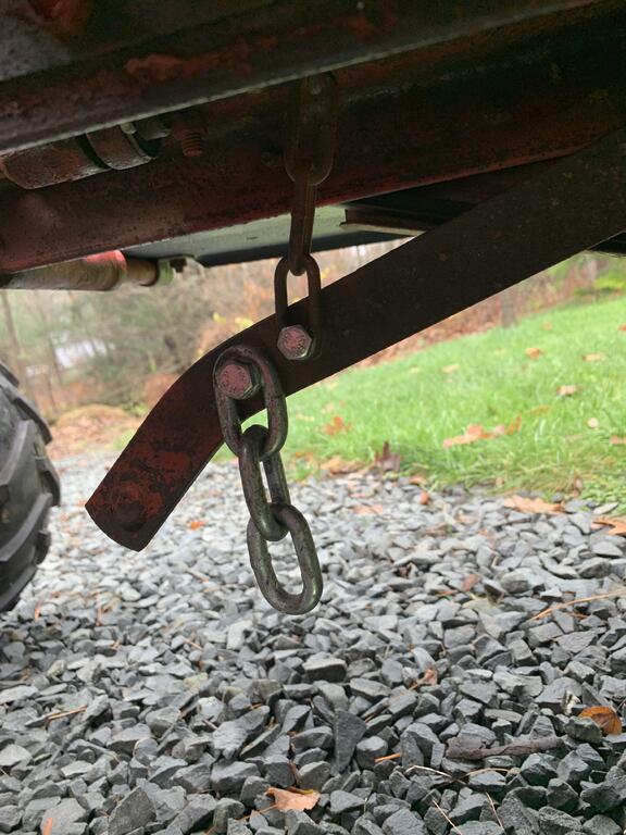

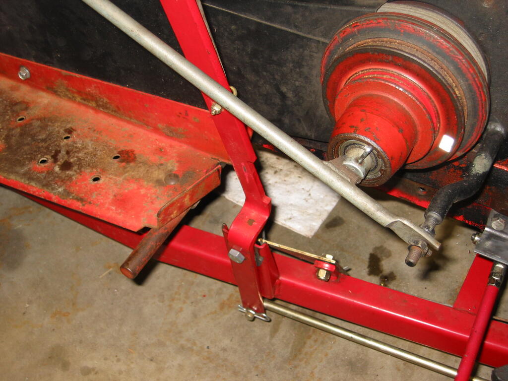

ebinmaine 80,955 #28 Posted November 27, 2020 There ya go! Not sure what to do about the step contact. @pullstart @953 nutnut @Achto any thoughts? As for the plow I connect mine to the hole in the pic. We run a straight link down to the plow. that gives down pressure when you press forward in the handle. You can also run a piece of chain or half chain, half solid. Whatever works. .... Share this post Link to post Share on other sites

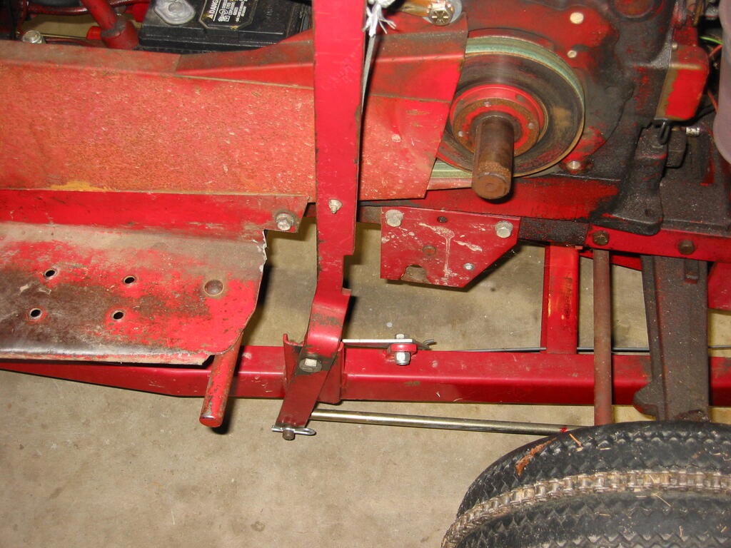

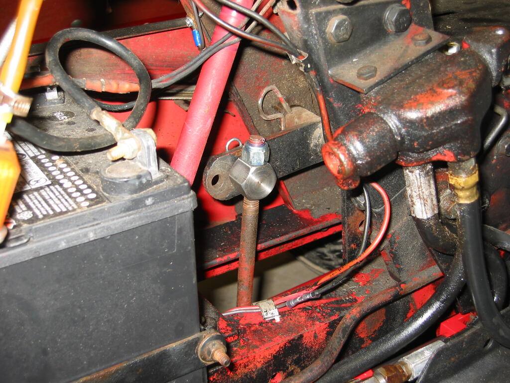

pfrederi 21,222 #29 Posted November 27, 2020 I run modern plow frames on two Charger/Electros. Both are hydro lift so I do not want a solid link. The set up uses a rod from lift to the plow. You will have to modify the foot plate fro clearance of the angle arm. 3 Share this post Link to post Share on other sites

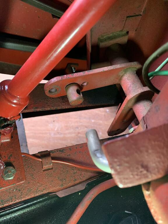

tallen4392 71 #30 Posted November 27, 2020 Thanks for the great pictures those will help a lot I have a piece of 7/16 threaded rod that I think will work good also I like the idea of being able to push down on the lever to scrape the driveway a little better might make it easier to go over where tire tracks are .. Share this post Link to post Share on other sites

tallen4392 71 #32 Posted November 27, 2020 Does anyone know what those pieces that go through the bracket with the hole in it are called can you get those at hardware store Share this post Link to post Share on other sites
wallfish 20,679 #33 Posted November 27, 2020 https://www.amazon.com/Agri-Fab-46001-Lift-Rod-Trunnion/dp/B00FMUV0WU/ref=sr_1_20?dchild=1&hvadid=78683899192360&hvbmt=bp&hvdev=c&hvqmt=p&keywords=trunnion&qid=1606520650&sr=8-20&tag=mh0b-20 1 Share this post Link to post Share on other sites

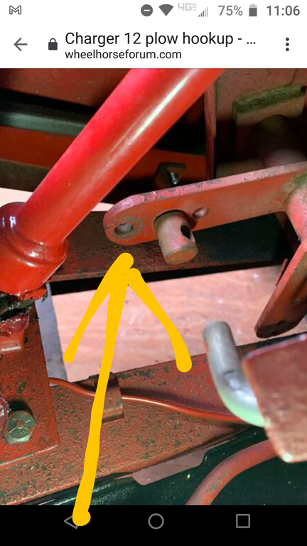

rjg854 13,405 #34 Posted November 28, 2020 Can't the arm for plow angle be turned around to clear the foot board 2 Share this post Link to post Share on other sites
ebinmaine 80,955 #35 Posted November 28, 2020 39 minutes ago, rjg854 said: Can't the arm for plow angle be turned around to clear the foot board That might just work. Share this post Link to post Share on other sites
pfrederi 21,222 #36 Posted November 28, 2020 59 minutes ago, rjg854 said: Can't the arm for plow angle be turned around to clear the foot board No. Still won't cler. The rod will NOT give you down pressure. Share this post Link to post Share on other sites
tallen4392 71 #37 Posted November 28, 2020 The rod will not give down pressure?? Share this post Link to post Share on other sites
pfrederi 21,222 #38 Posted November 28, 2020 The rod slides up through the trunion. I have hydros you do not want a fixed connection, WH hydro lift valves do not have a float position. 1 hour ago, tallen4392 said: The rod will not give down pressure?? Share this post Link to post Share on other sites

Achto 32,844 #40 Posted November 28, 2020 (edited) If you build the link that I gave dimensions for you should have what you need for down pressure Edited November 28, 2020 by Achto Share this post Link to post Share on other sites

squonk 48,222 #42 Posted November 28, 2020 38 minutes ago, rjg854 said: now I'm confused, what has the pivot rod got to do with down pressure? 2 topics in one discussion. Downpressure (lift rod,link,chain) and angle lever hitting the foot (tootsie) board. Share this post Link to post Share on other sites
rjg854 13,405 #43 Posted November 28, 2020 Exactly what I was thinking, would turning the pivot rod around clear the footboard. Down pressure comes from the implement rod, correct Share this post Link to post Share on other sites
squonk 48,222 #44 Posted November 28, 2020 Lever would still hit. Just on a different spot. I had this same issue on one tractor. I would take the footboard off and install a stirrup every winter. 1 Share this post Link to post Share on other sites
peter lena 10,091 #45 Posted November 28, 2020 I use a small lift shackle on my chain , made for that use, also notice the gap on the mount point pin hole to inside stop ? fill that with washers ,and LUBRICATE IT , it increases function ease and use. look up plow mounting pictures on this site for more ideas, pete Share this post Link to post Share on other sites
tallen4392 71 #46 Posted November 28, 2020 I am going to try this for a lift rod stuff I already had don’t see why it would not work 1 Share this post Link to post Share on other sites
tallen4392 71 #47 Posted November 28, 2020 I think this is going to work the blade should float a little and the angle lever goes into the notch I cut out doesn’t look bad either if u cut it right 2 Share this post Link to post Share on other sites
pfrederi 21,222 #48 Posted November 28, 2020 Nice idea and fix. 1 Share this post Link to post Share on other sites
