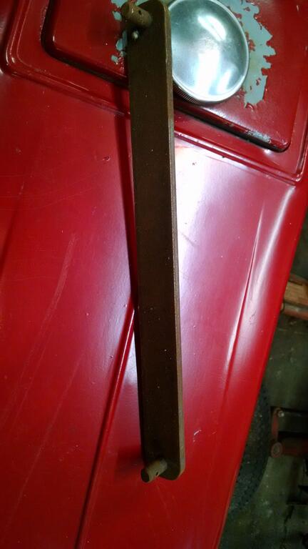

tallen4392 71 #1 Posted October 4, 2020 Can anyone tell what pieces I am missing to attach the lift arm to the plow frame ?? Share this post Link to post Share on other sites
ebinmaine 80,955 #2 Posted October 5, 2020 Short lift link. 5 or 6 inches long. A little chain. Allows for blade float. Or Long lift link. 11.5 or so long. Creates down pressure on the blade. 2 Share this post Link to post Share on other sites

gwest_ca-(File Mod) 12,511 #5 Posted October 5, 2020 Back in the day the blade for your tractor came in two packages. The blade in one and the frame to suit the tractor it was going on. The lift links came with the blade and are illustrated in the manual. Your tractor is a long frame model and the last blades sold up until a few years ago would still fit your tractor. Garry 2 Share this post Link to post Share on other sites
gwest_ca-(File Mod) 12,511 #6 Posted October 5, 2020 Back in the day the blade for your tractor came in two packages. The blade in one and the frame to suit the tractor it was going on. The lift links came with the blade and are illustrated in the manual. Best to click on the pictures below and download from that page. Your tractor is a long frame model and the last blades sold up until a few years ago would still fit your tractor. Garry 1 Share this post Link to post Share on other sites

Achto 32,844 #13 Posted October 5, 2020 11 hours ago, tallen4392 said: u would think someone on here would have one to sell me .... The using just a chain will work without issue. If you wish to have a solid link for down pressure they are easy to make. I can get you dimensions tonight, unless someone beats me to it. 1 Share this post Link to post Share on other sites
Achto 32,844 #14 Posted October 5, 2020 2 minutes ago, tallen4392 said: no hydro lift... wish it was Chain will work best then. 1 Share this post Link to post Share on other sites
ebinmaine 80,955 #15 Posted October 5, 2020 Neither one of our current plow tractors are hydraulic lift. Both of the plows we use have a solid link. It gives you the capability of pushing forward on the lever to generate some downforce for scraping up areas like where you may have driven over the snow and compacted it. 2 Share this post Link to post Share on other sites
gwest_ca-(File Mod) 12,511 #16 Posted October 5, 2020 The long solid link works well for a manual lift. If you leave it alone the lift lever moves on it's own to give you float. Hydraulic lift won't do that. Garry 1 Share this post Link to post Share on other sites
Achto 32,844 #17 Posted October 6, 2020 If you have the means to make a solid lift bar here are the dimensions. A piece of 1/4" x 1 1/4" flat stock 12 1/2" long. Weld 3/8" pins 11 1/2" on center apart. 1 1 Share this post Link to post Share on other sites
