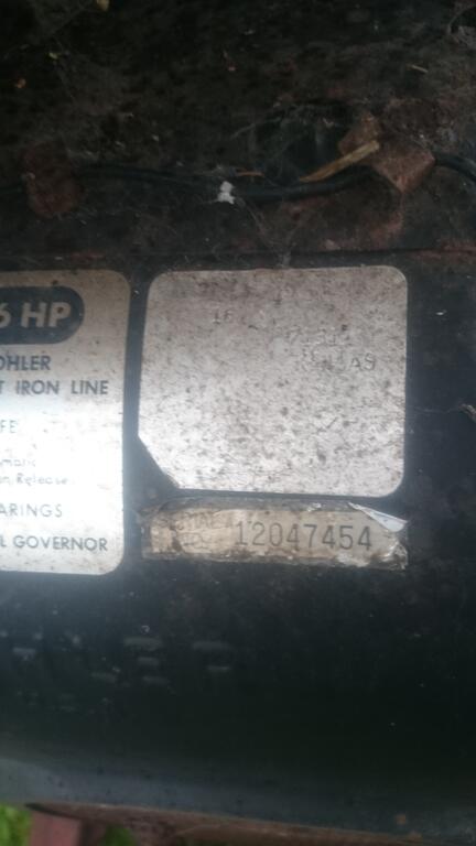

Jase675 10 #1 Posted October 2, 2020 Hi All, I'm a new Wheel Horse owner, yay! C 161 8 speed manual. It's a fixer upper and my goal is to eventually get it ready for the UK roads so I can get from field to field. First thing I want to do is to identify the tractor serial number. I've looked at the silver sticker under the dashboard but it's so faded I can't make out the numbers. Is there a serial number elsewhere on the tractor? Are there any tips on how to reveal the invisible number?? I can clearly read the engine number and was wondering if there's any correlation to chassis serial number or a way to cross reference from archives?? The chassis serial number is significant for dating and positively identifying the tractor, enabling UK registration. Any help or steers will be much appreciated! 1 Share this post Link to post Share on other sites
Sparky-(Admin) 25,935 #2 Posted October 2, 2020 Here in the USA a C161 is a 1978 or 1979 machine. Not sure if thats the case in Europe. Can you post up a couple pics as well as those motor tag numbers. Someone here will be able to decipher the motor numbers. Share this post Link to post Share on other sites

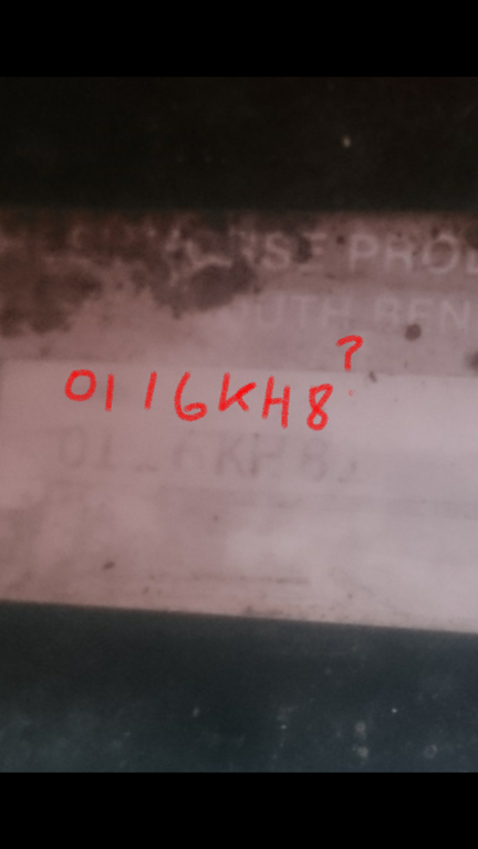

Jase675 10 #9 Posted October 3, 2020 @Dan.gerous- I'm v close to Aylesbury. Thanks to all that are helping, it's much appreciated. I've managed to work out the serial number by using a torch at an angle. The type/model number is more tricky as it's less legible. Can anyone decipher what it means? Thanks again!! 1 Share this post Link to post Share on other sites
953 nut 67,390 #10 Posted October 3, 2020 12 hours ago, Jase675 said: Are there any tips on how to reveal the invisible number?? The model number and serial number were mechanically stamped into the sticker on most models of . If you carefully remove the sticker the back side will have the reverse of the numbers. Share this post Link to post Share on other sites
Jase675 10 #11 Posted October 3, 2020 Top tip, thanks. That's probably why the torch at an angle helped - slightly indented characters. I'll take another look. The engine number is easier to see. I'm wondering if there's an archive that cross refers to model or chassis serial?? Share this post Link to post Share on other sites
Jase675 10 #12 Posted October 3, 2020 (edited) 4 hours ago, 953 nut said: The model number and serial number were mechanically stamped into the sticker on most models of . If you carefully remove the sticker the back side will have the reverse of the numbers. I think my numbers have been etched or printed, not stamped. It looks like I have: 01_16KH8_ The first underscores (did they use them back in the 70's??) could be the base of a number one and the second underscore looks like the base of a Z.... t's hard to tell. Edited October 3, 2020 by Jase675 Re-examined the tractor plate. Share this post Link to post Share on other sites
ebinmaine 79,686 #13 Posted October 3, 2020 4 hours ago, Jase675 said: @Dan.gerous- I'm v close to Aylesbury. Thanks to all that are helping, it's much appreciated. I've managed to work out the serial number by using a torch at an angle. The type/model number is more tricky as it's less legible. Can anyone decipher what it means? Thanks again!! @Jase675 can you post more pics? Whole tractor from a couple angles? @gwest_ca Could this be a 1980 model? Share this post Link to post Share on other sites
Lee1977 7,709 #14 Posted October 3, 2020 4 hours ago, Jase675 said: @Dan.gerous- I'm v close to Aylesbury. Thanks to all that are helping, it's much appreciated. I've managed to work out the serial number by using a torch at an angle. The type/model number is more tricky as it's less legible. Can anyone decipher what it means? Thanks again!! My guess is that the 0 is really a 9 and the H is a B so it would be 91-16B801 or 02 !979 model Share this post Link to post Share on other sites
stevasaurus 23,742 #15 Posted October 3, 2020 Need pictures of horse...hood, dash, both sides and rear. My guess is C-165 8 speed 1980 model # 01-16KH801 16 hp Kohler K-341AS 718030 Your model # is also close to this horse. SK-486 8 speed model # 01-16KH01 1982 16 hp Kohler K-341AS 71311A Share this post Link to post Share on other sites
gwest_ca-(File Mod) 12,352 #16 Posted October 3, 2020 The engine was made in 1982 so it should have landed on a 1982 or 1983 model of tractor. There was only one 16hp Kohler engine used in 1982 on a SK-486 model 01-16KH01. No 16hp Kohler used in 1983. https://www.wheelhorseforum.com/search/?q=01-16KH01&quick=1&type=downloads_file Garry Share this post Link to post Share on other sites

Jase675 10 #24 Posted October 6, 2020 @gwest_ca OK, need to go back a step! My model is 0116KH81 which I can't find reference to anywhere whatsoever. It's badged as a C161 but this was only made in 78 and 79 in the states. I'm reckoning that in the UK the C-161 in 1982 was sold as a run-out model same as SK486 was in 1982 in the US. It's the only explanation I can conjure because my model definitely exists - i found another mentioned on here in Scotland and only a hundred serial numbers away from mine. So I seem to have a 1982 C-161. If anyone can validate or disprove my theory, either way it would be appreciated. If there's any way to cross check, please let me know. The Toro website looks like a great resource but my model number isn't mentioned there either. Cheers. Share this post Link to post Share on other sites
gwest_ca-(File Mod) 12,352 #25 Posted October 6, 2020 I think your original hood has been replaced by the same part number 9699 hood that was used 1970-1979 on all long frame tractors like yours. It was used on over 100 different tractor models in that time. Your's just happens to have come from a C-161. Not uncommon to see variant digits for the last two digits in the model number for product that came out of Belgium. A 9 was often used and have no idea why. There is a Belgium list of models but don't know if it originated there or in America. Garry 1 Share this post Link to post Share on other sites
