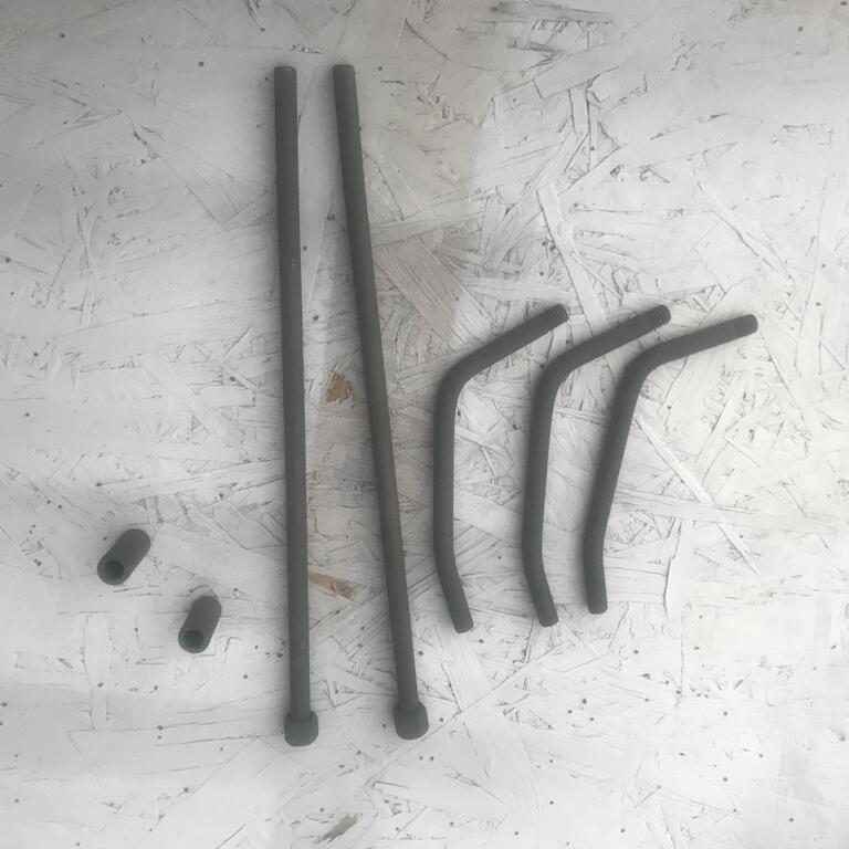

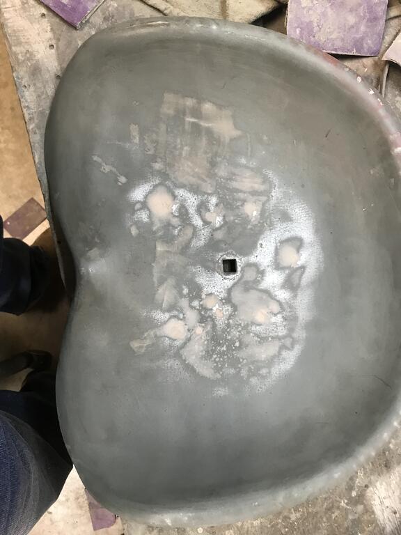

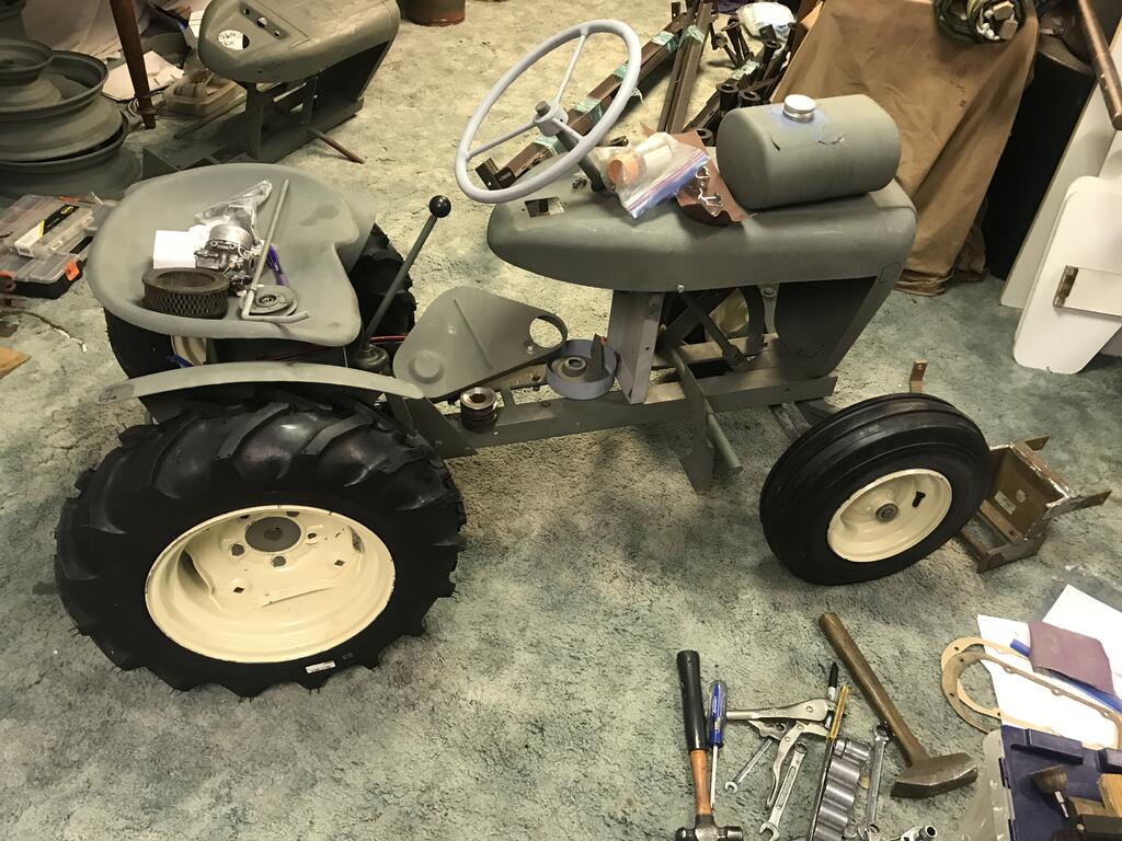

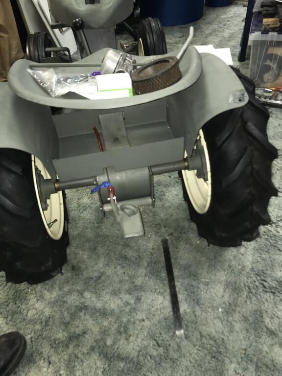

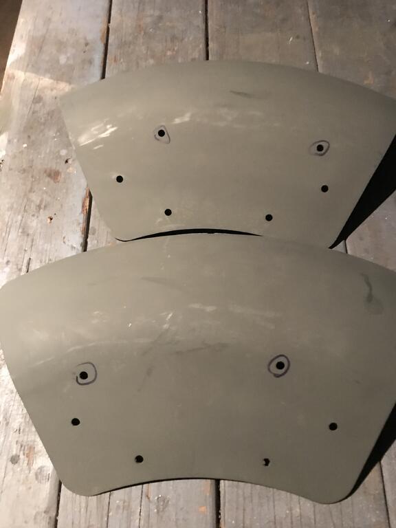

oliver2-44 11,847 #59 Posted June 7, 2021 @WHX24 The PC-7 worked well for me on the steering wheel repair. I tried using a wetted finger to smooth it like someone suggested, but that didn't help me much. So I worked it down with a hand file and that worked really good. Then some final sanding and I have it partially polished using my rouge wheel. The file was the thing to use, as it does sand hard. So I've been gradually getting some bodywork done, mainly filling rust pits with bondo. I would say everything is done except the hoods...... But then I realized my fenders had these extra upper set of holes in them. Does anyone know if these holes are there for a reason, or just something some PO did in the past? Made up some new rods for the lift arm. Gathered up all my parts and did a trial assembly on the 400. I'm glad I did. You can't see it in these photos, but the steering is very tight with the hood stand bolted down. With the bolts loose, the steering shaft holds the hood stand about an 1/8" off the frame. When I disassembled this frame the steering gear was rust bound in the lower hole and I had to use some heat and twisting to get it out. I suspect I tweaked/bent that lower piece a tiny bit, just enough to change the angle on the steering shaft a degree or two. So a little heating adjustment is needed to get a nice smooth steering shaft movement. I've also laid out all my miscellaneous parts to see what I'm missing so i could make a list. At this point, the engine, hood body work, exhaust and a few hardware store items are it. O, and to solder that new filler neck into the gas tank. My hood has a few little dents in it, but the big thing I need to work out is about a 1/4" sway in the top length of it like an old sway back horse. It will oil can straight, but pop right back down. Any suggestions how to work that oil can out and keep it straight would be appreciated. After I finish the tractor, if things work out, it's going to get a custom front attachment using this hitch. 4 5 Share this post Link to post Share on other sites

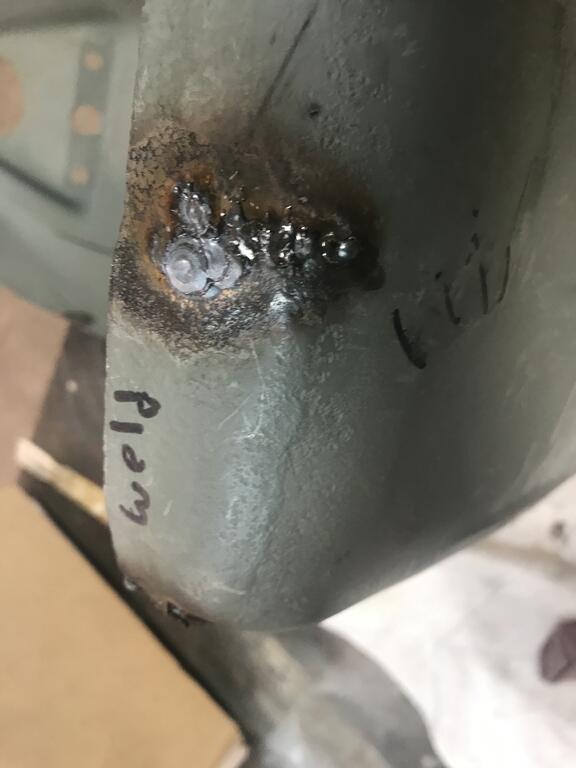

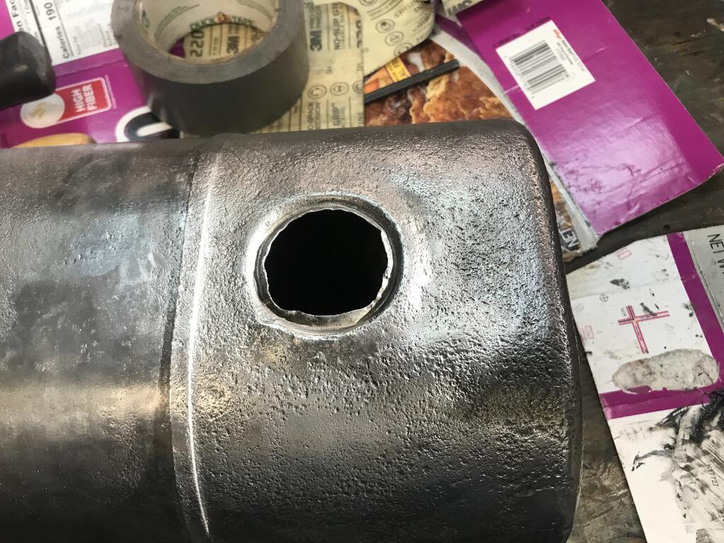

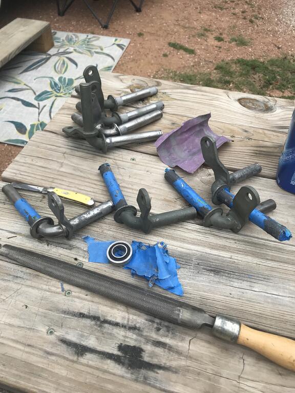

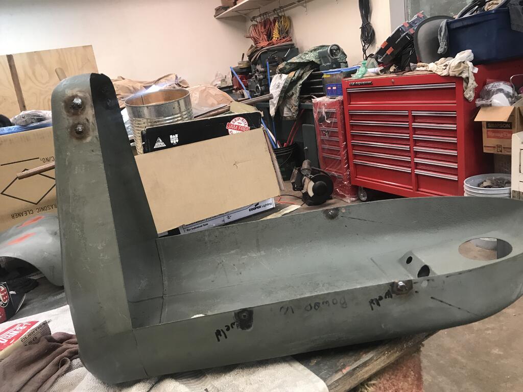

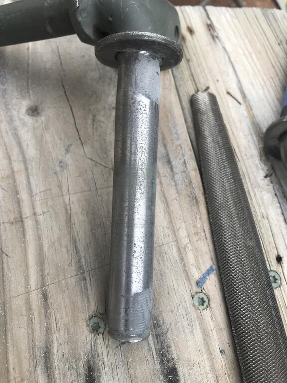

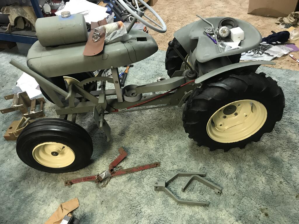

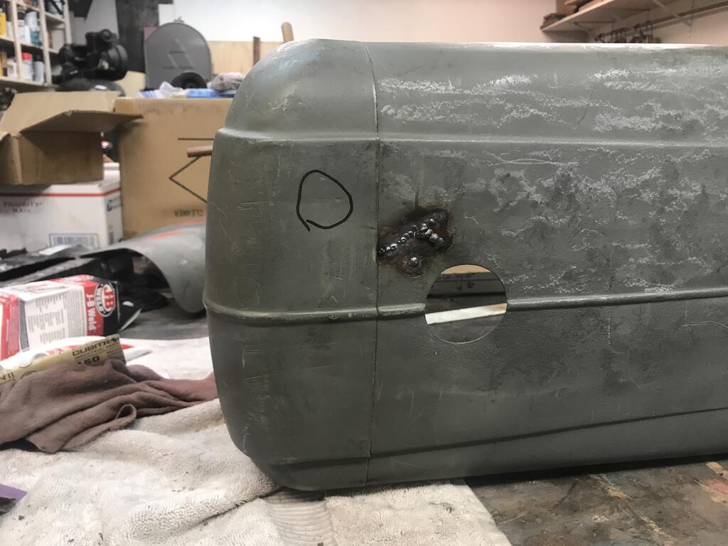

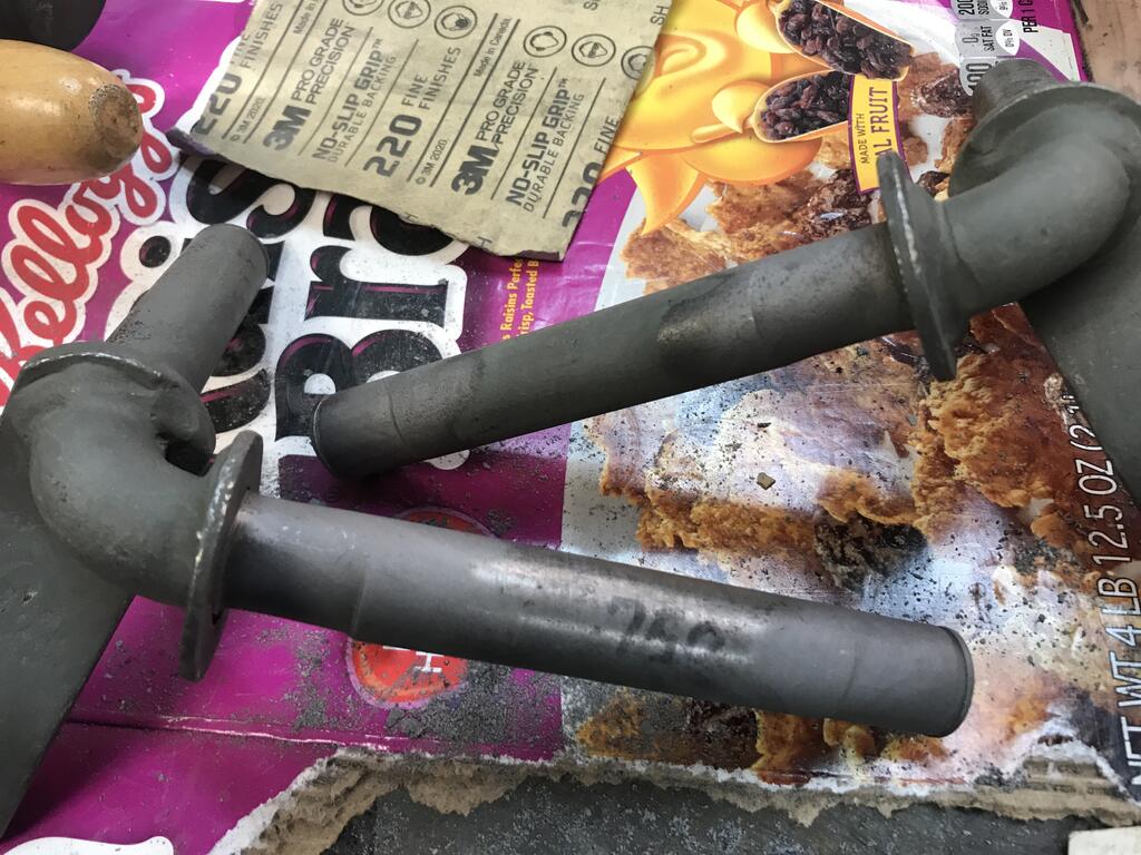

oliver2-44 11,847 #68 Posted October 28, 2021 It’s been 4 months, but I actually have been doing several little things. Welding up extra holes and cracks in thin sheet metal with a stick welder is not my thing. So I traded some sandblast work for some welding by a friend with a wire welder. Now a little grinding and smoothing Started repairing worn spindle areas with PC7 I got smart and mask the areas where I didn’t want epoxy. Less file/sanding is a good thing. I will use a bearing like in the picture in place of the cast iron split bearings. The PC7 really worked down nicely with a big file. I used a bearing to tell when I was getting close then switched to sand paper. Gas tank is next. 3 5 Share this post Link to post Share on other sites

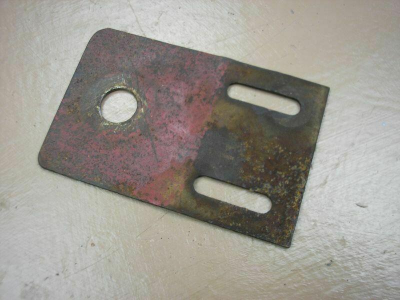

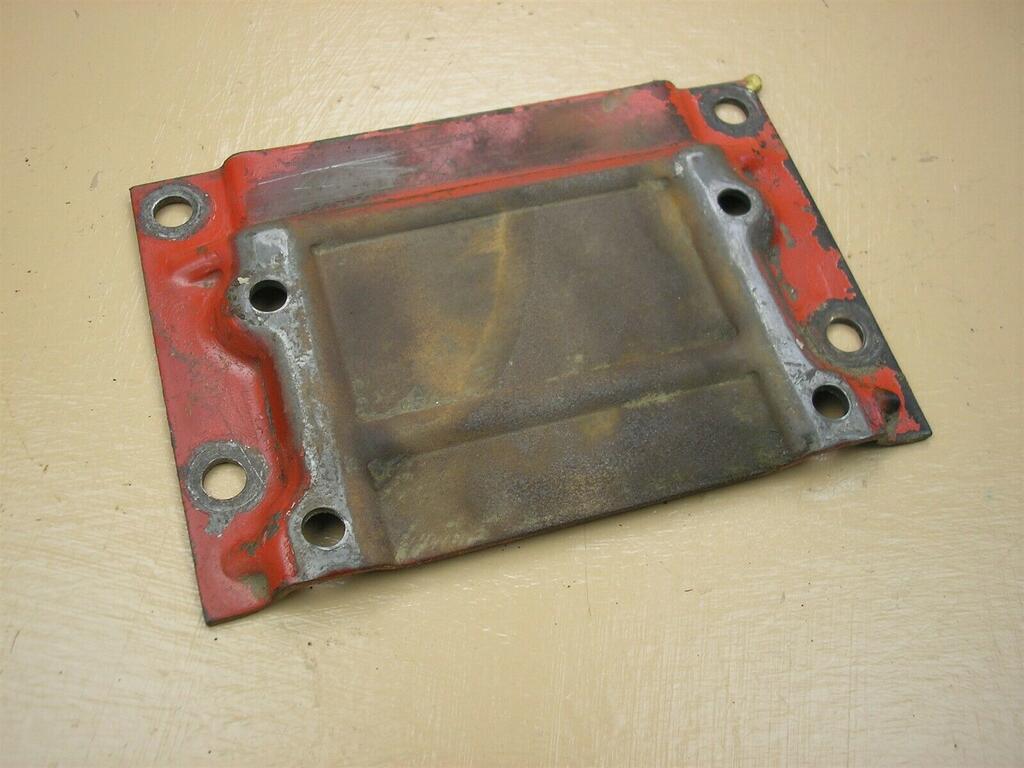

oliver2-44 11,847 #69 Posted November 15, 2021 Two questions about 551 parts. @formariz, & other 551 owners This is advertised as a Suburban 551 Tecumseh H60 engine mounting plate on Ebay. I don't see it on the parts breakdown and of course I don't have one. Is this required for the Tecumseh H55? or similar H60 engine or just bad advertising This is advertised as a Suburban 551 ignition switch mounting plate on Ebay. I don't see it on the parts breakdown and ofcourse I don't have one. Is this required for the original switch that counts in the round cover plate or bad advertising Share this post Link to post Share on other sites
formariz 12,381 #70 Posted November 15, 2021 That switch mounting plate is not from a 551. Bad advertisement or just lack o knowledge on the subject. Switch goes on the round cover clipped onto hood. Such cover is really an electric plate cover still available I believe. The one shown seems to be a user made part. As for the engine mounting plate, the H60 is not the correct engine for the 551. The H55 is the correct one. Having said that, the two engines are however identical in all dimensions to each other making the H60 a direct replacement if needed. The mounting plate on the H55s can be different wether used on a “B” or on a “ D” engine. If your question is if that plated would work on a H 55, I believe so but I would have to verify it on the engines I have here. Share this post Link to post Share on other sites

oliver2-44 11,847 #73 Posted November 15, 2021 Thanks @formariz Looks like I can make a plate like that out of flat steel plate. What is the height of the raised areas on the plate? PS I've collected copies of the electrical information pertaining to the H55 & H60. But I suspect I will have some questions for you when I get to that engine. It didn't have an engine when I got it. So far, I've only found an H60 engine. I've been looking for a H55, but just don't find them down here. (No old snow blowers for them to come off of I guess) 1 Share this post Link to post Share on other sites
