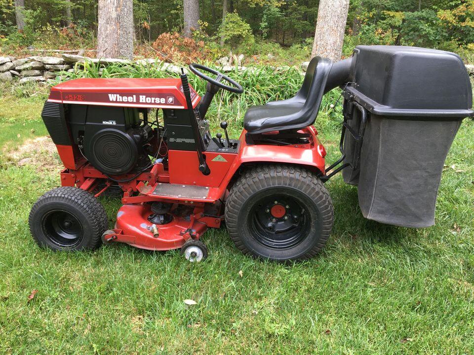

Dennis C. 142 #1 Posted September 21, 2020 Being relatively new to WH tractors, I need some feed back. While checking the transmission oil level on the 312-8 I noticed the dip stick was thick and milky. At some point in the tractors life water must have collected in the sump. I drained the old oil, flushed the trans with kerosene twice and filled with 80-90wt gear oil. Took the tractor out around the neighborhood and there is whining in the transmission. Some it sounds like a bearing at times as the noise will get louder and then quiet down. Are these trannys typically noisy? Thanks Share this post Link to post Share on other sites

Dennis C. 142 #12 Posted September 25, 2020 OK, a lengthy flush was completed, maybe not as long as suggested but completed anyway. Filled the tranny with 80-90 wt gear oil and have been hauling firewood out of the woods for the past 3 days. Transmission is much quieter and the squealing noise is gone. Found a new riding companion. My daughters dog loves to ride on the tractor with me!! 1 Share this post Link to post Share on other sites
