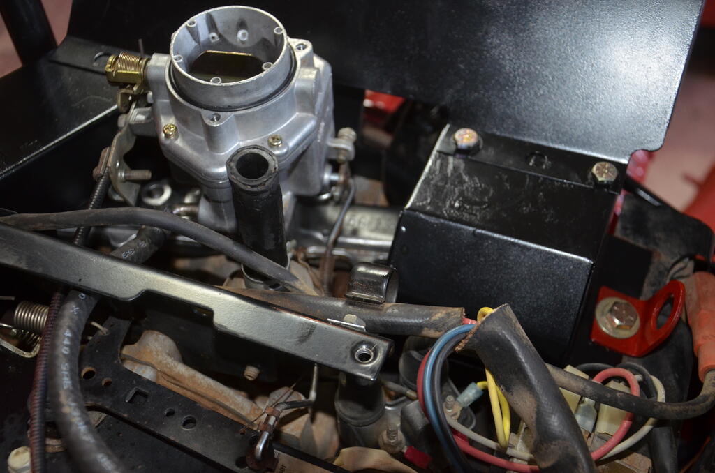

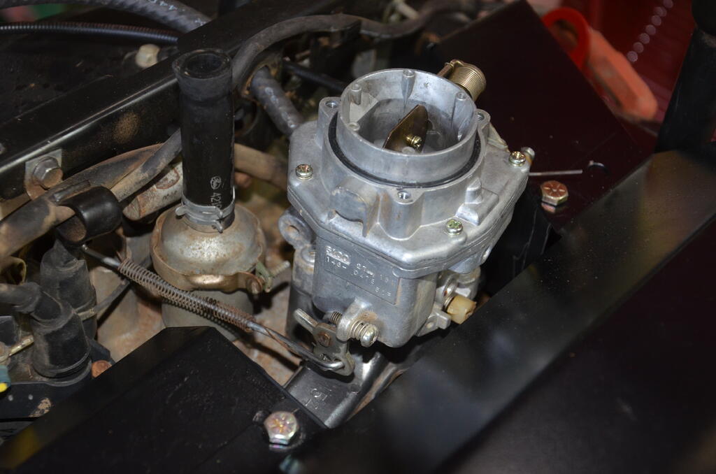

RJ Hamner 1,029 #11 Posted September 25, 2020 A funny (not really) thing happened while taking Ed's advise. Couldn't get to the plug that covers the jet (this is a non adjustable G model). So I thought that I'd just remove the carb and rebuild it. Roadblock 1: can't remove the carb without removing the intake manifold (carb mounts from the bottom) Roadblock 2: cant remove the intake manifold without removing the exhaust manifold and muffler. At this point the two tin covers, the hoist points and the oil filler tube bracket seemed like the easy part. Whoever designed the Onan engine was a sadist. While I have been waiting on parts I might have gotten carried away again but after soaking the card for two days in the mini dunk tank it is spotless. And I have an extremely shiny intake manifold and a newly blasted exhaust manifold and heat shield with two coats of 2,000 degree paint 1 Share this post Link to post Share on other sites

RJ Hamner 1,029 #13 Posted October 1, 2020 To quote a line from an old movie "We got trouble, right here in River City" Finally got all the parts and some time to do some work. Got it all put back together Tried to get it started and it was acting like it wasn't getting any gas. Checked tank shutoff, on. Checked fuel pump, shot a nice stream. Checked filter, not clogged. Pulled to of carb off. Bingo on fuel in the sump. Pulled float and needle. Float OK Needle looked OK then reinstalled (carefully) Two revolutions fired right up EXCEPT it runs at full throttle reguardless of lever position????? I didn't touch anything other than the rod going to the main butterfly Read, reread and went over everything again in the service manual. To put it mildly......I am stumped Like I said before Onan's are new to me. Share this post Link to post Share on other sites

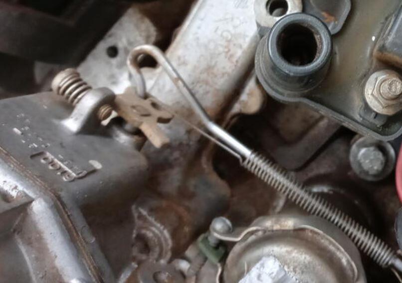

lynnmor 9,013 #14 Posted October 1, 2020 3 hours ago, RJ Hamner said: Two revolutions fired right up EXCEPT it runs at full throttle reguardless of lever position????? I didn't touch anything other than the rod going to the main butterfly If that rod has the double bend at the carb, maybe you have in the hole too far. Share this post Link to post Share on other sites

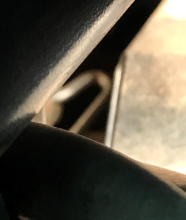

RJ Hamner 1,029 #16 Posted October 2, 2020 4 hours ago, lynnmor said: If that rod has the double bend at the carb, maybe you have in the hole too far. At present it is in the second bend in the rod? 4 hours ago, Ed Kennell said: Does the throttle plate open and close properly when the engine is not running? When the engine is off I can manually move the rod that controls the throttle plate Share this post Link to post Share on other sites
lynnmor 9,013 #17 Posted October 2, 2020 Put it in the first bend, see the fuzzy photo. 1 Share this post Link to post Share on other sites

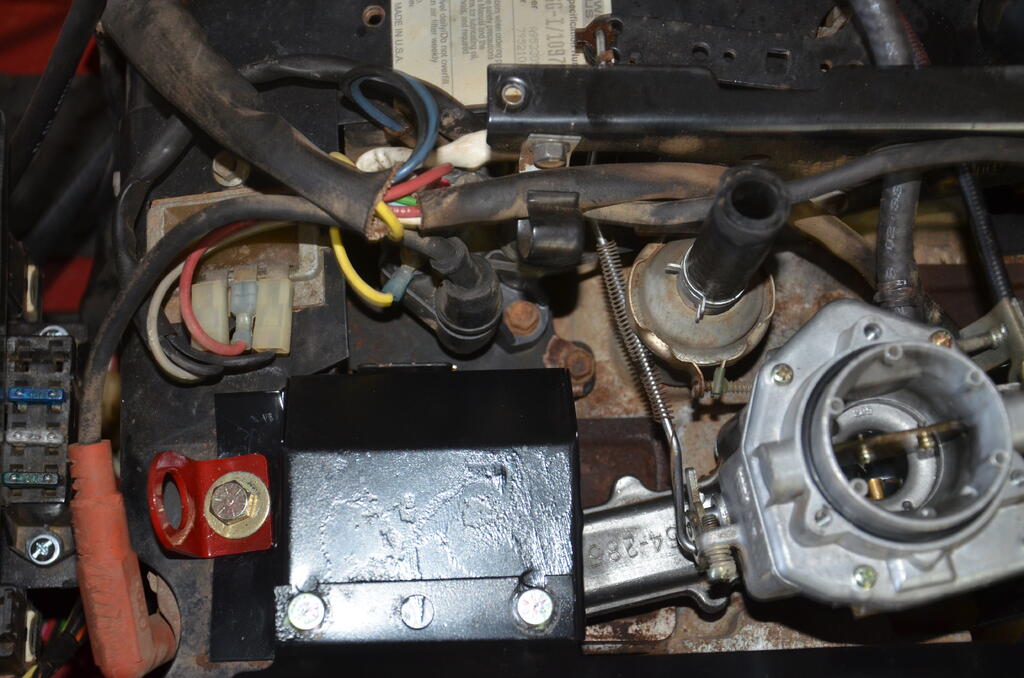

onanparts.com 185 #18 Posted October 3, 2020 (edited) I put some corrective lenses on Lynnmors pic.....:) Note that the spring here is in the same hole as rod. Should be in the front hole by itself. Edited October 3, 2020 by onanparts.com Share this post Link to post Share on other sites
RJ Hamner 1,029 #19 Posted October 3, 2020 When I was putting everything back together I had thought that it went in the first bend as shown in the pictures. But there is a brown spot on the rod (even shows up in the picture above) and it looked kinda like a wear spot and I thought that maybe I was wrong. Guess I shouldn’t second guess myself. Thanks to you and @lynnmor Share this post Link to post Share on other sites
