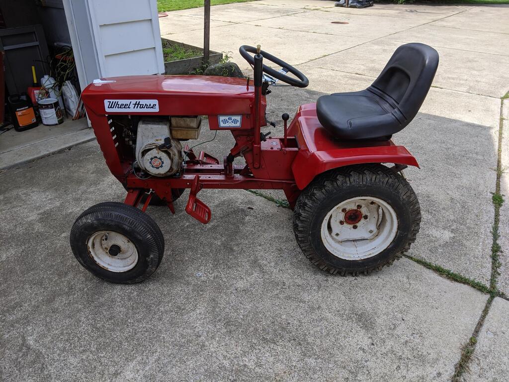

atbinkowski 13 #1 Posted September 1, 2020 Hi all! I'm new to the board, been lurking around a bit. Earlier this year I decided to do away with newer lawn tractors and buy something more Marine-proof. I picked up a C-175 and an Indy 500 Special as a combo deal (really only wanted the C-175, didn't know the 500 was a 500 until I started searching on here). The guy I bought them from had them sort of restored - mostly painted over and engine tune up type stuff. The 500 seems to be all original, included the hard sought after H60(?) engine. The crux is the mechanic sheered the driveshaft bolt off the engine. I'm wondering if this can be fixed if I farm the job out? I'd really like to get the Indy back to as original as possible, if possible, using it as a full restoration project my son and I can do together. I'll try to get some pictures up as well. Thanks! Tony 2 Share this post Link to post Share on other sites

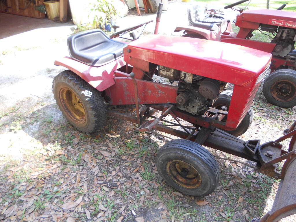

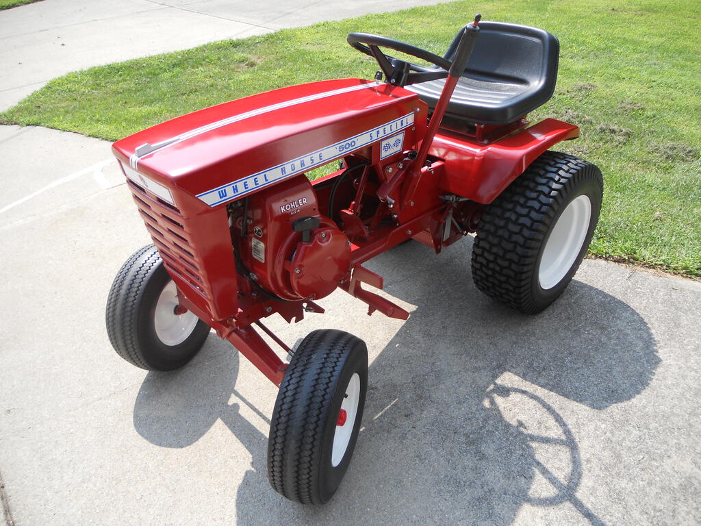

Racinbob 13,286 #6 Posted September 1, 2020 I love 500 Specials. Starting with these two tractors that were given to me. The 500 is in the backgound. The closest one is a 657. I used the salvageable parts from both of them to make this. Yours will be a great father/son project so please do post pictures along the way. Obviously it's not factory correct. 4 3 Share this post Link to post Share on other sites

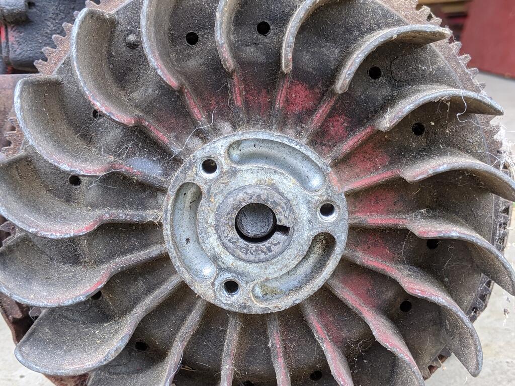

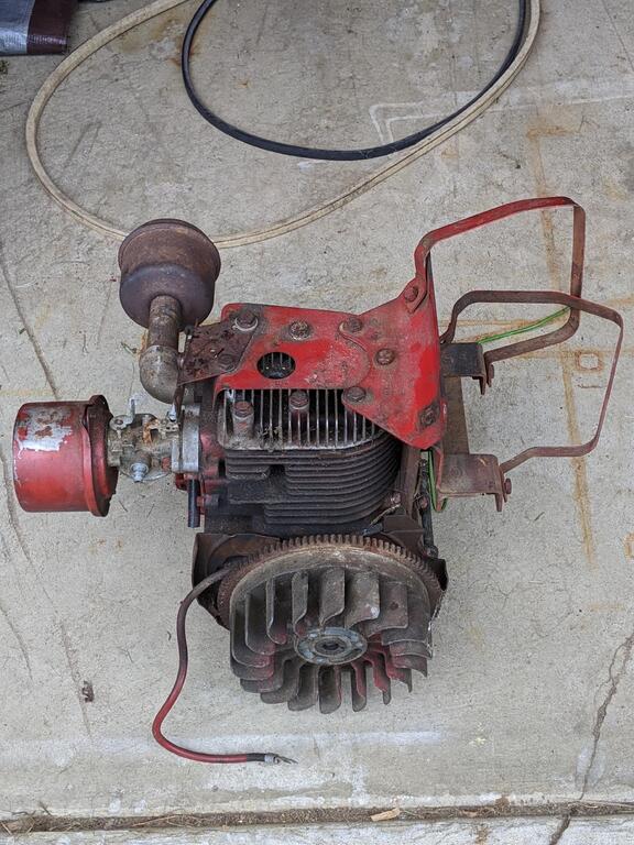

atbinkowski 13 #17 Posted September 2, 2020 Sorry it took some time to get back to this. Thank you all for your responses! I've attached some pictures. I think I meant to say the crankshaft bolt, not driveshaft bolt. I've been playing musical engines between my snowblower, wood chipper, and 500 this week. Engine on the wood chipper wouldn't start as soon as I got it home (ran just fine at the guy's place I bought it from...go figure), the engine on the 500 was back too far to use the deck I just bought, and the snowblower was the donor engine. Finally got the 500 all set last night after a second trip for belts and come to find that it cuts sometimes, smokes the belts other times. I'll try to figure that one out tomorrow (have woodworking to do today). Anyways, back to the subject. There's a local guy who restores older equipment, and I'm considering using him to fix up the engine, but winter is coming, so we'll see. I've been known to mess things up more than they were to begin with, so considering the safer and cheaper option 4 Share this post Link to post Share on other sites

Achto 32,927 #19 Posted September 2, 2020 (edited) 4 hours ago, atbinkowski said: This looks like some one used an impact wrench to turn the engine over. Note: you can put a socket on a drill and use it on the fly wheel nut to turn the engine over but never use an impact wrench to do this. The picture above shows the results of what will happen. The end of the crank shaft is broken off. Unfortunately, the only cure for this is to replace the crank shaft. 22 hours ago, atbinkowski said: The crux is the mechanic sheered the driveshaft bolt off the engine. If this was a mechanic that you paid, I would ask that he repairs his mistake. Edited September 2, 2020 by Achto Share this post Link to post Share on other sites

atbinkowski 13 #25 Posted September 2, 2020 The damage was done before I got it, otherwise that's exactly what would have happened. So I need to find a new crankshaft - how easy/hard is that for one of these old engines? Share this post Link to post Share on other sites
