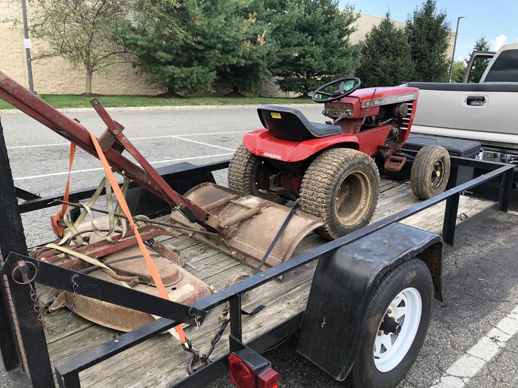

BHunter 1,702 #1 Posted August 29, 2020 I’ve been wanting a short frame automatic for a while. This 877 showed up on Marketplace and I had to get it. I really like the wood grain decals and the 8 hp with s/g . I got it home and rebuilt the carb. Then found out the vacuum fuel pump was clogged up too. Got it cleaned out and it fired up. Today we changed the trans fluid and took it for a test drive. It worked great. Mason drove it up a hill to see how the hst worked. It had no issues. A full restoration is in its future. IMG_4677.MOV 5 4 1 Share this post Link to post Share on other sites

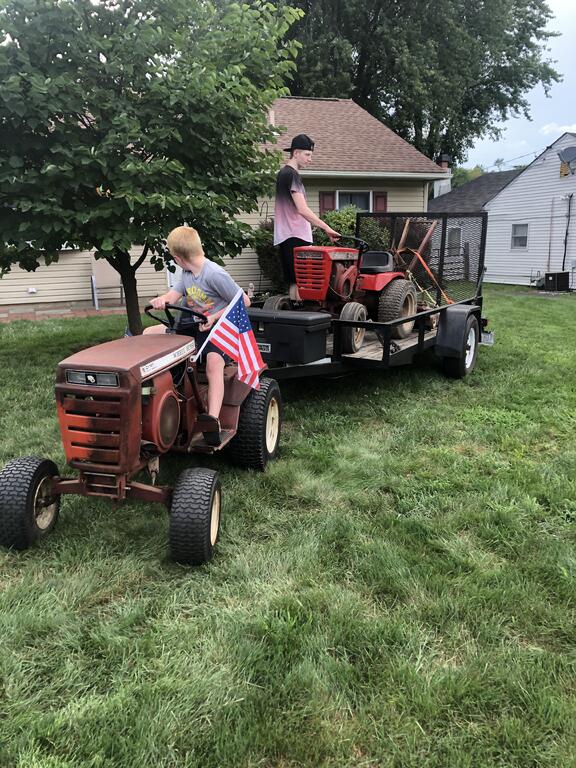

BHunter 1,702 #3 Posted August 29, 2020 Mason backing the trailer behind the house with his C141 5 3 3 Share this post Link to post Share on other sites

953 nut 67,389 #10 Posted August 30, 2020 11 hours ago, BHunter said: A full restoration is in its future. A wash and wax along with a dash decal from @Vinylguy will make it look lie new. Mason is "The Man" if he can back a trailer at his age. 2 1 Share this post Link to post Share on other sites
BHunter 1,702 #11 Posted August 30, 2020 1 hour ago, 953 nut said: A wash and wax along with a dash decal from @Vinylguy will make it look lie new. Mason is "The Man" if he can back a trailer at his age. You’re right. I’ve been talking with Terry. I’m going to get the whole set. Mason is getting good at backing the trailer behind the house. He has only has a few inches on each side of trailer after he gets around the side. There is a fence and air conditioning unit to get past. It’s tough without side mirrors . Hopefully there will be a Big Show next year and Mason will be cruising the 877 on Cruise night. 4 1 Share this post Link to post Share on other sites

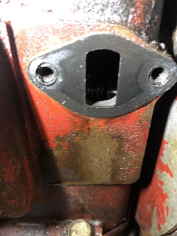

WHX?? 57,388 #21 Posted September 1, 2020 (edited) Yes mine hopefully got sent out today. Wonder if you could do me a favor Bob. Would like to know if there is a cam lobe to operate a mechanical fuel pump in a 8 HP.. The style with the lever. More importantly is the cam lobe centered in the pump mounting hole or is it offset to the right? See this thread Edited September 1, 2020 by WHX24 Share this post Link to post Share on other sites
pfrederi 20,869 #22 Posted September 1, 2020 (edited) K 181s use the offset Pump arm. Quick scan of the IPL indicates the vast majority used the same camshaft so the lobe would be there Edited September 1, 2020 by pfrederi 1 Share this post Link to post Share on other sites
BHunter 1,702 #23 Posted September 1, 2020 3 hours ago, WHX24 said: Yes mine hopefully got sent out today. Wonder if you could do me a favor Bob. Would like to know if there is a cam lobe to operate a mechanical fuel pump in a 8 HP.. The style with the lever. More importantly is the cam lobe centered in the pump mounting hole or is it offset to the right? See this thread It’s offset to the right 1 Share this post Link to post Share on other sites
BHunter 1,702 #24 Posted September 2, 2020 1 hour ago, BHunter said: It’s offset to the right You can see a little bit of the lobe on the right side of you zoom in. Share this post Link to post Share on other sites

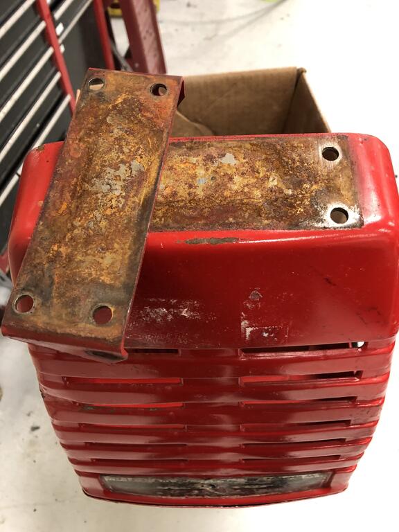

BHunter 1,702 #25 Posted January 30, 2021 I started taking the hood apart to get it ready for paint and found bare metal between the hood and the mounting bracket. No wonder I see a lot of hoods that have rot in that spot. This one only has surface rust. Not bad for a 1967. 2 Share this post Link to post Share on other sites
