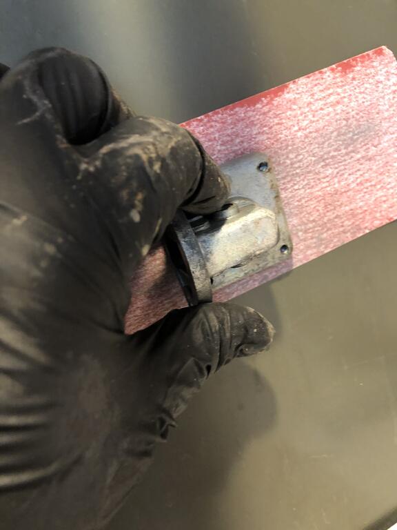

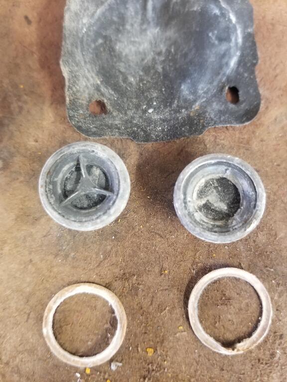

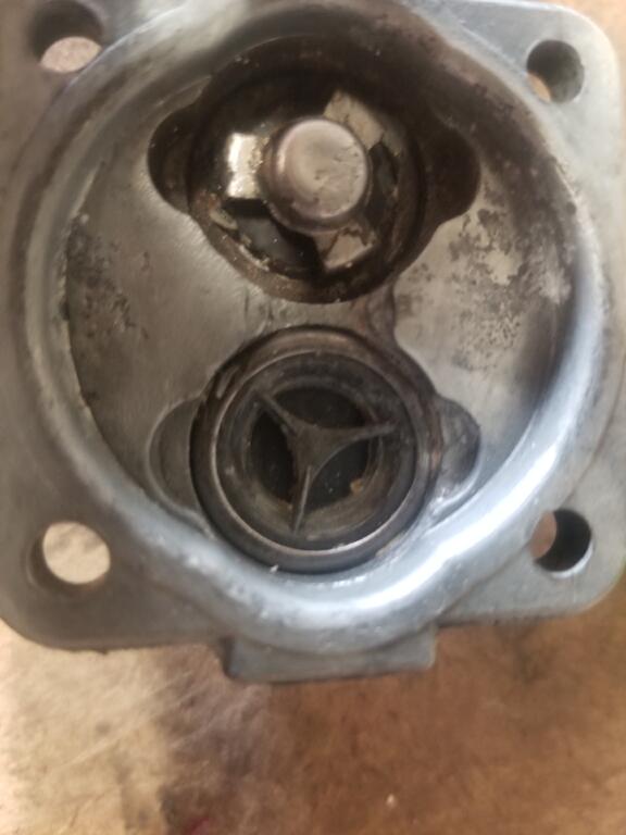

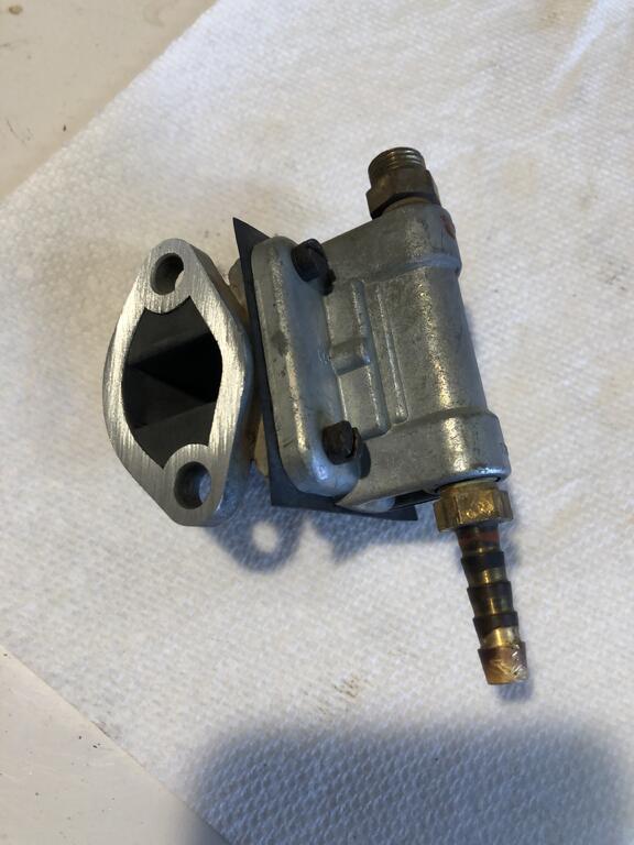

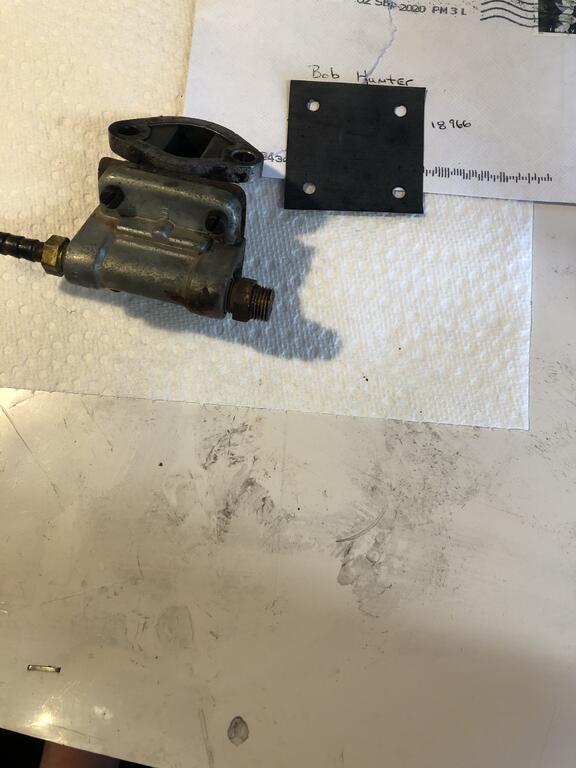

BHunter 1,702 #36 Posted September 6, 2020 I received the diaphragm from @buckrancher and Rebuilt the fuel pump today. It works great. 1 3 Share this post Link to post Share on other sites

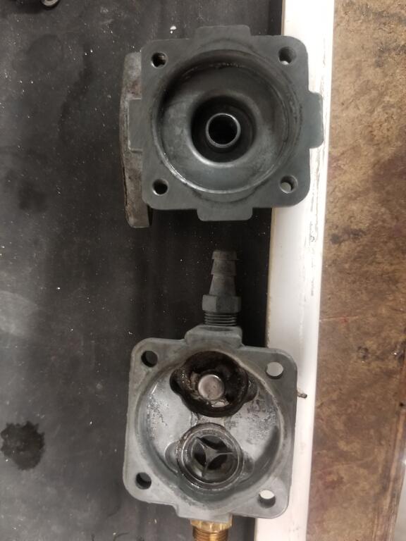

Elliot Garfinkel 166 #37 Posted October 2, 2020 Hi I find myself in the same fuel pump situation I sent a message to @buckrancher hopefully the diaphragm is still available but I was wondering how you disassembled the valves in the pump any advice would be appreciated. Thanks Share this post Link to post Share on other sites

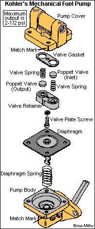

Jennifer 1,878 #38 Posted October 2, 2020 (edited) This is a mechanical fuel pump and it has a different diaphragm but the other mechanisms would at least give you an idea how it goes together! Hope it helps! Edited October 2, 2020 by Jennifer 2 1 Share this post Link to post Share on other sites

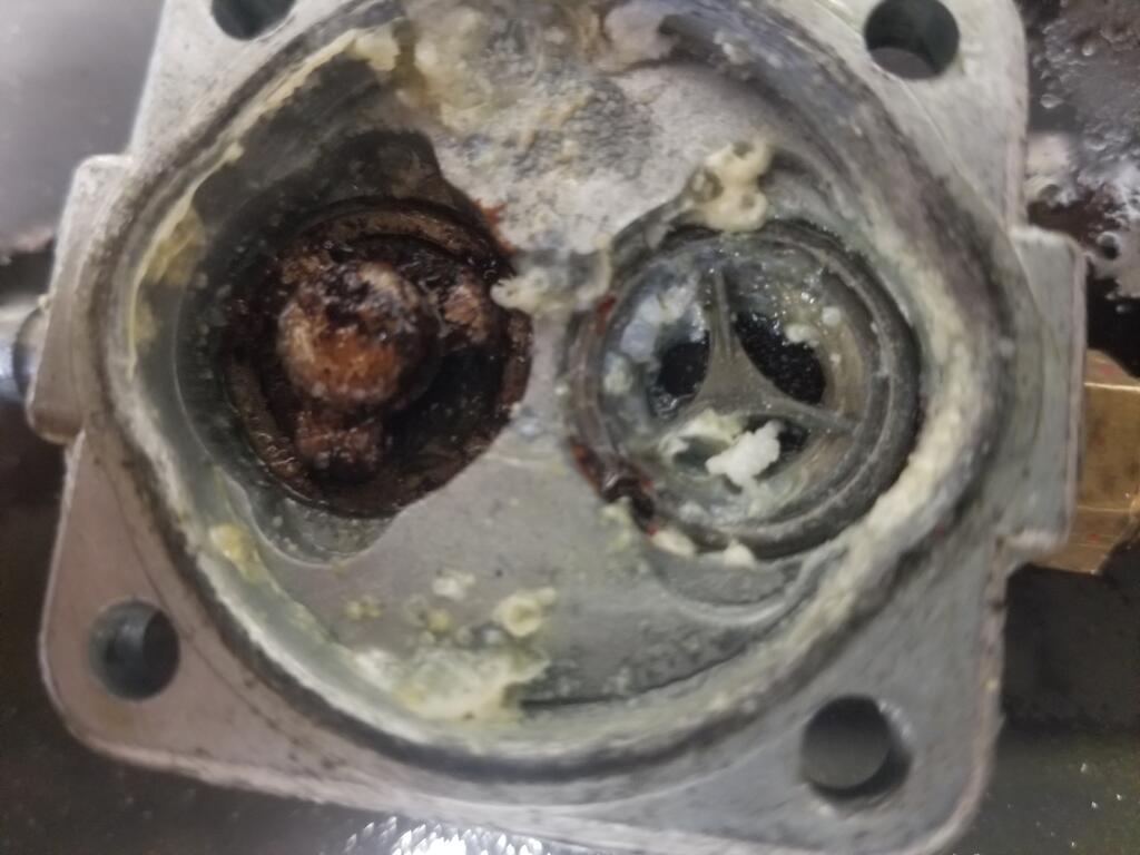

Elliot Garfinkel 166 #39 Posted October 4, 2020 Hi all so I ordered a kit from now and then but not sure it will work except for the diaphragm my pump doesn't have valve plate so not sure if rebuild able by me at least.this was after last season running for 2 hrs then system drained and ran dry did motor and tried starting this season.Thanks Share this post Link to post Share on other sites
ebinmaine 79,740 #40 Posted October 4, 2020 4 minutes ago, Elliot Garfinkel said: Hi all so I ordered a kit from now and then but not sure it will work except for the diaphragm my pump doesn't have valve plate so not sure if rebuild able by me at least.this was after last season running for 2 hrs then system drained and ran dry did motor and tried starting this season.Thanks Did the kit come with a correct diaphragm? Maybe a clean and reuse in the rest of it. All that slime is the result of previous ethanol usage. 1 Share this post Link to post Share on other sites
Elliot Garfinkel 166 #41 Posted October 4, 2020 I just ordered kit yesterday looks like right diaphragm I might call them and see if they didnt ship yet maybe send the pump to them put kit money to rebuild.As far as the ethanol I've been try to remove most of it by adding water to gas ,ethanol separates and drain somewhat ethanol less gas.(via utube)Although I noticed a good amount of rust in pump maybe from water in the stained gas.All new lines,filter And tank thoroughly cleaned,Thanks for quick response 1 Share this post Link to post Share on other sites
ebinmaine 79,740 #42 Posted October 4, 2020 2 minutes ago, Elliot Garfinkel said: I just ordered kit yesterday looks like right diaphragm I might call them and see if they didnt ship yet maybe send the pump to them put kit money to rebuild.As far as the ethanol I've been try to remove most of it by adding water to gas ,ethanol separates and drain somewhat ethanol less gas.(via utube)Although I noticed a good amount of rust in pump maybe from water in the stained gas.All new lines,filter And tank thoroughly cleaned,Thanks for quick response You're certainly doing the right thing trying to remove the ethanol. Not sure if there an issue with rust as I've never tried it. Perhaps others will chime in to comment on the rebuild. @Achto @WHX24 @953 nut 1 Share this post Link to post Share on other sites

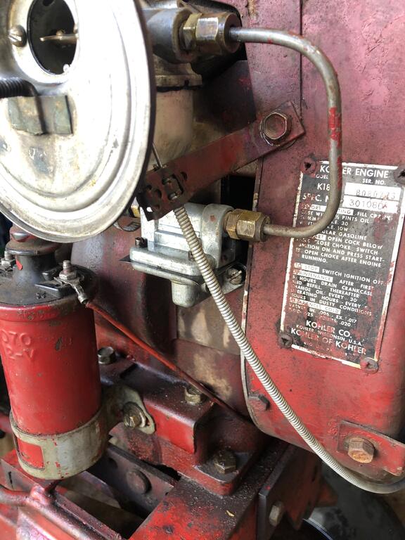

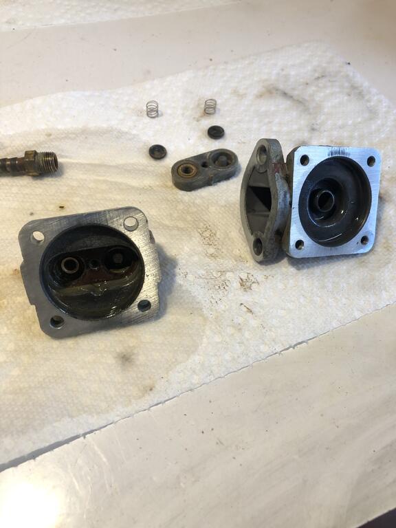

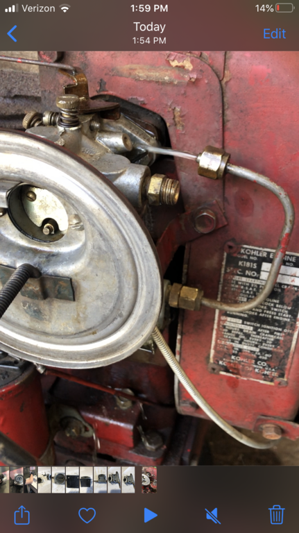

WHX?? 57,470 #47 Posted October 4, 2020 Couple more pics of the rest of the body please Elliot. Does it have a lever? I'm thinking a PO changed it at some time. Yours should look like Bob's BHunter above. His is a eight horse but should be the same. I have no idea how to get those valves out but they should come out somehow. Maybe you shouldn't try but just try and clean in place and flush good with a can of brake cleaner. The white gunk is oxidation from water. Share this post Link to post Share on other sites

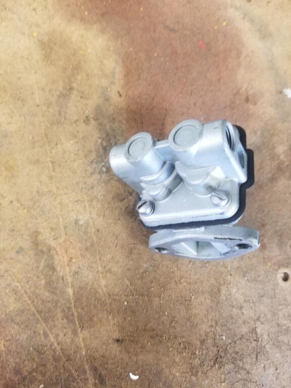

Elliot Garfinkel 166 #48 Posted October 5, 2020 Thanks for the response it doesn't have a lever I'm pretty sure it's an original kohler part here is some more pics Share this post Link to post Share on other sites

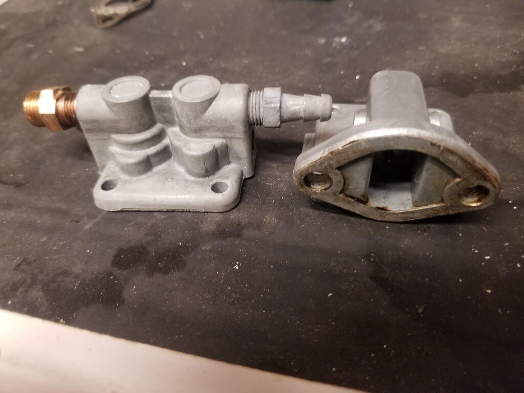

Elliot Garfinkel 166 #49 Posted October 15, 2020 Hi all so I just got my pump back from now and then complete rebuild it was only a couple of dollars more than kit plus shipping fee 2 2 Share this post Link to post Share on other sites
ebinmaine 79,740 #50 Posted October 15, 2020 That thing looks fantastic. I didn't know they did the rebuilds themselves as well as selling parts. Something to remember there. 1 Share this post Link to post Share on other sites
