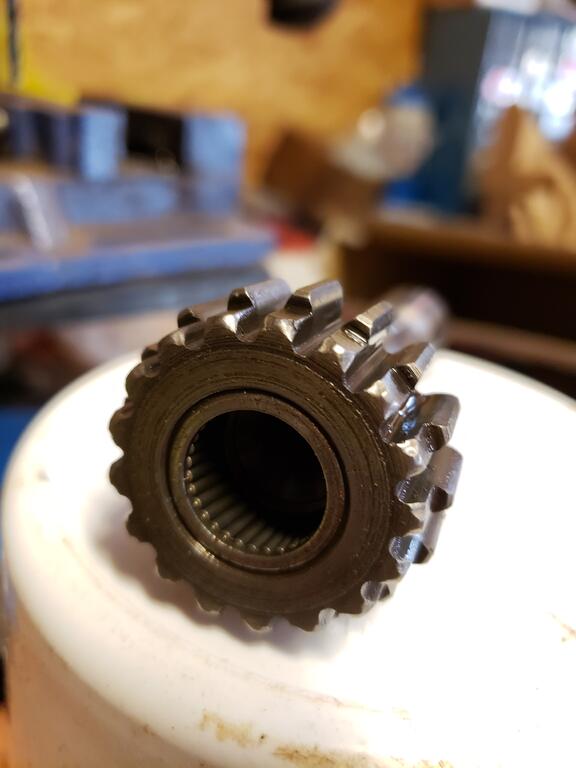

oliver2-44 11,663 #27 Posted August 27, 2020 Please post a pic of input gear with oil cleaned off and we’ll get @stevasaurus to weigh in on it You can find arbor shims at your hardware store that has all those drawers of special items 3 Share this post Link to post Share on other sites

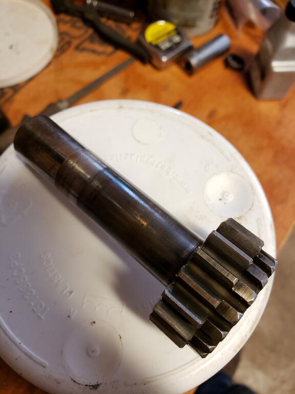

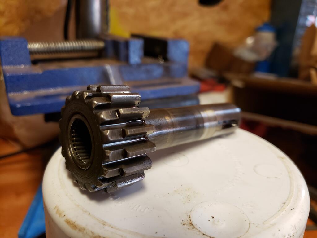

Gordyhogg 150 #34 Posted August 30, 2020 (edited) Sorry its been a couple days guys. My parts from lowell came in and id like to get this baby put back together and painted. This is the input gear/shaft right? Hows it look? If its ok then let me know and ill try to find some shims for it n throw it in Edited August 30, 2020 by Gordyhogg Share this post Link to post Share on other sites
oliver2-44 11,663 #35 Posted August 30, 2020 Your input gear looks good. Get her put together 1 Share this post Link to post Share on other sites

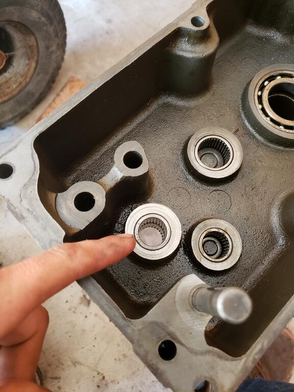

Gordyhogg 150 #36 Posted August 30, 2020 Thanks! Ill be going to the hardware store in a bit to get some things. If i do find some arbor shims there. Am i supposed to put them on the outside of the tranny behind the pulley or do i put them inside on the input shaft? Share this post Link to post Share on other sites
oliver2-44 11,663 #37 Posted August 30, 2020 Put them on the inside under the input bearing Share this post Link to post Share on other sites
Gordyhogg 150 #38 Posted August 30, 2020 Here? @oliver2-44 Share this post Link to post Share on other sites
stevasaurus 23,787 #39 Posted August 30, 2020 Yes, the shim/s would go there...but I am wondering how you would determine how much or how many. The idea is to make the input gear snug (not tight) into the hi gear, but too many shims can mess with the mesh and maybe even keep the shift rail from falling into the detente properly. I think I would build the whole transmission, including bolting it together, put it in 3rd gear and see how much play I had in the input shaft. The shims would amount to a hair less. You might get away with just building the spline shaft with the fork gears, and closing the case. I don't know?? Need @Racinbob in here I think. BTW, like Jim said, your input gear looks OK...just a little wear on the points. 1 Share this post Link to post Share on other sites
Racinbob 13,087 #40 Posted August 30, 2020 Unfortunately I didn't get on this thread until the transmission was apart. In the past I have suggested that the play be checked prior to opening it up. There's a good chance there will be none and not needing a shim. Now the only way to check it is to reassemble it. It's not too hard to get a fairly accurate measurement. I usually do it with the pulley removed and use a dial caliper from the end of the shaft to the case. I try to find a thickness that will keep the ball just falling a fuzz shy of the center of the detent. That will ensure that full contact is made. The very slight pressure won't hurt a thing. It's possible that, if there is any play, it could have been caused by wear of the detent. Just a theory though. The last one I did was the 5025 on my 854. It was right at .035. I happened to have a .038 in my stash so that's what I used. I believe I accomplished exactly what I wanted. I put a larger drive pullen on the engine making 3rd gear kinda like a 'road' gear and it's working perfectly. My 2¢ worth on the input gear is the same. I've used worse with fine results. 1 Share this post Link to post Share on other sites
Racinbob 13,087 #41 Posted August 30, 2020 4 hours ago, Gordyhogg said: Here? @oliver2-44 Yes, there. Slide it on the input shaft before you put it in the case. I wouldn't add one without checking if you need it and, if so, what thickness. 1 Share this post Link to post Share on other sites

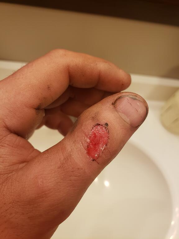

Gordyhogg 150 #45 Posted August 31, 2020 Also yesterdays lesson when using an angle grinder to remove paint from parts, dont let it eat your thumb...it doesnt help get any work done 3 Share this post Link to post Share on other sites
WHX?? 57,651 #46 Posted August 31, 2020 Ouch.... but been there done that... more than once .... Share this post Link to post Share on other sites

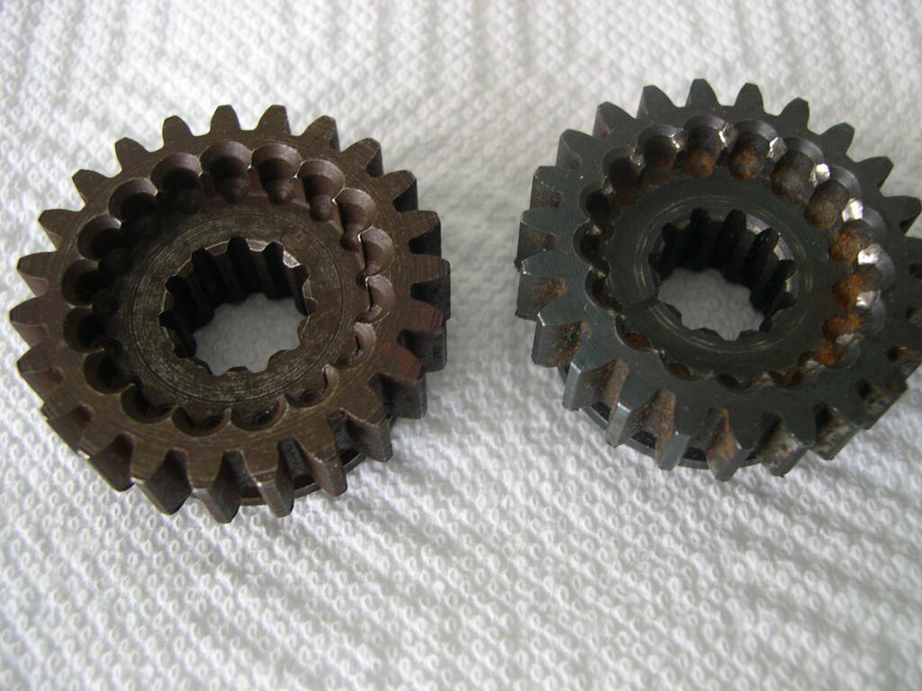

Racinbob 13,087 #48 Posted August 31, 2020 2 hours ago, Gordyhogg said: Ohh it has to be in gear when measuring the play? I wasnt able to get a good measurement before i tore it apart but (in neutral) it had some in and out play Yes, it must be in 3rd gear with only the detent holding it in place. You're wanting to make sure the 3523 gear stays fully engaged to the input gear. Here's a comparison of a new gear and a worn one. Share this post Link to post Share on other sites
