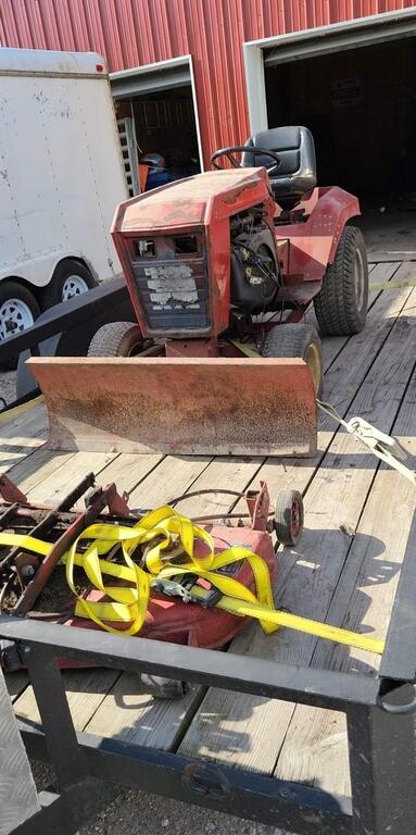

Mike e. 26 #15 Posted August 29, 2020 (edited) I just got the C-175 home I'll post pics tomorrow thanks for the help guys I'm thinking of going with Rust-Oleum Sunrise red for the main paint and the classic black for the hood and maybe some pinstripes for a little personal touch and all the original decals and thank's Alex 175 i will go with metal rear fender pan too the plastic one is broken Edited August 29, 2020 by Mike e. 2 Share this post Link to post Share on other sites
AMC RULES 37,260 #17 Posted August 29, 2020 Congrats, nothing but up from there. 1 1 Share this post Link to post Share on other sites
Mike e. 26 #18 Posted August 29, 2020 (edited) Now to get it running I'll post pictures of it and a pic of the identification plate tomorrow I already love it and it still has two years of dust on it from setting in a burn or garage so I'll probably be getting more I have two now a-165 and c-175 Edited August 29, 2020 by Mike e. 3 Share this post Link to post Share on other sites
Pollack Pete 2,273 #19 Posted August 29, 2020 7 hours ago, Mike e. said: I'll probably be getting more I have two now a-165 and c-175 Yes,they tend to multiply.Ask me how I know.Pic looks pretty good.Should clean up nicely.Have fun with your new toy. 1 1 Share this post Link to post Share on other sites

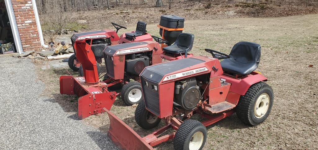

Alex175 785 #20 Posted August 31, 2020 On 8/28/2020 at 11:33 PM, Mike e. said: so I'll probably be getting more I have two now a-165 and c-175 Oh yeah, it's an addiction, this forum is really just our support group. The only problem is we are all enablers Here's a picture of my C-Series with the metal fender swap. To me it is just a much cleaner look than the plastic, and it doesn't hurt that it is a heck of a lot more durable as well. I haven't been able to find a metal fender for the C-195 in the back yet, I know there is nothing factory wise for them, but I have to figure someone out there made one, and maybe I can have one made too 3 Share this post Link to post Share on other sites
WHX?? 58,347 #21 Posted August 31, 2020 47 minutes ago, Alex175 said: much cleaner look than the plastic, Agreed and about the easiest swap one can do on a black hood. Mine came off a parts 520 & fit perfect. On the Super C I don't know if it can be done. might get tricky for gas tank filler and some custom holes for the lift levers. if I had an extra metal pan to play with wouldn't be afraid to give it a shot. I know the guy who is making hi test fiberglass replacement pans for the Supers. He is a member here. Looks like yours is a '84? 2 Share this post Link to post Share on other sites

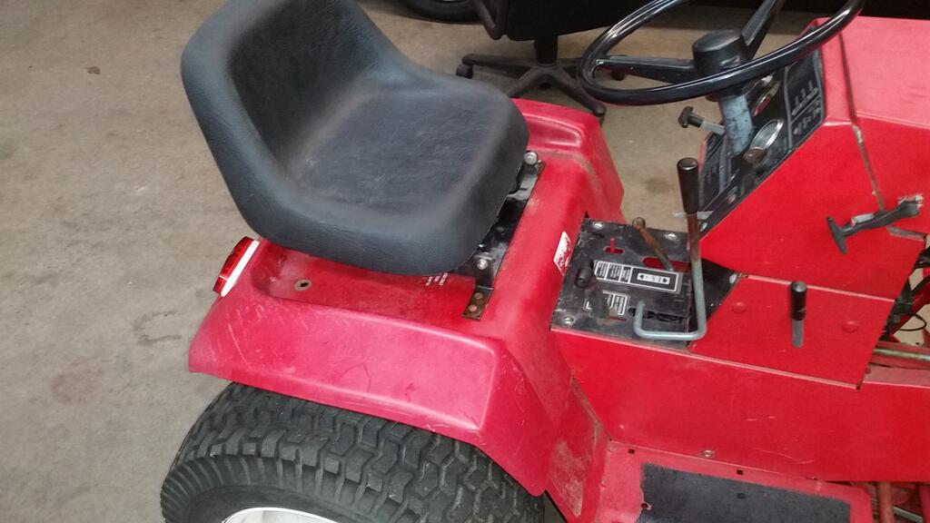

Mike e. 26 #22 Posted September 2, 2020 (edited) '84 is what I was thinking I know the motor is a Kohler motor with points on top the motor ID plate on motor has numbers faded so I have to see of I can take it off to get a number also still can't find the main ID plate on tractor itself and I need a coil and probably a starter any ideas Edited September 2, 2020 by Mike e. Share this post Link to post Share on other sites
WHX?? 58,347 #23 Posted September 2, 2020 Just now, Mike e. said: '84 is what I was thinking I know the motor is a Kohler motor with points on top the motor ID plate on motor has numbers faded so I have to see of I can take it off to get a number and I need a coil and probably a starter any ideas @PeacemakerJack told me the '84s are the only ones with the lift levers mounted high. The motor is probably a KT series 1 if original motor. The series 1 was not the best motor Kohler ever made. Vast improvements on the oiling system in the series 2. Starters are common and can be had here as well as other KT parts. http://www.psep.biz/store/kohler_starter_motors.htm 1 Share this post Link to post Share on other sites
Mike e. 26 #24 Posted September 2, 2020 Whx24 thanks for the help I'm new to the brand I got a b-165 for 20 bucks it looks like the headlights will work I made a mistake and said it was a-165 sorry guys I got it while waiting for my c-175 it's all original and it's got the lever for hydraulics down on the panel between your feet and it needs a few parts I'll post some proper pics as I was asked and maybe a video I plan on starting work on it as soon as I can get time still working on my trailer I just moved from WV to Monticello, indiana so I'm planning on finding out on all the attachments that work with it and unfortunately I got bit by the horse it sneaked up on me lol 1 Share this post Link to post Share on other sites
Alex175 785 #25 Posted September 2, 2020 44 minutes ago, WHX24 said: told me the '84s are the only ones with the lift levers mounted high. This is correct for the C-195's 52 minutes ago, Mike e. said: '84 is what I was thinking To find out exactly what year your C-175 is you need to look for a tag under the steering wheel column, on the side facing the seat between the upper dash area, and the hydraulic controls. The serial number should be there. 1980 01-17KE01 (hydrostatic) 1981 01-17KE02 (hydrostatic) 1982 01-17KE02 (hydrostatic) 1983 01-17KE03 (hydrostatic) 1 Share this post Link to post Share on other sites
