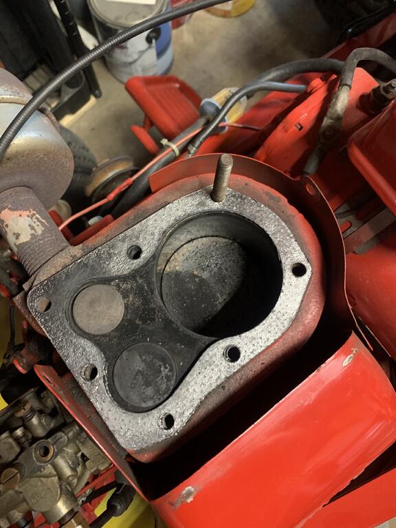

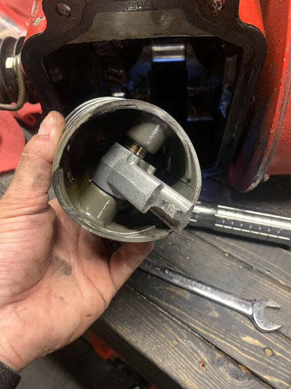

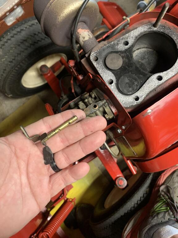

Delkc01 1 #10 Posted August 23, 2020 Thank you all for your feedback. I have never worked on engines in my life so this is all new for me so bare with me as I want to learn. I had my neighbor come over that seems to know a little bit about everything so we took the head off and found a little metal piece sitting on top of the piston. As we dug in more we also found that the butterfly, I guess you would call it somehow broke off of the throttle adjustment within the carburetor and made it way through. There is zero compression and the rod is 100% broke. Has anyone see this happen before? 1 Share this post Link to post Share on other sites
The Tuul Crib 7,354 #11 Posted August 23, 2020 Sounds like rebuild to me . I'm with majority about helping you through this. A lot of good knowledge here! T😎 Share this post Link to post Share on other sites

tunahead72 2,662 #13 Posted August 24, 2020 8 hours ago, Delkc01 said: 8 hours ago, Delkc01 said: I'm not an expert here, but that combustion chamber doesn't look horrible to me. Do you have a photo of the head that you removed? You mentioned a noise in your first post, I think I would check that out carefully... In this photo, the piece along your index finger is the throttle shaft, which installs into the opening at the top of the carburetor, right past the end of your finger. It looks to me like somebody installed a bushing or two to tighten up the shaft and make it operate more smoothly, it's a pretty common repair to make on these carbs. The other piece in your hand, I can't quite tell but maybe it's the butterfly, a thin flat metal disc? Once the shaft was inserted into the carb, that disc would have been fastened to it with two very small screws, it's quite possible that they broke loose and got sucked out of the carb and into the engine. Did you find those two screws? And what was the part that you found on top of the piston? You have a good neighbor. Share this post Link to post Share on other sites
Delkc01 1 #14 Posted August 24, 2020 The butterfly pice was sitting on tip of the large piston when we took off the head. It did break off and one screw is still connect, but cant fine the other one. The rod is defiantly broke too. Share this post Link to post Share on other sites

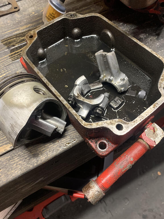

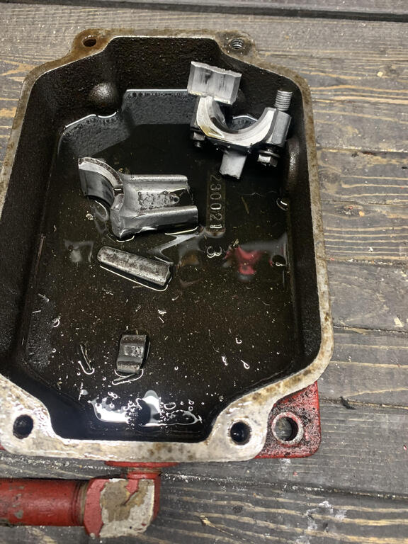

Delkc01 1 #17 Posted August 28, 2020 I'm pretty sure I found one of the issues. 1 Share this post Link to post Share on other sites
953 nut 70,322 #18 Posted August 28, 2020 That would do it. How do the crank shaft and cylinder look? Any evidence of other damage? Share this post Link to post Share on other sites
Delkc01 1 #19 Posted August 28, 2020 (edited) @953 nut No - I had my neighbor look this morning to make sure I wasn't missing anything and those look pretty good. Anything else I should check? Edited August 28, 2020 by Delkc01 Share this post Link to post Share on other sites

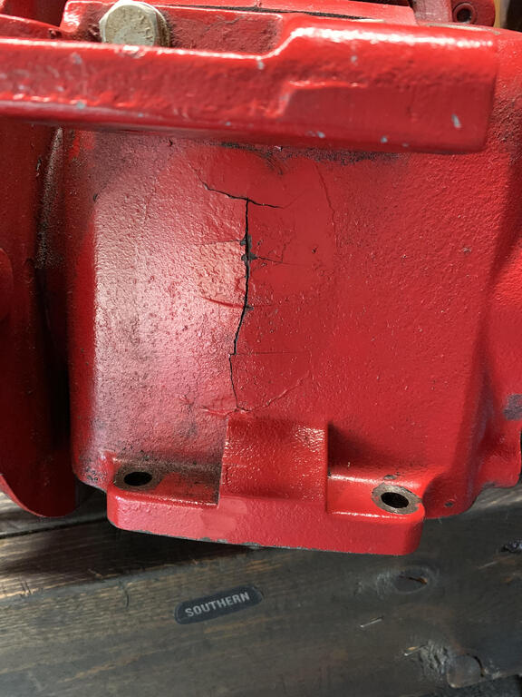

Delkc01 1 #23 Posted September 8, 2020 Well went to put everything back together and didn't see there was a crack in the engine block. The advice I have been given is to use JB Weld or Braze Weld. Thoughts anyone? Share this post Link to post Share on other sites
953 nut 70,322 #24 Posted September 8, 2020 1 hour ago, Delkc01 said: JB Weld Clean it up inside with a wire brush followed with a lacquer thinner wash and spread 1/8" layer of JB weld on the damaged area. Share this post Link to post Share on other sites
tom2p 2,396 #25 Posted September 9, 2020 my advice is to find another engine 1 Share this post Link to post Share on other sites
