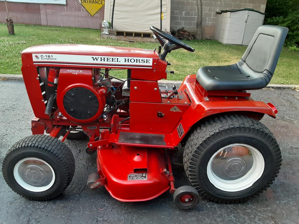

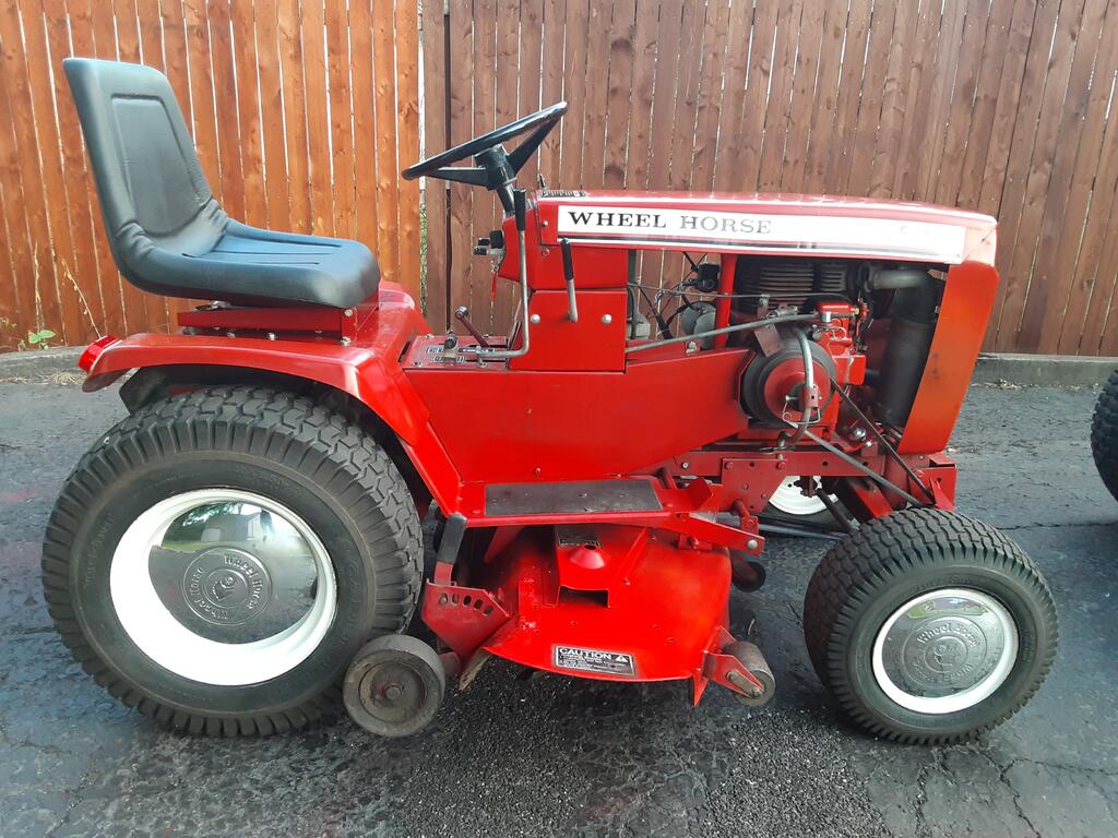

D_Mac 9,339 #3 Posted August 13, 2020 Yes I had a C-161. Same thing, the hood and the side of the grill would get really hot. Its just a bad design flaw. You look at most of these models you can see where the paint gets messed up along side of the grill and top of the hood. It is because the muffler sits so close. I think @c-series don made some heat shield for some of his to help correct that problem. Notice the first picture of mine you can see the paint discolored near the muffler. The original decal was also burned away, also the top of the hood around there became discolored. I was going to put a stack muffler on it to help with that problem but sold the tractor before I did it. 1 1 Share this post Link to post Share on other sites

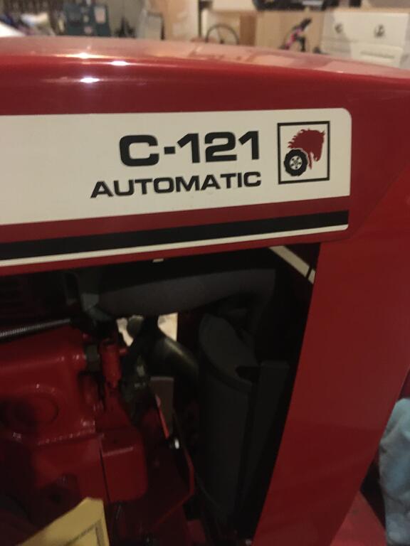

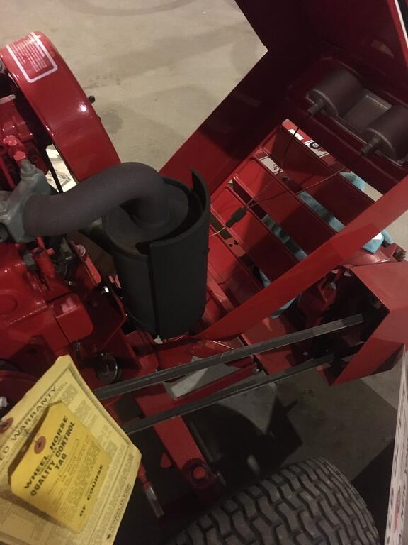

c-series don 12,421 #13 Posted August 14, 2020 (edited) After the paint on my newly restored C-121 blistered, I personally asked Cecil Pond about this and he said basically it was not the best design. Here’s the shield that I made for it. Edited August 14, 2020 by c-series don 3 Share this post Link to post Share on other sites
