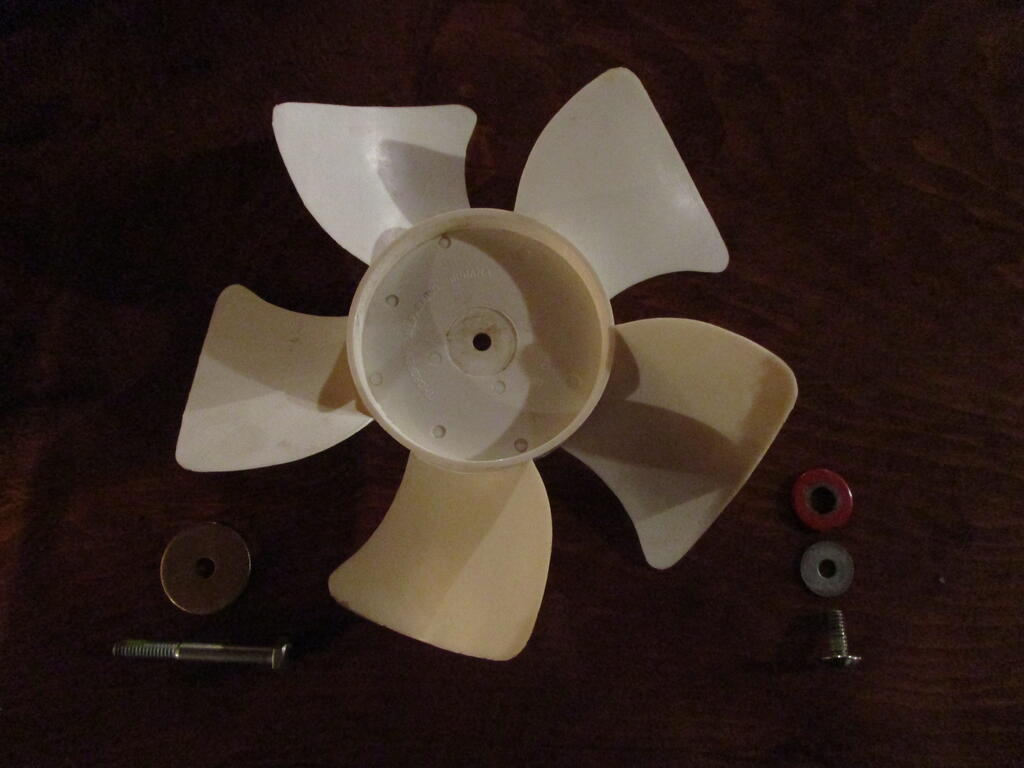

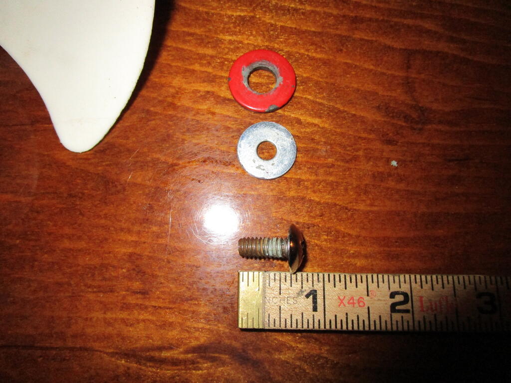

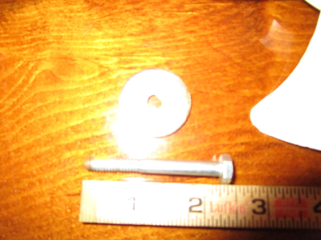

JCM 11,343 #1 Posted August 2, 2020 After purchase of a 420 and making a list of things to correct I found the fan was mounted with a phillips head fastener, flat washer and red washer then plastic fan to shaft which looked incorrect to me. After research I found Part # 908010 hex hd cap screw with a # 103995 washer to be correct. This cap screw measures 2- 1/4 '' from behind head as compared to 5/8'' long fastener. The new cap screw has loctite on it out of the package and seems to tighten after several turns in. To me it seems it has a long way to go before the washer will compress up to the fan. Looking for your opinions on this before proceeding. Thanks Share this post Link to post Share on other sites

squonk 47,804 #3 Posted August 2, 2020 (edited) I don't remember what was exactly there, but that long bolt aint right. Your 520 has the same fan. Take a look. Edited August 2, 2020 by squonk 1 Share this post Link to post Share on other sites
JCM 11,343 #4 Posted August 2, 2020 Wire only goes in 1'', that explains the screw and doubled up washers. I thought about the 520 but it would take a bit of moving things around to check that out. I am not quite ready yet to run the 420 but getting real close. I hate the thought of messing with the 520 and breaking that off inside the shaft. Is it possible the bolt listed for that is incorrect, could be. If someone has replaced the fan on either one of these machines please let me know and thank you @squonk & @ebinmaine . Maybe I should just use the correct washer I have with a shorter cap screw, just want to do the right thing. Enjoy your Sunday 1 Share this post Link to post Share on other sites
gwest_ca-(File Mod) 12,421 #5 Posted August 2, 2020 The ipl I looked at lists 2 bolts 908002 is 1/4-20 x 5/8" 908010 is 1/4-20 x 2-1/4" 2 - 103995 washers listed but no description. Garry 1 1 Share this post Link to post Share on other sites
squonk 47,804 #6 Posted August 2, 2020 (edited) 1/4" x 5/8" sounds right. Now go try to find one. Gonna have to try a 3/4" . Maybe trim it. I would use an external toothed lockwasher under the bolt head. Edited August 2, 2020 by squonk 1 1 Share this post Link to post Share on other sites

Damien Walker 297 #9 Posted February 4, 2021 You've probably fixed this by now but my three transaxles all have (conventional) Hex head 1/4-20 screw probably 5/8" or 3/4" long (ie threaded all the way, no plain shank). The long bolt is totally wrong and whilst the button head Philips will probably do, it's not the right part! It does seem rather a poor way of mounting the fan as it is very likely to slip.May be that is intentional to try to keep the blades on should anything get caught up in the fan? 1 Share this post Link to post Share on other sites
