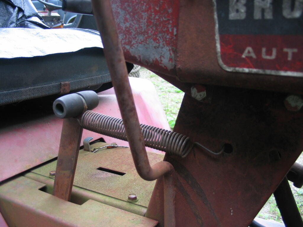

daveoman1966 3,882 #3 Posted July 27, 2020 I have a Bronco 14 with the same ANNOYING rattle issue...from exactly the same source... Flat Idler bouncing around. My fix was easy....just hook up a tension spring like this to stop the rattle. Your Charger has all the same hardware, EXCEPT for the engagement lever, so I don't know if you could arrange some sort of spring to minimize the rattle, or not. 3 Share this post Link to post Share on other sites

bottjernat1 2,196 #5 Posted July 27, 2020 (edited) I agree with @squonk Hey whatever works. I dont think i have seen anybody put a spring there before. Edited July 27, 2020 by bottjernat1 1 Share this post Link to post Share on other sites

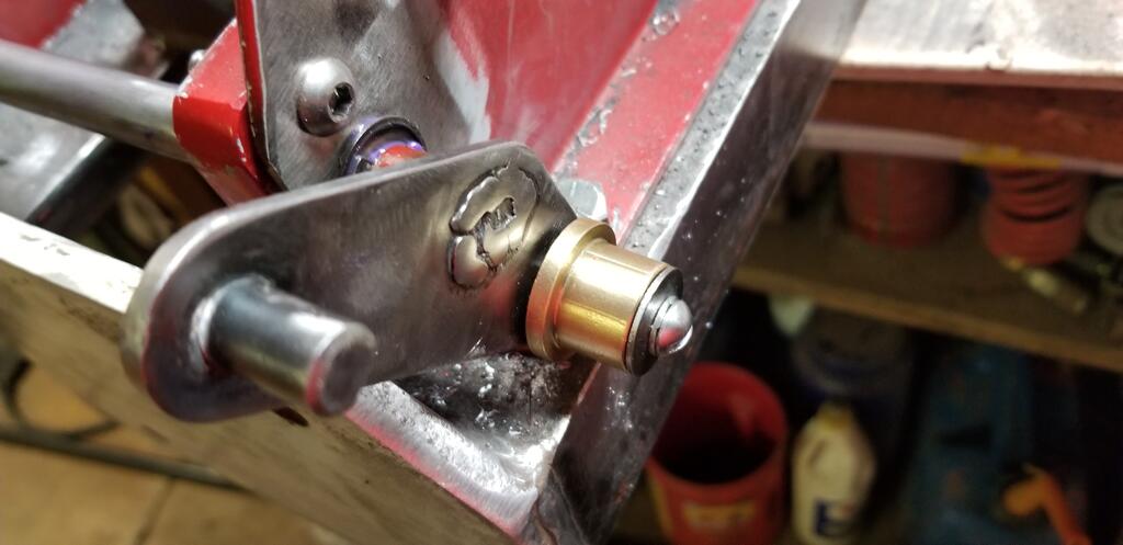

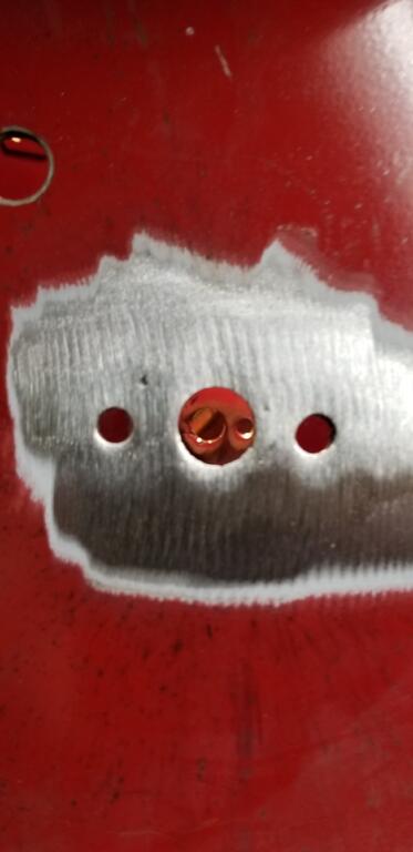

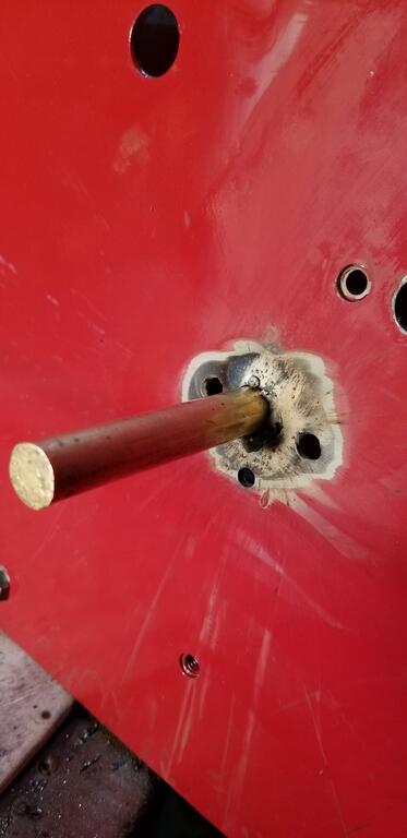

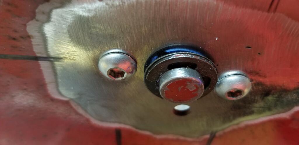

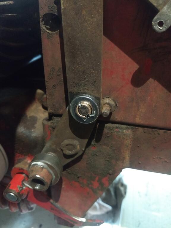

gt14rider 1,053 #8 Posted December 8, 2020 Tightened things up with brass bushings, grommets, welded up holes 1 2 Share this post Link to post Share on other sites
ebinmaine 77,517 #9 Posted December 8, 2020 @gt14rider Beautiful work there. Can't quite tell from the pictures on this phone. Is that a brass or copper rod you're using as a welding spacer? Share this post Link to post Share on other sites
gt14rider 1,053 #10 Posted December 9, 2020 9/16 brass rod. I Put a brass bushing on pivot point,should help with wear from E brake lever . Also welded and smoothed holes in lever 1 Share this post Link to post Share on other sites
ebinmaine 77,517 #11 Posted December 9, 2020 28 minutes ago, gt14rider said: 9/16 brass rod. I Put a brass bushing on pivot point,should help with wear from E brake lever . Also welded and smoothed holes in lever Very nice. Looks like I need to fire up the ole buzz box. Share this post Link to post Share on other sites
oliver2-44 11,258 #12 Posted December 9, 2020 Weld will not stick to brass or copper so you can use a rod to help build up a hole, or a flat piece to completely fill in a hole 1 Share this post Link to post Share on other sites
ebinmaine 77,517 #13 Posted December 9, 2020 7 hours ago, oliver2-44 said: Weld will not stick to brass or copper so you can use a rod to help build up a hole, or a flat piece to completely fill in a hole Watched a couple videos on that. Cool stuff. Share this post Link to post Share on other sites

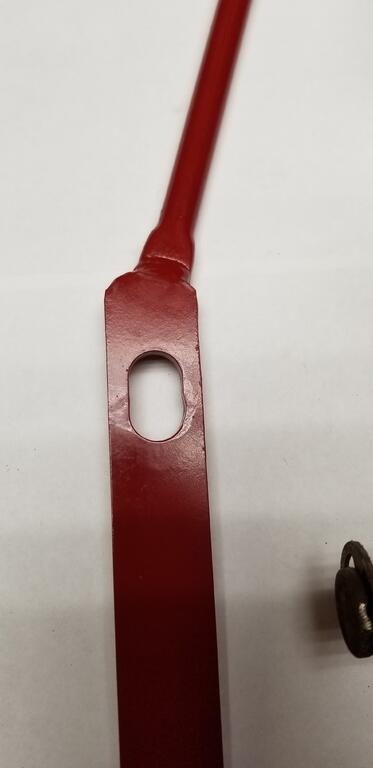

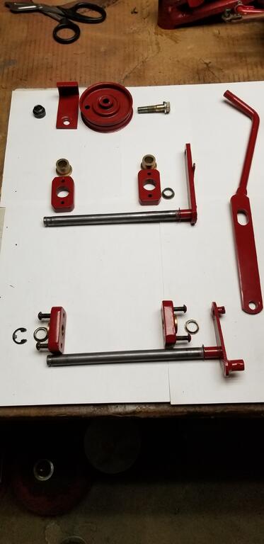

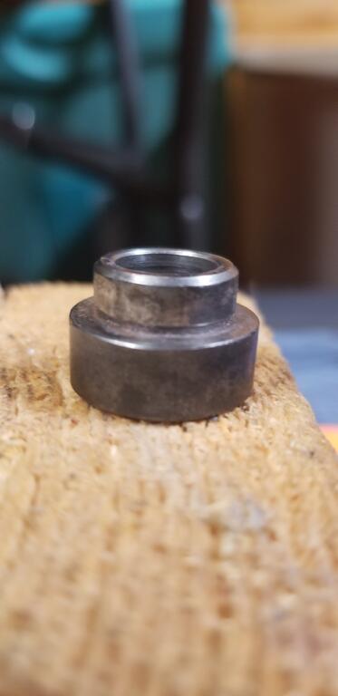

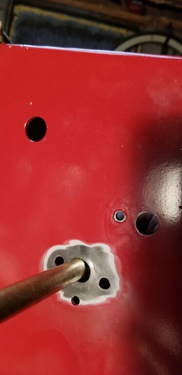

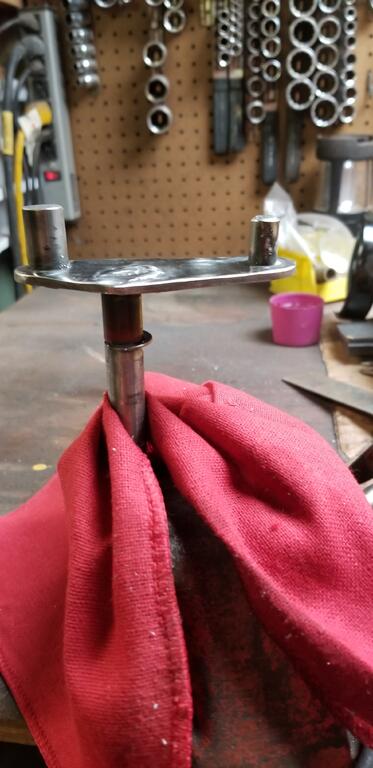

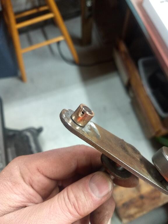

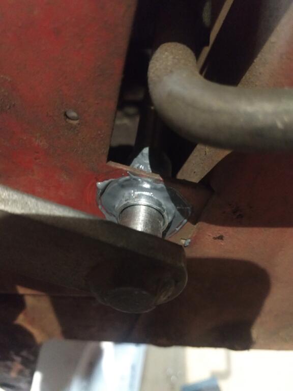

ebinmaine 77,517 #14 Posted January 9, 2021 I wanted to take a minute to post what I'd done here. My welding setup is exterior only and snow is pretty much surrounding the bench. I decided to get some bushings and try JB Weld. Worst it could do is not work for long. The idler shaft was WELL worn into the sheet metal that supports it. The size difference was varying from 3 or 4 thousandths to about 9. Nice oblong hole. I bought a couple steel bushings 1/2" ID to 5/8" OD. Sanded the rust off the shaft til it went through then drilled the sheet metal to accept the bushings. I coated the outside of the bushings with JB and pushes them in to place. Cleaned up the excess and put the shaft in place so everything would dry straight. The pivot pin on the brake handle was also extremely loose. The pin was rusted to the point of being out of round and mushroomed at the end. Sooooo me and my Dremel had some fun. I found a copper bushing that was just a little too tight for both inside and outside diameters. Put a little grindstone on and made the pin as close to round as I could starting on the bench grinder to remove the biggest parts. I then put a chainsaw sharpener diamond bit in and did the same thing to the corresponding hole. Last thing was to cut a notch for the cotter pin. Install bushing... Voila! 3 1 Share this post Link to post Share on other sites

Handy Don 15,997 #18 Posted January 13, 2021 Well dang. Today being warmer (42, up from the 20's) I decided to get after an intermittent rattle that's been bugging me in the 520 chassis somewhere. Finally tracked it down to the shaft supporting the drive belt tensioner. It's the same issue that @ebinmaine had with his--wallowed out sheet metal supporting the shaft. As soon as I get a couple of bushings (and fresh JBWeld), I'm gonna fix it the same way! 1 Share this post Link to post Share on other sites
ebinmaine 77,517 #19 Posted January 13, 2021 7 hours ago, Handy Don said: fresh JBWeld Funny you'd mention that. I realized the other day my own JB Weld is WELL over 20 years young. Might be time for a newer package here too. Share this post Link to post Share on other sites
