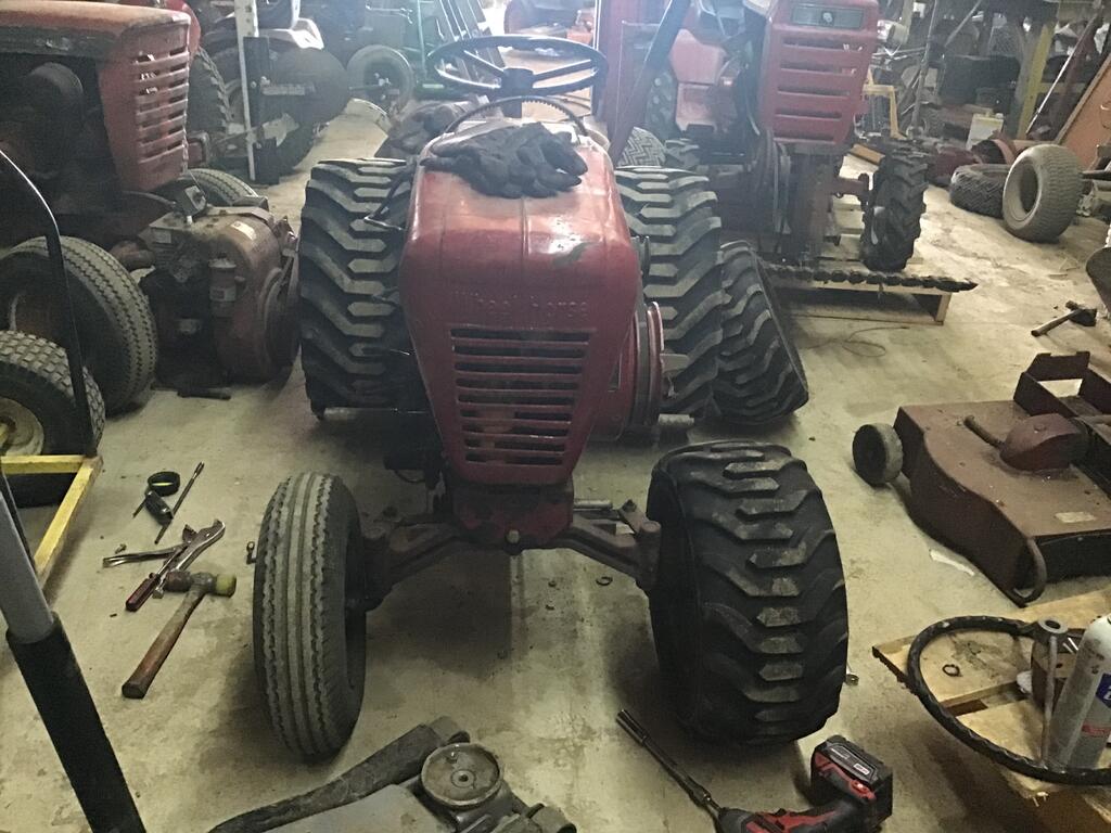

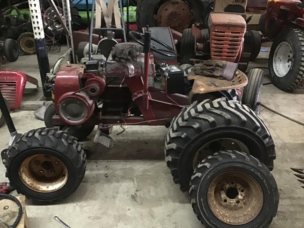

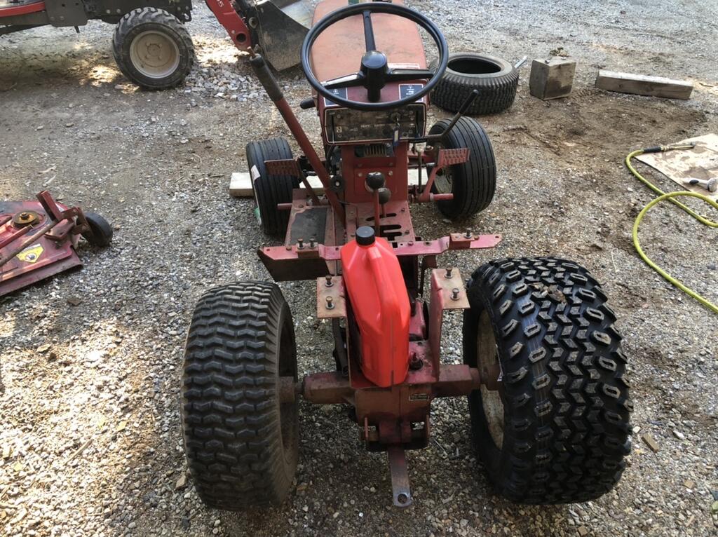

Lee1977 7,756 #32 Posted July 30, 2020 2 hours ago, pullstart said: @Lee1977 runs ATV tires, he needed to lift his rear fender a bit to clear but I believe he’s got 27” meats on there? 24’s should do just fine. Most people go with a 23x10.5-12 and it looks good. I can tell you a 26x12-12 is going to be trouble for ya! They are 25 x 900 x 12 Alltrail II . That is a 520 beside it with 24 x 9.50 x 12 Turf Masters. 1 Share this post Link to post Share on other sites

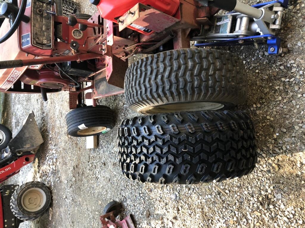

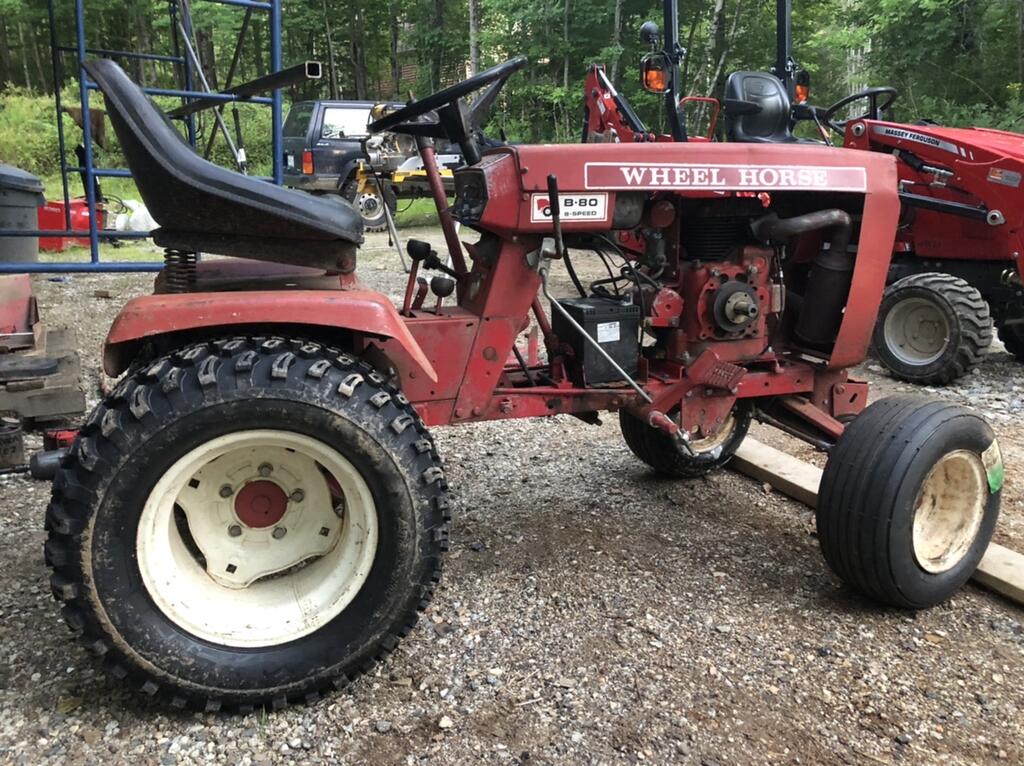

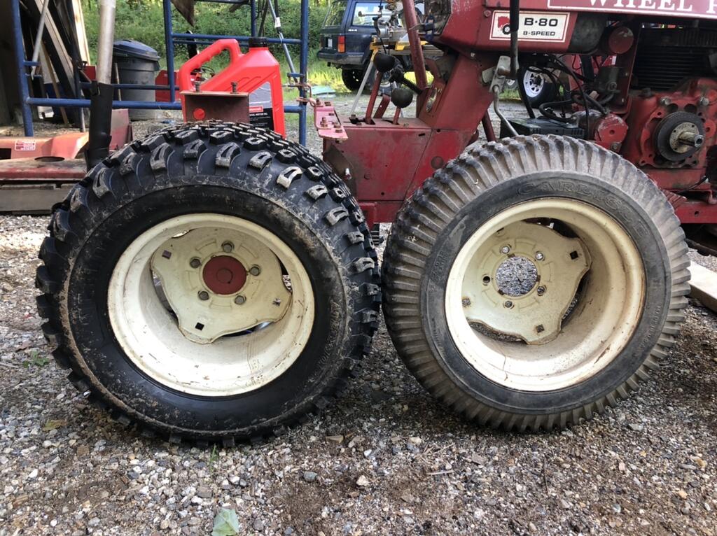

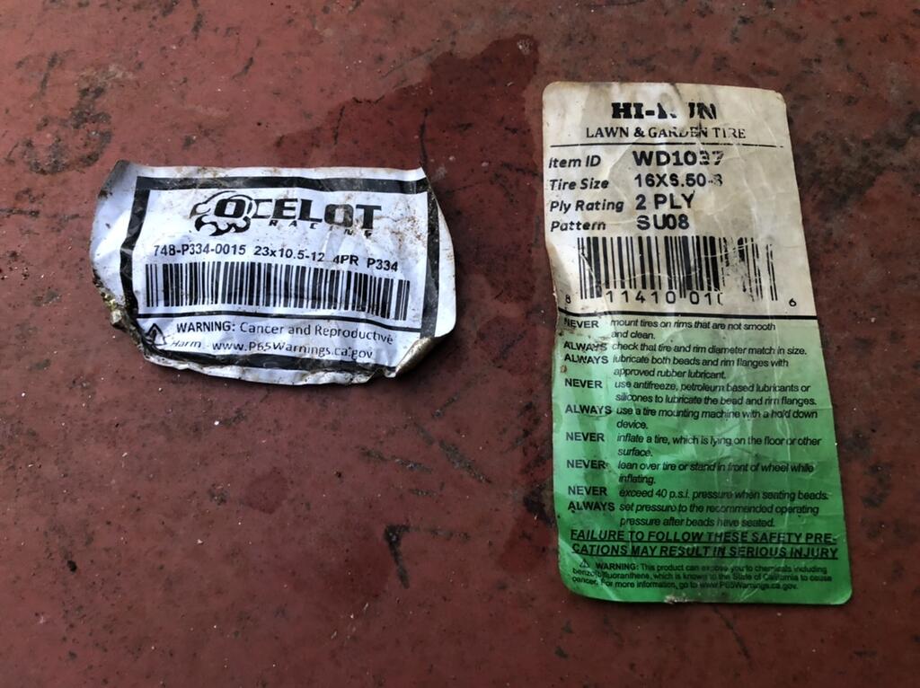

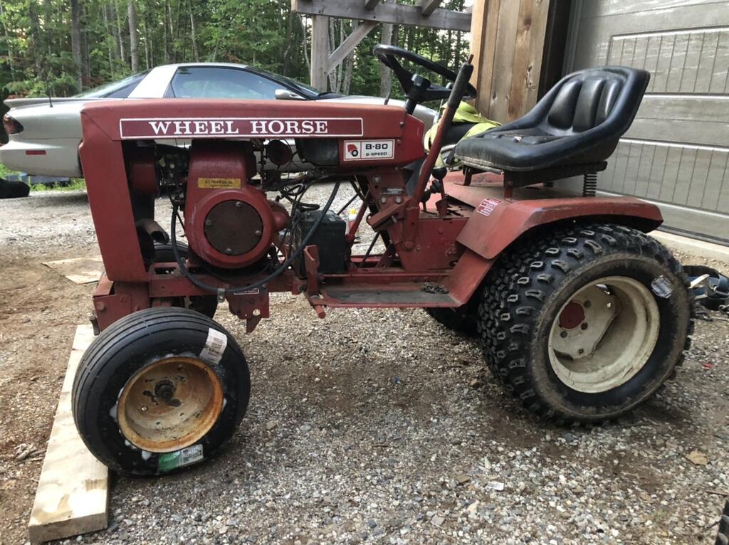

Richcz28 24 #34 Posted August 7, 2020 I got my new rear tires in and mounted up. They are 23x10.5r12s. I couldn’t have stuffed any more in there without modifying the fenders. I’m real happy with them. 2 Share this post Link to post Share on other sites
ebinmaine 80,465 #35 Posted August 7, 2020 I like em!!! 1 Share this post Link to post Share on other sites
sgtsampay 166 #36 Posted August 10, 2020 On 7/30/2020 at 7:27 PM, Lee1977 said: They are 25 x 900 x 12 Alltrail II . That is a 520 beside it with 24 x 9.50 x 12 Turf Masters. Hey sir, your solution with the rear electric winch is great looking. It gives me ideas for when I get a tiller. Thanks! 1 Share this post Link to post Share on other sites
