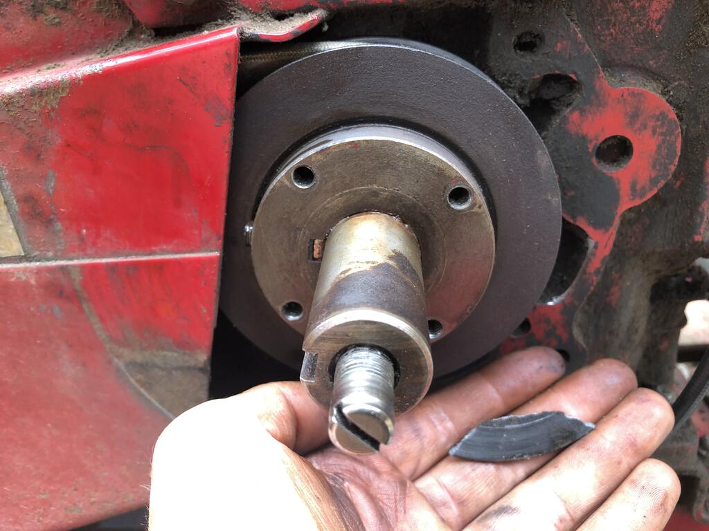

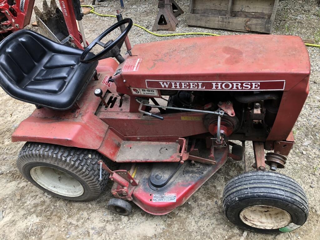

Richcz28 24 #1 Posted July 26, 2020 (edited) Hi Wheel Horse People, I picked up a new to me 1977 B-80 last night. As a kid, I spent a many hours behind the wheel of a 1967 Wheel Horse. I've always wanted my own. When my shifter lever broke off my constantly failing Craftsman two days ago, I took to the Craigslist. As luck would have it, there was a Wheel Horse for sale within an hour of my home. I don't know much about the different models, but I think the B-80 is going to be perfect for me. It has the 3 speed manual trans with high and low range. I'm excited to have a real gear box. The tractor is mostly original. I think the carburetor is a replacement unit and the mower deck is definitely newer. The deck has warning stickers that just look way too safe for 1977. The B-80 will mainly be serving duty as a lawnmower and wagon puller. I have a bigger Massey-Ferguson for heavy lifting. I think the deck on this unit is 38" which should be perfect for my lawn with many trees. The tractor does run and drive, but it has a few issues to work out. I replaced the front tires last night when I got her home. The previous owner had picked up some new units, but they weren't installed. The fronts are now tubeless and even hold air! Unfortunately the wheel bearings are a mess and there is an assortment of washers and different snap-rings on the front spindles. I'd like to get some new bearings up front and have the correct order of parts. The PTO clutch for the mower deck is not engaging. I pulled the pulley off and there also was some odd washers and snap rings holding this together. A really neat washer with roller bearings inside was hiding in the grease of the pulley. I believe I found where it rides. Again, I'd like to replace the bearings here and get everything in the proper order. The 8hp Kohler, which I believe to be original, runs smooth at high rpm. At low rpm it doesn't hold idle and makes some bad noises. It sounds like it could be piston slap, but I'm not a master of small engines. Future projects will include new rear tires, lights and a small stack with the quietest muffler I can come up with. -Rich Edited July 26, 2020 by Richcz28 7 1 Share this post Link to post Share on other sites

ebinmaine 81,048 #3 Posted July 26, 2020 From another Mainer!! Where are you located? You'll love that B80. That model was/is my first horse and we have several others now. Lemme know what you need for the front end as I have a couple spare axles. The most quiet way to add a stack is to use a cub muffler turned upwards. That's what's on my own B80 and sounds great. 1 Share this post Link to post Share on other sites

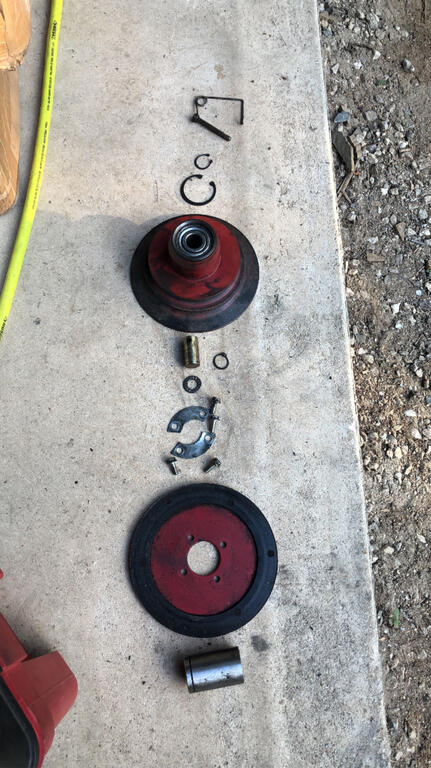

Richcz28 24 #5 Posted July 26, 2020 Well, I broke my first part. I’ve been trying to gently move the PTO pulley a little further off the engine after doing some reading on here and I cracked the pulley. I was hoping to move the pulleys closer together to get better pto engagement. i loosened the Allen set screws up, and I thought she’d slide back easily. I may be doing something incorrect, but the pulley looked like it had been move backwards. The belt needs replacement, so I know I’ll be opening this side up anyways. Now to source a replacement. 2 Share this post Link to post Share on other sites
ebinmaine 81,048 #6 Posted July 26, 2020 I'm in South Hiram a little over an hour south of you. @JCM and @Stepney are fellow neighbors, sort of. I'm not sure how to remove that pulley with the PTO stuff there. None of ours have that PTO in place. Perhaps the manual section or another member could help you out. I don't have a spare pulley. Parts can be had from our own members via a want ad in the classifieds or by calling Lincoln at A to Z tractor in PA. When you get to tearing into the spindles post a pic or two of what ya need. It's highly likely I'll have those. 2 Share this post Link to post Share on other sites

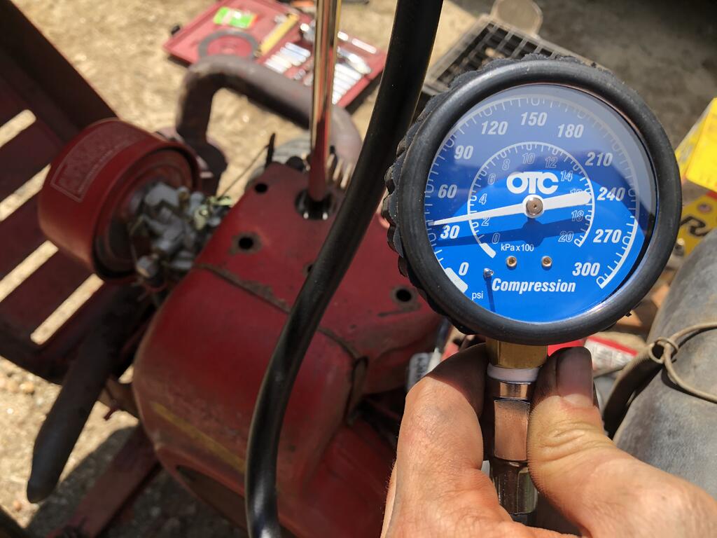

Richcz28 24 #8 Posted July 26, 2020 I did a compression test for kicks. She’s got about 35 psi. I’m guessing this isn’t very good, but I don’t know these engines. Share this post Link to post Share on other sites

ebinmaine 81,048 #10 Posted July 26, 2020 29 minutes ago, Richcz28 said: I did a compression test for kicks. She’s got about 35 psi. I’m guessing this isn’t very good, but I don’t know these engines. Can't do a usable compression test on these because that Kohler has a compression release to ease starting. A leak down test is the way to check it. 4 Share this post Link to post Share on other sites

Stepney 2,356 #17 Posted July 27, 2020 Those pulleys are always seeming to break. I'm in Maine too as Eric mentioned, Ill dig around I may actually have a 1" crank WH pulley off a Briggs WorkHorse i dismantled a while back. The long flathead screw and the spring arrangement inside that PTO was actually part of the thrust brake to stop the deck fast in the OSHA days. They almost always have fallen apart now and the PTO will work fine without it. I remove them so they cant fragment. Nice machine. I like the 8hp models. Looks like your PTO adjustment was out of threads. Bet anything that pulley slid inward on the crank and threw the clutch out with it. 1 Share this post Link to post Share on other sites

Richcz28 24 #19 Posted July 27, 2020 The pulley definitely moved inwards. There is wear on the engine block. I think some of the spring setup is gone at this point. I’ll attach a picture of what was inside in order. I had a good chat with the Wheel Horse parts website in the venders section. They have some bearings for the front axles and a few other parts I may need. It sounds like it could be a bit cheaper than Parts Tree. I’ll know more this evening. -Rich 2 Share this post Link to post Share on other sites
