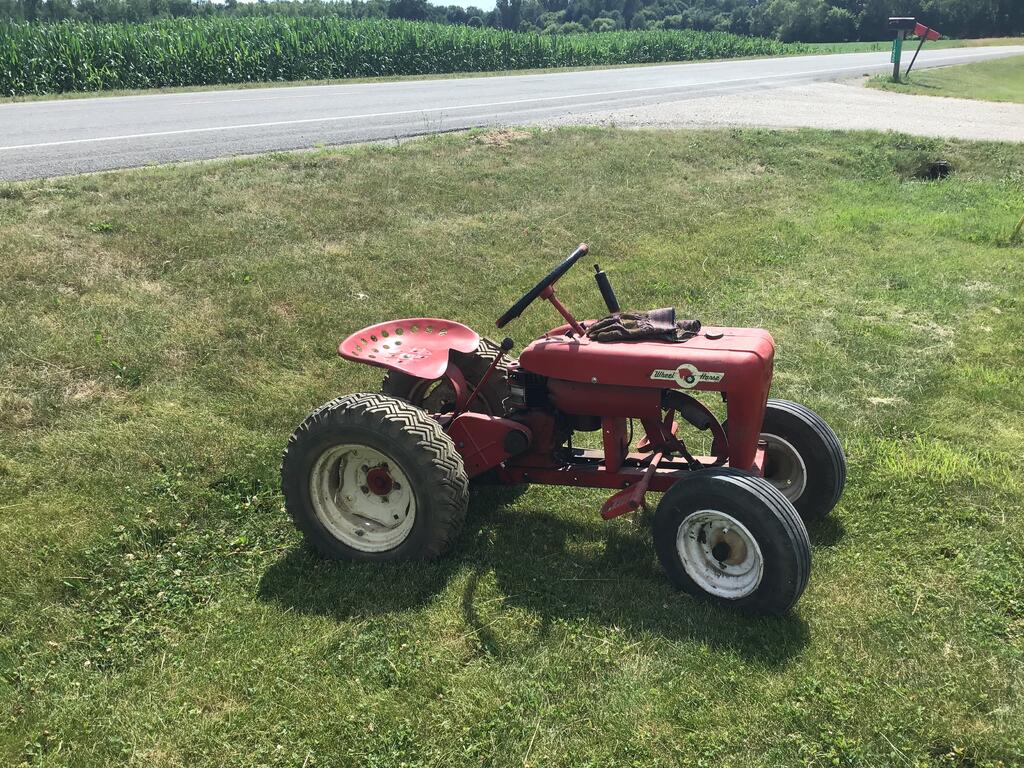

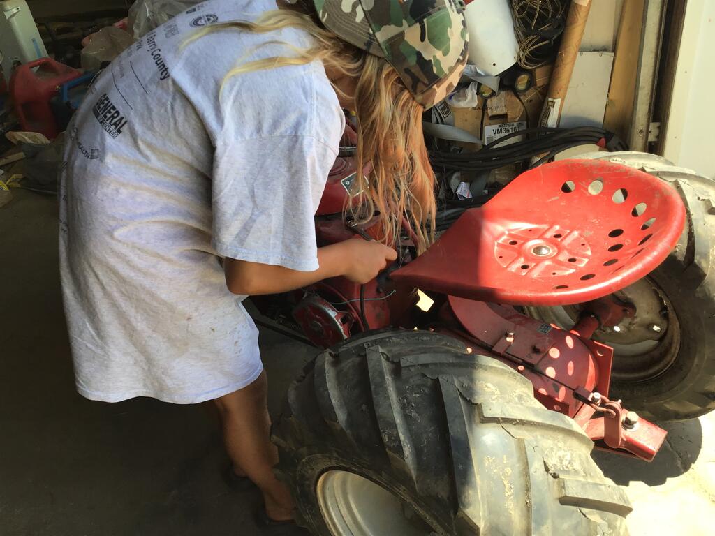

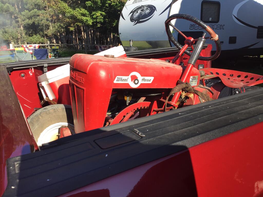

Pullstart 68,853 #1 Posted July 13, 2020 So, Rylee worked her tail off doing all Jim’s dirty work. She ran the disc, ran the drag, swapped a battery, who knows what else she ran around doing... I traded child labor and some 701 gear to him and we tugged it back to Michigan! I pulled this in the shop last night and tugged a couple times. The Clinton engine didn’t cough or anything, so I started by checking spark. I’ve got nothing. I’ll have to grab a manual here and see what it takes to make fire in the hole! 5 9 4 Share this post Link to post Share on other sites

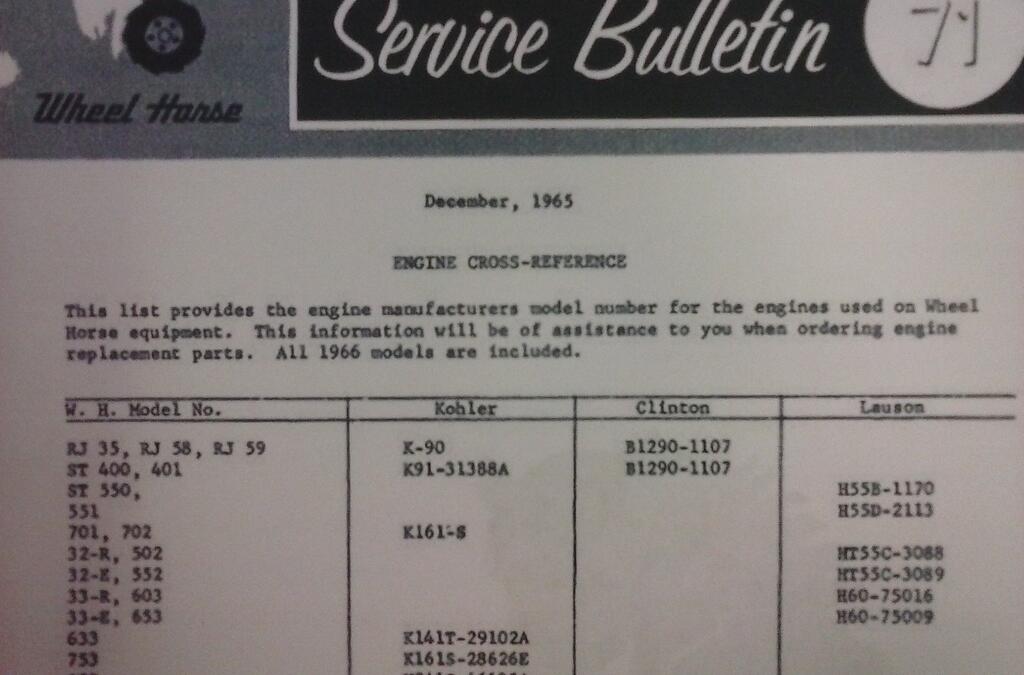

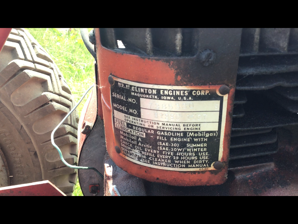

oldiron613 584 #10 Posted July 13, 2020 (edited) Congrats @pullstart! That's actually a pretty rare (and original) tractor your daughter has. I'm 100% positive that Clinton is the original engine to that tractor. The 1107 spec # on the engine s a Wheel Horse sepc. There is a very small handful of 400's and early 401's that got left-over 1959 Clinton B1290 engines which I have one of and the Clinton serial # on yours is only 8 numbers from mine. Of the known Clinton powered 401's also, none have fenders which makes me think that these were probably lesser expensive "economy" models that had the left over Clinton engines without fenders. So, if you still want to swap the engine for a Kohler which I personally wouldn't do as much as I like Kohler's myself, keep that original Clinton on the shelf... or sell it to me. Rob Edited July 13, 2020 by oldiron613 3 2 3 Share this post Link to post Share on other sites
Pullstart 68,853 #11 Posted July 13, 2020 34 minutes ago, oldiron613 said: Congrats @pullstart! That's actually a pretty rare (and original) tractor your daughter has. I'm 100% positive that Clinton is the original engine to that tractor. The 1107 spec # on the engine s a Wheel Horse sepc. There is a very small handful of 400's and early 401's that got left-over 1959 Clinton B1290 engines which I have one of and the Clinton serial # on yours is only 8 numbers from mine. Of the known Clinton powered 401's also, none have fenders which makes me think that these were probably lesser expensive "economy" models that had the left over Clinton engines without fenders. So, if you still want to swap the engine for a Kohler which I personally wouldn't do as much as I like Kohler's myself, keep that original Clinton on the shelf... or sell it to me. Rob Rob, I’ll see what it takes to get the Clinton going, for sure. I love Kohlers as much as the rest of y’all, but if it ain’t broke I’ll keep the hammer in the tool box this time! It won’t take too much to pop the flywheel off and get the points cleaned up. 6 1 Share this post Link to post Share on other sites
WHX?? 54,891 #12 Posted July 13, 2020 1 hour ago, oldiron613 said: early 401's that got left-over 1959 400's I knew this to be true and just figured that by '61 this would no longer be true or they would have used up all the left over 1290's. This is also the first Clinton powered 401 I have saw. I was also not aware that they offered a "budget" model without the fenders too. I suppose they could have been dealer added as an option. Thanks for the schooling Rob. That 400 next to my RJ is an early 400 and never had fenders. Careful of those big meats Kev ....the keyways/woodruffs maybe marginal at this point without further tranny investigation or love. Check the setscrews. You also do not want that axle to start digging into the axle tube just the much softer replaceable bushing. Score the axle you might be done. One of the reasons I quit running her and laid her up. 4 1 Share this post Link to post Share on other sites
oldiron613 584 #13 Posted July 13, 2020 (edited) 5 minutes ago, WHX24 said: 400's I knew this to be true and just figured that by '61 this would no longer be true or they would have used up all the left over 1290's. This is also the first Clinton powered 401 I have saw. I was also not aware that they offered a "budget" model without the fenders too. I suppose they could have been dealer added as an option. Thanks for the schooling Rob. That 400 next to my RJ is an early 400 and never had fenders. You bet Jim. I've only seen 3 or 4 factory Clinton powered 401's which all fall into a close serial number range. This one pictured is the one I have that's 8 serial numbers off from Rylee's. The 1290B is shown in WH documentation I've seen as an avaliable engine for the 401. I've never seen any documentation on a "budget model" but just think that none of Clinton powered 400 or 401's I've seen so far having had fenders is more than a coincidence. Just my theory anyway. Edited July 13, 2020 by oldiron613 3 4 Share this post Link to post Share on other sites

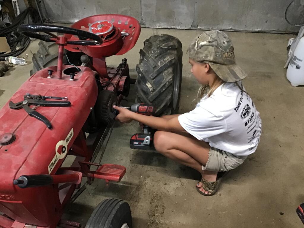

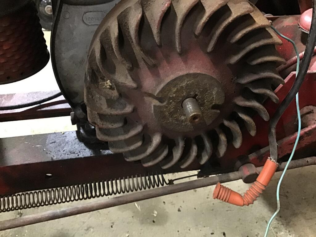

Pullstart 68,853 #23 Posted August 22, 2020 “Daddy, Jada won’t play with me, can I watch a movie?” ”Want to work on your tractor?” And here we are! We need to pull the flywheel and clean the points. 1 3 1 1 Share this post Link to post Share on other sites
WHNJ701 4,169 #24 Posted August 22, 2020 4 minutes ago, pullstart said: “Daddy, Jada won’t play with me, can I watch a movie?” ”Want to work on your tractor?” And here we are! We need to pull the flywheel and clean the points. Nice, my 8 year old wet sanded a hood tonight, he asked what can I do help get parts ready for paint tommorow, he wants this commando done more than me 1 1 1 3 Share this post Link to post Share on other sites
Pullstart 68,853 #25 Posted August 22, 2020 Ok, any input on how a flywheel with no tapped holes comes off? Big jaw puller on the outside? Share this post Link to post Share on other sites
