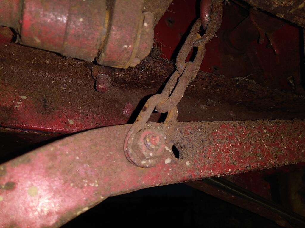

Dan.gerous 2,696 #28 Posted June 23, 2020 This is the lift chain that either needs shortening or a solid bar added. Share this post Link to post Share on other sites
ebinmaine 80,957 #29 Posted June 23, 2020 2 minutes ago, Dan.gerous said: This is the lift chain that either needs shortening or a solid bar added. Given the option I'd do the solid bar. We use it for moving dirt once in awhile but mostly it's for scraping the snow a little bit deeper during the winter. We have a dirt driveway so things tend to get compacted and it's nice to be able to give it that little extra oomph to clean things. 1 Share this post Link to post Share on other sites

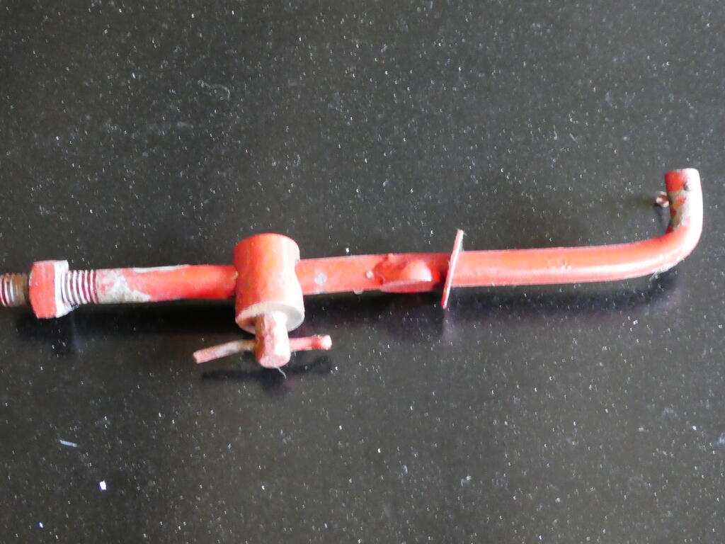

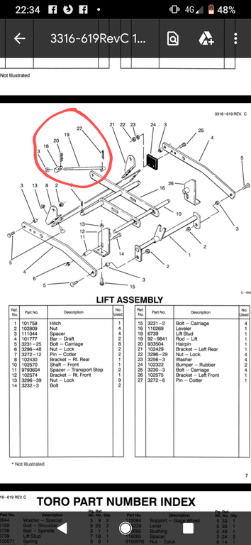

Dan.gerous 2,696 #30 Posted June 23, 2020 @Stormin I don't suppose you have the part circled in red? A measurement of it would be handy as no idea how long it should be, or happy to buy it and it's associated little bits😊 Share this post Link to post Share on other sites
Dan.gerous 2,696 #31 Posted June 23, 2020 5 minutes ago, ebinmaine said: Given the option I'd do the solid bar. We use it for moving dirt once in awhile but mostly it's for scraping the snow a little bit deeper during the winter. We have a dirt driveway so things tend to get compacted and it's nice to be able to give it that little extra oomph to clean things. Do you still have the rubber strip on the bottom or do you use a sacrificial steel strip for grading the driveway? The rubber is great on the tarmac and concrete but it lacks the bite of a solid edge when pushing the dirt/gravel/mud in the courtyard. Share this post Link to post Share on other sites

Stormin 9,988 #36 Posted June 23, 2020 I'll look for that rod tomorrow, Dan. As for the plough/dozer blade, I'm the same as Eric. Both that and my mid mount grader have sacrificial strips. 1 1 Share this post Link to post Share on other sites

Stormin 9,988 #40 Posted June 24, 2020 Here you are Dan. Yours if you want it. 2 Share this post Link to post Share on other sites

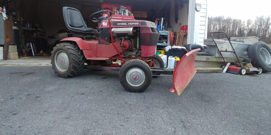

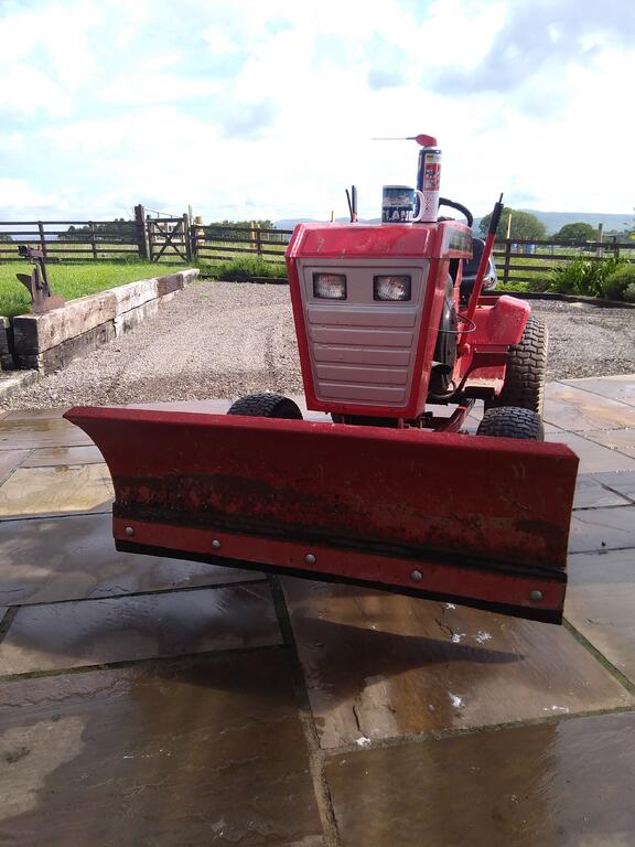

Dan.gerous 2,696 #44 Posted June 24, 2020 @ebinmaine @Stormin I did the quick fix for now and shortened the chain. Was playing around with the blade angle as it was in the furthest back position, when I put it several positions closer to vertical the ground clearance reduced to 0! The short chain has given me a couple of inches clearance so I can use the wheelhorse with the trailer and blade now. I noticed while playing about under there that the lift mechanism has another arm on it, wonder what that's for? Share this post Link to post Share on other sites
Dan.gerous 2,696 #45 Posted June 24, 2020 Forgot to mention it slightly fouls the steering arm with the shorter chain when you pick it up. Probably just needs a spacer to keep it slightly more to the side. Share this post Link to post Share on other sites
ebinmaine 80,957 #46 Posted June 24, 2020 I don't have any implement other than the plows so I don't know what that extra arm would be for. Because of the very rough terrain that I live on I needed to get the maximum lift that I could from my plow. When I made the brackets for the rear axle I also lowered the attaching point about an inch. Combining that with appropriate placement of the new lift point in the middle, when I lift the plow it sometimes touches the front of the frame. but I don't have an attach a matic or mule drive or anything like that. 1 Share this post Link to post Share on other sites
WVHillbilly520H 10,379 #47 Posted June 24, 2020 To gain moldboard height when lifted you need to add spacers to the rear axle plow attach... 3 Share this post Link to post Share on other sites
Dan.gerous 2,696 #48 Posted June 24, 2020 31 minutes ago, ebinmaine said: I don't have any implement other than the plows so I don't know what that extra arm would be for. Because of the very rough terrain that I live on I needed to get the maximum lift that I could from my plow. When I made the brackets for the rear axle I also lowered the attaching point about an inch. Combining that with appropriate placement of the new lift point in the middle, when I lift the plow it sometimes touches the front of the frame. but I don't have an attach a matic or mule drive or anything like that. I also notice that other lever for altering the plow angle stops the brake pedal from depressing fully.... Spacer on the rear axle bracket send the next thing to do, I have the same problem with ground clearance around the farm. Ideally want to keep the plow on as much as possible until I buy another house to tow the trailer. 1 Share this post Link to post Share on other sites
WVHillbilly520H 10,379 #49 Posted June 24, 2020 1" blocks netted me nearly 2" higher lift at the cutting edge. 3 Share this post Link to post Share on other sites
Dan.gerous 2,696 #50 Posted June 24, 2020 58 minutes ago, WVHillbilly520H said: 1" blocks netted me nearly 2" higher lift at the cutting edge. I have found some spacers and removed the bracket, just need to find some longer bolts now. Might see if I can get bigger spacers as mine are only about half inch. 2 Share this post Link to post Share on other sites
