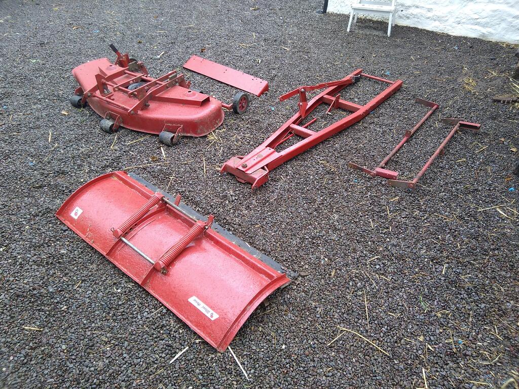

Dan.gerous 2,696 #1 Posted June 21, 2020 Well, as I mentioned in my other thread about ploughs, we picked up the Snow plow yesterday just to the south of London. It was a bit of a trip, ended up on the road for 18 hours when you factor in food and tea breaks. While there I also brought the side discharge deck that he had available - it seemed silly to travel all that way and just bring back one item! Also got a free box of bits 😁 I think there is part of the rear attachment bracket, but no quick release clips. I'm sure you guys can identify all the parts in the photos... 6 2 Share this post Link to post Share on other sites

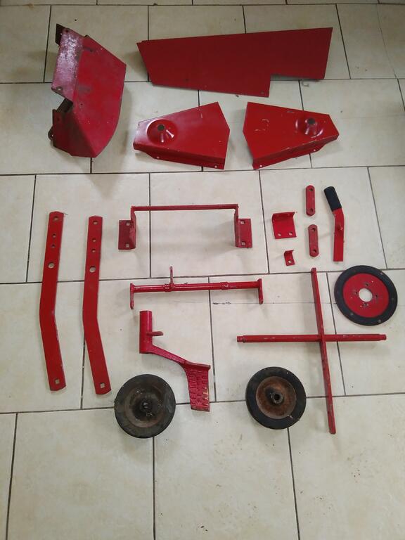

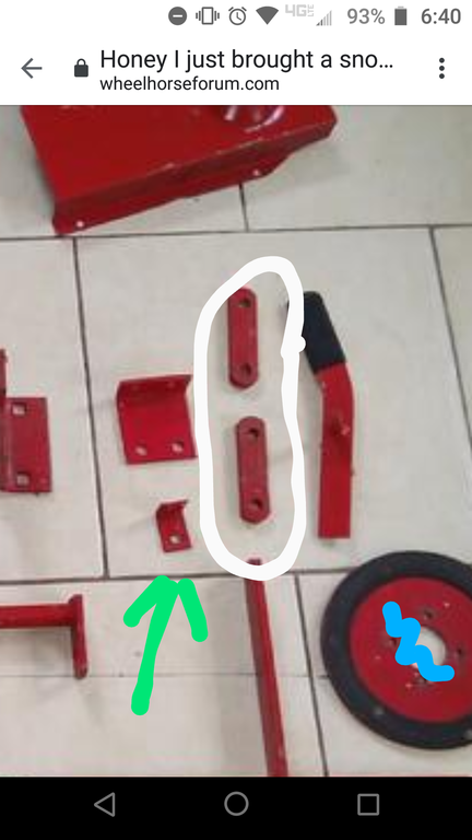

ebinmaine 80,957 #2 Posted June 21, 2020 Nice purchase! You're correct about the bracket. It's the part in the center of the lower pic. Release levers can be made up fairly easy. The top pieces of the bracket are just to the right. 1 Share this post Link to post Share on other sites
Dan.gerous 2,696 #3 Posted June 21, 2020 8 minutes ago, ebinmaine said: Nice purchase! You're correct about the bracket. It's the part in the center of the lower pic. Release levers can be made up fairly easy. The top pieces of the bracket are just to the right. That's even better, I didn't realise the little bits are part of it as well. Well have to have a look at my other bracket and see how the release units work. Thanks for the information 😁 1 Share this post Link to post Share on other sites
ebinmaine 80,957 #4 Posted June 21, 2020 In white are the bracket tops. Blue squiggle marks a clutch plate I think. Those are worth a bit and Handy to have when yours wears out. Green arrow is pointing to what may be the tab at the idler pulley. The rest, others will be able to help with. Various mower parts I believe... 1 Share this post Link to post Share on other sites
Ed Kennell 47,608 #5 Posted June 21, 2020 Nice haul. In addition to the missing clips for the axle bracket, the deck is missing the leveling rod that connects the rear wheel assembly to the carriage assembly. It appears the plow frame is missing one of the three rods required to connect the blade. 2 Share this post Link to post Share on other sites
Dan.gerous 2,696 #6 Posted June 21, 2020 46 minutes ago, Ed Kennell said: Nice haul. In addition to the missing clips for the axle bracket, the deck is missing the leveling rod that connects the rear wheel assembly to the carriage assembly. It appears the plow frame is missing one of the three rods required to connect the blade. I might be able to source the missing deck party from one of my old rotten ones. The rods for the blade might be more of an issue, once the rain has gone will have a look at connecting it up and see what else I need - stand by for SOS messages on here! Share this post Link to post Share on other sites
Ed Kennell 47,608 #7 Posted June 21, 2020 The blade rod can be easily made from 1/2" round stock. 2 Share this post Link to post Share on other sites

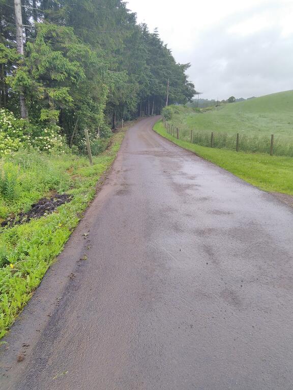

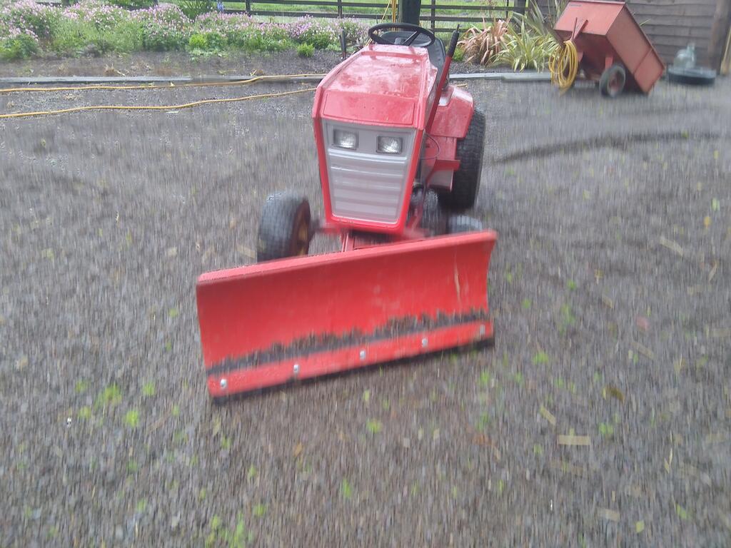

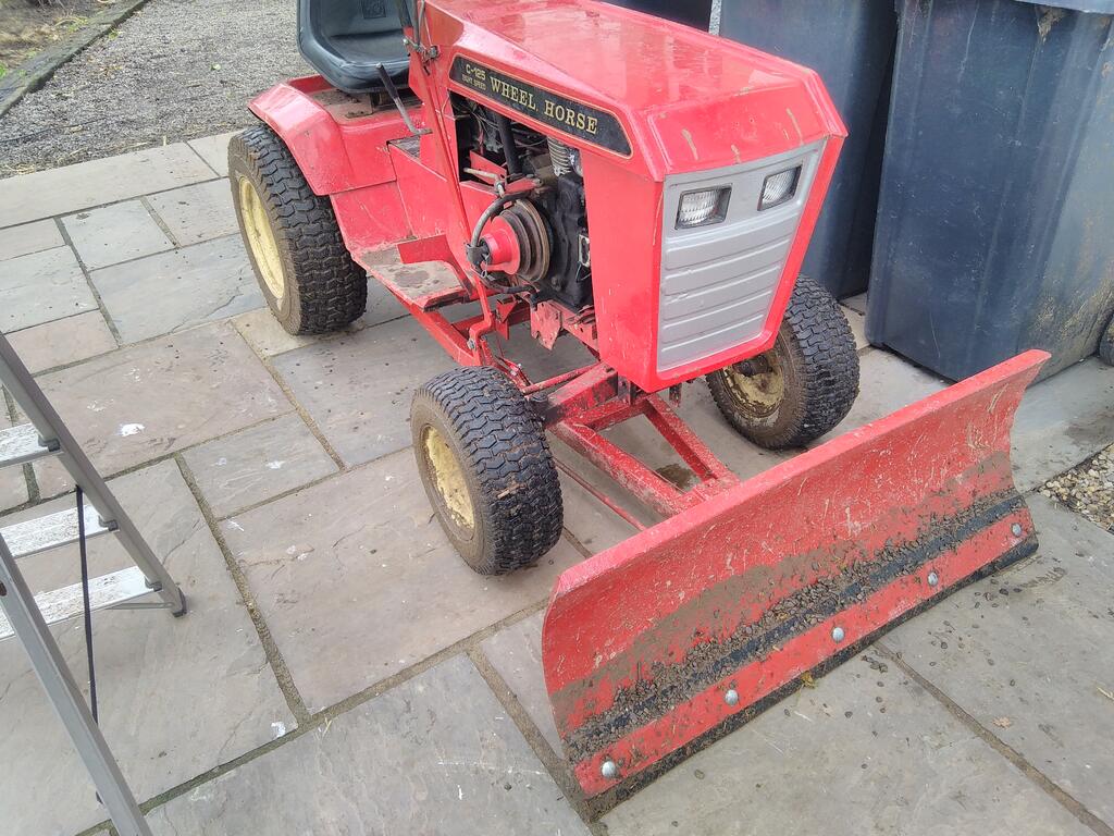

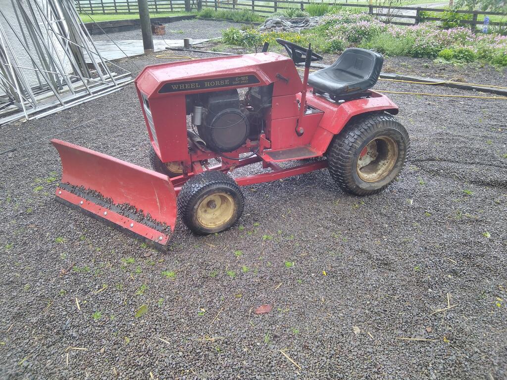

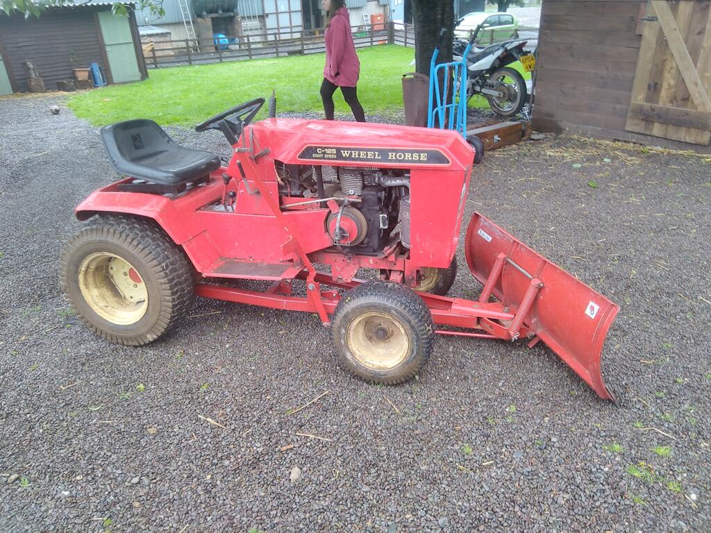

Dan.gerous 2,696 #17 Posted June 23, 2020 Got one of the UK wheelhorse boys to sell me a rear bracket so I could get the snow plow in action. It all works well, playing around on the tarmac drive at the moment moving mud to the edges. Only problem so far is it doesn't lift high enough, will have to see how much adjustment I can get. 2 Share this post Link to post Share on other sites

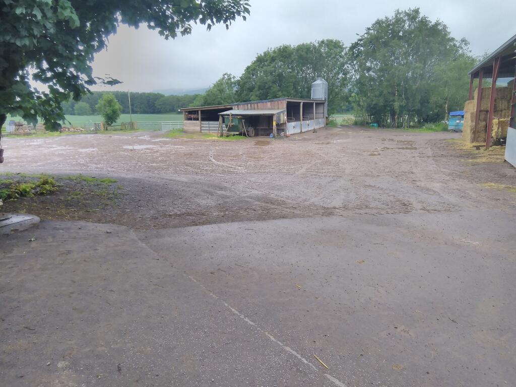

Dan.gerous 2,696 #18 Posted June 23, 2020 Been cleaning up our drive with the snow plow, so much fun 😊 Next stop is the muddy courtyard.... 2 Share this post Link to post Share on other sites
ebinmaine 80,957 #19 Posted June 23, 2020 To get that lift adjustment off you might be able to go with a shorter piece of chain or link that is under there. Another option would be to machine a couple of blocks that go between the bracket and the axle at the rear. Lower the rear, raise the front. 1 Share this post Link to post Share on other sites
Dan.gerous 2,696 #20 Posted June 23, 2020 28 minutes ago, ebinmaine said: To get that lift adjustment off you might be able to go with a shorter piece of chain or link that is under there. Another option would be to machine a couple of blocks that go between the bracket and the axle at the rear. Lower the rear, raise the front. I had a look and it might be possible to go one link shorter on the lift chain. Anymore and it might start fouling the chassis. It just needs to lift an inch or so more at the front as on uneven ground when moving about it touches down occasionally. 1 Share this post Link to post Share on other sites
Dan.gerous 2,696 #21 Posted June 23, 2020 Bedtime after a hard day's pushing dirt about. Next thing to try out is the new mower deck and see what I need for that. Oh, also got offered a GT14 - it looks like a nice machine, might be a good machine for the sweeper when I get it.... 2 Share this post Link to post Share on other sites
ebinmaine 80,957 #22 Posted June 23, 2020 2 minutes ago, Dan.gerous said: I had a look and it might be possible to go one link shorter on the lift chain. Anymore and it might start fouling the chassis. It just needs to lift an inch or so more at the front as on uneven ground when moving about it touches down occasionally. Just as a point of interest you could also Fab up a solid link. That would give you the ability to have down pressure on the blade. 2 Share this post Link to post Share on other sites
Dan.gerous 2,696 #23 Posted June 23, 2020 11 minutes ago, ebinmaine said: Just as a point of interest you could also Fab up a solid link. That would give you the ability to have down pressure on the blade. That's a good idea! I was thinking it didn't push down hard enough and was toying with the idea of adding weight to the blade. 1 Share this post Link to post Share on other sites

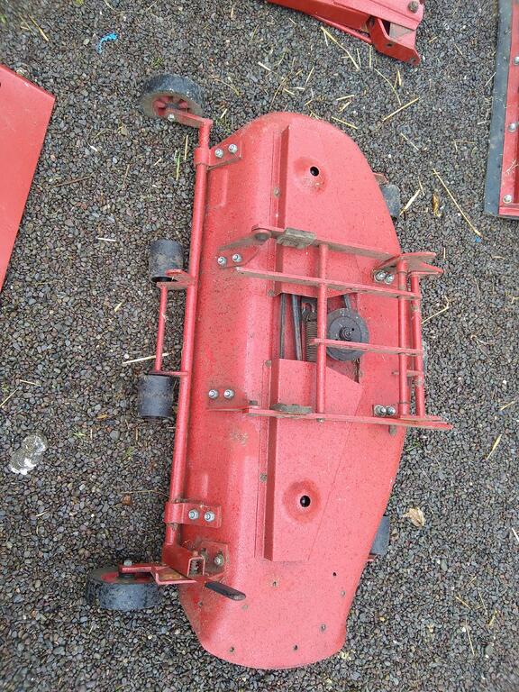

Stormin 9,988 #24 Posted June 23, 2020 Eric just beat me to it. Using the lift handle to apply pressure gives you a feel of what the blades doing. I don't see the blades or spindle housings for that SD deck. Have you got them? 1 Share this post Link to post Share on other sites
Dan.gerous 2,696 #25 Posted June 23, 2020 Just now, Stormin said: Eric just beat me to it. Using the lift handle to apply pressure gives you a feel of what the blades doing. I don't see the blades or spindle housings for that SD deck. Have you got them? Yep the deck is almost all complete apart from an adjuster at the back, have a rod I will adapt tomorrow for that. The spindles are in ok condition but might need to sharpen the blades. Going to have to do that modification to the snow plow, more control will be nice for leveling jobs like our courtyard. Share this post Link to post Share on other sites
