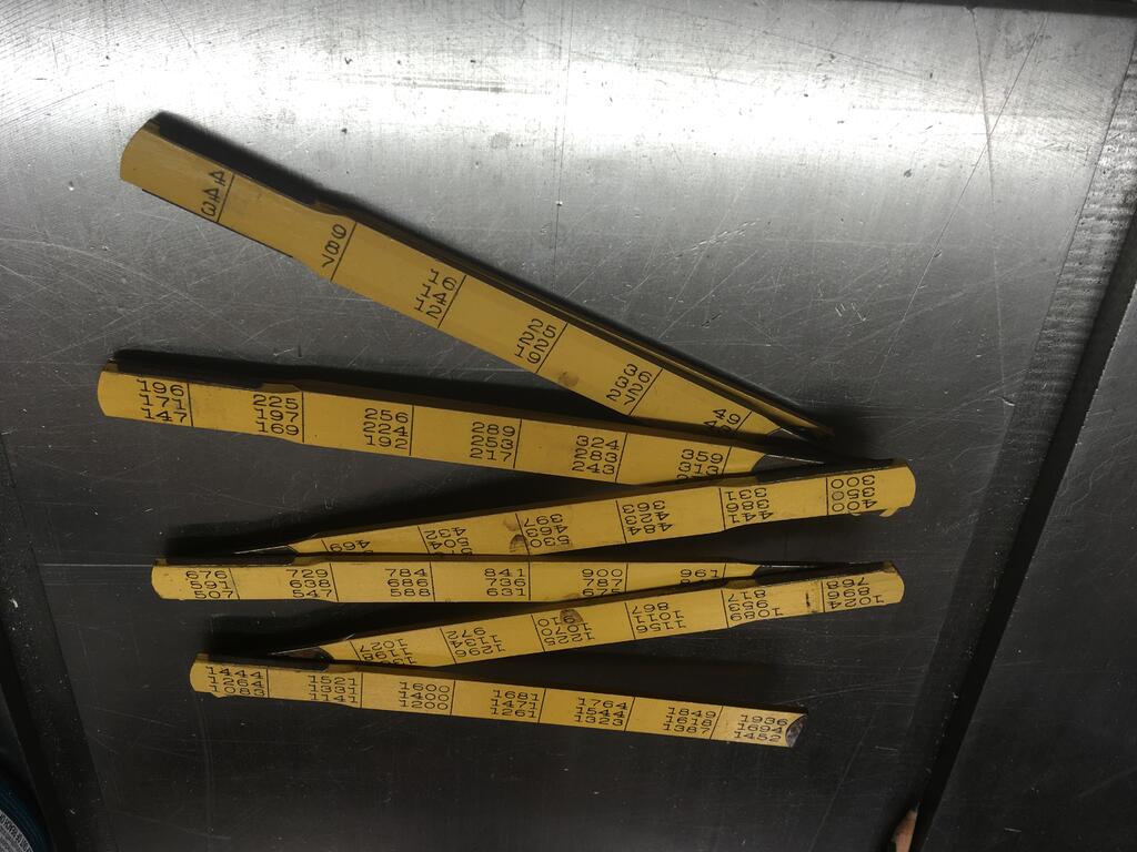

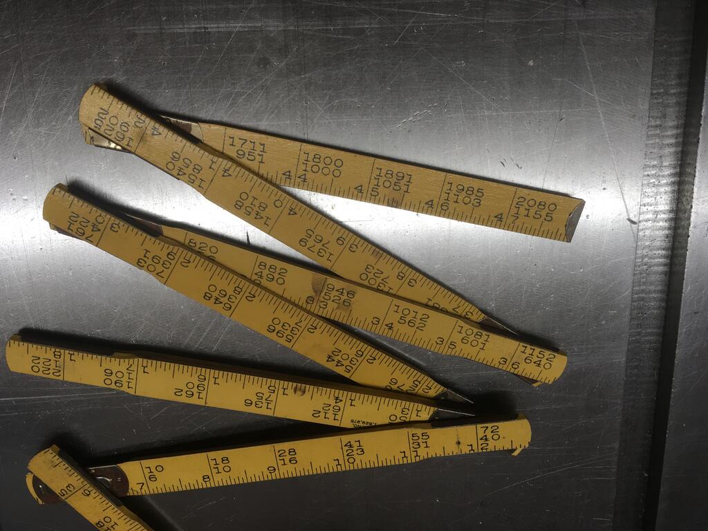

formariz 12,359 #1 Posted June 12, 2020 What kind of ruler is this ? 1 Share this post Link to post Share on other sites
RandyLittrell 3,944 #2 Posted June 12, 2020 Made like a carpenters rule, but I can't figure out the other numbers. Randy Share this post Link to post Share on other sites
squonk 46,198 #3 Posted June 12, 2020 (edited) Yellow folding carpenter ruler. Edited June 12, 2020 by squonk 1 1 1 Share this post Link to post Share on other sites
8ntruck 8,786 #4 Posted June 12, 2020 Used to measure board feet of lumber? 1 Share this post Link to post Share on other sites

The Tuul Crib 7,354 #6 Posted June 12, 2020 I think the other numbers are in millimeters and centimeters ? 1 1 Share this post Link to post Share on other sites
Stormin 9,987 #7 Posted June 12, 2020 That's what I'm thinking. It's the sequence of them that's baffling me. Maths was never my strong point. Share this post Link to post Share on other sites

roadapples 6,987 #9 Posted June 12, 2020 My Dad was a mason. All he ever used. Cement blocks are 16" long. 8, 10, & 12" wide.. 1 1 1 Share this post Link to post Share on other sites
formariz 12,359 #10 Posted June 12, 2020 2 hours ago, 8ntruck said: Used to measure board feet of lumber? Care to elaborate on your answer? Share this post Link to post Share on other sites

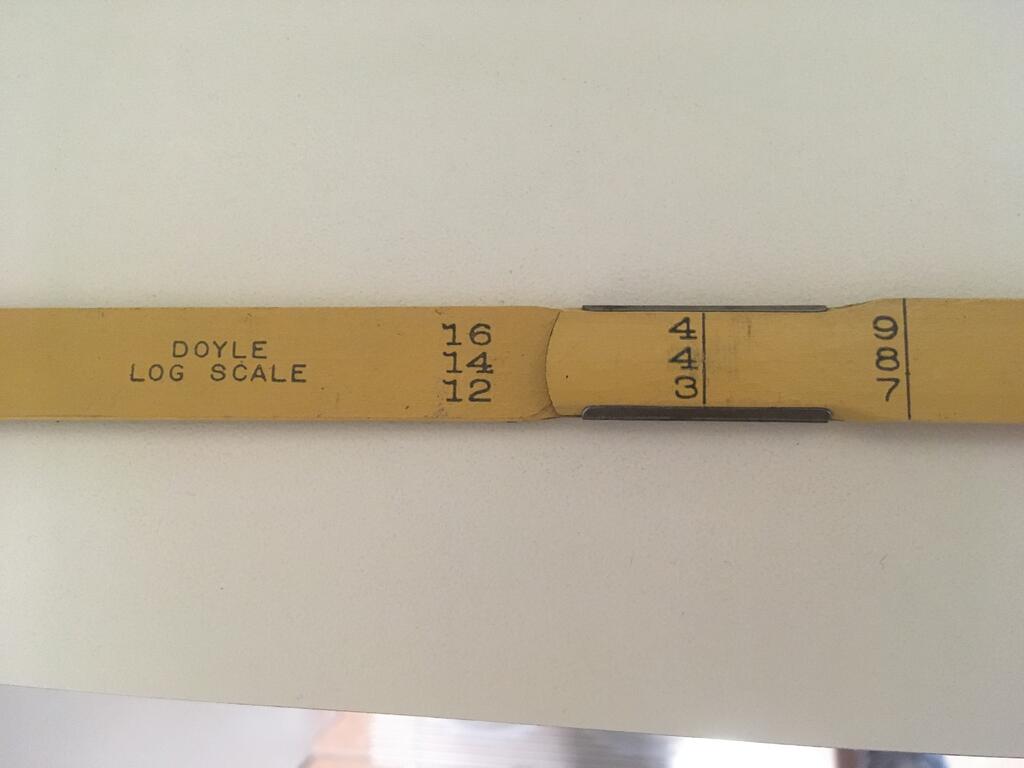

cafoose 3,701 #11 Posted June 13, 2020 1 hour ago, formariz said: Care to elaborate on your answer? I'm not sure which number means which board but if you are measuring the length of a 2x4 one of the numbers is the board-feet for that length. If you are measuring a 1x6 or some other width and thickness you use a different number on the scale that corresponds to the width and thickness of the board you are measuring. For example, the 4 4 3 on the first picture the first "4" is board-feet of an x width and an x thickness board of that length. The middle "4" is the length of a board in board-feet of a board of y width and y thickness. The "3" is the board-feet of a board of the same length with a different width and thickness. I'm not totally sure but I think that's basically how it works. 1 Share this post Link to post Share on other sites

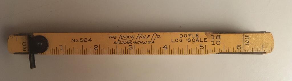

8ntruck 8,786 #12 Posted June 13, 2020 3 hours ago, formariz said: Care to elaborate on your answer? It is a Doyle log rule. It is used to estimate the amount of lumber that can be milled out of a log, based on the diameter of the log. Which scale you read depends on the length of the log. Had to look up the details. Learned something new today! Lufkin still makes these. 1 1 1 Share this post Link to post Share on other sites
formariz 12,359 #13 Posted June 13, 2020 (edited) Correct. Used to determine approximate board feet of lumber in a log prior to milling it. Useful if you are buying or selling logs for lumber. Yes they are still available and made by Lufkin. Its a Lufkin 524.New ones are white in color. This one is vintage and it is yellow which is kind of hard to find. Something that @pullstart may find useful in his new adventure. Edited June 13, 2020 by formariz 2 2 Share this post Link to post Share on other sites

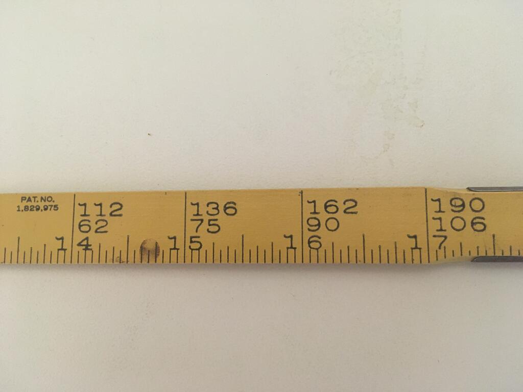

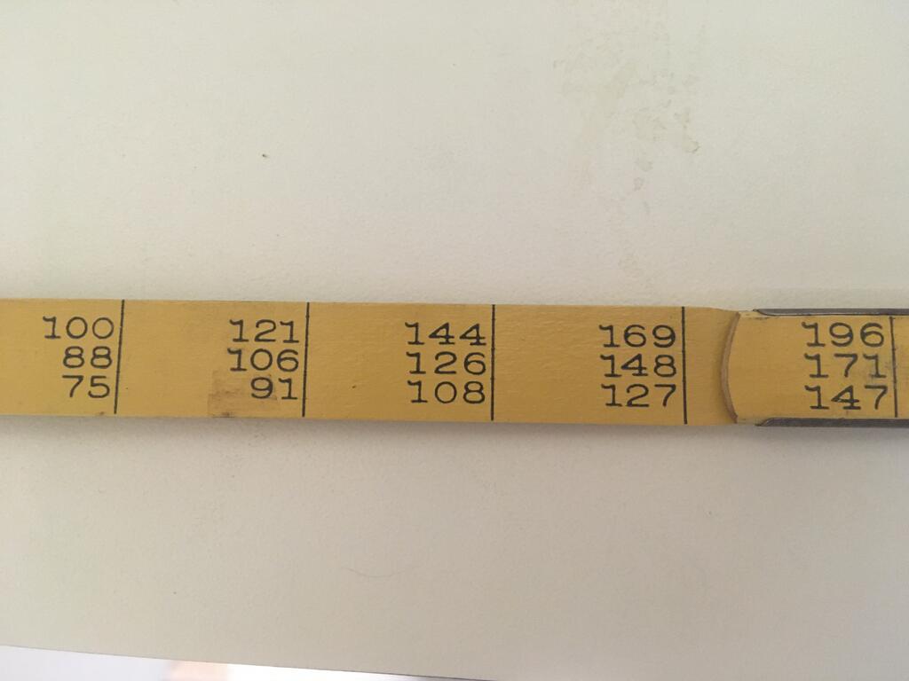

formariz 12,359 #20 Posted June 13, 2020 (edited) Its kind of hard to learn how to use something if it's not in our hands or at least in front of us,and at first glance this ruler looks confusing and complicated but in reality it is very simple.Let me try to explain it a bit. This particular ruler is graduated for logs of lengths 10,18 feet on one side, and 12,14, and 16 feet on the other side. On main side the bottom of ruler reads 1 through 48" like a regular ruler. One uses that to measure log diameter. Log length has to be determined through some other means. On main side above regular graduation, there are two other rows of numbers. With the exception of the first number at left in each row, they are board feet numbers. Same thing on the other side except there are three rows of board feet numbers. The very first three numbers on each row at left side right after it says Doyle Scale are the log lengths this ruler calculates.18 and 10 on main side, and12,14, and 16 on second side. All numbers to the right of vertical lines are board feet numbers.On other side those numbers are to left of same line. So looking at photos below and using a 7" diameter log the numbers right above it to the right of line are6 and 10 board feet. 6 board feet for a 10' log and10 board feet for a18t' log. Flipping ruler to the other side and looking at the same 7" diameter log line there is 7 board feet for a 12', 8 board feet for a 14', and 9 board feet for a 16' log. Using a small diameter log these numbers don't make sense, and that is because this system in this ruler substantially under measures smaller logs. The larger the log diameter the more accurate it is. It is intentional since a smaller log always yields a lot less than expected, so when buying a log it is already accounted for when using ruler Edited June 13, 2020 by formariz 2 1 2 Share this post Link to post Share on other sites
