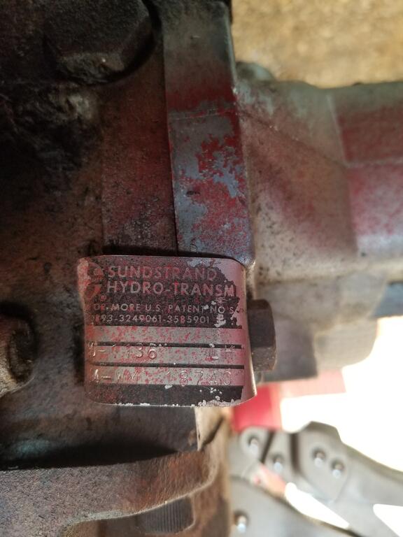

meadowfield 2,955 #26 Posted June 2, 2020 thats a 1971 model - so likely to have had a swap like mine! Share this post Link to post Share on other sites

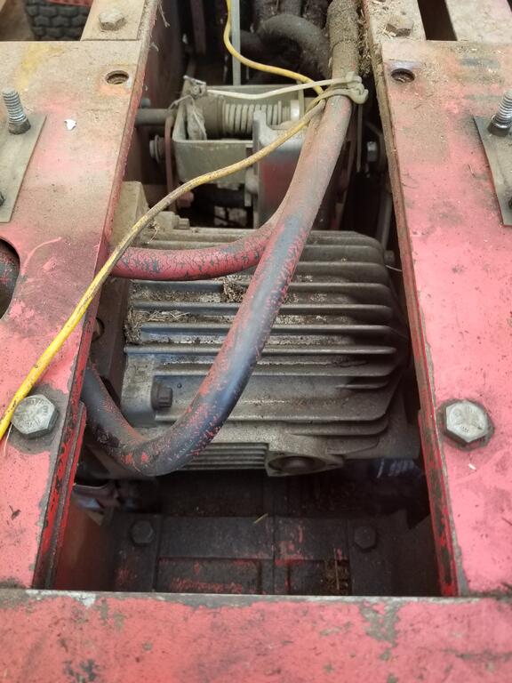

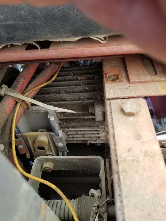

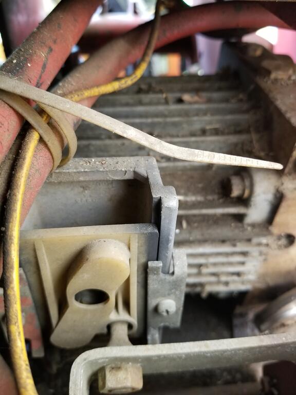

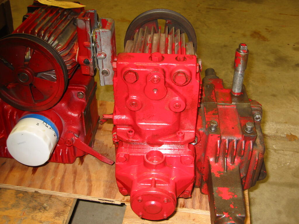

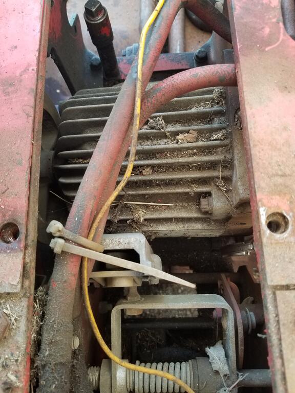

cafoose 3,685 #27 Posted June 2, 2020 28 minutes ago, pfrederi said: Looking at your first picture it looks like a piston to piston not a hydro gear. (Could use a better pic of the hydro motor part to be sure). GT-14s even in 73 didn't come with piston to piston. Guessing yours has been swapped. meadowfield is on the mark your tow valve is a normal screw in screw out valve. many differences between hydro gear and piston to piston Share this post Link to post Share on other sites

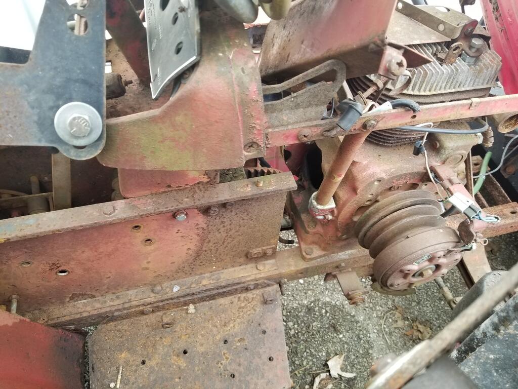

cafoose 3,685 #28 Posted June 2, 2020 @pfrederi @meadowfield more hydro pics with the seat removed Share this post Link to post Share on other sites

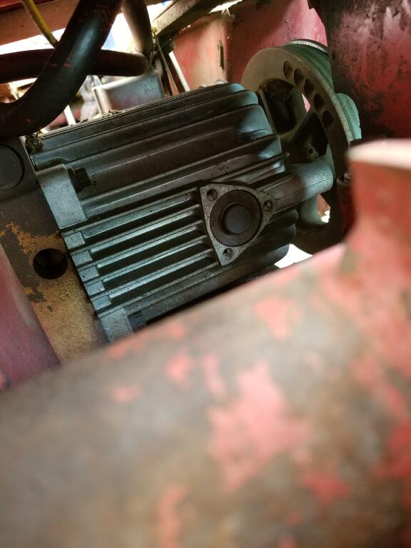

pfrederi 20,210 #29 Posted June 2, 2020 The hydro motor be it gear or piston is on the left side of the transaxle. Looks like figure 8 hydro gear, round end piston to piston. Share this post Link to post Share on other sites
cafoose 3,685 #30 Posted June 2, 2020 2 minutes ago, pfrederi said: The hydro motor be it gear or piston is on the left side of the transaxle. Looks like figure 8 hydro gear, round end piston to piston. Not sure what that means is it original? 1 Share this post Link to post Share on other sites
pfrederi 20,210 #31 Posted June 2, 2020 If it is piston to piston it is not original Does the end of you r hydro motor look like this?? Compare it to the other GT-14 you have... If it does look like this you have a replacement non original system. Inter sting I am not sure how they dealt with the gear mismatch...have to think on that some. Share this post Link to post Share on other sites

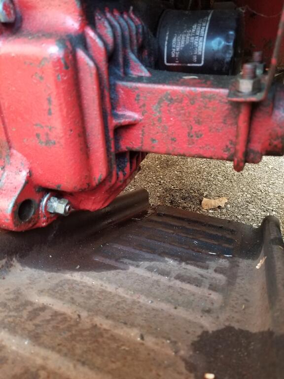

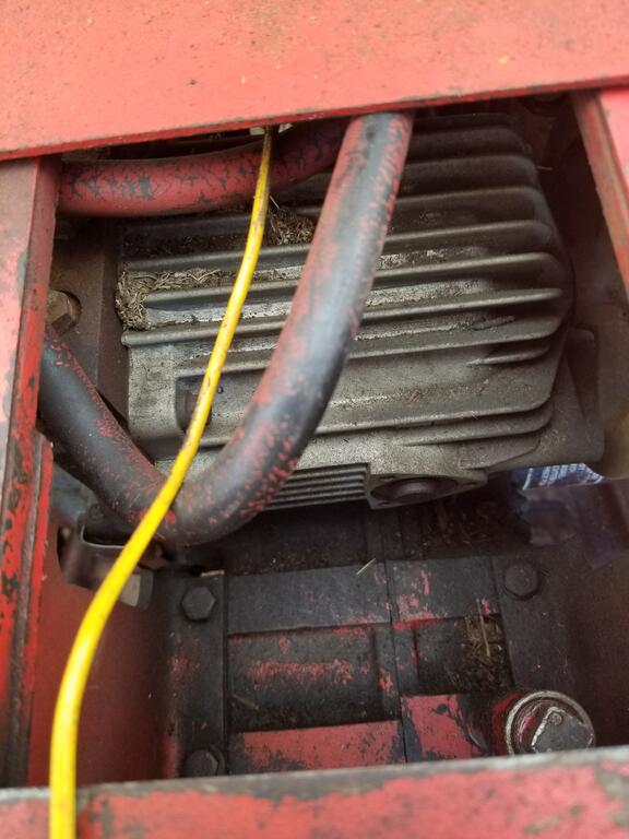

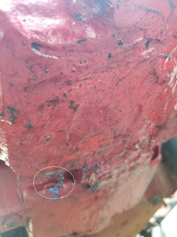

cafoose 3,685 #43 Posted June 3, 2020 (edited) Just went out to drain fluid and saw this on the ramps I left sitting under the tractor. Looks like a leak. Must have leaked when I started it. When you look to the left of the ramp at the bottom back of the fins it looks like it may have been running out from the case gasket? Where is the drain plug? Edited June 3, 2020 by cafoose Share this post Link to post Share on other sites
pfrederi 20,210 #44 Posted June 3, 2020 1 hour ago, cafoose said: Just went out to drain fluid and saw this on the ramps I left sitting under the tractor. Looks like a leak. Must have leaked when I started it. When you look to the left of the ramp at the bottom back of the fins it looks like it may have been running out from the case gasket? Where is the drain plug? Same as all the other Transaxles 1 Share this post Link to post Share on other sites
cafoose 3,685 #45 Posted June 3, 2020 I think I found the leak looks like someone tried to braze or weld it? Notice the blue gasket sealer I guess I'm going to learn how to split a case I have two other GT-14 tractors to choose from for parts. Total of four GT-14 tractors Notice the grenaded block in the third picture 1 Share this post Link to post Share on other sites
Ed Kennell 45,630 #46 Posted June 3, 2020 Woops, looks like you may need 4 GTs to make 1 or 2. The good news ….you found a leak and saved a filter and 5 qts. of oil. 1 1 Share this post Link to post Share on other sites
pfrederi 20,210 #47 Posted June 3, 2020 Rather than mess with this one I would look at one of you parts tractors for a rear end transplant. The braising/welding would worry me. 1 Share this post Link to post Share on other sites
cafoose 3,685 #48 Posted June 3, 2020 (edited) 6 minutes ago, Ed Kennell said: Woops, looks like you may need 4 GTs to make 1 or 2. The good news ….you found a leak and saved a filter and 5 qts. of oil. Also going to gain some experience working on a hydro plus it will keep me out of trouble during the pandemic Pick'em up cheap no matter what condition if nothing else lots of parts Edited June 3, 2020 by cafoose 2 Share this post Link to post Share on other sites
