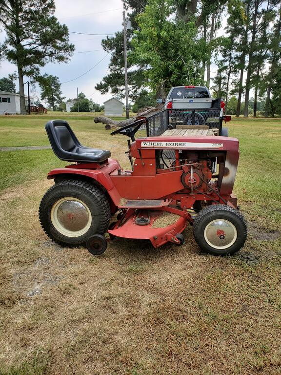

D_Mac 9,337 #1 Posted May 28, 2020 I have a question about my newly acquired tractor. After mowing with it yesterday I noticed that the hood, air cleaner, grill got very hot. I can only assume it is from the exhaust that is positioned so close. Is this common with this style? I even noticed discoloration on the front grill from the heat over the years. Also wondering if that helped in the cracking of the air cleaner base plate. Anyone else have same issue? I know these are bad pictures. I just assumed it was just your regular paint fading but now I am sure its from the heat as it gets so hot. If you look you can see the areas. The muffler almost touches. Share this post Link to post Share on other sites
squonk 47,405 #2 Posted May 28, 2020 Yes they get hot . Might want to pull off the blower housing to make sure there are no nests or grass on the engine fins. Your cracked air cleaner is probably due to the fact that motor is mounted on a shaker plate 4 1 Share this post Link to post Share on other sites

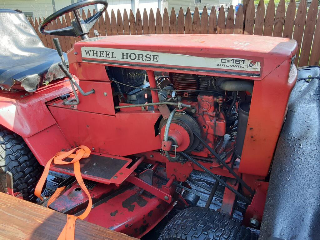

chip61 666 #3 Posted May 28, 2020 My C141 has the same problem! This muffler is larger in diameter than the one on my C160 which does not have this issue. I was told these mufflers came out as Wheel Horse was transitioning to the Black Hood series which I am guessing had a wider hood. I think I have an older smaller Nelson that I can install on this machine. I am in the process of cleaning up and painting this tractor and I don't want to ruin the new paint. 1 1 Share this post Link to post Share on other sites
peter lena 9,943 #4 Posted May 28, 2020 my c 85 originally had that front engine muffler , its relatively easy to swap that out for the top /side muffler of later years . your engine screw in exhaust port is the same , you might pick up a used side muffler , and remount as to later engines. just my own experience , don,t want to scare anyone with a change , pete 1 Share this post Link to post Share on other sites
SylvanLakeWH 31,723 #5 Posted May 28, 2020 I have that muffler on my C-105 Black Hood and yes - side and hood gets hot... Little more space in there on mine compared to yours, but it is still plenty toasty... 1 Share this post Link to post Share on other sites

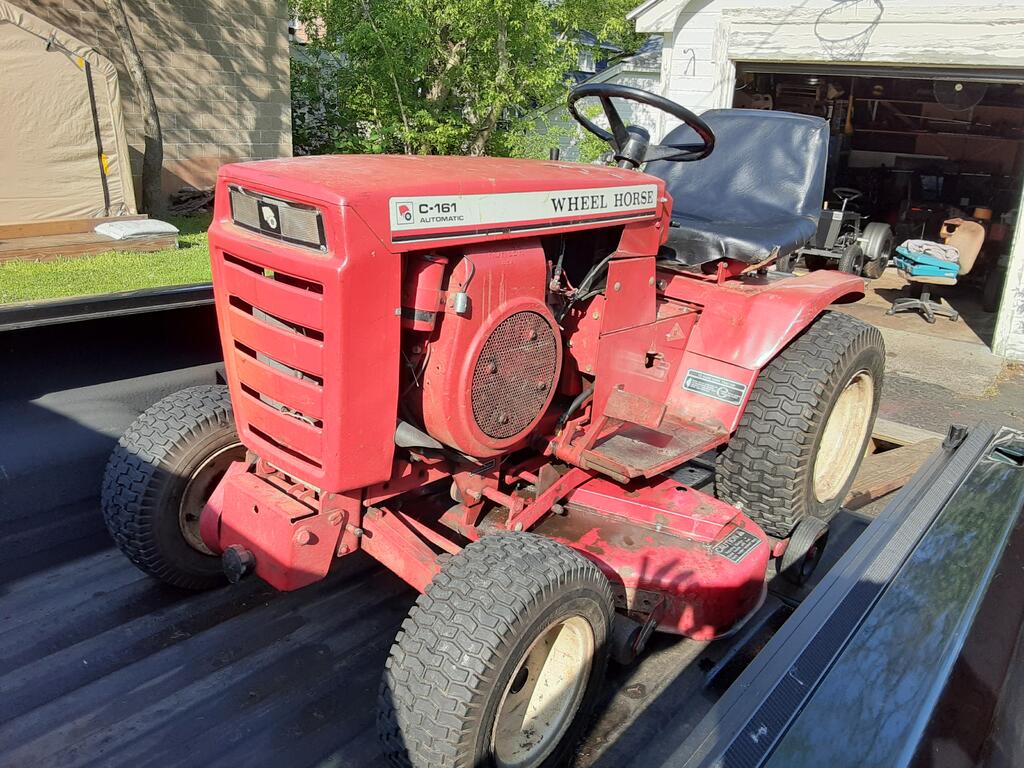

Pollack Pete 2,273 #6 Posted May 28, 2020 (edited) My C-161 8 Speed that I just started mowing with a couple days ago has the same heat problem.Dis-colored paint and my head light lens melted.Had my engine tins off and everytihing is clean as a whistle.Hot little tractors. Edited May 28, 2020 by Pollack Pete 1 Share this post Link to post Share on other sites
