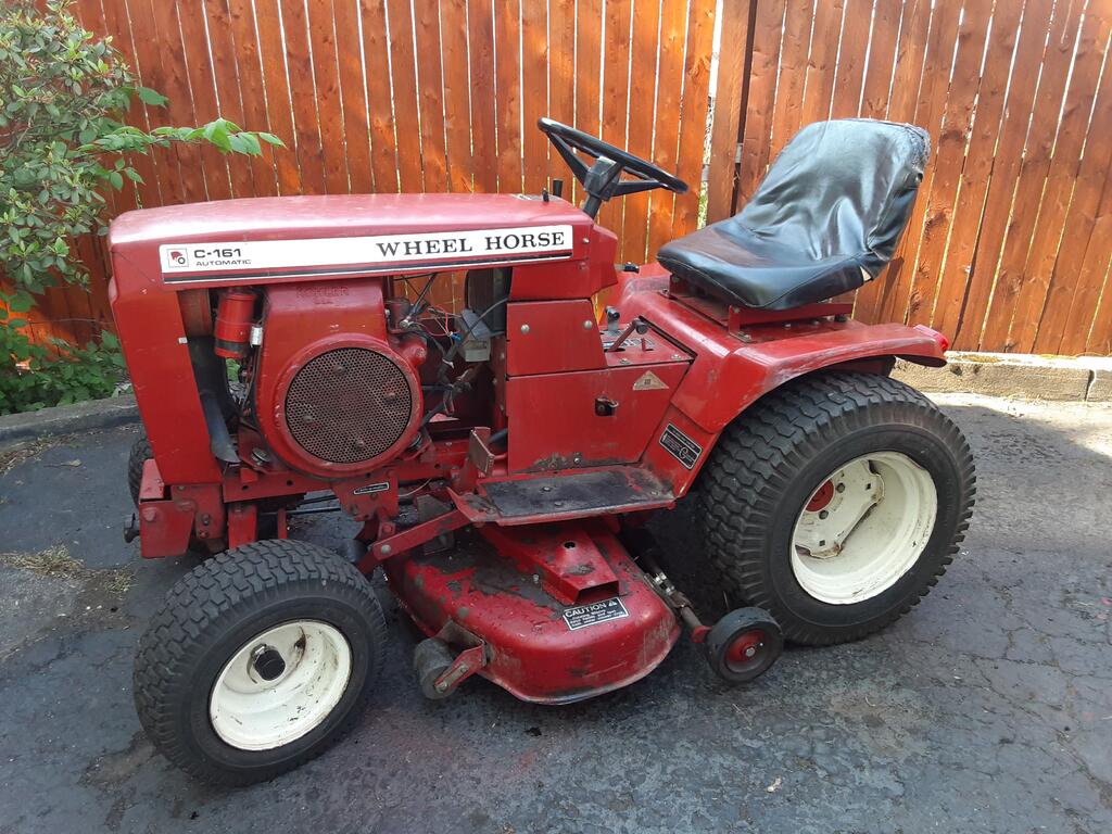

D_Mac

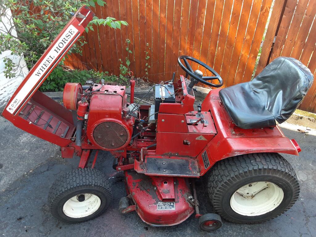

I am back in the club !! New to me Horse.
kasey54
Looks like a good one! I've seen some c-161 twins( B+S)
  • Thanks 1
kasey54
The 16 hp single cylinder kohler is second to none.
  • Like 3
  • Excellent 3
  • Thanks 1
Achto
 Nice looking tractor!! The C161 was only made in '78 & '79. 16hp Kohler is one beast of a thump-er.  The hand operated hydro may take a bit to get used to. I spent my child hood driving a hand operated hydro so a foot operated hydro seems foreign to me.
  • Like 5
  • Thanks 1

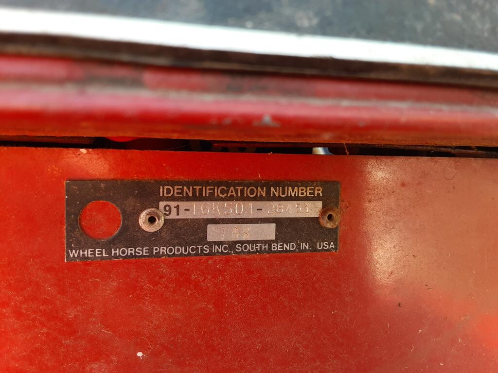

Added your serial number to the list. Could not read the build date at the bottom.

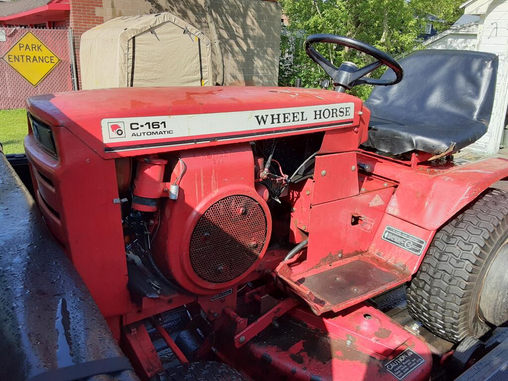

I have a thousand question but I will start with this one..... why are some C series hoods black and others red?
  • Like 1
ZXT
On that style hood, I don't think you'll find a black one. Later tractors got the different hood and it was black depending on the year.

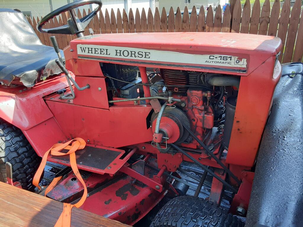

If you hit the brake, does it actually stop / return to neutral?  If so, you’re ahead of all of my hydro units.  If not, that can be adjusted fairly easily.
As for the leak, if you can get to it, see if the source is near the motion control system.  There are a couple o-rings in that part that tend to flatten and leak.  @pfrederi taught me that.  :handgestures-thumbupright:

Yes when I press the brake it stops and goes to neutral.

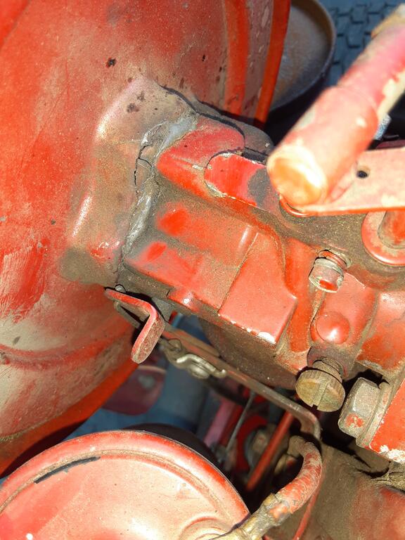

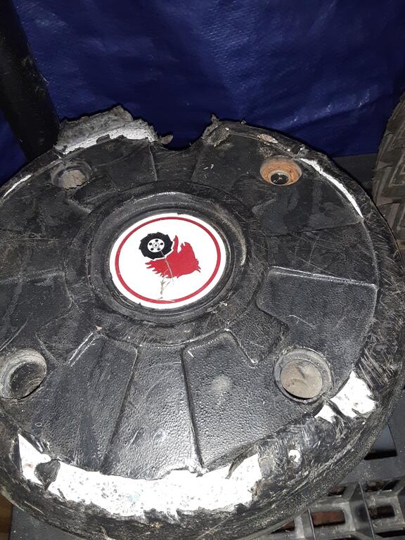

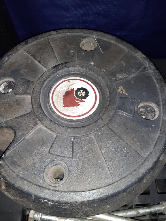

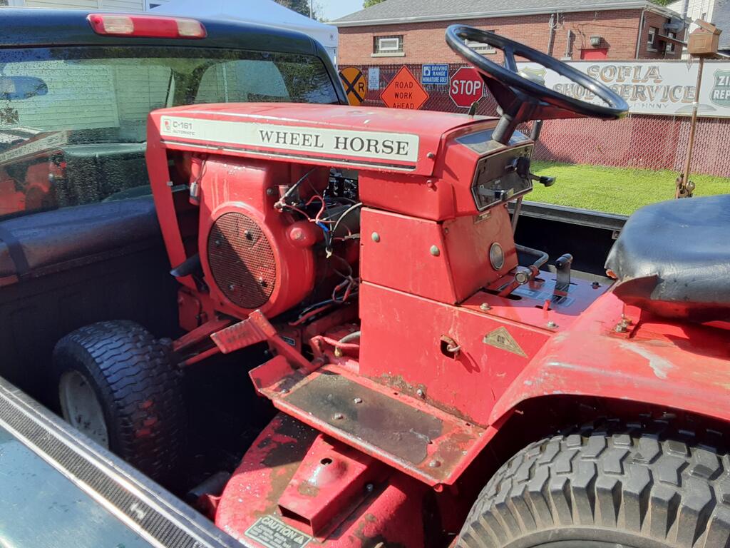

Alright gentleman. Was out early this AM giving my new Horse a look over. The previous owner glue a piece of vinyl all over the seat. Wrapped it up. Looked horrible. I got the vinyl off but glue all over the tractor. gonna need a new seat. Right now its serviceable. I notice the hood gets real hot after its running. Its that comman because the muffler is so close to it? Even the air cleaner is real hot. Speaking of the air cleaner.... I noticed it is cracked and ready to break off. In the picture you can see the crack, with the engine running and vibrating crack appears much longer. Not going to last very long. What are my options? Other then the lights not working it seems to run really good. It came with rear wheel weights. If I have no plow or snowblower do I need them? One is really good shape the other looks like it has been run along side a curb. What the value of them? I aslo would like to take the deck off. Does the hydro make it any different then my old 308? I would like to address the crack on the carb first. I can not find a tag on the engine.

D-MAC , looks like you have a very solid piece there, in addition to anything you look at that needs maintenance , a very thorough baseline service  ,  all oils , greasing , lubricate all cables for function , get some seafoam in the gas , look for wire chafing and posible mounting issues. the seat issue is easy , look at agri fab for exact w/h mounting seat pattern ,and good prices . you really scored with a good solid looking horse, keep us informed , pete

Oh no doubt I will go through all that. I will change all the fluids. They tranny oil was really low I just added some. I will change it. Right now my plate is full with the Lambert. I want to address the carb before I make a mess of it.

That air cleaner base comes off the carb.  It looks like it’s been siliconed on?  Try pulling it apart to inspect for overall damage.  There should be three screws holding the base to the carb.
  • Like 1
  • Thanks 1
D_Mac
Yeah I thought it was all one piece. Didnt make seance to me but I am no mechanic. I thought about JB weld but if it comes off I will look for a new one
Pullstart
I might just need some screws?
