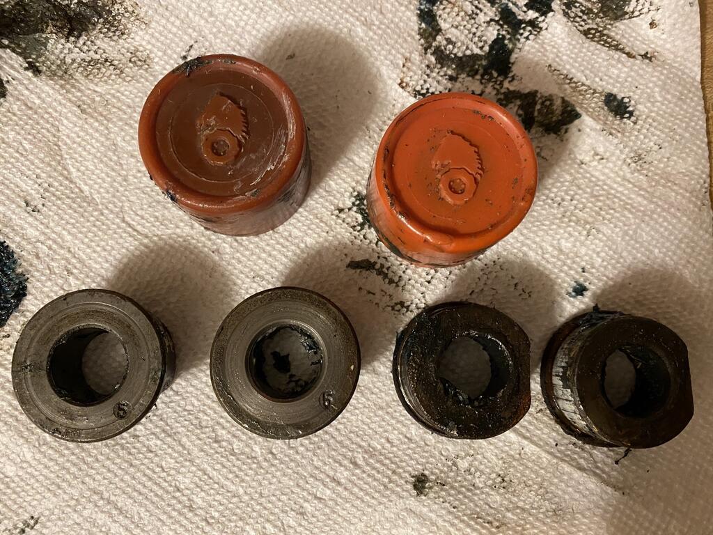

55reasons 171 #77 Posted May 25, 2020 Dump cart question. Pulled the wheels off today so I can send all the wheels off to powdercoat in one batch. The dump cart doesn’t have bearings? Just flanged sleeves through the wheels? Should I just stick with it, or is there a conversion to switch to sealed bearings? Share this post Link to post Share on other sites
squonk 48,288 #78 Posted May 25, 2020 1 hour ago, 55reasons said: Dump cart question. Pulled the wheels off today so I can send all the wheels off to powdercoat in one batch. The dump cart doesn’t have bearings? Just flanged sleeves through the wheels? Should I just stick with it, or is there a conversion to switch to sealed bearings? Unless your hauling a Detroit Diesel or @ebinmaine or @Stormin's logs your trailer wheels are fine. 3 Share this post Link to post Share on other sites
Stormin 9,988 #79 Posted May 25, 2020 Those flanged sleeves will be plain bushes/bearings at a guess. Are there grease nipples in the wheels? If so, just grease now and then. That's what my Saxon trailer is like. 1 Share this post Link to post Share on other sites
oliver2-44 11,791 #80 Posted May 25, 2020 If the flanged sleeves are 2 pc they are cast iro which mages a great old school bearing. If the are 1 pc tap them out and they are probable A stamped metal roller bearings. 1 Share this post Link to post Share on other sites

55reasons 171 #84 Posted May 26, 2020 (edited) 4 hours ago, oliver2-44 said: If the flanged sleeves are 2 pc they are cast iro which mages a great old school bearing. If the are 1 pc tap them out and they are probable A stamped metal roller bearings. This is what I’m looking at. Stamped with a “5” near the flange. I assume these are the cast iron you speak of. A flat side running along each so that grease can pass along and make its way to the flange seat. Edited May 26, 2020 by 55reasons Share this post Link to post Share on other sites

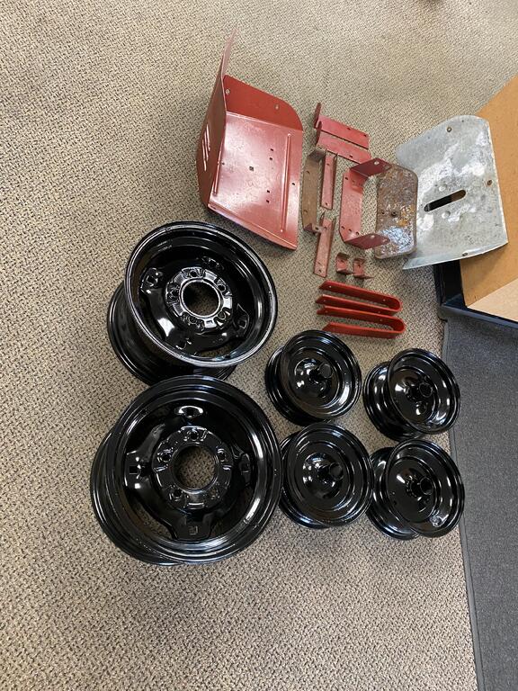

55reasons 171 #86 Posted May 29, 2020 Dropped off all the wheels, including the dump cart wheels, at the Powdercoater today. They were pretty rough, hopefully they’re halfway decent when they come back. Share this post Link to post Share on other sites
55reasons 171 #87 Posted June 3, 2020 Picked up the wheels, and dropped off the seat hardware at the powdercoater today. I’m hoping the red powder with a RAL code comes out close. If so, RAL coded powder has a direct paint matching code as well. 3 1 1 Share this post Link to post Share on other sites

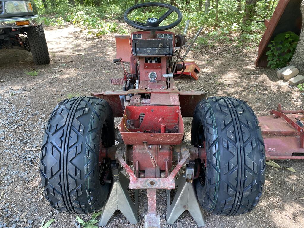

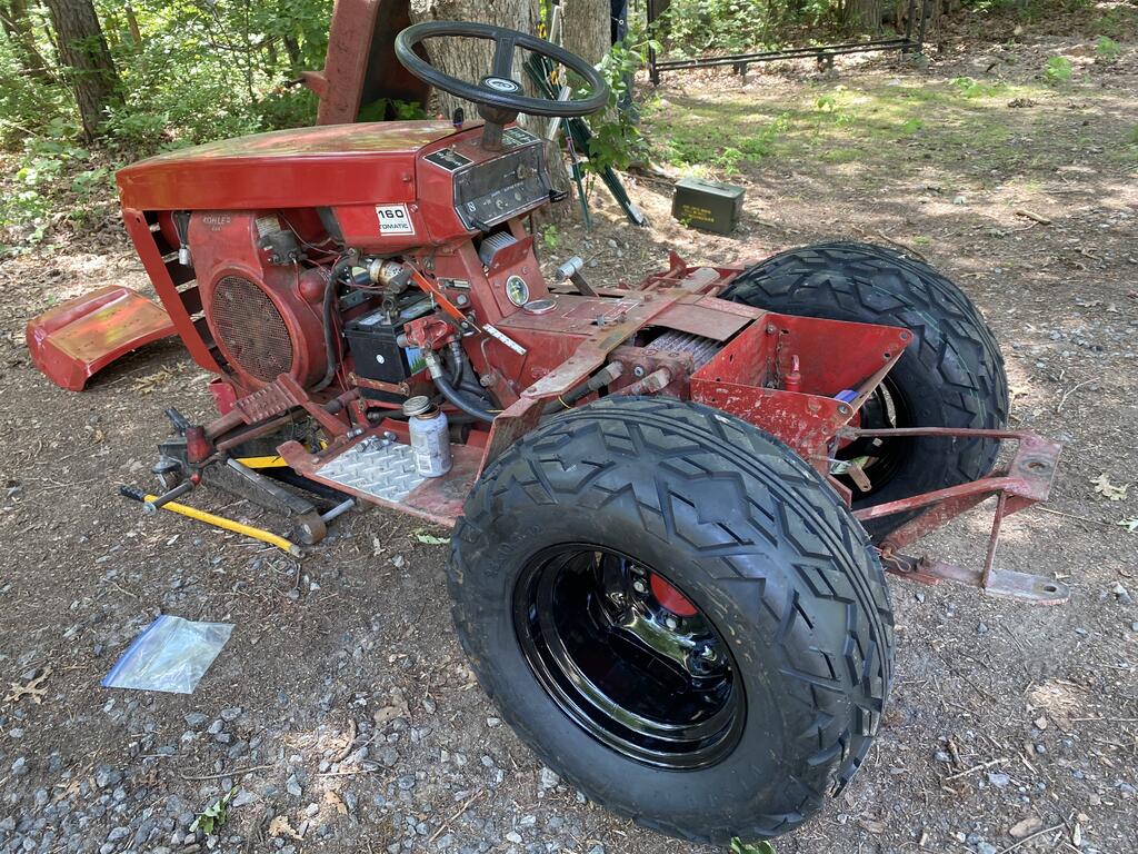

55reasons 171 #88 Posted June 3, 2020 Anyway, got the back tires on at least! 2 3 Share this post Link to post Share on other sites
71_Bronco 1,073 #90 Posted June 3, 2020 What's the intended use for those tires? Never seen that tread pattern before. Pretty cool looking. 1 Share this post Link to post Share on other sites
55reasons 171 #91 Posted June 4, 2020 (edited) 5 hours ago, 71_Bronco said: What's the intended use for those tires? Never seen that tread pattern before. Pretty cool looking. They are actually golf cart tires. I chose them because they are 6 ply, they looked like they could be aggressive in soft stuff, but wouldn’t tear up the turf like an ag tire. I’m going to be planting a clover lawn and it doesn’t take kindly to the rough stuff. Edited June 4, 2020 by 55reasons Typos. Share this post Link to post Share on other sites

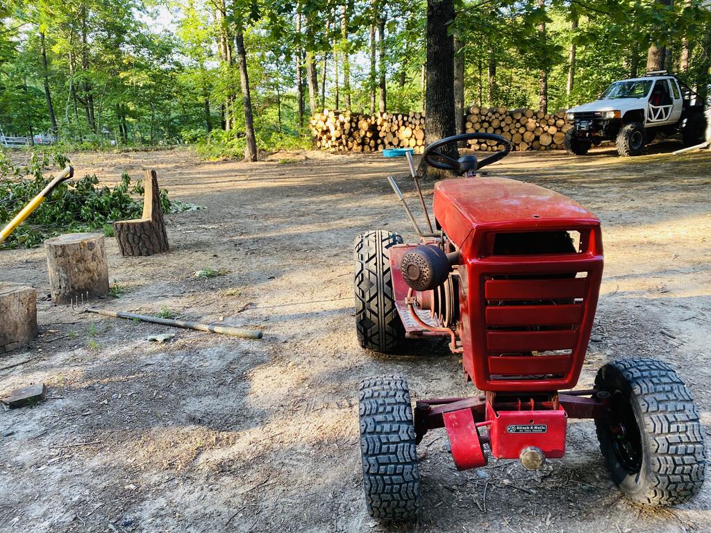

55reasons 171 #92 Posted June 4, 2020 Front tires came in the afternoon FEDEX delivery. Drove it for the first time. Immediately had flashbacks of my childhood. I couldn’t be happier... What an awesome machine. 1 3 1 Share this post Link to post Share on other sites

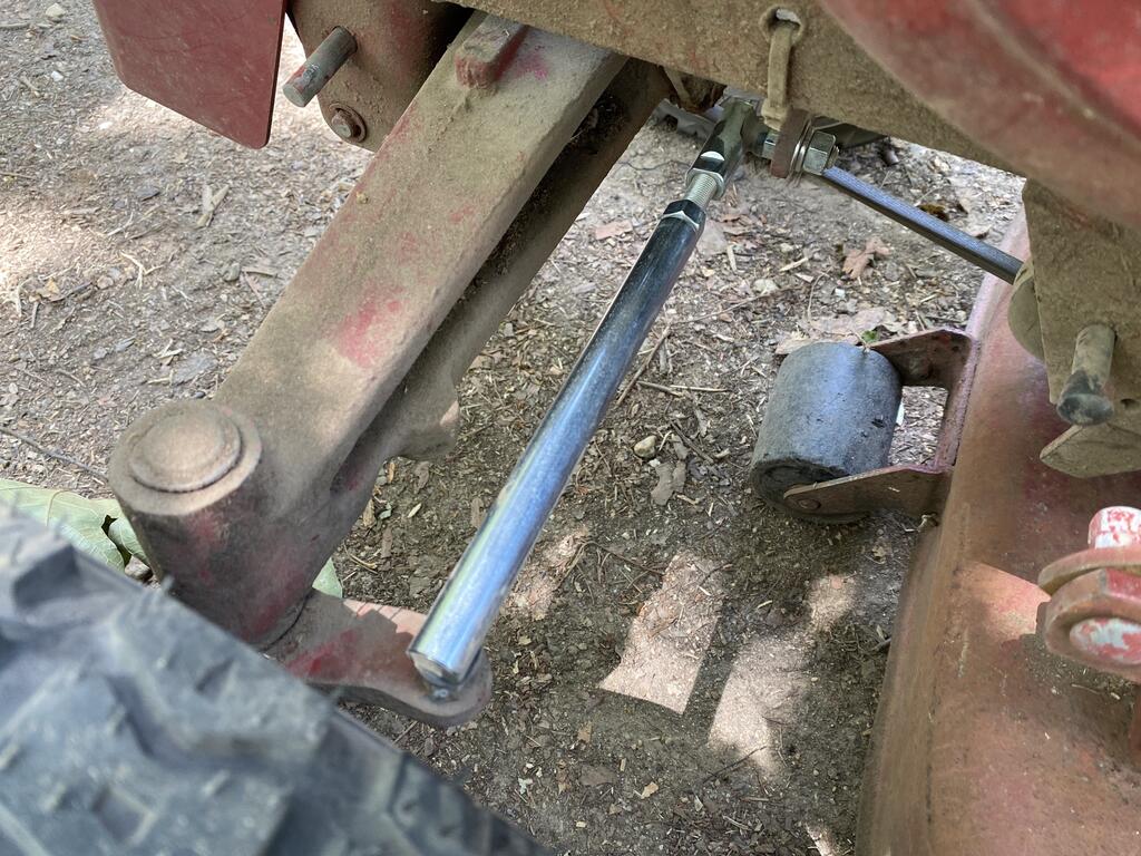

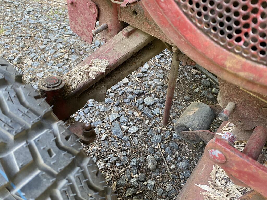

55reasons 171 #95 Posted June 5, 2020 Today is the first day of real work. Luckily, the blades on the deck turn freely. Managed to score some original WH belts at the dealer, and two WH logo’d tranny filters. Came home, fired it up, made three passes, and snapped a tie rod. Luckily, the dealer had a replacement. I’ll go with this until I make my own with some heims and rod, etc. 1 1 Share this post Link to post Share on other sites

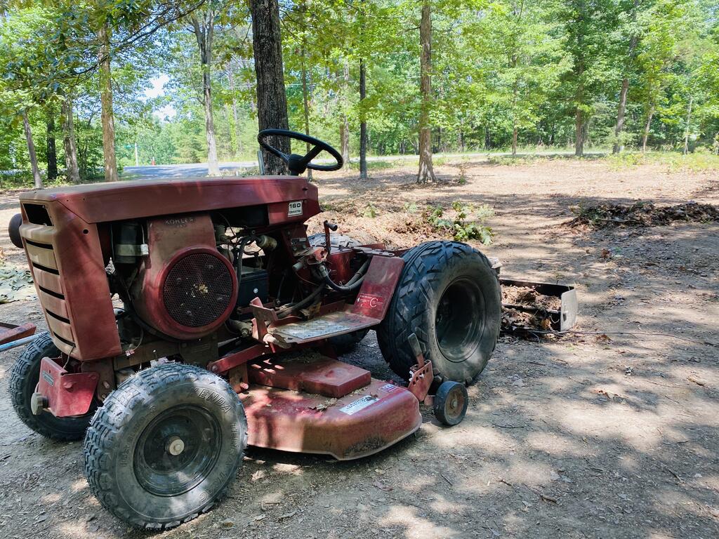

55reasons 171 #97 Posted June 5, 2020 Meanwhile, she’s putting in WORK and I’m loving it! (The headlight assembly is at the chrome shop) But I still need a hood ornament. I can’t aim without it. 👁 1 1 Share this post Link to post Share on other sites

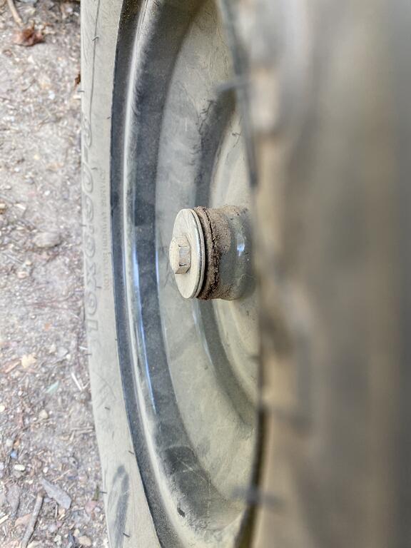

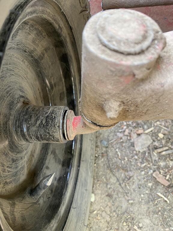

55reasons 171 #99 Posted June 5, 2020 (edited) I ordered the sealed bearings off eBay and I can’t get these things to go on right for some reason. The bearing sleeves stick out and I’m at a loss as to the best way to get these things to torque down properly. There’s gap on the front and the back exactly the amount that the bearing sleeves stick out. Edited June 5, 2020 by 55reasons Share this post Link to post Share on other sites
