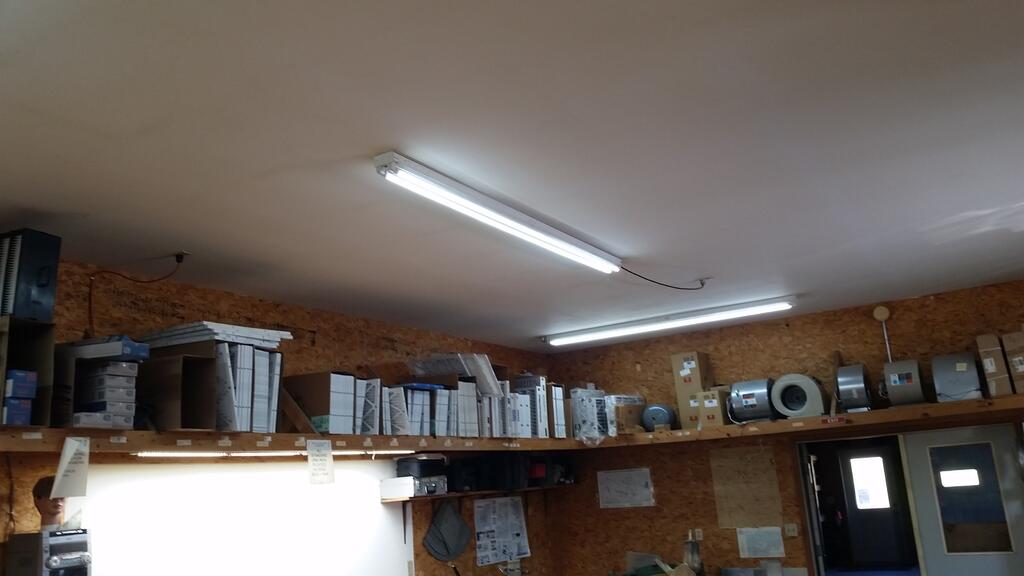

953 nut 64,332 #1 Posted May 11, 2020 Had an old four foot fluorescent shop light that needed new tubes. While I was out doing the weekly Corona Virus shopping spree this morning I found a pair of LED direct replacement tubes for $ 8.88 that are super bright. I will be getting more for sure. 13 3 1 Share this post Link to post Share on other sites

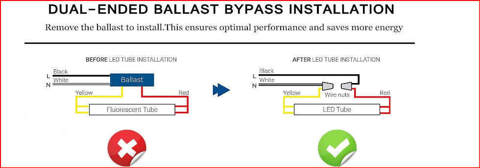

ZXT 2,401 #3 Posted May 12, 2020 Keep an eye out for the retrofit versions of them too. You have to wire around the ballast (which is a piece of cake), which makes fixtures with bad ballasts useful again. Saves electricity not having to run them as well. This is what we typically do for customers when changing out fluorescent bulbs for LED. 3 Share this post Link to post Share on other sites
chip61 666 #4 Posted May 12, 2020 8 hours ago, ZXT said: Keep an eye out for the retrofit versions of them too. You have to wire around the ballast (which is a piece of cake), which makes fixtures with bad ballasts useful again. Saves electricity not having to run them as well. This is what we typically do for customers when changing out fluorescent bulbs for LED. Now I'm curious-what do I need to do to retrofit for led bulbs on old 48" lamps?? I have 4 in my dad's shed that we installed 40 years ago. They are getting a little dim!! Thanks 2 Share this post Link to post Share on other sites
clueless 3,348 #5 Posted May 12, 2020 13 minutes ago, chip61 said: Now I'm curious-what do I need to do to retrofit for led bulbs on old 48" lamps?? I have 4 in my dad's shed that we installed 40 years ago. They are getting a little dim!! Thanks How to bypass the ballast, a diagram or pictures would be nice, I'm a slow reader . 1 Share this post Link to post Share on other sites

WHX?? 55,259 #9 Posted May 12, 2020 (edited) 1 hour ago, chip61 said: Now I'm curious-what do I need to do to retrofit for led bulbs on old 48" lamps?? I have 4 in my dad's shed that we installed 40 years ago. They are getting a little dim!! Thanks You might need to replace the "tombstones" , the bulb holders. Older tubes will be T-12 you might need to swap them out with T-8's. I always take out the ballasts as they are nothing but power robbing heat sinks. All you need to do is wire 120vac direct to each end of the retrofit bulb. Jungle sites have boat loads of stuff to convert and a good place to research. I did my whole office, shop and warehouse right off Amazon. Couple of bad ones out of box but they quickly sent me replacements no questions asked. Edited May 12, 2020 by WHX24 2 Share this post Link to post Share on other sites
Racinbob 12,812 #10 Posted May 12, 2020 My, how things have changed since I retired. I just got edjumekated on the retrofit this morning. When I first saw the LED replacements I assumed they used the ballast as a driver. They state to check for ballast compatibility. Some state to bypass the ballast. I'm gonna be experimenting this morning. 2 Share this post Link to post Share on other sites
WHX?? 55,259 #11 Posted May 12, 2020 (edited) Just get the direct wires Bob and toss the ballasts. … hot and neutral both ends and good to go. Polarity doesn't matter. This stuff changes with the wind and everyday they come up with a new mousetrap. Used to be the ballast was required but that's history now. Did half my shop at home just to see how well they hold up. So far so good. Only problem was the bulbs created RFI both here and home so no more shop radio. Alexa plays it all now. Edited May 12, 2020 by WHX24 3 Share this post Link to post Share on other sites

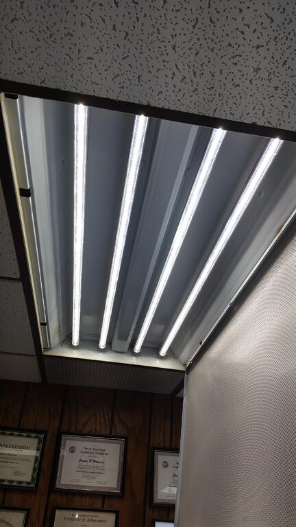

clueless 3,348 #16 Posted May 12, 2020 I've got 8 8ft/4bulb that are the old ballast fixtures in the shop, I've been replacing the bulbs with the new LED bulbs as the old bulbs start to go. The new LED bulbs work great my only problem is the ballast in one of the fixtures is shot and another is going. I want to disconnect the ballast in them as they start to go but not sure exactly how to do it on these 4 bulb fixtures, any help would appreciated, remember this is clueless, electrical ain't my strong point . Share this post Link to post Share on other sites

Racinbob 12,812 #18 Posted May 12, 2020 Here some interesting information I found. Replacing Fluorescents with LEDs When you decide to replace your fluorescent tubes with tubular LED lamps (or TLEDs), you have three basic options. You can keep the existing ballast and use ballast-compatible Type A LEDs for installation, or you can opt for ballast-bypass Type B LEDs, which don’t use a ballast and have their own internal driver. The third option, Type C, uses no ballast, like Type B, but has an external driver. Type A: Ballast-Compatible / Direct-Fit Ballast-compatible LEDs give you instant, plug-and-play results. You just remove the old fluorescent tube, plug in your new LED tube, and flip the switch. There’s no need to remove the old ballast. It’s a super easy installation with reduced up-front labor costs. Although convenient, this option has a couple of disadvantages over the long term. Type A ballast-compatible LEDs tend to be more expensive than their bypass counterparts. Also, although they are more energy-efficient than fluorescents, they are not as energy-efficient as ballast-bypass LEDs. Expect to save about 20 percent in energy usage with ballast-compatible LEDs, compared to fluorescents. Not every Type A LED tube is compatible with every make and model of ballast. You’ll need to verify which ballast you have and whether or not it is compatible with the Type A LED you’re looking at. Dimming control is limited to the capability of the ballast. The last big drawback to ballast-compatible LED tubes is the fact that that the old ballast is still in operation and is still a point of failure. So even if the LED tubes are working fine, when the ballast fails over time, the LED tubes will go dark and you will still have to get back up into the fixture and replace it. Type B: Ballast-Bypass Type B ballast-bypass LED tubes require the removal of the old fluorescent ballast. These tubes have their own internal driver and run directly off line voltage. The lamp sockets, or tombstones, may also require rewiring. There is additional labor involved in the initial installation versus ballast-compatible LEDs, but the end result is a much more reliable and longer-lasting assembly as the old ballast is eliminated from the circuit. Limited dimming capabilities are available. Although Type B ballast-bypass LEDs tend to be a little more expensive than ballast-compatible LEDs, they can save you an additional 20 percent in energy usage (for a total of about 40% over fluorescent tubes). That means they will pay for themselves in the long run. Type C: External Driver Like Type B LEDs, Type Cs will also require removal of the existing tube and ballast, and some rewiring. But in addition, the Type C will also necessitate an external remote driver and connecting it to the sockets. Opting for these LEDs with external drivers will entail some extra labor and expense, but it will pay off with even better efficiency and higher performance. These LEDs provide the best dimming and controlling options too. Installation Although they provide better efficiency, Type B and Type C LED lamps require a little more installation time and know-how. Removing or bypassing the old ballast will require some rewiring of your light fixture. Although this can be done with ordinary household tools and is not particularly difficult, you should consult with a qualified electrician if you are not handy or knowledgeable about electricity, wiring, and lighting. Also, if you are thinking about taking this on as a DIY project, you should make sure to wear eye protection to protect your eyes in case the fluorescent tube shatters during removal. And, of course, you should always refer to the manufacturer’s instructions before retrofitting your LED linear lamps. IMPORTANT: Always refer to the manufacturer’s installation instructions prior to retrofitting your LED linear lamps 1 2 Share this post Link to post Share on other sites

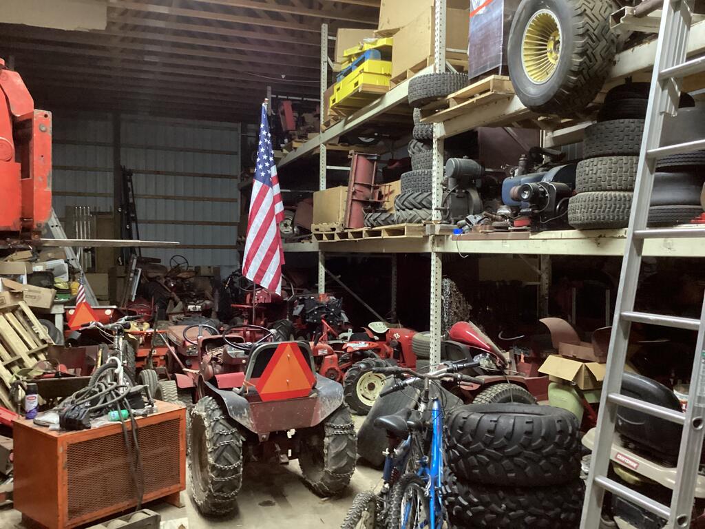

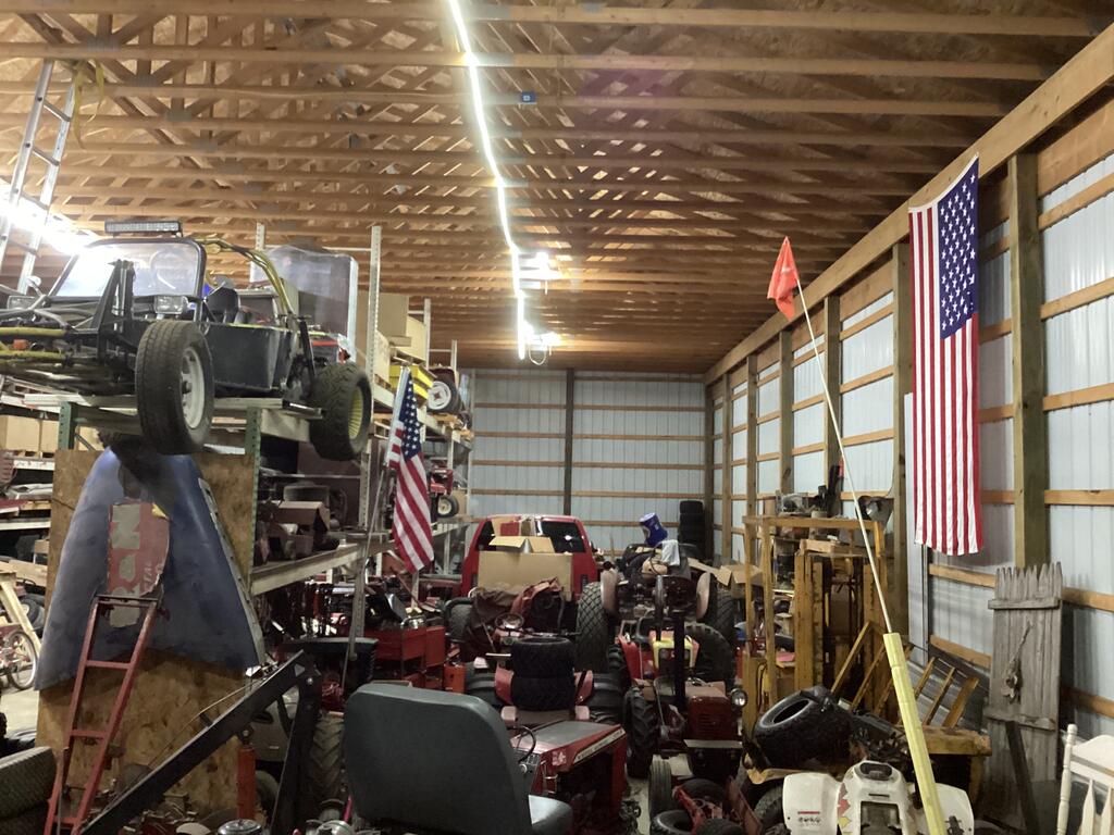

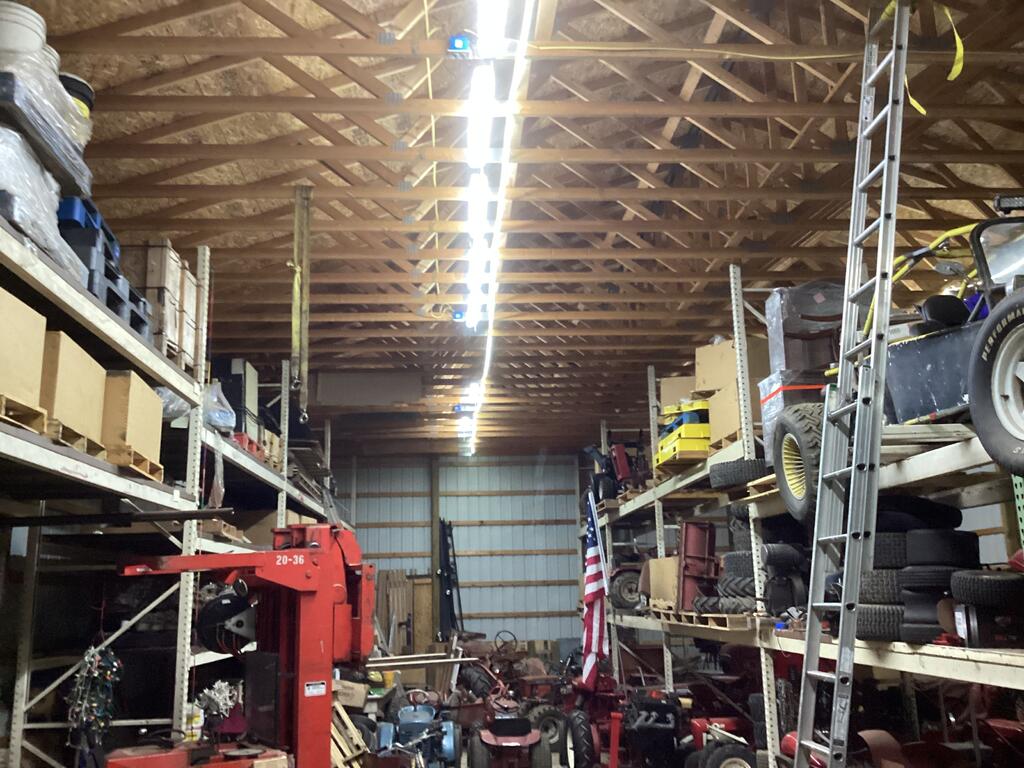

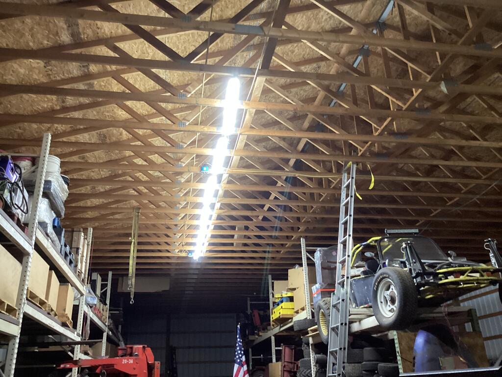

Pullstart 68,981 #21 Posted October 25, 2023 My rope lighting malfunctioned in the back barn. It worked great but wasn’t the brightest. I bought two of these 10 packs for $89.99/box and so far, the 6 I have installed are amazing! Oh look, I found some tractors I forgot I had! just kidding, I wouldn’t forget about them! 3 Share this post Link to post Share on other sites
c-series don 11,490 #22 Posted October 25, 2023 @Pullstart I’m not sure if you’re aware of this Kevin but you have a lot of “stuff” !! My brother says to me that I’m suffering from TMS, Too Much Stuff! 4 Share this post Link to post Share on other sites
Pullstart 68,981 #23 Posted October 25, 2023 3 minutes ago, c-series don said: @Pullstart I’m not sure if you’re aware of this Kevin but you have a lot of “stuff” !! My brother says to me that I’m suffering from TMS, Too Much Stuff! HEY NOW… My bills are paid and all my “stuff” is paid for too 2 1 2 Share this post Link to post Share on other sites
SylvanLakeWH 30,651 #24 Posted October 25, 2023 Mrs P's game plan: Kevin plans plow day; Kevin cleans sheds to prepare; Kevin discovers many wonderous 's and bits and pieces that visiting plow dogs may ... leaving sheds cleaner with more room for another Senior... Mrs P's smart girl... 5 Share this post Link to post Share on other sites
Pullstart 68,981 #25 Posted October 25, 2023 I’m so satisfied with these 10, I see no reason to put 10 more up! I also found the cause of the issue with the rope lights, so they are putting out some lumens again too! It has inspired me to move some tractors and “stuff” around to get ready for making room inside for the camper, Norman and Ole’ Smoky the ‘69 C10 for the winter. 2 Share this post Link to post Share on other sites
