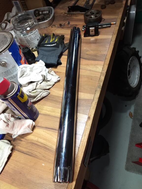

ebinmaine 80,772 #1 Posted May 11, 2020 I've been considering making my own muffler out of a particular piece of chrome pipe I have on hand. I think I've come up with the idea for the basic structure okay. 1.25 inch tube with Bunches of holes set into the 2 in chrome tube. My biggest question is what to use for packing in between the two tubes. Share this post Link to post Share on other sites

ebinmaine 80,772 #16 Posted May 11, 2020 3 minutes ago, Achto said: Strait through is going to be more noisy. Also a small diameter pipe tends to have a higher pitch than a larger diameter pipe. 1 minute ago, WVHillbilly520H said: Short answer Yes, but with fiberglass packing or mat wrapped around the the louver or perforated tube the sound is (as with their Dynomax mufflers) considerably less than non-packed varieties or other brands. Very nice. Thank you. I'll take a picture of a drawing I made up and a couple of pipes I'm thinking of using later on today. I'd like to have this "relatively" quiet. Share this post Link to post Share on other sites

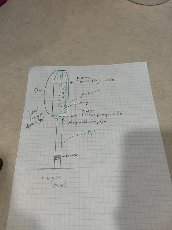

ebinmaine 80,772 #25 Posted May 12, 2020 11 hours ago, WVHillbilly520H said: muffler Here's a descriptive drawing of what I'm thinking. Keep the small pipe one solid piece for structure. Drill a few dozen holes. I'd use rivets instead of welding only because I don't want to discolor the chrome. Here's the pipe section I would cut in half to make 2 mufflers. 1 Share this post Link to post Share on other sites
