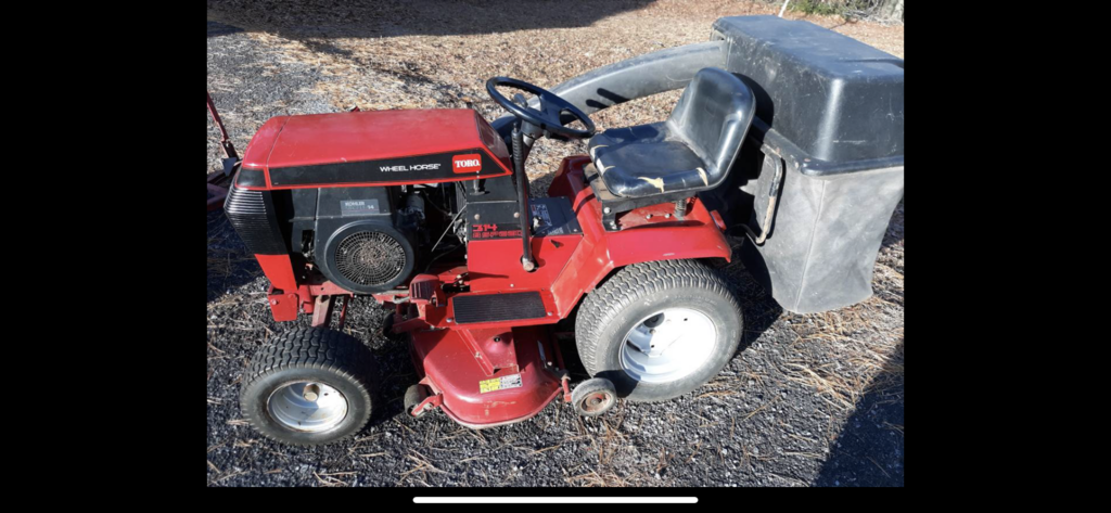

ATolles 52 #1 Posted May 5, 2020 I’m looking for some input on a Wheel Horse 314-H. I have found one that looks to be in good condition. Asking price is $975. Comes with a bagger and a front dozer blade. It has the Kohler Magnum 14 and the hour meter reads 395. I’ve never owned a Wheel Horse and I’m tired of junk riding mowers. Just looking for something that is sturdy and won’t fall apart in a few years. Thanks for your input. 6 Share this post Link to post Share on other sites

ATolles 52 #5 Posted May 6, 2020 Thanks for the replies. You think $975 is a good buy, or should I ask for less? Here are a couple pics: Share this post Link to post Share on other sites
ebinmaine 80,608 #6 Posted May 6, 2020 Don't know the market down there... @953 nut or @19richie66 may chime in.... It's a fair price 'round here. Great machine. Our newest is a '74 so you'll have plenty of time to enjoy it.... 1 1 Share this post Link to post Share on other sites
Stepney 2,356 #7 Posted May 6, 2020 312-H with a hand lift. I'm not terribly familiar with late models, on an old 3xx the 314-a had the hand lift and a weak transmission, the H had a heavier duty unit. Could anyone fill us in on what this tractor would have? If it had the weaker transmission pump I'd be weary of plowing with it. But still, it looks well maintained and the price seems reasonable to me. 1 Share this post Link to post Share on other sites
tom2p 2,396 #8 Posted May 6, 2020 (edited) if it is in good shape - run don't walk to get it 314 - 8 speed or hydro (if Eaton 1100) - is one the better late Wheel Horse tractors produced perform very well - reliable and durable as an anvil Edited May 6, 2020 by tom2p 2 Share this post Link to post Share on other sites
ATolles 52 #9 Posted May 6, 2020 On the side sticker is says 314...8 Speed. May not be an “H”. Not sure. The ad says 314-H, but it may be listed wrong. Share this post Link to post Share on other sites
Stepney 2,356 #10 Posted May 6, 2020 Huh, it does say 8-speed doesn't it? I didn't notice that. Clearly a hydro drive though. Be curious to hear what others say. Share this post Link to post Share on other sites
ATolles 52 #11 Posted May 6, 2020 I just noticed the ad says it has the Eaton 1100 hydrostatic transmission Share this post Link to post Share on other sites
tom2p 2,396 #12 Posted May 6, 2020 (edited) 4 minutes ago, ATolles said: On the side sticker is says 314...8 Speed. May not be an “H”. Not sure. The ad says 314-H, but it may be listed wrong. hmmm ... odd appears to be a hydro don't know why it has the 8 speed stickers ask the owner Edited May 6, 2020 by tom2p Share this post Link to post Share on other sites
lynnmor 9,037 #13 Posted May 6, 2020 Things don't quite add up, the seat, paint, engine dirt and the sticker mismatch says to me that you are dealing with an unknown. No way of telling if the low hours are correct. Proceed with caution. 2 Share this post Link to post Share on other sites
tom2p 2,396 #15 Posted May 6, 2020 15 minutes ago, lynnmor said: Things don't quite add up, the seat, paint, engine dirt and the sticker mismatch says to me that you are dealing with an unknown. No way of telling if the low hours are correct. Proceed with caution. yeah - what's up with the fan side of the engine ... Share this post Link to post Share on other sites
ATolles 52 #16 Posted May 6, 2020 (edited) How would I know if it’s not legit? What should I look for? It’s almost 3 hours from me and I don’t want to be swindled! That would suck! Edited May 6, 2020 by ATolles Share this post Link to post Share on other sites
ATolles 52 #17 Posted May 6, 2020 My cobwebs on the side of the motor? Not sure. Share this post Link to post Share on other sites
19richie66 17,932 #18 Posted May 6, 2020 (edited) Just grass from mowing that got sucked up into the fan. Looks clean. If it is a 314 with an Eaton 1100, it would be hard to beat. Ask him if you can get a picture of the rear of the tractor. If it has a filter below the left side fender pan, your good. Edited May 6, 2020 by 19richie66 1 Share this post Link to post Share on other sites
Stepney 2,356 #19 Posted May 6, 2020 It's still a 30 year old tractor.. It just won't be mint. I've seen some severely abused 1100 Eaton hydros and they are doing great. The stickers are weird, but I had a tractor that said C145 on one side, and C105 on the other. And a B100 with the stickers totally crooked.. weird things happened and often snuck by. Those dash towers were somewhat known to crack, may have been replaced. I'd say look it over good, and you should be fine. Just be sure it doesnt smoke, leak, have a weak hydro, etc.. Where are you located that such a machine would be a 3 hour ride? Share this post Link to post Share on other sites
JCM 11,415 #20 Posted May 6, 2020 (edited) By the way, to 314-H or 8 can't go wrong. by the way, nice largemouth. pic's of it's cousin. Edited May 6, 2020 by JCM 1 Share this post Link to post Share on other sites
PeacemakerJack 11,059 #21 Posted May 6, 2020 I remember asking the same question about a 314-8 about 5 years ago! First of all—-to the best Wheel horse resource on the planet! Back to the 314: mine had about 750 hours on it when I bought it and looked like a wreck... however it ran like a Swiss watch! The guys suggested that I buy it and 5 years later I am so glad I made that purchase. I built mine into a plow tractor. Looks a little different now... Looks a little different now but runs just as good. I now two horses with the Eaton 1100 and my son owns one with it—great hydro. Compared to the throw away trash, well........... you cant really compare because that 314 is on a whole different plane than those! Anything mechanical can break at any time but when you purchase something with a proven track record you lessen your chances of mechanical failure! Good luck! 3 Share this post Link to post Share on other sites
horseyheaven 113 #22 Posted May 6, 2020 I would say that is a good deal as good as it looks in the picture. Things I notice in the picture. Looks like 8 speed decal on a hydro tractor. Decals look like the newer decals used on the 2005 or 2006 models (those were 315-8 I believe). Could just be a re decal. Does have newer style brake pedal. If memory serves me right, I believe they made 314s in 1985 but then brought it back in 1997? (Late 1990s, can’t remember how many years they made them now). Are they a good tractor? Absolutely. My Aunt has one with 2000 hours on Kohler 16 hp (416-8). Only thing done was basic maintenance. Still uses no oil and runs like a top. This one has to be a late 90s machine due to newer brake pedal. They are not throw always. Take care of it and the next couple generations of your family will mow with it to. 2 Share this post Link to post Share on other sites
ATolles 52 #23 Posted May 6, 2020 So...I finally got the scoop on the 314-H. Just got off the phone with the seller. Was on the phone for over an hour. He was very knowledgeable and new all about this Wheel Horse forum. Even named a few guys on here that had access to parts. One that has any decal sticker you could want (don’t remember any names). The reason why there was some confusion with the “H” and 8-speed stickers is because he put in an Eaton 1100 transmission which turned it into an “H”. It still has the manual deck adjustment. He said there is a guy in this forum that has a conversion kit pedal for the hydro-stat. I asked him why he was into “Wheel Horse” tractors. He gave me a long, cool story about his dad having one in the 70’s. This guy sounded legit. This tractor is mid-90’s. Only thing I need to replace is the belt on the right side that connects to the mower deck. He said it’s split. He said the metal is solid as a rock and the motor hours are original. It comes with the dozer attachment too. I think I’m gonna pull the trigger! 7 Share this post Link to post Share on other sites

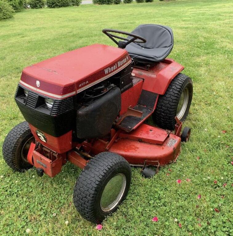

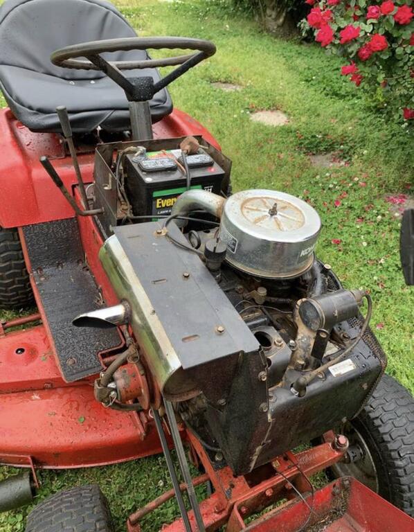

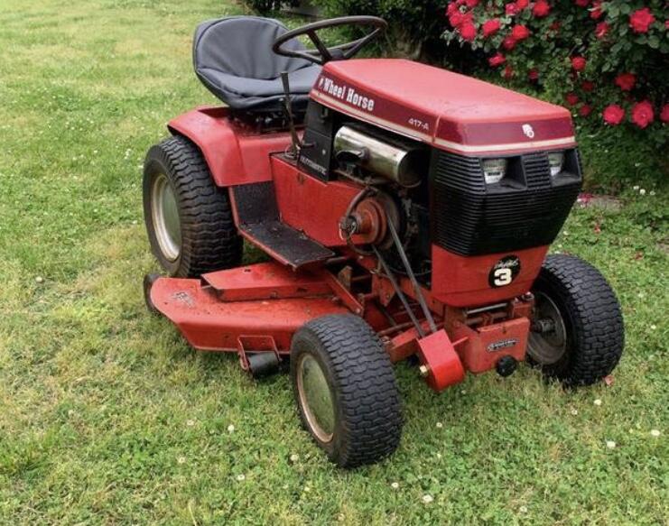

ATolles 52 #24 Posted May 9, 2020 So after all that...I just happened to check on Craigslist before I made the 6hr round trip tomorrow and this is what I came across for $500...a 416-A in good running order. Motor really sounds good and the body seems to be solid. Best of all...only 36 minutes from my house! I hope I made a good decision. 2 3 Share this post Link to post Share on other sites
ebinmaine 80,608 #25 Posted May 9, 2020 6 hours ago, ATolles said: 416-A in good running order Niiiice. Excellent price! My knowledge of the twins engines is limited. Others will tell you more. I do know you'll want to pop off a shroud/metal cover or two and make sure it's clean and happy. Do a search on this site for "baseline" and you'll find threads detailing what certain members do for all the new arrivals they get. Share this post Link to post Share on other sites
