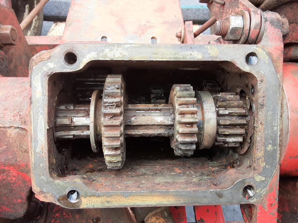

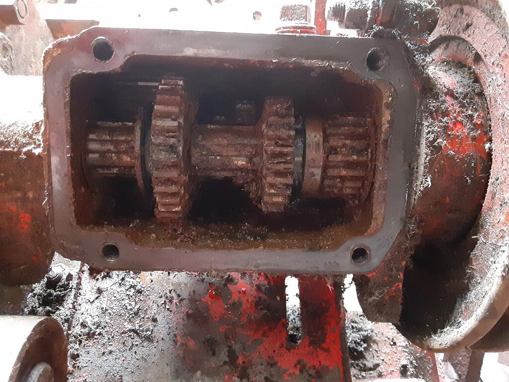

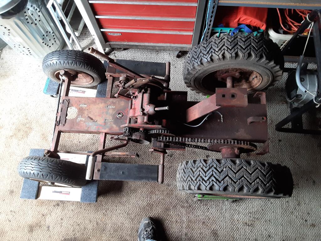

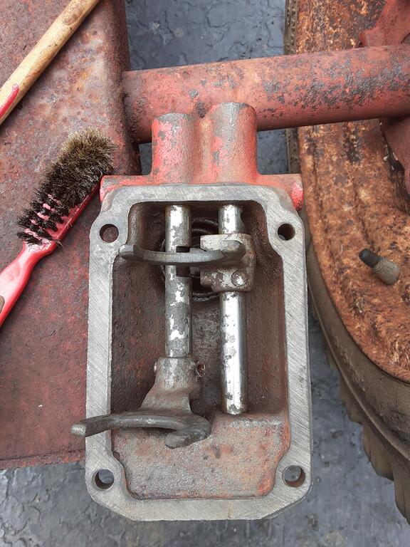

D_Mac 9,339 #27 Posted May 6, 2020 (edited) Got some more work done today. I also dont know if I have good news or bad news. Stripped the Lambert down all the way today. With the transmission completely exposed I took the top cover off. As you can see it dosnt look good. That being said I dont see anything broken. I still need to remove it. I would rather not remove EVERYTHING but at this point I might as well. I hope you guys stay with me. This is where I am going to need the most help. The thread seems to be losing interest. Is there such a thing as a rebuild kit for these or do you just take apart, clean, reassemble ? Edited May 6, 2020 by D_Mac 2 Share this post Link to post Share on other sites

WHX?? 57,955 #30 Posted May 6, 2020 I don't think it looks too bad. Mix up some acetone/ATF and put some in take a few days off and let it work. Every once in awhile take a little paint brush and hit the gears not immersed. After a few days see how it looks. Flush the gunk out and see how everything turns you see if you have to strip it out. Looks like a fairly simple design so may not be a huge job you have to gut it. 1 1 Share this post Link to post Share on other sites

WHNJ701 4,173 #32 Posted May 6, 2020 (edited) 11 minutes ago, WHX24 said: I don't think it looks too bad. Mix up some acetone/ATF and put some in take a few days off and let it work. Every once in awhile take a little paint brush and hit the gears not immersed. After a few days see how it looks. Flush the gunk out and see how everything turns you see if you have to strip it out. Looks like a fairly simple design so may not be a huge job you have to gut it. exactly, as long as nothing is. broke which it doesn't look like that trans should free up. look up t92, crosely, power king topics for parts diagrams, the parts are out if you need them, it's going to take some creative searching but, as I I posted this word a couple times on your posts (patience), you need to realize parts don't magically free up in 15 minutes. fill that trans up with cheap white vinegar and let sit for a few hours and get a wire brush Edited May 6, 2020 by jabelman 1 1 Share this post Link to post Share on other sites
953 nut 68,912 #33 Posted May 6, 2020 1 hour ago, D_Mac said: Is there such a thing as a rebuild kit for these or do you just take apart, clean, reassemble ? This is where a bit of creativity, perseverance and research will pay off. Not too likely a kit exists, but you know we can find a source for bearings and seals if none of the gears are badly damaged. Once the soak that Jim @WHX24 talked about has been done and things will turn we will have a better idea of what is needed. Have you managed to remove the input pulley, break drum and output sprocket? 1 1 Share this post Link to post Share on other sites

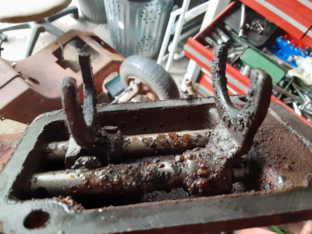

D_Mac 9,339 #37 Posted May 7, 2020 Well yes it seems I have my work cut out for me. Seriously have my doubts on if I can pull this off. Stop me if you think im going to do more damage then good. Tomorrow I want to roll it over to where I can get to my hose, undo the drain plug on the tranny, and with the cover off power wash to get as much junk out of the bottom of the tranny case as I can. There is A LOT of sediment on the bottom of that casing. After that I will spray it all down with brake cleaner. Put the plug back in. Fill it up with either vinegar or ATF/acetone. I will take the top half and put it in a bucket and soak it in the same solution. Anyone see any problems with that before I do it? Speak now or forever hold your piece ! 2 1 Share this post Link to post Share on other sites
WHX?? 57,955 #38 Posted May 7, 2020 Sounds like a good plan Mac. Share this post Link to post Share on other sites
troutbum70 858 #39 Posted May 7, 2020 I don't think you could make it any worse by doing so. Getting the junk out of the way makes more room for more solution allowing to work better on the bigger problem. Share this post Link to post Share on other sites
squonk 48,010 #40 Posted May 7, 2020 Those T92’s do use any seals. At least on Power King they don’t. And only use 1/2 pt. Of lube. I use a mix of STP, Lucas Oil stabilizer and gear oil in mine. Share this post Link to post Share on other sites

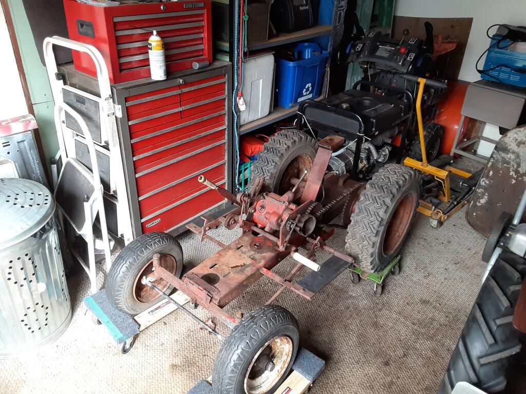

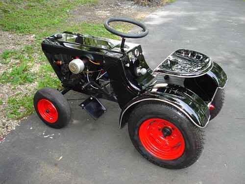

D_Mac 9,339 #41 Posted May 7, 2020 Well @squonk stopped by today to do a little trading and he gave me a hand on the Lambert. What do you think ? Came out pretty good. Amazing how much you can get done with an extra set of hands. Now I know how @pullstart gets so much work done!!! 1 6 Share this post Link to post Share on other sites
Pullstart 71,175 #42 Posted May 7, 2020 Great job @D_Mac! @squonk I’m sure you had a blast ribbing Don with your one liners all the while 1 Share this post Link to post Share on other sites

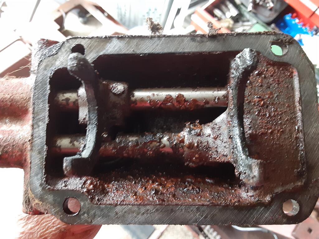

D_Mac 9,339 #43 Posted May 7, 2020 Actually not much progress today. Power washed the case out. Got it to roll in neutral. Alot of pitting inside. Going to have to get it all apart. Needs bearings as well. Cant catch a break with this one. I have it soaking again. It spins but no chance the gears are moving back and forth on the shafts. 2 Share this post Link to post Share on other sites
squonk 48,010 #44 Posted May 7, 2020 49 minutes ago, D_Mac said: Well @squonk stopped by today to do a little trading and he gave me a hand on the Lambert. What do you think ? Came out pretty good. Amazing how much you can get done with an extra set of hands. Now I know how @pullstart gets so much work done!!! Pictures either do wonders or add 10 lbs! 2 Share this post Link to post Share on other sites
953 nut 68,912 #45 Posted May 7, 2020 1 hour ago, D_Mac said: It spins but no chance the gears are moving back and forth on the shafts. Looks like a good candidate for a week-long vinegar soaking. Share this post Link to post Share on other sites
D_Mac 9,339 #46 Posted May 8, 2020 I got the vinegar in it now. Im not giving it much hope. If anyone has a T-92 transmission let me know ! 2 Share this post Link to post Share on other sites
