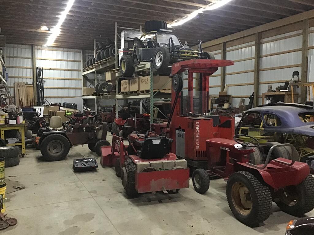

Pullstart 71,520 #18 Posted May 7, 2020 10 hours ago, Jaydubz83 said: @pullstart if you're really ok with it, @ebinmaine and I can sort out the deets. I just don't wanna step on anyone's toes. 10 hours ago, ebinmaine said: Your name looks great in red jay! Don't sweat pull start. Kevin's a good dude. You're not stepping on his toes. Yeah it looks good in red! I’m really hurting for that C100! I can’t live without it! Just pulling your leg, if you want dibs... by all means grab it up. I bought it from EB with neither of us knowing how to finish the transaction of transportation. I think I count 20 Wheel Horses in here... that one won’t break my heart if it doesn’t show up... but if you pass we’ll figure a way to pass it through a few states! 1 1 Share this post Link to post Share on other sites

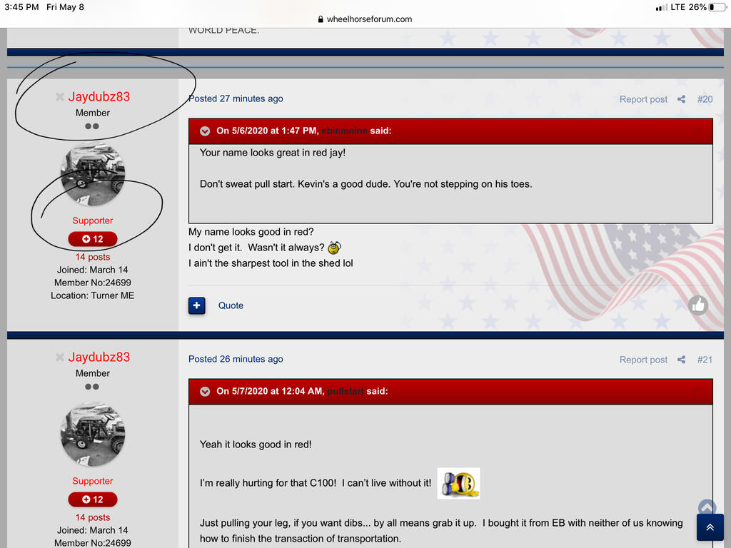

Jaydubz83 22 #20 Posted May 8, 2020 On 5/6/2020 at 1:47 PM, ebinmaine said: Your name looks great in red jay! Don't sweat pull start. Kevin's a good dude. You're not stepping on his toes. My name looks good in red? I don't get it. Wasn't it always? I ain't the sharpest tool in the shed lol Share this post Link to post Share on other sites
Jaydubz83 22 #21 Posted May 8, 2020 On 5/7/2020 at 12:04 AM, pullstart said: Yeah it looks good in red! I’m really hurting for that C100! I can’t live without it! Just pulling your leg, if you want dibs... by all means grab it up. I bought it from EB with neither of us knowing how to finish the transaction of transportation. I think I count 20 Wheel Horses in here... that one won’t break my heart if it doesn’t show up... but if you pass we’ll figure a way to pass it through a few states! Bah ahahahahahaha Gotta keep even numbers bud 😂🤣 Share this post Link to post Share on other sites
Pullstart 71,520 #22 Posted May 8, 2020 28 minutes ago, Jaydubz83 said: My name looks good in red? I don't get it. Wasn't it always? I ain't the sharpest tool in the shed lol Supporting forum members have their name displayed in RED, non-supporting members are in BLACK. All are welcome, supporters get more photo and private message storage. 1 Share this post Link to post Share on other sites
Jaydubz83 22 #23 Posted May 8, 2020 Thanks for clearing this up. I had no knowing lol 1 1 Share this post Link to post Share on other sites
