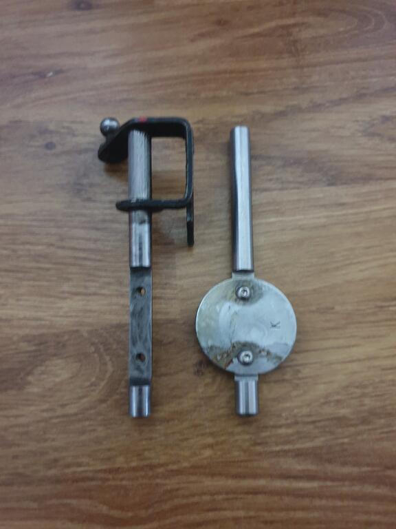

Mickwhitt 5,259 #1054 Posted December 2, 2020 Now thats a cup full! You need a steady hand to get that out of there. Soent the morning cooking, the afternoon cleaning down my machines after turning all that cast iron and then an hour milling a new throttle shaft for Fred's carb. Nice bit of 1/4 inch sliver steel with M2.5 threads tapped in. I will have a look at the throttle lever tomorrow. I fancy making it from brass bar rather than pressed steel but we will see. 3 Share this post Link to post Share on other sites
Mickwhitt 5,259 #1055 Posted December 3, 2020 Today I fitted the flywheel and checked the static timing. At 20 thou points gap its not far off. Started on the throttle arm, fabricating it from brass bar which I will silver solder onto the shaft. Also made a brass Bush to support the top end of the shaft even more. 2 Share this post Link to post Share on other sites

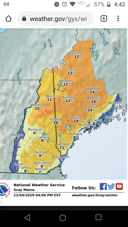

ebinmaine 79,610 #1061 Posted December 4, 2020 Well the latest update from the National Weather Service has us expecting a little over a foot between noon Saturday and 3 am Sunday. We're approximately at the blue 🔵 above the arrow. Mt Washington is the red area... That's 18 to 24" forecast. Here we go folks!!!! 1 1 Share this post Link to post Share on other sites

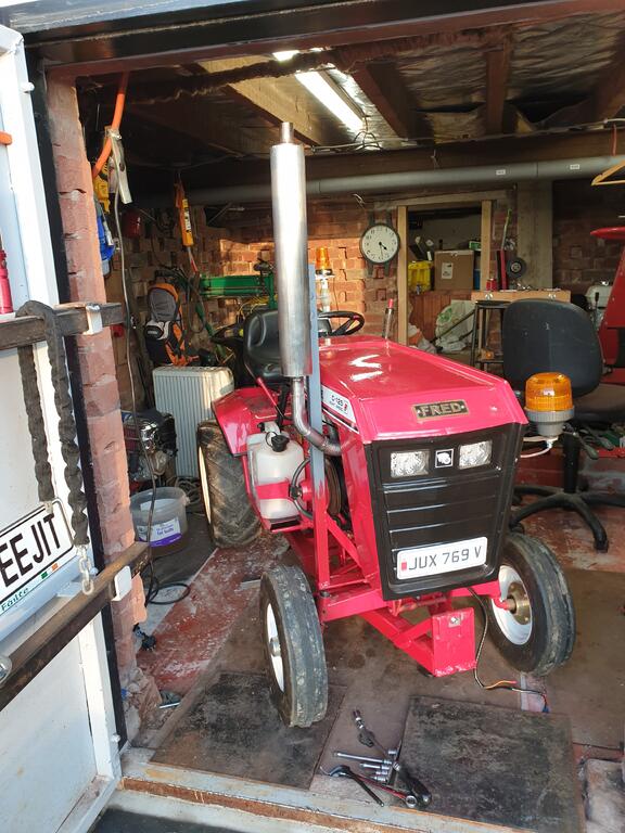

Mickwhitt 5,259 #1070 Posted December 7, 2020 How does that look for a stack? Not sure if it needs to be cut down a little or what. Opinions please gents Mick 2 1 1 Share this post Link to post Share on other sites

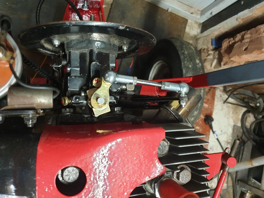

Mickwhitt 5,259 #1071 Posted December 7, 2020 Also made the new throttle link today which looks good. 2 1 Share this post Link to post Share on other sites
Pullstart 70,571 #1072 Posted December 7, 2020 I like it Mick! @ebinmaine would agree, taller is better! 1 Share this post Link to post Share on other sites
ebinmaine 79,610 #1073 Posted December 7, 2020 3 hours ago, Mickwhitt said: cut down Now don't be silly. If it clears the doorway it's just about right. Just be sure it's well supported. 1 Share this post Link to post Share on other sites
Mickwhitt 5,259 #1074 Posted December 7, 2020 Eric, the support post is pretty beefy and its on a length of flexible steel tube so hopefully not too much vibration. I will be attempting to set up the carb tomorrow. See if it runs better now the throttle shaft is nice and smooth. 3 Share this post Link to post Share on other sites
Stormin 9,988 #1075 Posted December 7, 2020 The stack does look tall but you don't want fumes in your face. You need a rain flap for it. 1 Share this post Link to post Share on other sites
