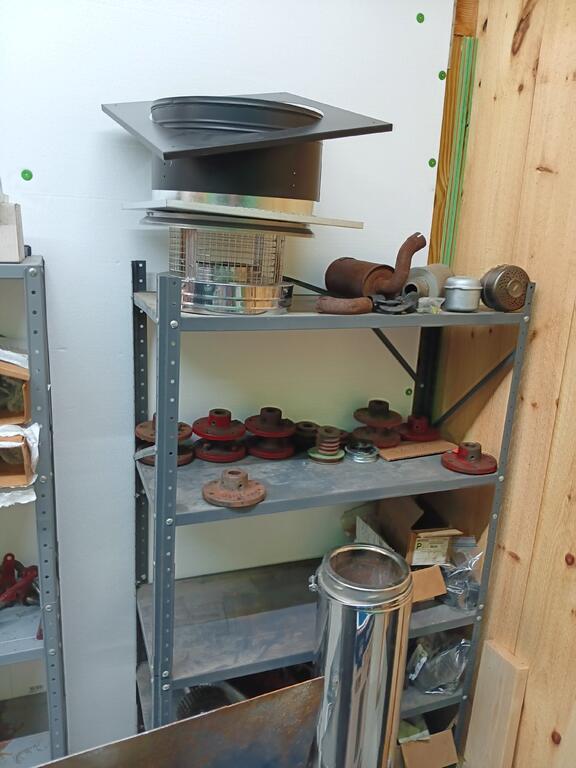

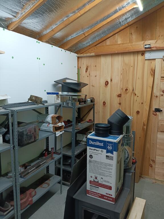

ebinmaine 80,714 #8428 Posted July 3, 2025 In the upper right part of this bare wall we are installing a very large air conditioning and heating unit. That's why that electric plug is there above the door. In the upper left part, that's where the wood stove chimney will go through. Yesterday evening I started shuffling things around a little to get these metal shelves back away from the wall six or seven inches. You can see the difference between the two in the second picture. I still have to move the third one of course. 1 Share this post Link to post Share on other sites

ebinmaine 80,714 #8441 Posted July 5, 2025 On 7/3/2025 at 7:52 AM, ebinmaine said: In the upper right part of this bare wall we are installing a very large air conditioning and heating unit. That's why that electric plug is there above the door. In the upper left part, that's where the wood stove chimney will go through. Yesterday evening I started shuffling things around a little to get these metal shelves back away from the wall six or seven inches. You can see the difference between the two in the second picture. I still have to move the third one of course. I decided that this morning's project was going to be to empty the large gray shelf and move it from the interior of the barn to the workshop. I needed to reset the two smaller, darker colored shelves for better level. Using the strap to the doorway and some additional blocking on the floor, that was accomplished. Then I installed the large shelves. All are screwed to the wall at the interior purlins. Now, I can start moving things from the shelf closest to the far corner onto this large shelf. Share this post Link to post Share on other sites

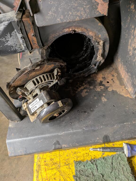

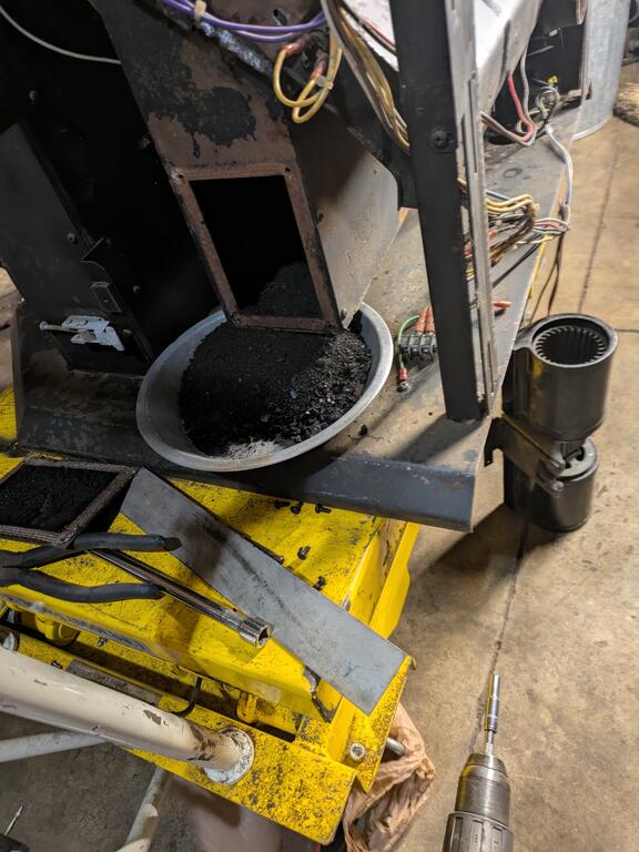

ohiofarmer 3,481 #8442 Posted July 5, 2025 (edited) I got a free pellet stove. The exhaust port was carboned up really hard stuff, so off came the forced draft fan near the exhaust port. The feed auger was full of pellets that got wet and swelled up. I finally drilled out the base of it to use a rebar to pulverize the now solid mass and she cleaned out. At the opposite end of the exha ust fan there was a clean out which probably was never accessed..The scraper removed enough to fill a pie pan which probably explains all the crud and crust at the exhaust. Not too bad working in front of a squirrel cage furnace fan. These things list at over three thousand. They have more system controls than an Englander, so maybe because they have thinner heat exchangers they might put out more heat. Anyway, the thing is cleaned up enough that I will no longer look like a coal miner.... Edited July 5, 2025 by ohiofarmer 3 Share this post Link to post Share on other sites

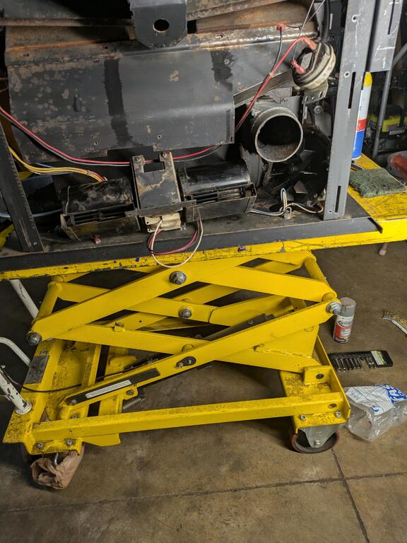

ohiofarmer 3,481 #8443 Posted July 5, 2025 Oh and another marketplace find is this very nice condition double scissors lift. It let lifts from about seventeen inches to sixty four or so rated 660 pounds 5 Share this post Link to post Share on other sites

Handy Don 17,474 #8445 Posted July 5, 2025 29 minutes ago, ohiofarmer said: Oh and another marketplace find is this very nice condition double scissors lift. It let lifts from about seventeen inches to sixty four or so rated 660 pounds Very nice find. I have a similar single-scissor lift good for 1000 lbs to ~35” that I use all the time. I do use it only on very hard surfaces (concrete and pavement) since I’m leery of heavy stuff high in the air! 1 Share this post Link to post Share on other sites
