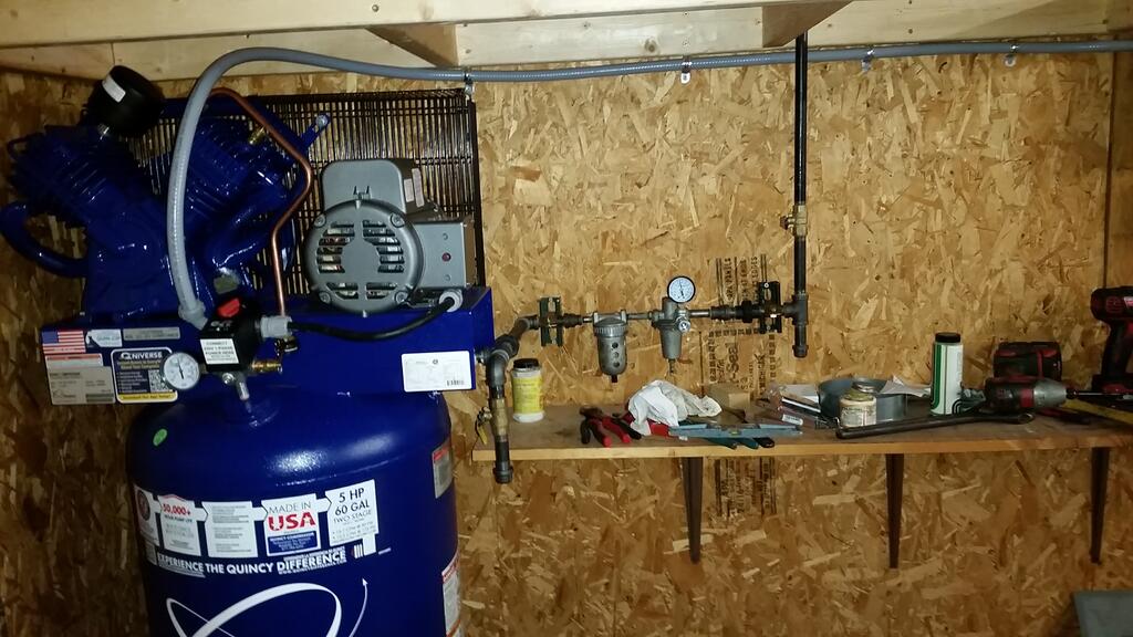

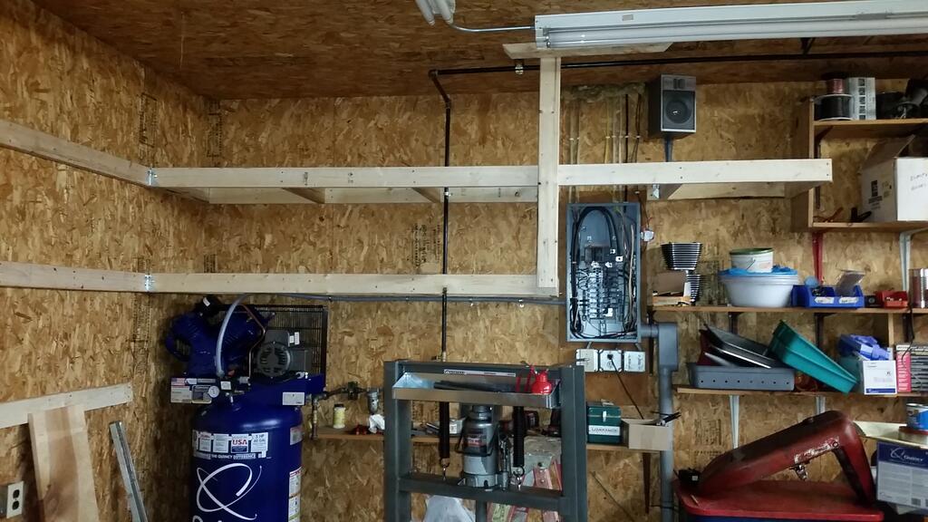

WHX?? 58,274 #802 Posted October 1, 2020 Got the Quincy making air and a good start on the piping. Shop is trashed worse than @pullstarts but we'll getter cleaned up. Working on the hi test shelves but coulda used @PeacemakerJacks help ... I suck these days at carpentry! Can't believe the price of lumber these days ...over seventy bucks for a small stack of 2X ! 11 Share this post Link to post Share on other sites
PeacemakerJack 11,061 #803 Posted October 1, 2020 Coming together nicely Jim...too bad I’m on the other side of the lake or I’d gladly help you out. Definitely gotta be careful buying too much lumber right now as prices are highly inflated...hopefully they start dropping soon cause $25 for a sheet of 7/16 OSB is crazy🤪 Share this post Link to post Share on other sites

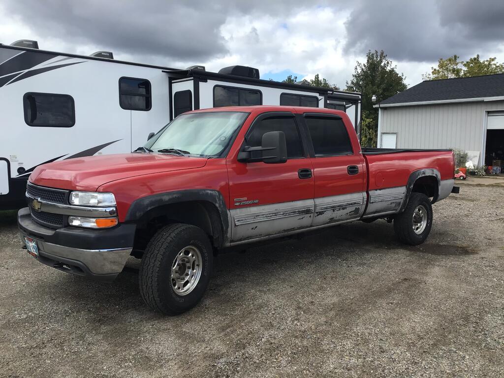

Pullstart 71,349 #808 Posted October 4, 2020 Since this thread began on the east side of the pond, I’ll say that I fitted Norman’s bonnet today and pulled him outta’ the shop! The only thing left is to vacuum the A/C system down and recharge it with fresh oil and freon. 2 5 Share this post Link to post Share on other sites

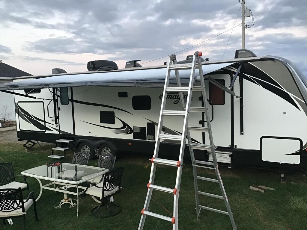

Pullstart 71,349 #809 Posted October 4, 2020 Our RV awning tore about 6 months after buying it new. I was too pissed to even make the call to have it fixed, so we’ve dealt with it for almost 2 years. Well, we finally decided it’s time to fix it. Today was the day. Never. Again. 1 3 Share this post Link to post Share on other sites
lynnmor 9,046 #810 Posted October 5, 2020 41 minutes ago, pullstart said: Our RV awning tore about 6 months after buying it new. I was too pissed to even make the call to have it fixed, so we’ve dealt with it for almost 2 years. Well, we finally decided it’s time to fix it. Today was the day. Never. Again. I hate my power awning, almost useless. Unless there is perfect weather it needs to be rolled up, so what is the point in having one? Give me a manual awning any day. 2 Share this post Link to post Share on other sites
Pullstart 71,349 #811 Posted October 5, 2020 2 minutes ago, lynnmor said: I hate my power awning, almost useless. Unless there is perfect weather it needs to be rolled up, so what is the point in having one? Give me a manual awning any day. This one at least has the auto drop when a 25 lb pressure is applied to the top. I think the underlying issue was that it never quite rolled up square and it was crooked from the factory, pulling too much in the outer front corner. Share this post Link to post Share on other sites
squonk 48,194 #812 Posted October 5, 2020 6 hours ago, pullstart said: Since this thread began on the east side of the pond, I’ll say that I fitted Norman’s bonnet today and pulled him outta’ the shop! The only thing left is to vacuum the A/C system down and recharge it with fresh oil and freon. Unless you drained all of the oil out of the system, only add the amount drained. I have seen guys add too much oil and destroy compressors. Rule of thumb: compressor 4 oz. Condenser 2 oz Evap and lines 1oz each. If you didn't see any oil come out, do not add any. Get straight refrigerant. Do not buy the combination refrigerant ,oil and sealer cans. 1 Share this post Link to post Share on other sites
WHX?? 58,274 #813 Posted October 5, 2020 6 hours ago, pullstart said: Since this thread began on the east side of the pond, I’ll say that I fitted Norman’s bonnet today and pulled him outta’ the shop! The only thing left is to vacuum the A/C system down and recharge it with fresh oil and freon. Save it when you come over here... all the needed stuff and lots of R134a. If you got it leak free ... good luck with that! Share this post Link to post Share on other sites

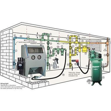

squonk 48,194 #814 Posted October 5, 2020 On 9/30/2020 at 10:15 PM, WHX24 said: Got the Quincy making air and a good start on the piping. Shop is trashed worse than @pullstarts but we'll getter cleaned up. Working on the hi test shelves but coulda used @PeacemakerJacks help ... I suck these days at carpentry! Can't believe the price of lumber these days ...over seventy bucks for a small stack of 2X ! You have the water trap too close to the compressor. For serious blasting you need the air to cool in the metal pipes so the moisture will release from the air. Tech Tips Minimize moisture in your air lines with metal piping Click to Download & Print Metal Piping Diagram (PDF) Let's talk shop ... piping that is. When we moved into our Canfield, Ohio plant, we had a shop full of air tools and needed to get set up quickly. We ran temporary rubber air hoses with 4-way crosses and quick connectors. Hoses, crosses and connectors were everywhere! Well, it wasn't long before we started having problems - air drills were failing, air rivet guns would not operate properly, and shears and other air-operated equipment were out of order more often than not. The reason for this is simple. By using long lengths of air hoses, moisture stayed in a vapor form, which passed through our water separators. It didn't matter how many water separators we had installed; moisture worked its way into our air tools, causing premature failure. We needed to make a change fast, so we equipped our entire shop with metal piping. The result was no more burned out air tools, no more clogged air filters and fittings, and our air tools lasted for years! Moral of the story: install a proper metal piping system and you will eliminate 95% of all moisture problems for smoother-running, longer-lasting air-operated tools and equipment. Even a small shop should have metal piping installed. With our affordable "piping kits", you can install the correct piping system in your shop at a reasonable cost. Using our Metal Piping Diagram above and components available in our catalog and on our web site, you can easily handle the installation yourself! Metal piping is the answer to moisture problems and will last for many years. Choose 1/2" or 3/4" metal pipe sizes - 1/2" pipe for up to 75 feet of horizontal pipe runs from your compressor, and 3/4" pipe for horizontal runs over 75 feet. Mount piping along the walls of your shop. Not only does the metal piping act as an "air reservoir", it also enables the moisture-laden air to cool, so the water separators can do their job. The most important feature is the use of "risers", which allow the system to draw dry air from the piping, with the water separators removing most of the remaining moisture. (Moisture condenses in the cold metal pipes and can be easily removed by the water separators.) Use Black Iron Pipe only. We do not recommend galvanized metal pipe, as galvanization can come off the inside of the pipe, clogging separators and regulators. Do not use PVC pipe, as PVC will not help cool the air; and glued joints often separate. Avoid copper tubing, as it is easily damaged; and soldered joints can come loose under pressure (Safety Hazard). 2 Share this post Link to post Share on other sites
WHX?? 58,274 #815 Posted October 5, 2020 Thanks Mike ... I am using all black iron pipe cause it is FREE. Also the air separate and the regulator were also FREE. Yup I'M a cheapskate and it's all good enough for the women I go out with. 'Sides lots of onions allows me to change anything without hassle. I also don't plan on using a huge amount of air at this point in time. Just trying to get away from having to wait years for a dinky rol aire to keep up for just givin a blow job.... The missuse's tires ....git yer mid out the gutter! 1 2 Share this post Link to post Share on other sites
