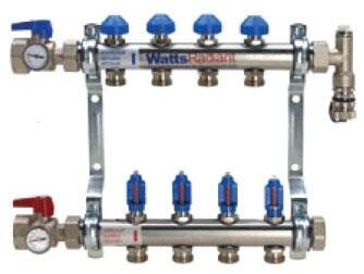

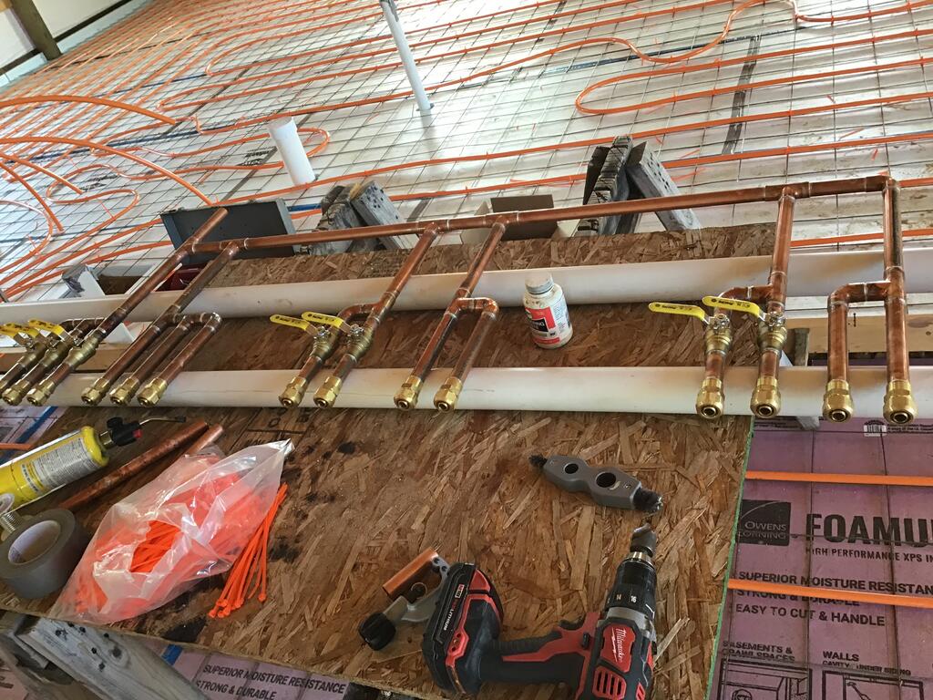

WHX?? 58,276 #577 Posted August 12, 2020 (edited) I've gotten into the habit of always deburring copper as thats just how I was taught as an apprentice. Easier these days what with the power methods available. A step bit in a drill motor works well too. Good thing you ain't charging by the hour as the cost would get way out of hand the way yer going at it! You should be using store bought manifolds and those usually dont' go on till after floor and framing is done and final heat source install. Reverse return is not needed if using them as they have balancing valves and flowmeters built right in as well as a easy way to zone. Simple design & layouts just get these. Edited August 12, 2020 by WHX24 1 Share this post Link to post Share on other sites

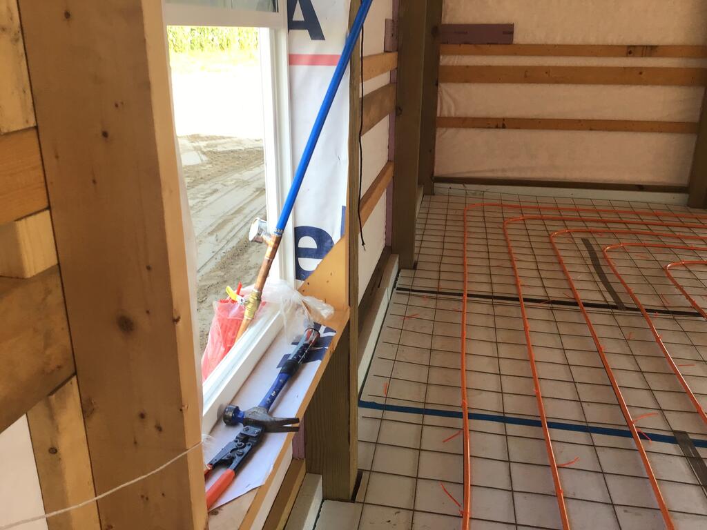

Pullstart 71,350 #578 Posted August 12, 2020 Yeah, this is a freebie for the FIL Jim. I’m sure he’ll get me back some day They want to be able to pressure test before and during concrete pour, so I’ll toss this on and run a line out the window with a gauge. 1 Share this post Link to post Share on other sites

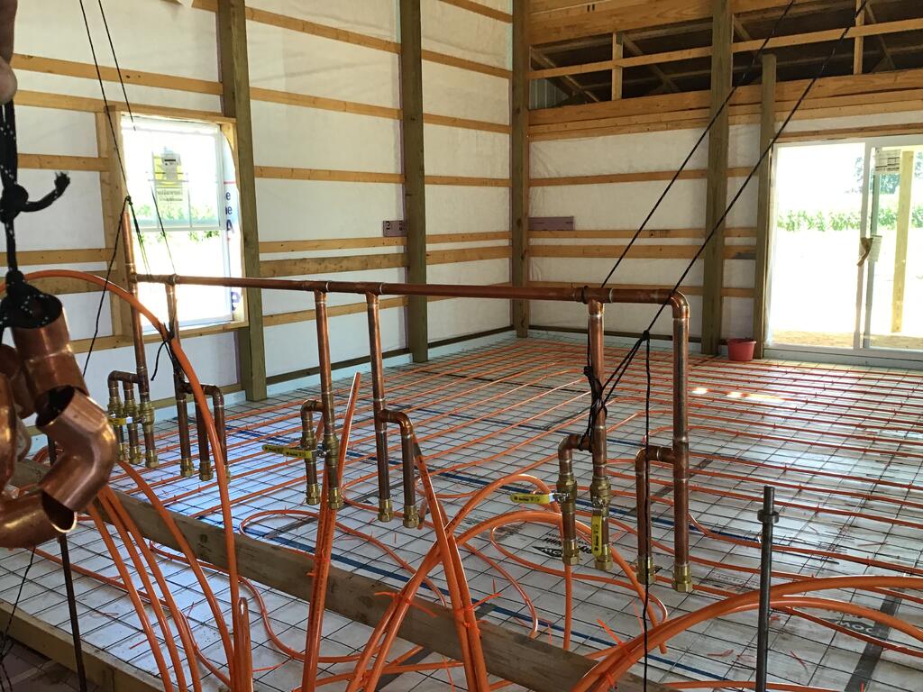

WHX?? 58,276 #579 Posted August 12, 2020 (edited) Pressure test = absolutely! We label all the ends per zone and then just tie it all together with crimp fittings plug on one tail and pressure gauge and shrader valve on the other. Tie every up on a rebar frame to keep it out of the concrete. Take lots of pics of the layout for future reference if needed. We been using these for a professional look but were using the conduit ells for years when we knew no better. . http://www.theezroute.com/ Where you at when we need infloor pics Plunge!?!?!? @JCM Trying to coach a rookie here! .... Prolly out more horses! Edited August 12, 2020 by WHX24 2 Share this post Link to post Share on other sites

Pullstart 71,350 #581 Posted August 12, 2020 (edited) Took Uncle Jim’s advice and put a chamfer bit in my drill. Manifold test system is all assembled for indoors. I’ll toss the outside system together and be good to go. Edited August 12, 2020 by pullstart Picture didn’t load 2 Share this post Link to post Share on other sites

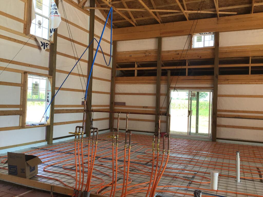

Pullstart 71,350 #584 Posted August 12, 2020 I used a wad of copper and some paracord to string the manifold up. Now, I can make my pex connections and keep it all close to right. 1 Share this post Link to post Share on other sites

Pullstart 71,350 #588 Posted August 13, 2020 Pullstart Stables, presenting Barnum and Bailey’s 2 ring circus... construction style! Manifold is complete, test piping run out the window! 1 Share this post Link to post Share on other sites
