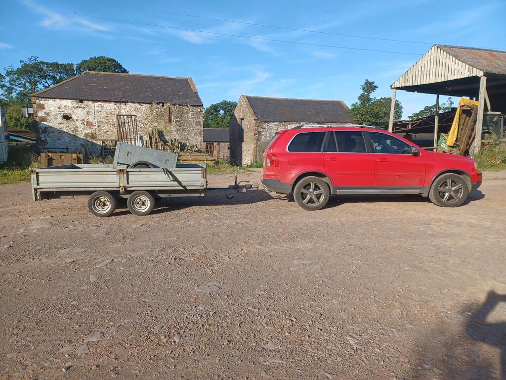

Dan.gerous 2,696 #4529 Posted August 9, 2022 We were in town yesterday running an errand. I was chatting to a guy and noticed a little trailer buried I grass on his lawn, so said it looked like a nice little unit. 2 minutes and £20 later it was mine and on the big trailer heading home! It's road legal, but ideal for the wheelhorses. Just needs a new deck as it was rotten beyond salvation. It even came full of firewood.... The kids just rolled their eyes when I turned up with it, however it's already been put to use moving our giant chest freezer to its new owner on the farm across the field. 2 5 Share this post Link to post Share on other sites

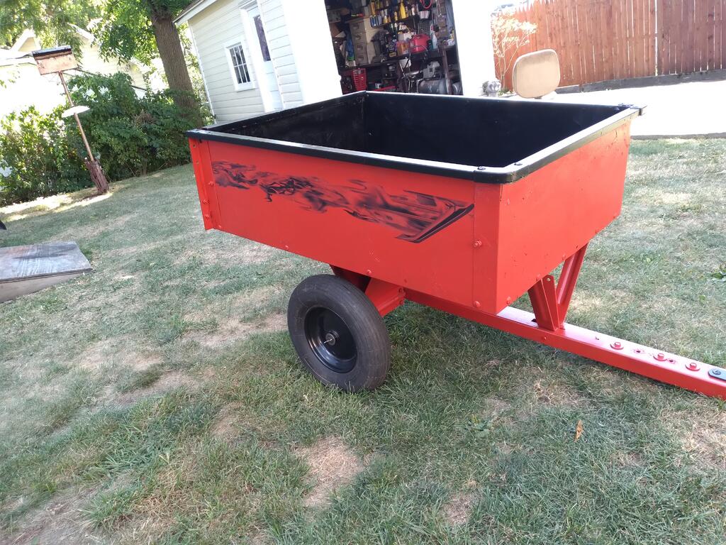

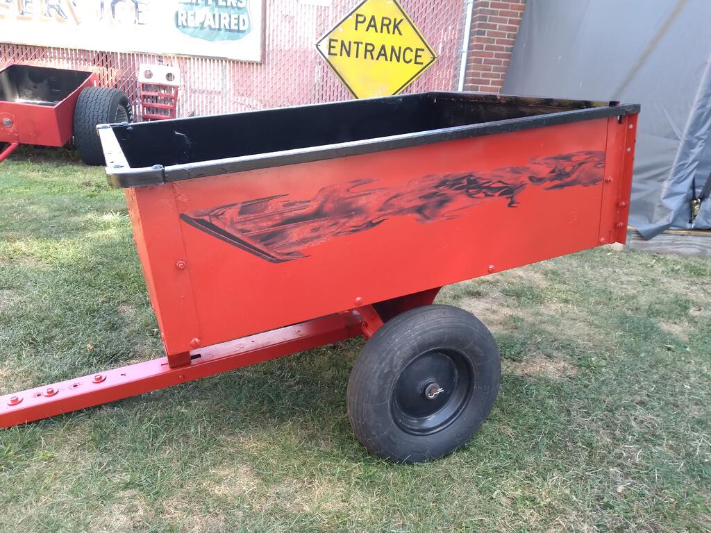

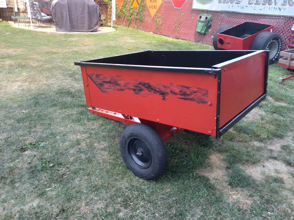

D_Mac 9,339 #4544 Posted August 13, 2022 So I bought this trailer from a junk man off the back of his scrap truck for 10 bucks. Just gave it a paint job. 5 1 Share this post Link to post Share on other sites

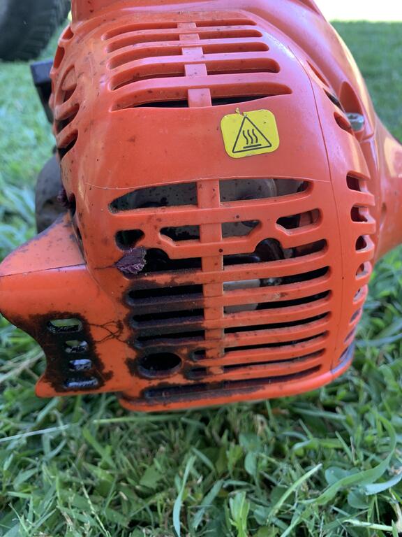

Horse Newbie 7,405 #4546 Posted August 13, 2022 Mowed the yard today… I’m a every two week guy, and it was thick more than tall. I’ll have to blow these mounds of cut yard(notice I don’t say grass because I’m not sure if anything growing in my yard can be classified as grass) to spread it out some. Did not want to start a topic on this, but what causes the exhaust on my 2 cycle string trimmer to blow out oil ? Got this blob landing on my arm and I thought I had been stung or bitten… 1 Share this post Link to post Share on other sites
Pullstart 71,516 #4547 Posted August 13, 2022 @Sparky tarp shingles! The HOA’s gotta love that! @Horse Newbie what ratio mixture do you use in that trimmer? Looks a bit rich to me… 2 1 Share this post Link to post Share on other sites
Handy Don 17,663 #4548 Posted August 13, 2022 51 minutes ago, Horse Newbie said: what causes the exhaust on my 2 cycle string trimmer to blow out oil ? I think a mixture rich enough to accumulate that much oil in the exhaust would probably not run well and it would smoke like the dickens. IMHO, that oil is coming around the rings--worn rings or a worn/scored cylinder wall. 2 1 Share this post Link to post Share on other sites
Stormin 9,988 #4549 Posted August 13, 2022 I agree with Don. Ring problem. Possibly a broken one. 1 Share this post Link to post Share on other sites
Horse Newbie 7,405 #4550 Posted August 13, 2022 45 minutes ago, Pullstart said: Horse Newbie what ratio mixture do you use in that trimmer? Looks a bit rich to me… Rich as in too much oil ?… Don’t know the ratio right offhand… I’ll check the manual and my oil bottles. I am pretty sure the mix is as recommended as I am a stickler when it comes to science…lol… you could say I’m mad about it ! 1 Share this post Link to post Share on other sites
