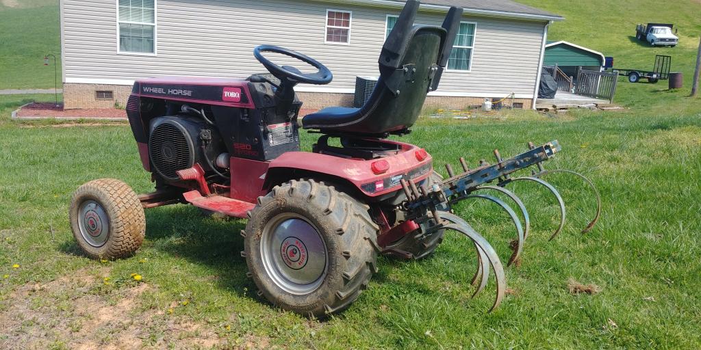

WVHillbilly520H 10,379 #6 Posted April 30, 2020 This is what dad used behind a Cub Cadet for weed control Brinly Cultivators (we never had a tiller until I bought the one for the 520 about 10 years ago)... 3 1 Share this post Link to post Share on other sites

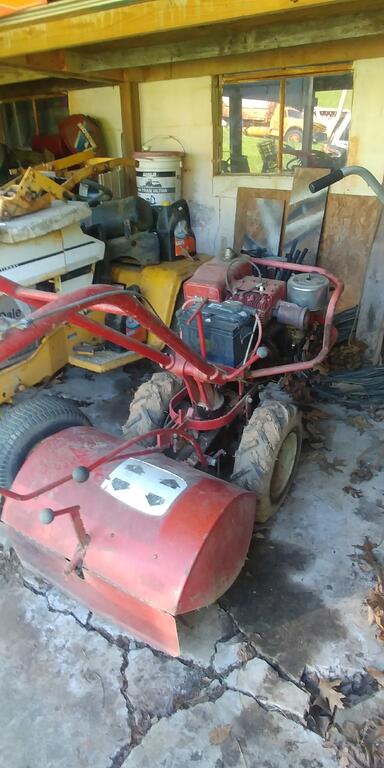

WVHillbilly520H 10,379 #11 Posted May 25, 2020 Here's the FIL's TroyBilt B&S powered with electric and pull start... 1 Share this post Link to post Share on other sites
