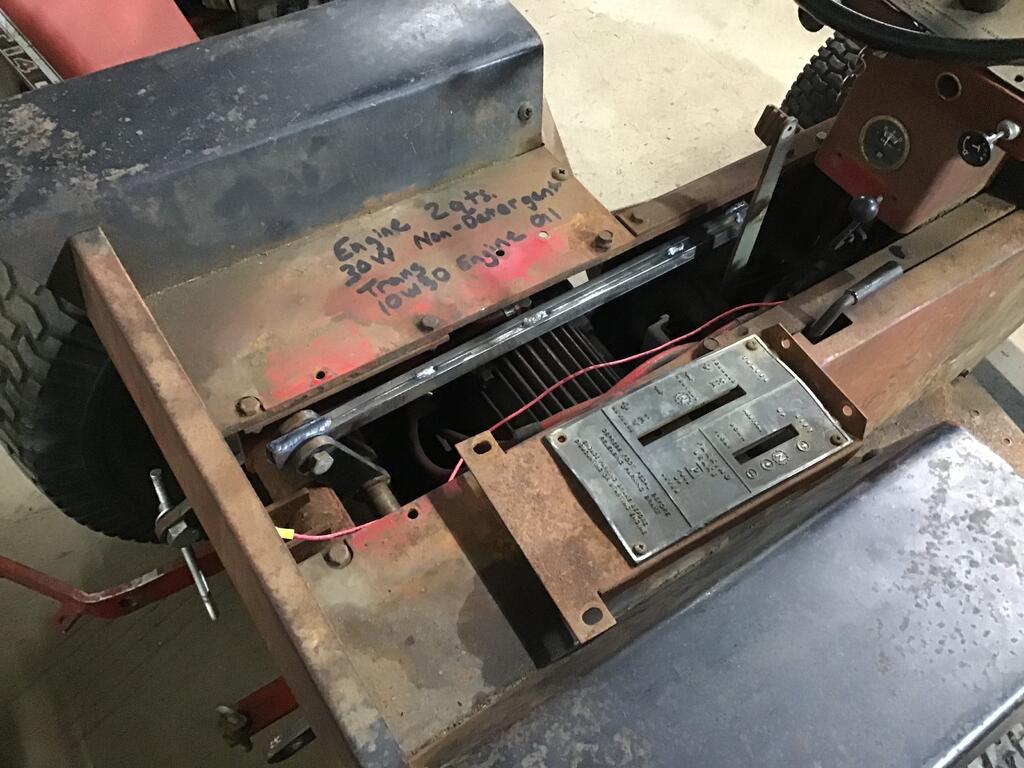

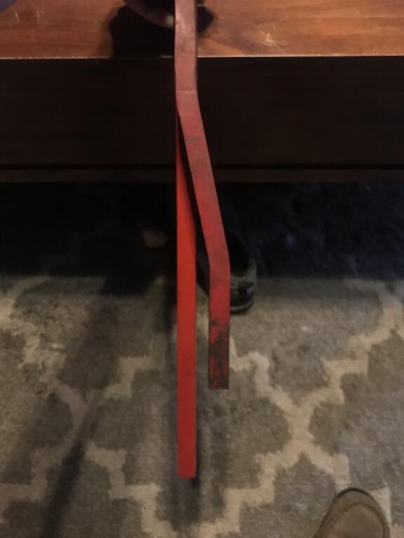

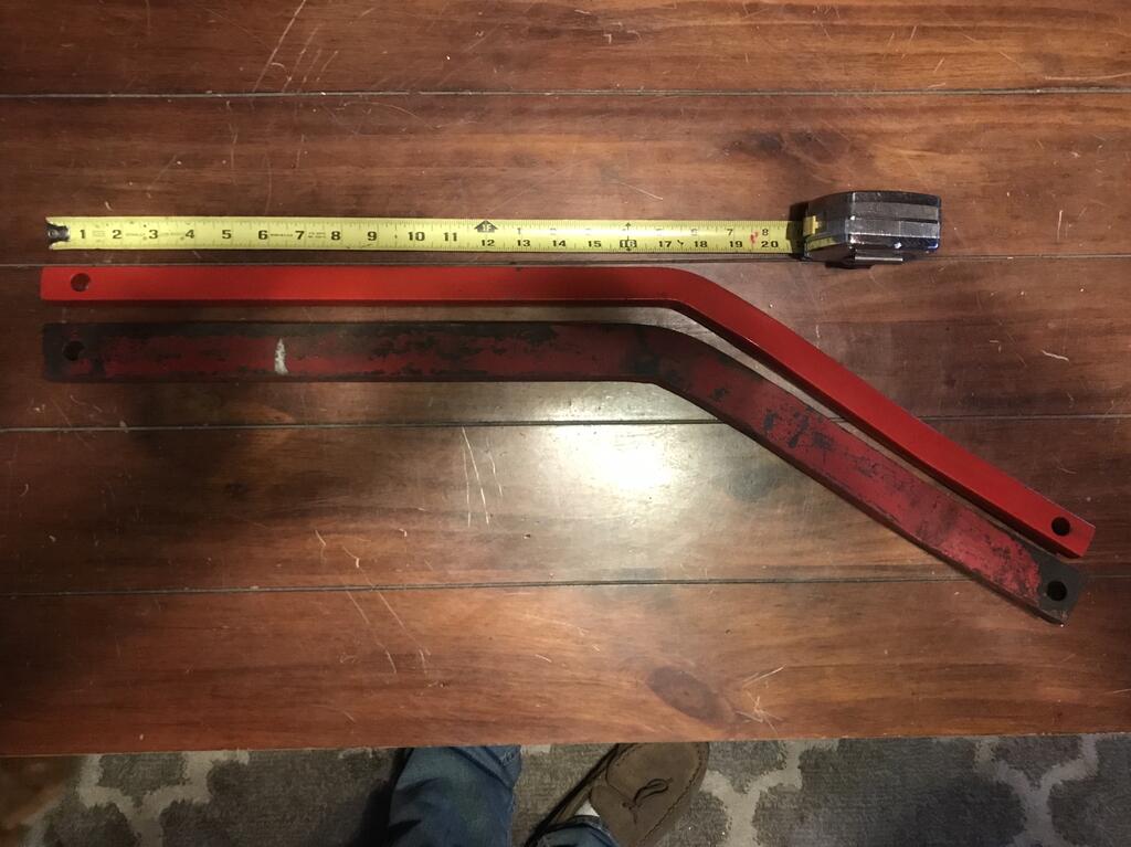

Super-C 4 me 612 #52 Posted May 7, 2020 20 hours ago, pullstart said: @pfrederi @Super-C 4 me @fast88pu @953 nut if anyone could take a few moments and measure length between bends and maybe even approximate angles, I’d like to take a try at building a linkage bar in the next couple days! Thanks in advance! let me know now if you need anything else 1 1 Share this post Link to post Share on other sites

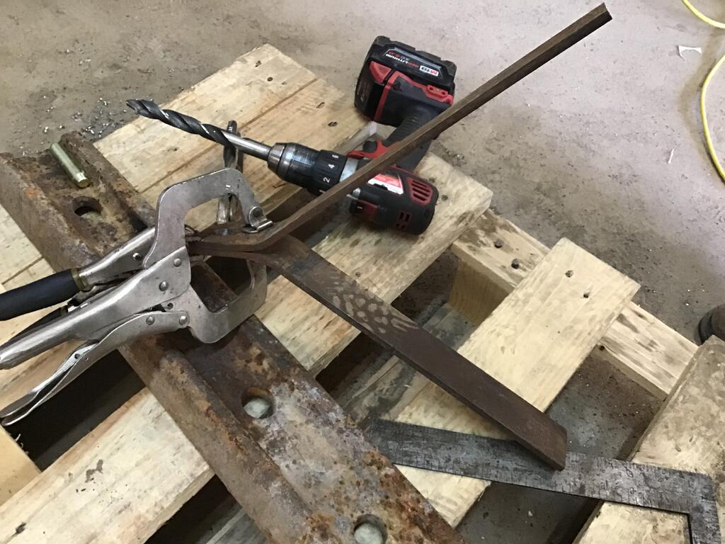

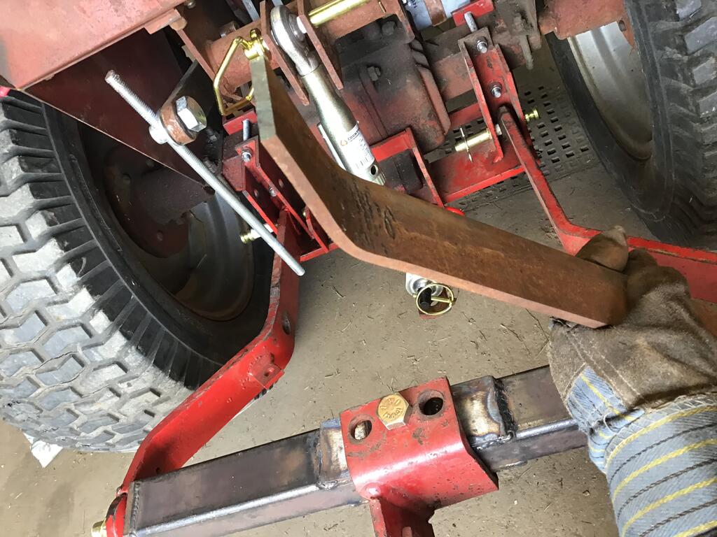

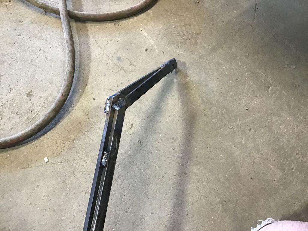

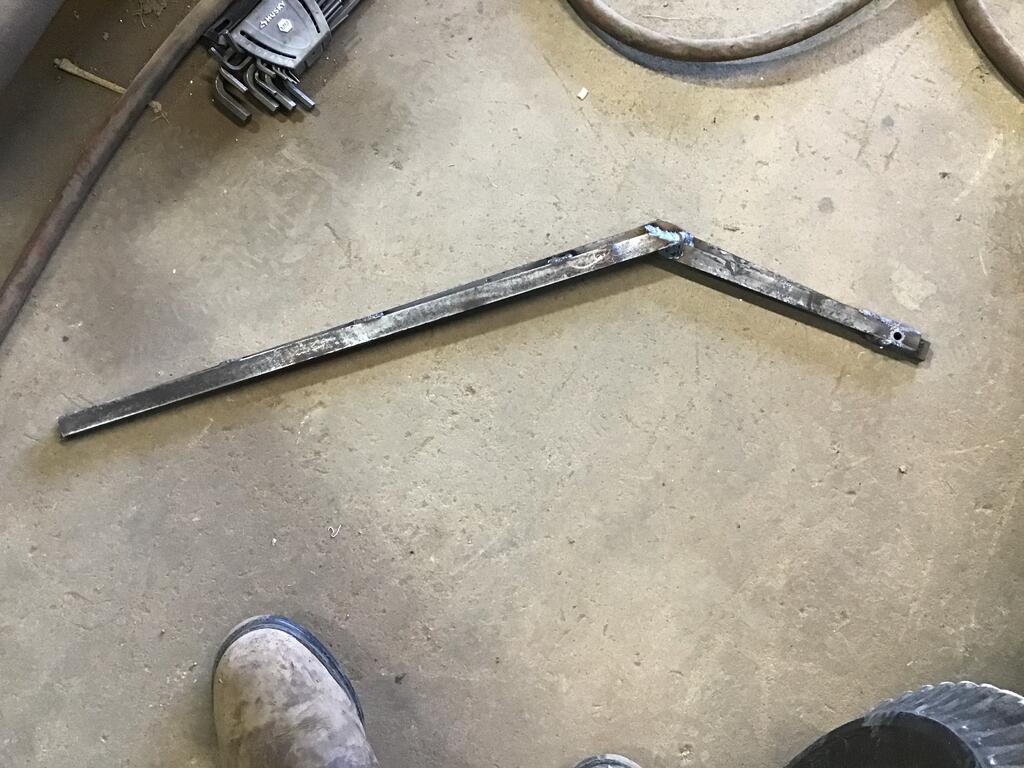

Pullstart 71,564 #53 Posted May 7, 2020 Thanks Brian! I started playing around and have come up with this! time to get playing with the torch and forge my holes! 2 2 Share this post Link to post Share on other sites

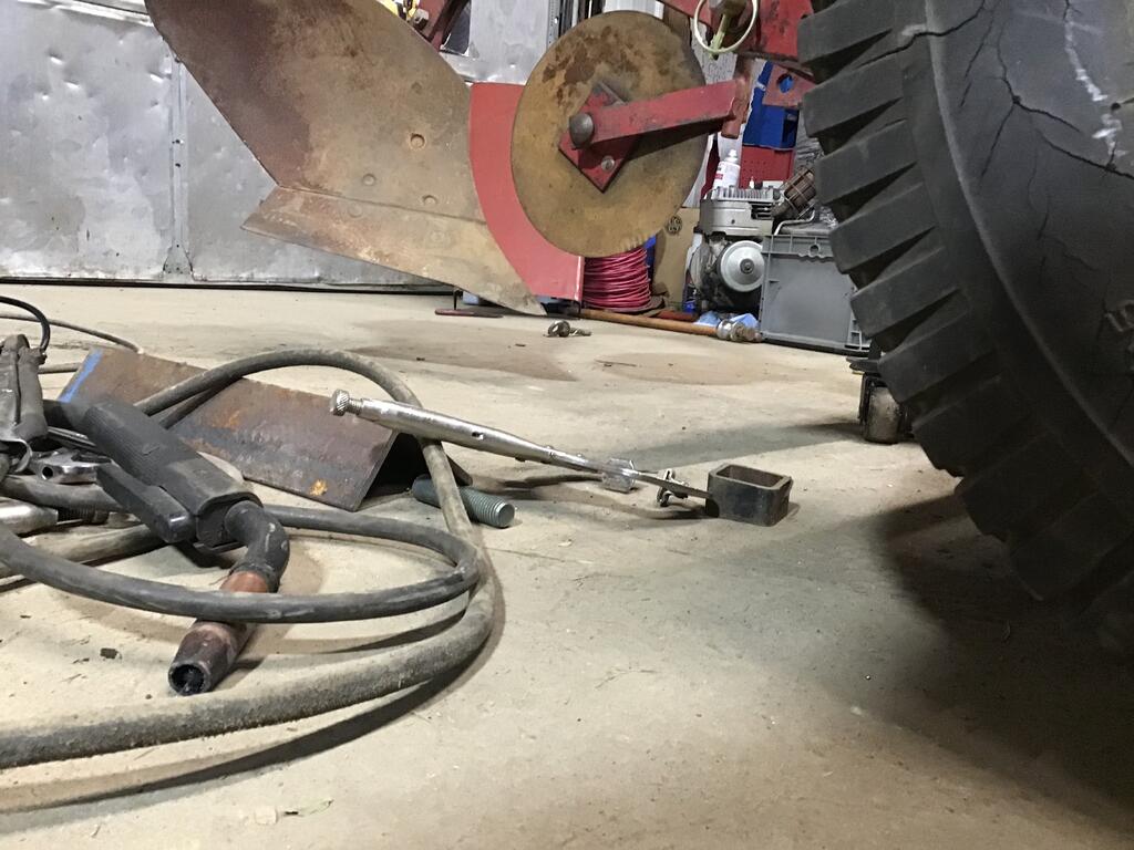

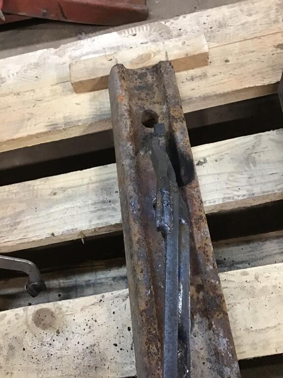

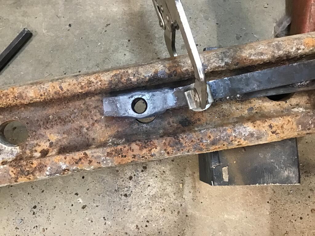

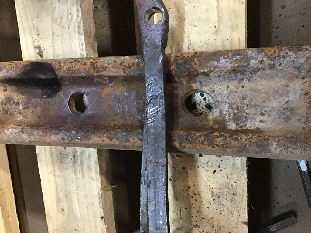

Pullstart 71,564 #54 Posted May 7, 2020 I could easily weld this thicker and drill a hole, but I’ve always wanted to try forging something molten. It’s almost ready for a 5/8” pin! 1 Share this post Link to post Share on other sites

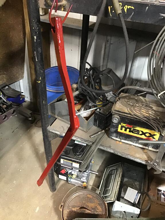

Pullstart 71,564 #55 Posted May 8, 2020 I suppose if I continue to forge tools or accessories, I should up my PPE in the shop! I’ve got a couple burns from super hot metal, but I was so close to being done I pressed on! 1 Share this post Link to post Share on other sites

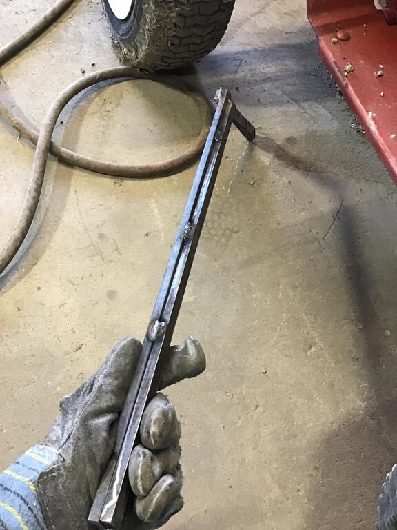

Pullstart 71,564 #56 Posted May 8, 2020 It works! 4 1 1 Share this post Link to post Share on other sites

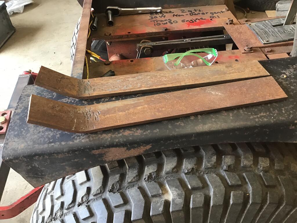

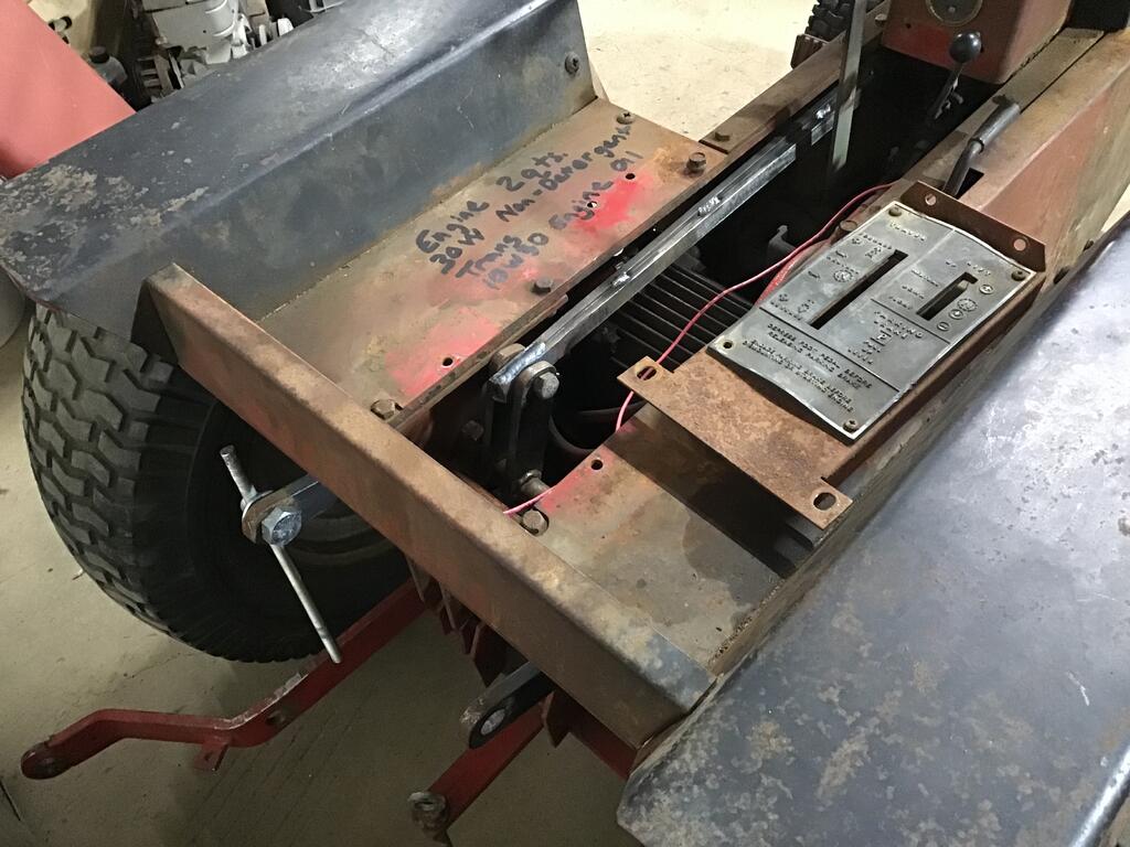

Pullstart 71,564 #58 Posted May 8, 2020 I was concerned with the corner of the lift bar colliding with the motion control bezel so I did some quick cold forming today. I just grabbed this rusty chunk of iron out of my FIL’s scrap pile a week or two ago, not knowing what I’d use it for. I see it becoming a useful shaping tool for stuff like this! 1 Share this post Link to post Share on other sites

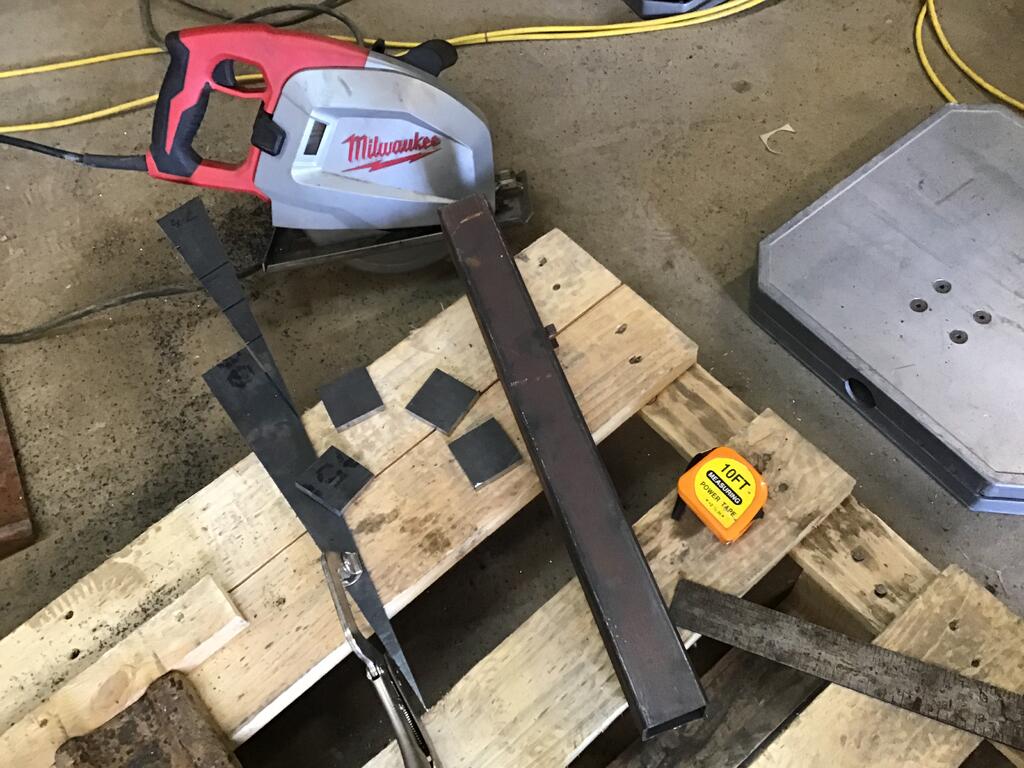

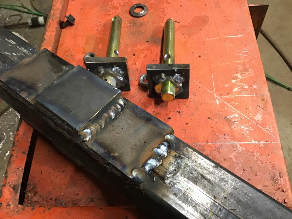

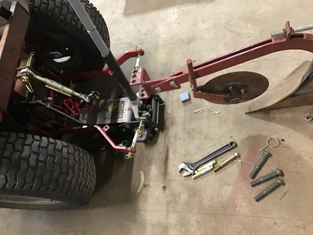

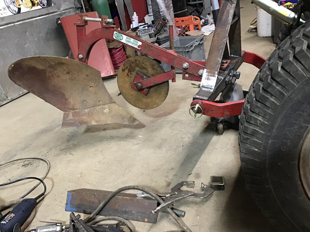

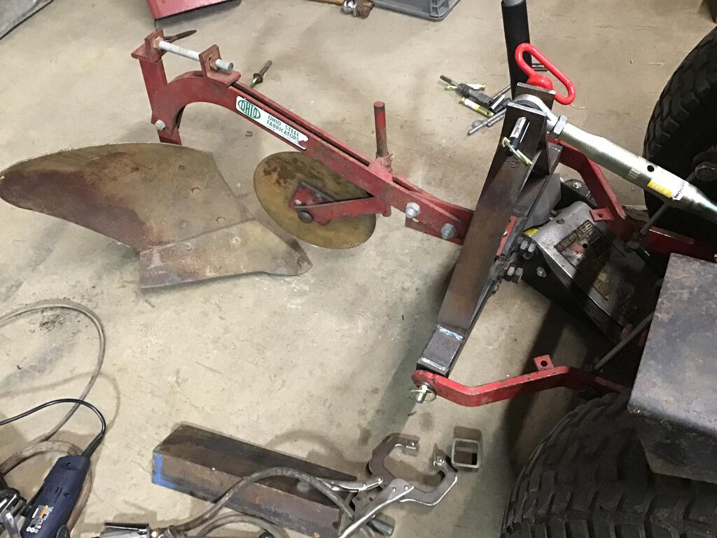

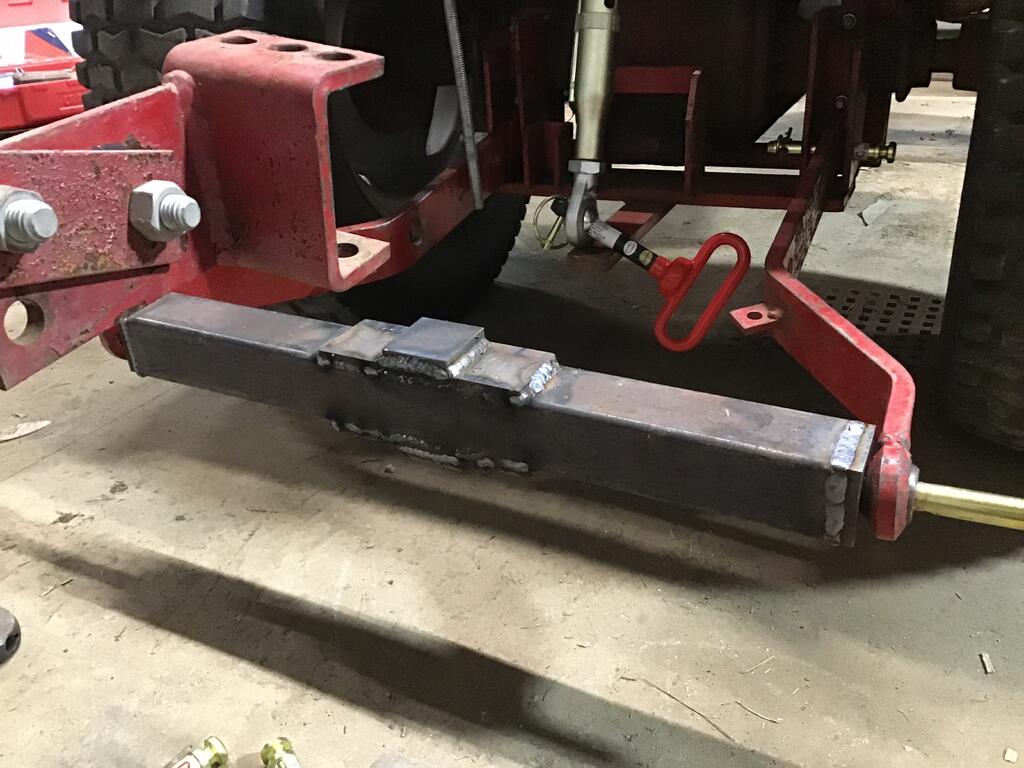

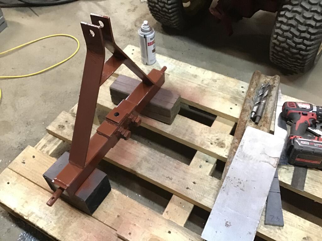

Pullstart 71,564 #59 Posted May 8, 2020 A few pieces cut to build a Brinly 3 point adapter... 1 Share this post Link to post Share on other sites

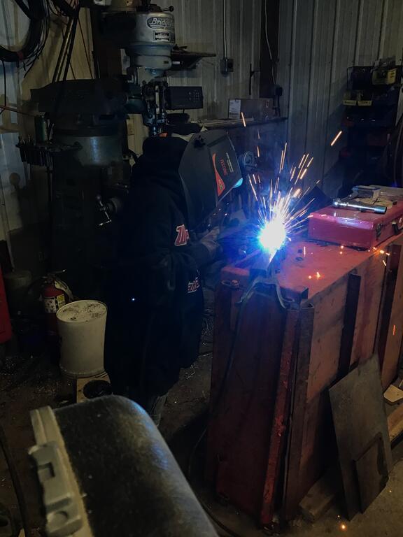

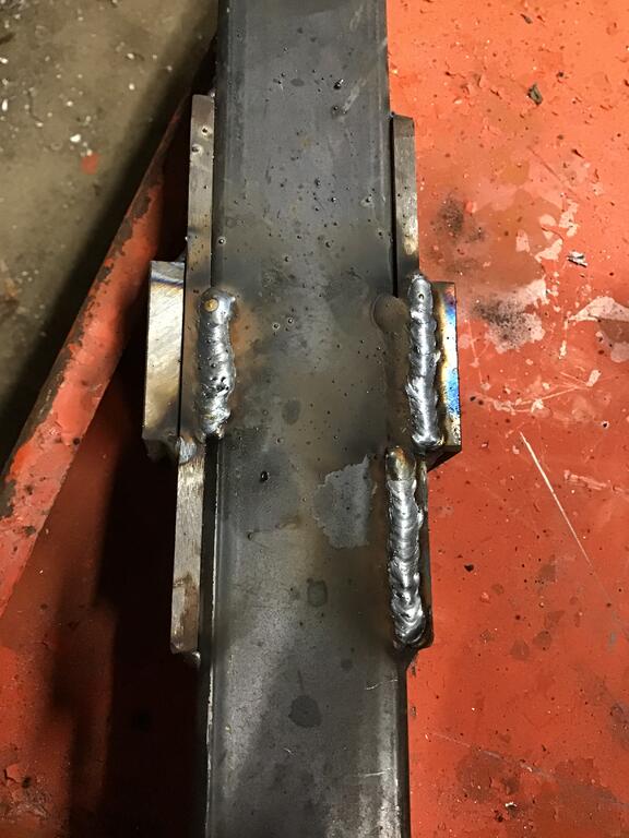

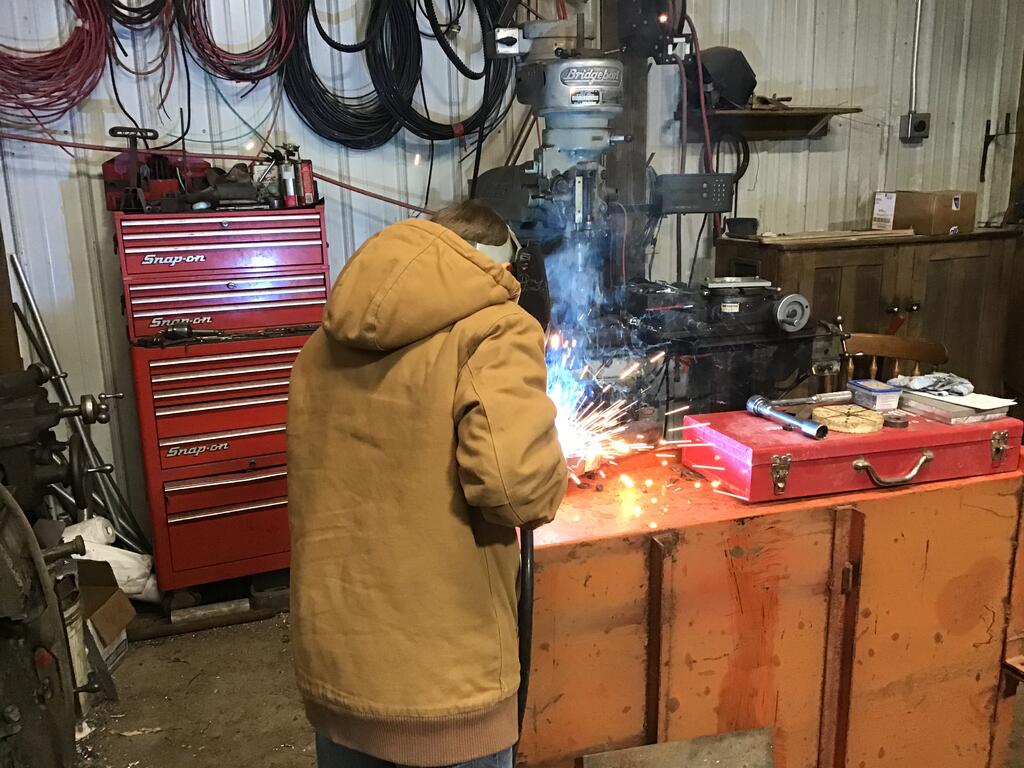

Pullstart 71,564 #60 Posted May 8, 2020 The delivery boy came, shiny stuff showed up! Walker is welding his own hitch 1 2 Share this post Link to post Share on other sites
Pullstart 71,564 #61 Posted May 8, 2020 Kid’s pretty good! 3 Share this post Link to post Share on other sites
Pullstart 71,564 #62 Posted May 8, 2020 Rylee helped for a bit. She struggles with control of the MIG gun by herself, but Walker was very encouraging to her as well! He’s so excited to tell his friends that he welded his own hitch! 4 Share this post Link to post Share on other sites

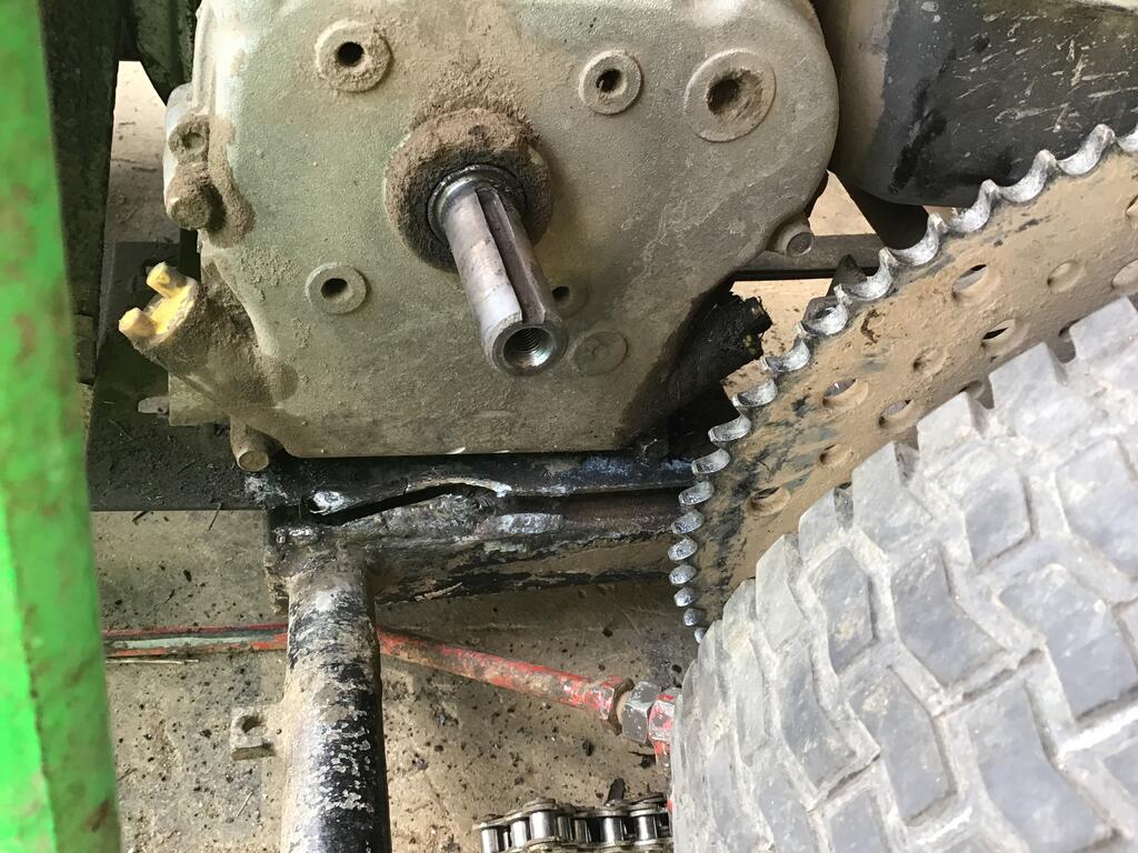

Pullstart 71,564 #65 Posted May 8, 2020 Pit stop! Broken motor mount! 1 Share this post Link to post Share on other sites
ebinmaine 81,283 #66 Posted May 8, 2020 6 minutes ago, pullstart said: Pit stop! Broken motor mount! You gotta weldah? 1 Share this post Link to post Share on other sites

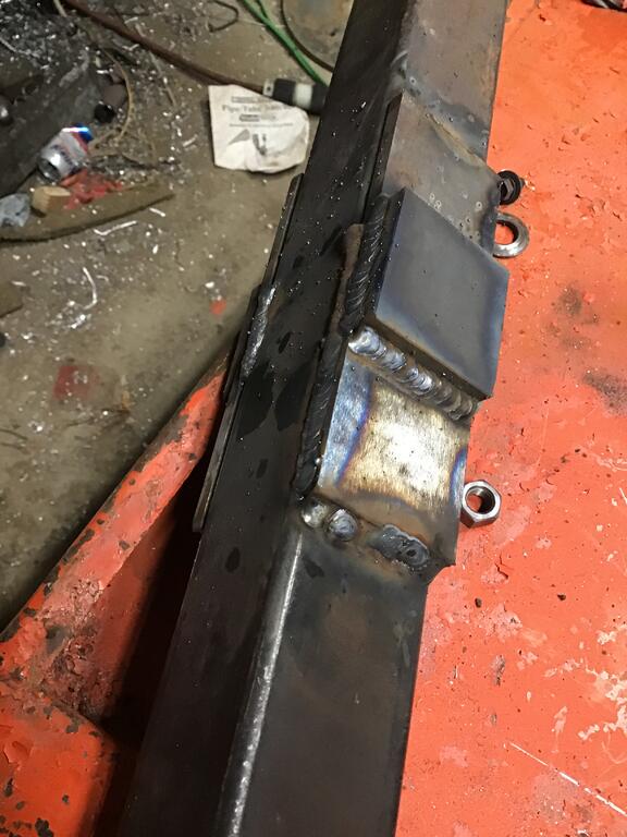

Pullstart 71,564 #68 Posted May 9, 2020 Monster 3/4” stop bolts with jam nuts! 1 1 Share this post Link to post Share on other sites

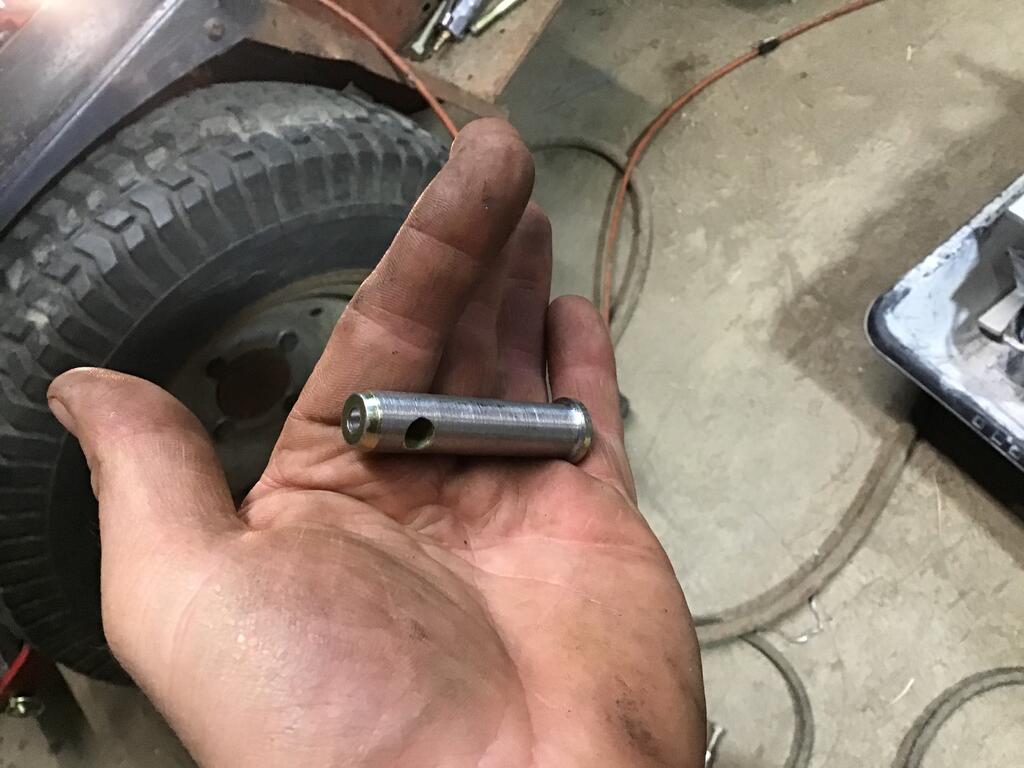

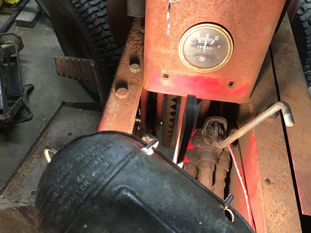

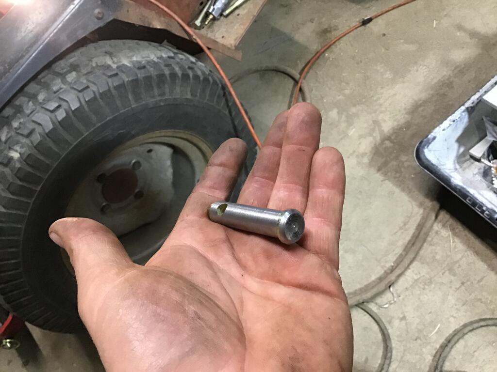

Pullstart 71,564 #69 Posted May 9, 2020 A pin is machined to fit between the rock shaft and steering fan gear. There’s not a ton of room in there! 2 1 Share this post Link to post Share on other sites

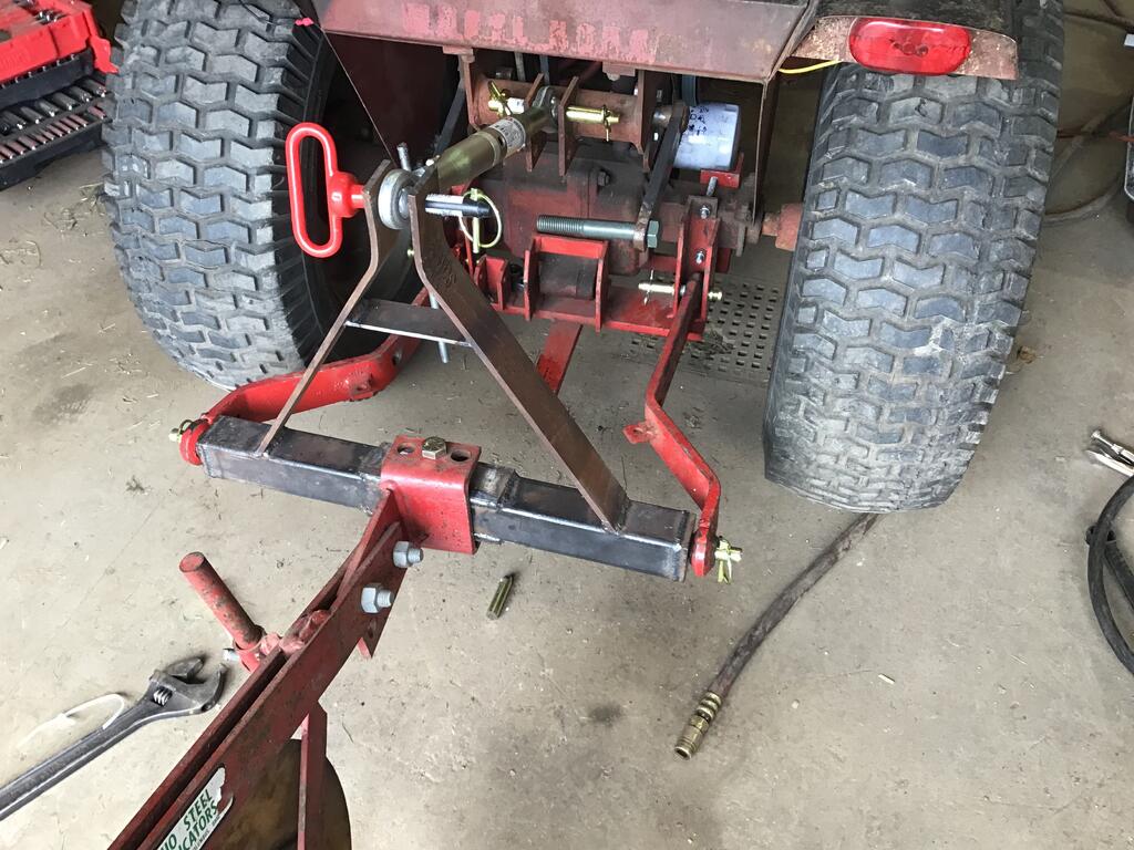

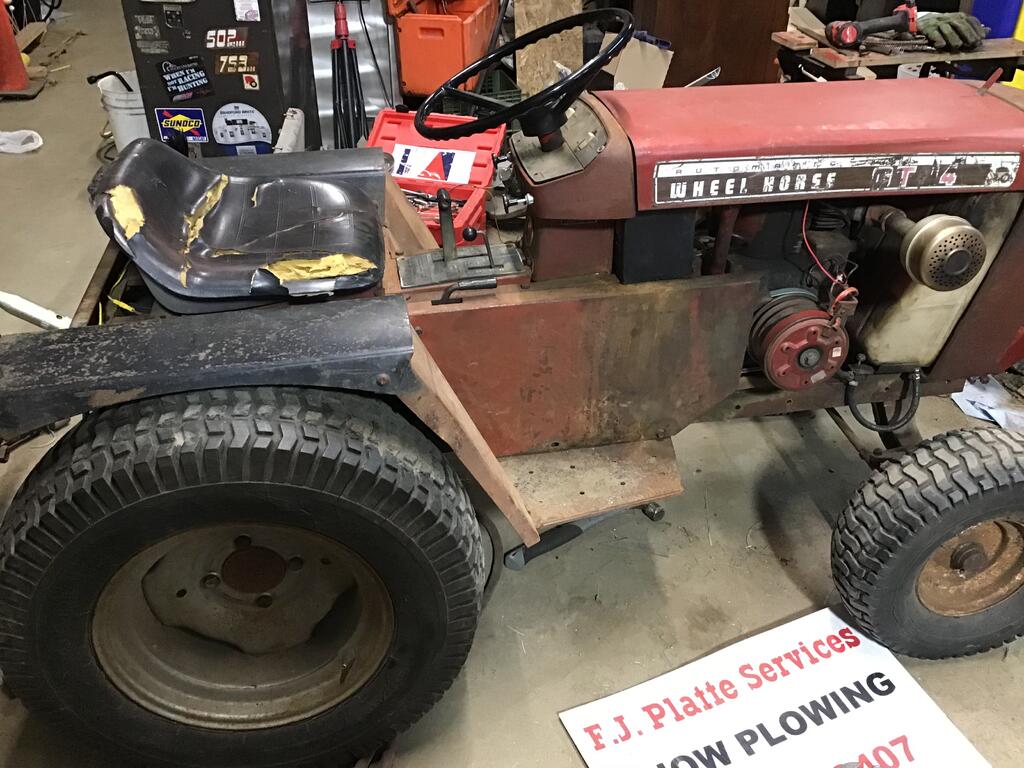

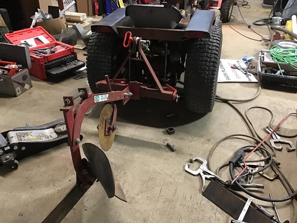

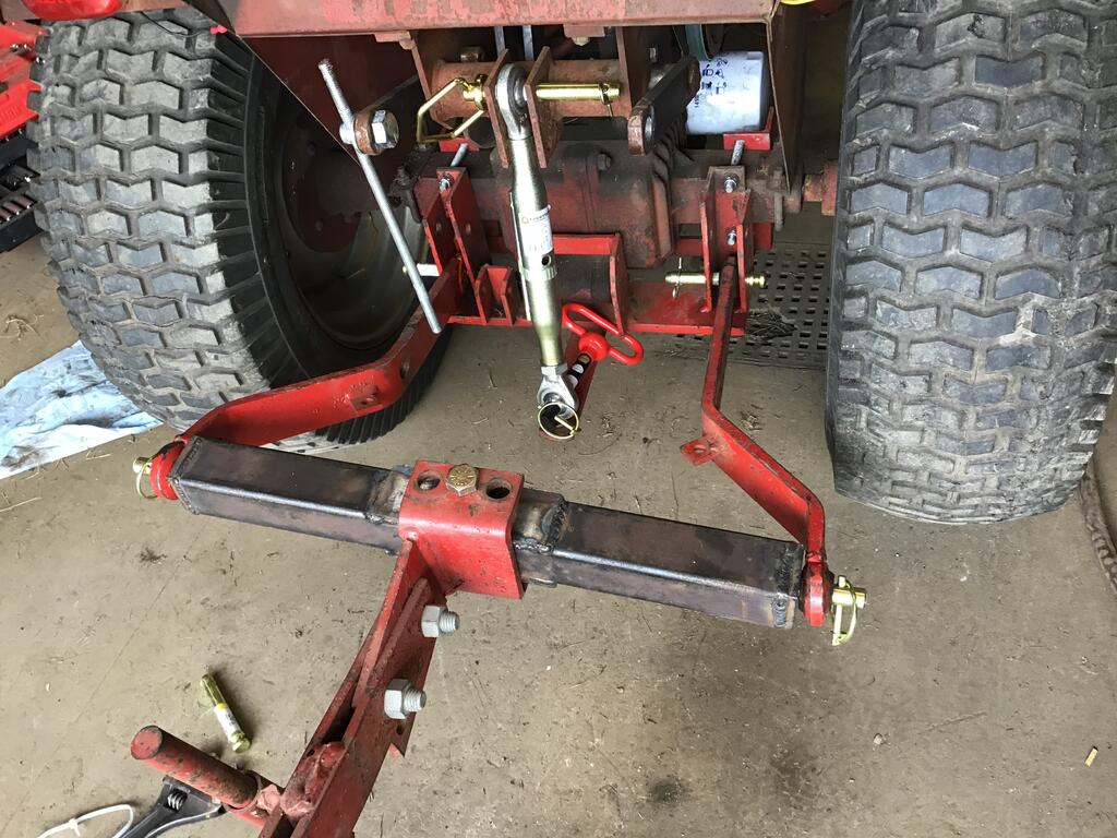

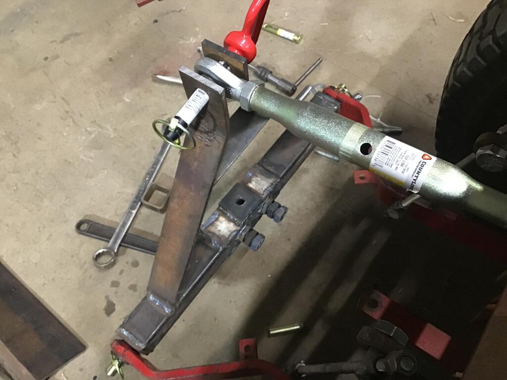

Pullstart 71,564 #70 Posted May 9, 2020 It lifts! The plow is just 3-1/2” off the ground at full height, but some plows just scrape the ground in the lift position. I can’t wait to see the boys drop this in a furrow so we can do some real testing and tuning! I’m going to paint the lift rod so I can get the bezel and seat back on for them, then prime the hitch and let them paint it! 2 1 Share this post Link to post Share on other sites
Pullstart 71,564 #71 Posted May 9, 2020 Stuff is in primer and paint. 1 1 Share this post Link to post Share on other sites
Pullstart 71,564 #72 Posted May 9, 2020 It’s back together for test and tune sessions! 2 1 Share this post Link to post Share on other sites
953 nut 70,662 #73 Posted May 9, 2020 10 hours ago, pullstart said: The plow is just 3-1/2” off the ground at full height, but some plows just scrape the ground in the lift position. Take up a couple more turns on the top link and it will go higher. 1 Share this post Link to post Share on other sites
Pullstart 71,564 #74 Posted May 9, 2020 1 minute ago, 953 nut said: Take up a couple more turns on the top link and it will go higher. I moved it to the bottom hole to shorten it up at lift and it helped a bit. The top link is a standard “Cat O” from TSC and is as short as it’ll go in stock trim. I have been known to take a few turns off on a lathe for other projects. I can’t see why this would be any different... Thanks Richard! 1 Share this post Link to post Share on other sites
Tractorhead 9,218 #75 Posted May 9, 2020 The top links are available in different lenghts. maybe a shorter toplink fits better, of if no shorter available, simply cut the edges about 5mm each side. That doesnt‘s give you a weak point at all, but improves the liftheight a bit more. 1 1 Share this post Link to post Share on other sites
