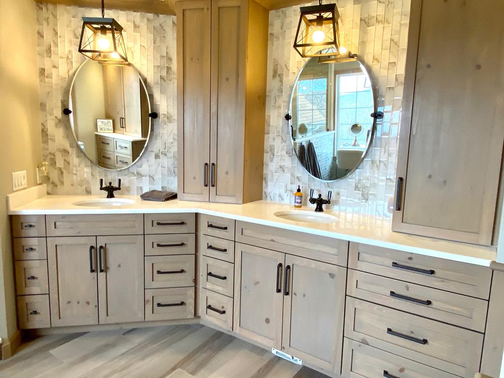

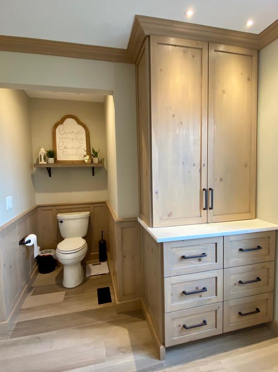

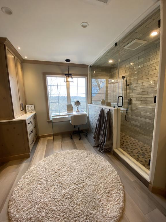

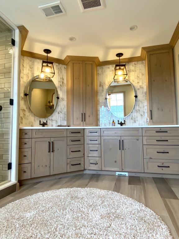

formariz 12,359 #1 Posted April 24, 2020 (edited) Had this client for a few years where I exclusively do all the woodwork in their house. This is the recently completed master bath. Edited April 24, 2020 by formariz 11 9 5 Share this post Link to post Share on other sites
oliver2-44 11,409 #2 Posted April 24, 2020 Beautiful work. I count 41 doors and drawer fronts. This week I sprayed 41 identical design drawers and doors for my sons kitchen cabinets. 1 1 Share this post Link to post Share on other sites
SylvanLakeWH 31,143 #3 Posted April 24, 2020 Nice work! Wow - Beautiful! (The toilet paper is probably a non-contract "added cost item" these days!) 6 Share this post Link to post Share on other sites
formariz 12,359 #4 Posted April 24, 2020 (edited) 13 minutes ago, oliver2-44 said: Beautiful work. I count 41 doors and drawer fronts. This week I sprayed 41 identical design drawers and doors for my sons kitchen cabinets. Thank you .Right. Tons of work on those. These are not sprayed. I do a hand rubbed finish. Pretty tedious. Four coats of top coat each sanded with 320 sterated paper, with final coat hand rubbed with very fine white scotch brite pad. Panels are finished prior to assembling frames around them Final product is silk smooth. Doors have same finish inside. Final test is throwing a rag against one end of longest door. If it slides all the way to the other end then its right. Just a little playful thing I do to aggravate my wife every time she peaks in and asks "is it done yet". Edited April 24, 2020 by formariz 1 Share this post Link to post Share on other sites

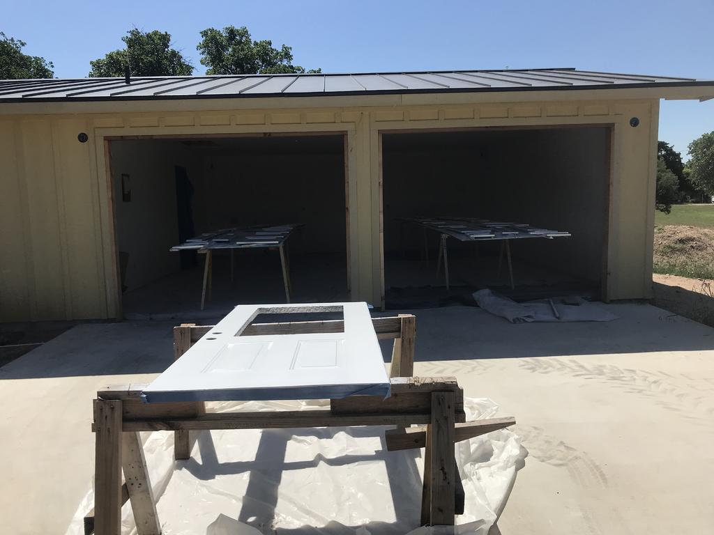

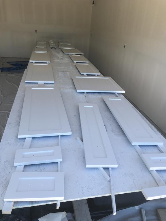

oliver2-44 11,409 #6 Posted April 24, 2020 @formariz I would like to learn more about your hand rubbed finish. I've been doing lacquer finish on cabinets and furniture for awhile and personally prefer to show off the wood grain. My daughter-in-law wanted white cabinets so I sprayed them with the shelac base original Kilz, sanded them with 220, buffed with red scotchbrite, then sprayed them with white oil based enamel with hardener like I use on my tractors. Not to steal your thread, but heres a little of Tuesdays work painting the back side, and this mornings work spraying the front side. 5 3 Share this post Link to post Share on other sites

ZXT 2,401 #8 Posted April 24, 2020 1 hour ago, formariz said: Had this client for a few years where I exclusively do all the woodwork in their house. This is the recently completed master bath. Man, that looks excellent! I have a special respect for carpenters. I certainly couldn't do that! 3 minutes ago, oliver2-44 said: @formariz I would like to learn more about your hand rubbed finish. I've been doing lacquer finish on cabinets and furniture for awhile and personally prefer to show off the wood grain. My daughter-in-law wanted white cabinets so I sprayed them with the shelac base original Kilz, sanded them with 220, buffed with red scotchbrite, then sprayed them with white oil based enamel with hardener like I use on my tractors. Not to steal your thread, but heres a little of Tuesdays work painting the back side, and this mornings work spraying the front side. Someone is going to have fun putting up the light on the left side of the garage! Stinkin' trim.. Share this post Link to post Share on other sites

953 nut 65,407 #10 Posted April 24, 2020 Considering the view from that window I'm not too sure I would ever want to leave the bathroom. 1 2 1 Share this post Link to post Share on other sites

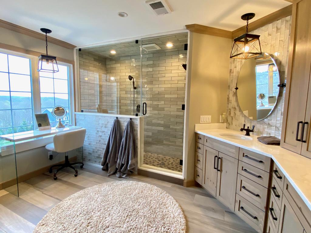

formariz 12,359 #14 Posted April 24, 2020 3 hours ago, 953 nut said: Considering the view from that window I'm not too sure I would ever want to leave the bathroom. She spends a lot of time at that window doing her makeup and thinking about the next project. 2 hours ago, CCW said: Isn't it nice that some people have plenty of money to pay you for this kind of work. I am impressed with it's beauty. Great down to earth modest people not reflecting their money in their attitudes. He is a very famous surgeon in NYC. There never is an estimate required, she simply states what she wants being very particular about finishes and colors. I usually have to do half dozen finish samples before she approves one. 1 hour ago, pullstart said: Caz, that is an amazing bathroom! Please don’t ever show this to my wife! I’m afraid I’d be in the gutter and she’d find a real craftsman like yourself to build her a real nice bathroom! LOL thank you. I get in trouble here too lots of times. She sees the stuff and then gets ideas. Lucky for me most of the stuff I make would not even fit in my house. Ill post HER personal closet next. Definitely don't let your wife see that one. 1 Share this post Link to post Share on other sites
