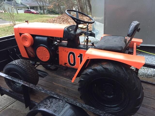

12Horse Paladin 1,038 #58 Posted July 23, 2020 On 4/22/2020 at 6:45 PM, pullstart said: We broke Quarantine to go get it It still needs The Flag😊👍🏼 1 Share this post Link to post Share on other sites
12Horse Paladin 1,038 #59 Posted July 23, 2020 On 4/22/2020 at 8:48 PM, pullstart said: Someone already took that idea... with a GT-14 here lately i need to see that GT-14😍👍🏼👍🏼 PLZ? Share this post Link to post Share on other sites
Pullstart 70,694 #60 Posted July 23, 2020 3 hours ago, 12Horse Paladin said: i need to see that GT-14😍👍🏼👍🏼 PLZ? Share this post Link to post Share on other sites
Sailman 1,307 #61 Posted July 28, 2020 Ok. I usually don't get that much attention about the GT 14 but ....inquiring minds want to know...so happy to comply.... I'm sure you will appreciate this "true rebel" down here in Georgia! The guys on this forum warned me... I now have the GT 14 and 2 - C120's....addiction has struck! Good luck with rebel. 2 2 Share this post Link to post Share on other sites

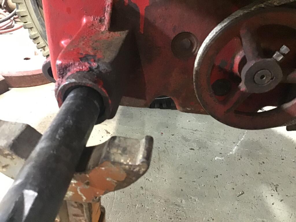

Pullstart 70,694 #67 Posted October 15, 2020 Rebel’s got no axle seals and didn’t have an input pulley either. I grabbed the pulley off of the 1054 roller for the time being so I can say I put the belt on. I need to put a brake rod together and assemble the brakes so I can connect the clutch spring and see if it’ll move after a top off of fresh gear lube! 1 1 Share this post Link to post Share on other sites
953 nut 67,392 #69 Posted October 15, 2020 41 minutes ago, pullstart said: got no axle seals Probably made hub removal easy? 4 Share this post Link to post Share on other sites
Pullstart 70,694 #70 Posted October 15, 2020 12 minutes ago, 953 nut said: Probably made hub removal easy? This trans had just been gone through before I picked it up... it’s still dry inside. Plenty of anti-seize on the axles helped slide the hubs right off though! 3 Share this post Link to post Share on other sites

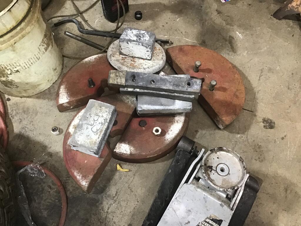

Pullstart 70,694 #72 Posted October 16, 2020 More lead than I can carry in one trip across the shop should help weigh Rylee down in the furrow! Sorry @Coulter Caleb @Shynon @prondzy, I think this might work better than oatmeal and bricks! I’ll bolt two pieces on to the sides of the grill, then place a few blocks in the tool box too. 2 Share this post Link to post Share on other sites
Achto 32,095 #73 Posted October 16, 2020 13 hours ago, pullstart said: This trans had just been gone through before I picked it up... So, were they out of axle seals when it was put together?? 1 Share this post Link to post Share on other sites
Pullstart 70,694 #74 Posted October 16, 2020 2 minutes ago, Achto said: So, were they out of axle seals when it was put together?? No idea. Come to find out, just the right side was missing. Honest mistake? Who knows. The parts store has 4 11050’s waiting for me 2.5 miles away! 1 Share this post Link to post Share on other sites

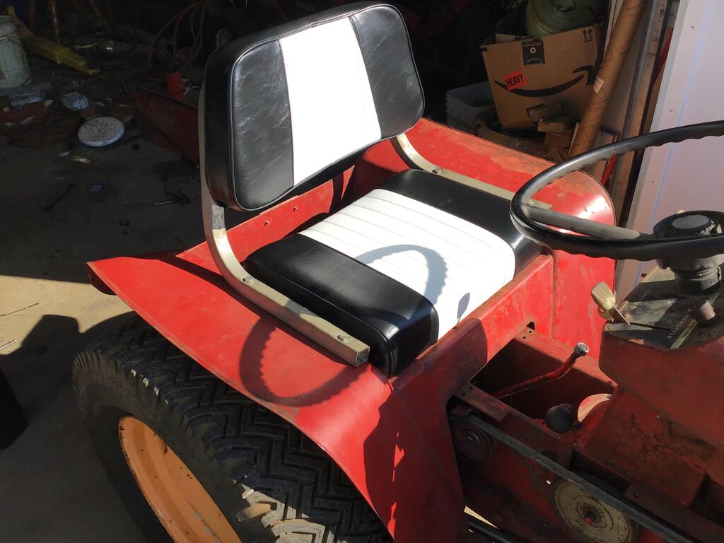

Pullstart 70,694 #75 Posted October 16, 2020 Rylee’s gonna be plowing in style with this new @BOB ELLISON seat! 1 1 Share this post Link to post Share on other sites
