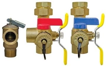

WHX?? 58,308 #7 Posted April 22, 2020 I would go with regular pex fittings but only cause all I would have to do is back my work truck up to the door and have everything I would need! Shark bites can get a bit pricey for me but they would work fine. They offer a whole host of clamps, hangars and what not for support. Make sure you get a valve kit for the tankless. Think the advice of a plunger who puts bacon on his table by doing this is needed here @JCM…. 1 Share this post Link to post Share on other sites
