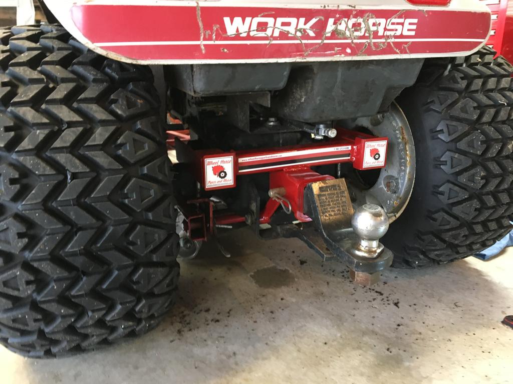

Sparky-(Admin) 26,304 #2 Posted April 20, 2020 I always recommend these...Carlisle All Trails...best of both worlds . 5 2 Share this post Link to post Share on other sites

JCM 11,415 #7 Posted April 20, 2020 to I am a big Carlisle fan because of looks and longevity and have had great luck with the Turfs for three seasons and add 2 link chains and wheel weights for Winter and they work well for me. I would like a set of those All Trails on one of my tractors someday that @Sparky runs on his WorkHorse because they look just Awesome. 5 1 1 Share this post Link to post Share on other sites

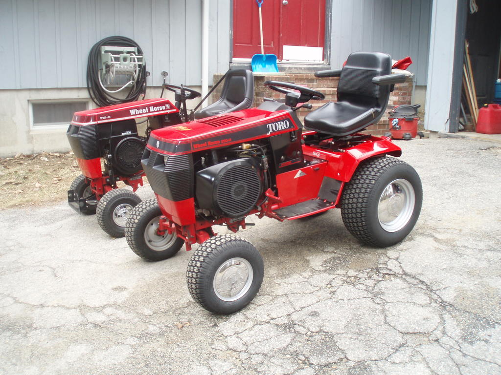

WHX?? 58,057 #13 Posted April 20, 2020 (edited) No EB ther is a link to all sorts of tire suppliers in links to suppliers here. Don't make me do it or I gonna kill brain cells I gotta do it on a dumb phone..Jeepers cats Plunger that is one fine lookin 520 ther... you tryin to start a war on a fine lookin 520s thread? Like I said Bob we don't get out much these days! Edited April 20, 2020 by WHX24 4 Share this post Link to post Share on other sites
