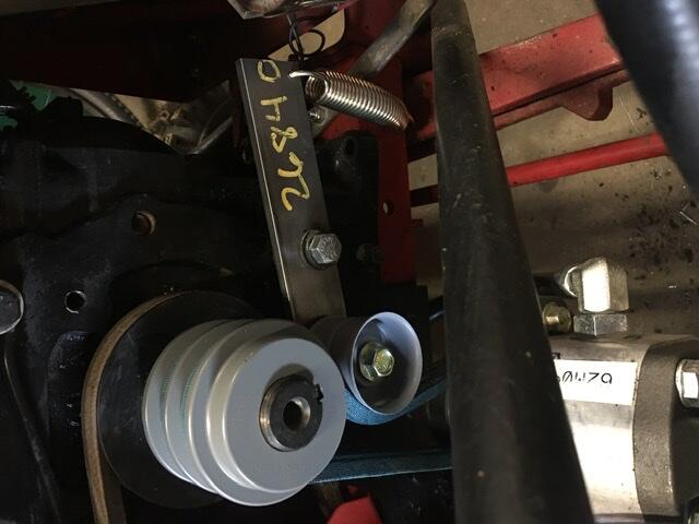

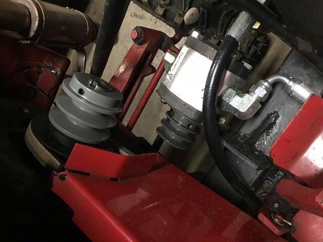

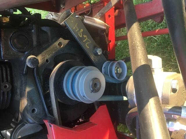

KrazeyOlDave 860 #77 Posted July 1, 2020 16 hours ago, Jhook said: What was the approximate material cost for this whole build? Minus the tractor I stole the tractor for $200 and put new tires, seat, starter and battery in it. The bucket build itself was roughly 2K. So you all know about the belt slipping issues, I think I have it fixed. I’m going to test it later today. Looks a bit crude but I’ll radius the bracket and paint it if it pans out. 2 1 Share this post Link to post Share on other sites

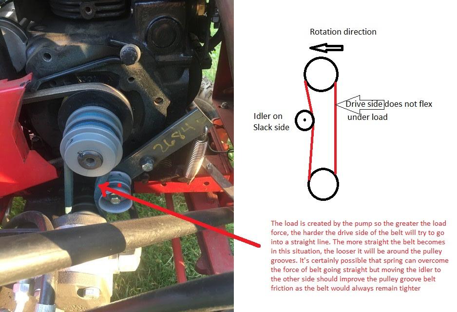

wallfish 19,992 #78 Posted July 1, 2020 (edited) 3 hours ago, KrazeyOlDave said: So you all know about the belt slipping issues, I think I have it fixed. I’m going to test it later today. Looks a bit crude but I’ll radius the bracket and paint it if it pans out. Maybe not necessary but applying the tension to the slack side of the belt loop could hold better. The drive side of the belt will tension more under load and try to push out on the idler pulley. If it pushes out the pulley the belt loop will be getting looser around the pulley groove. With all the tension applied on the slack side, the drive side of the belt loop directly drives the driven pulley. Does that make sense? Edited July 1, 2020 by wallfish Share this post Link to post Share on other sites
KrazeyOlDave 860 #79 Posted July 2, 2020 Didn’t like how hot it was getting, just too much loop. So I threw on a 1” shorter belt, much better! 1 Share this post Link to post Share on other sites
KrazeyOlDave 860 #80 Posted July 2, 2020 1/4 throttle scoop IMG_4909.3gp 2 Share this post Link to post Share on other sites
KrazeyOlDave 860 #81 Posted July 2, 2020 2 hours ago, wallfish said: Maybe not necessary but applying the tension to the slack side of the belt loop could hold better. The drive side of the belt will tension more under load and try to push out on the idler pulley. If it pushes out the pulley the belt loop will be getting looser around the pulley groove. With all the tension applied on the slack side, the drive side of the belt loop directly drives the driven pulley. Does that make sense? I think so 🤔 it spins counter clockwise Share this post Link to post Share on other sites

wallfish 19,992 #83 Posted July 2, 2020 9 hours ago, KrazeyOlDave said: I think so 🤔 it spins counter clockwise Again this may not be necessary if it's not slipping but something to try if it is slipping 2 2 1 Share this post Link to post Share on other sites
KrazeyOlDave 860 #84 Posted July 2, 2020 (edited) 31 minutes ago, wallfish said: Again this may not be necessary if it's not slipping but something to try if it is slipping Gotcha, thank you so much for making that clear!!! Excellent info sir, I appreciate it!!! Edited July 2, 2020 by KrazeyOlDave 1 Share this post Link to post Share on other sites

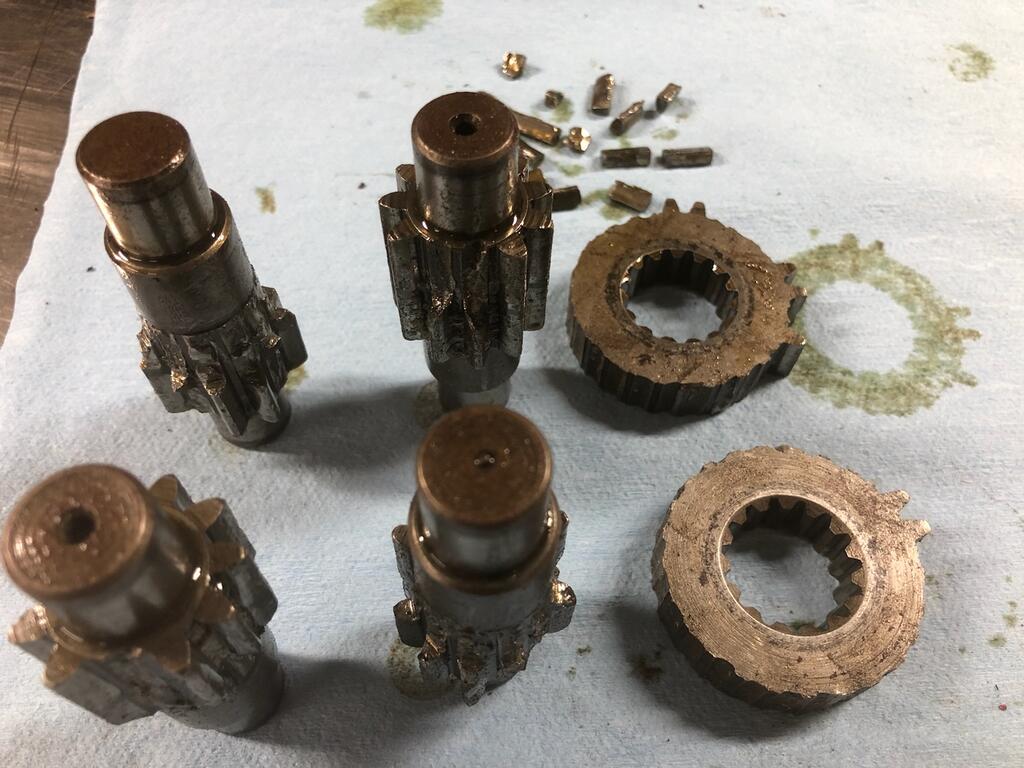

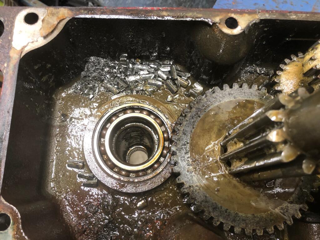

KrazeyOlDave 860 #87 Posted July 5, 2020 (edited) On 7/2/2020 at 7:26 AM, pullstart said: Good stuff in this thread! The more you work it, the less you’ll wanna sell it Yep! Except I think my differential just puked...it’s making a clink sound every few minutes...sounds like someone is hitting the fender with a big bolt. I’d LOVE to upgrade the rear end but not a clue what bolts in. Hydrostatic drive would be sweet but it’s probably not a bolt and go. My axles are 1” diameter... I need to upgrade to the 1 1/8” I think? I’ve read the C160 is the strongest? Edited July 5, 2020 by KrazeyOlDave 1 Share this post Link to post Share on other sites
Pullstart 69,983 #88 Posted July 5, 2020 Anything 1-1/8” axle would work for ya, anything 8 speed would bolt right in. Lowell @wheelhorseman sells the transmission case gaskets, it might be worth a look inside. There are plenty of parts available to fix what you have, or look for a donor with the larger axles. @davidtmercer did have an arrangement of transmissions, he’s just south of the MI border off 131. It might be worth asking him what he”s got. 1 1 1 Share this post Link to post Share on other sites
KrazeyOlDave 860 #89 Posted July 5, 2020 28 minutes ago, pullstart said: Anything 1-1/8” axle would work for ya, anything 8 speed would bolt right in. Lowell @wheelhorseman sells the transmission case gaskets, it might be worth a look inside. There are plenty of parts available to fix what you have, or look for a donor with the larger axles. @davidtmercer did have an arrangement of transmissions, he’s just south of the MI border off 131. It might be worth asking him what he”s got. Thank you!!!!! 2 1 Share this post Link to post Share on other sites

KrazeyOlDave 860 #92 Posted July 10, 2020 @davidtmercer hooked me up! Here’s what he found inside my old one. 1 1 3 Share this post Link to post Share on other sites

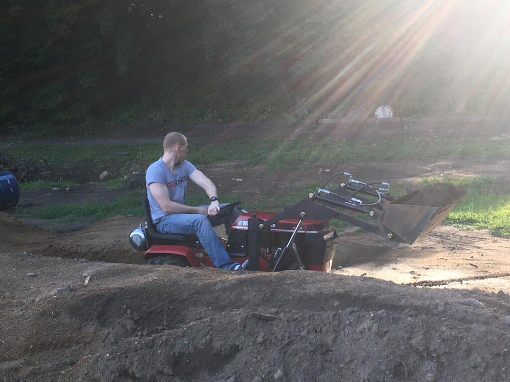

KrazeyOlDave 860 #93 Posted July 12, 2020 Back up and running...my youngest trying it out. IMG_5126.MOV 3 1 Share this post Link to post Share on other sites

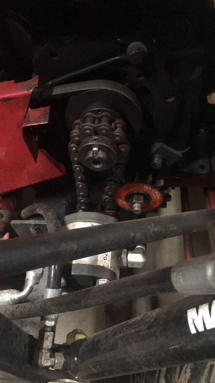

KrazeyOlDave 860 #95 Posted October 8, 2020 Long time, no updates. I didn’t have to move after all. FEL is still kicking butt. Slight change to the pump drive, no issues all summer long. 3 1 Share this post Link to post Share on other sites
Tractorhead 9,217 #96 Posted October 9, 2020 Great to hear you can keep it. Allway‘s a good feeling, if you calculate or even estimate Things, construct them and they last. 👍 1 Share this post Link to post Share on other sites
Pullstart 69,983 #97 Posted October 9, 2020 Chain drive, is that full time? How does that do for noise? I like the idea of positive engagement and no slip! 1 Share this post Link to post Share on other sites
KrazeyOlDave 860 #98 Posted October 10, 2020 11 hours ago, pullstart said: Chain drive, is that full time? How does that do for noise? I like the idea of positive engagement and no slip! Yep, full time. I used a #60 chain, its not ear banging but it’s definitely louder...sounds like a race car with gear to gear timing, LOL. Now I can use full capacity and no issues. Believe it or not, my tiny tach shows 2100-2200 rpm’s and never have to throttle up. 1 Share this post Link to post Share on other sites

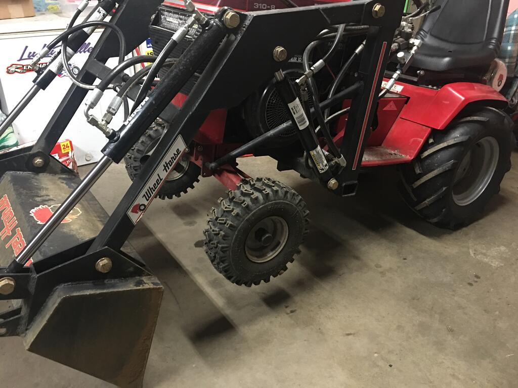

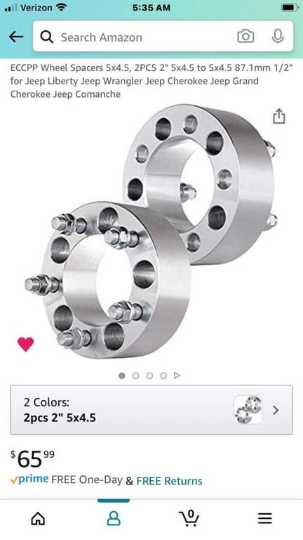

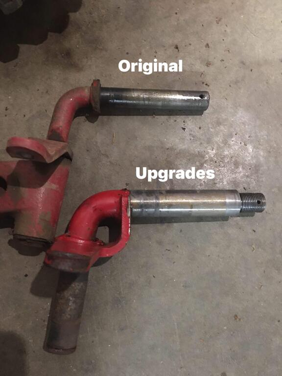

KrazeyOlDave 860 #99 Posted November 7, 2020 It’s that time of the year for upgrades. 520 swept front end install with power steering. Due to the front being wider, I will be adding wheel spacers to the back, and also building a wider bucket. 1 2 Share this post Link to post Share on other sites
Tractorhead 9,217 #100 Posted November 7, 2020 The upgrade of the Spindles looks great. 1 Share this post Link to post Share on other sites
