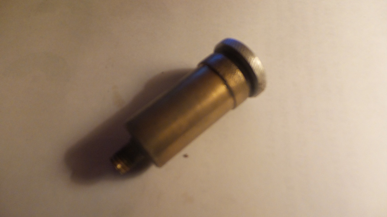

bc.gold 3,406 #12 Posted April 20, 2020 (edited) If your absolutely sure all the air has been bled out and there's fuel coming from under the loosened injector nut and the engine still will not start. Remove the injector, reposition it in such a way that you can reconnect the fuel line, keep your hands etc from under the nozzle from where the fuel is sprayed out. The fuel comes out at a very high pressure, enough to penetrate your skin. Crank the engine over keeping an eye on the nozzle, the fuel should come out in a spray pattern, if your not seeing a spray of fuel them the nozzle is probably clogged with dirt. Unfortunately the only option you have is to replace the injector. Mechanical injectors are pretty basic, the nozzle has some very small holes for the fuel to exit into the cylinder, a needle valve very similar to the one you see on a carburetor float. The injector needle valve is kept in a normally closed position by spring pressure, the high pressure fuel delivered from the pump has enough pressure to lift the needle which in turn sprays fuel into the cylinder. To little or to much spring pressure as you can imagine would either allow fuel early or much to late in the compression stroke. Internal spring tension is adjusted by removing or adding shims. With a pop off tester you can check the pop off pressure at which pressure the fuel is released, check for proper spray pattern and if the nozzle leaks. Fortunately the Chinese clone injector is inexpensive to replace. Edited April 20, 2020 by bcgold 1 Share this post Link to post Share on other sites
bc.gold 3,406 #13 Posted April 20, 2020 15 minutes ago, r356c said: It is a Chinese knockoff of a Yanmar air cooled diesel engine. The manuals say it should go 3000 hours between rebuilds, so it has plenty of life left, There does not seem to be any corrosion to speak of on the external metal parts, so I will assume the cylinder bore and rings are in decent shape. All that is left is fuel delivery. I would drain the tank, clean the finger filter in the tank, put in fresh diesel fuel, check for good gravity fuel flow from the disconnected low pressure fuel line and if that all checked out and still no start, pull and clean the fuel injector. My engines all had a yellow bolt fitting into the combustion chamber to be able to add a few drops of kerosene or cooking oil for cold weather starts. I had better luck with the pull cord rather than electric start for starting a sleepy engine. There should be a decompression lever near the exhaust valve for pull starting. My Lister has these fuel cups to raise the compression. Share this post Link to post Share on other sites

Tractorhead 9,217 #17 Posted April 20, 2020 The easiest way to see if the injector works is to remove it, reconnect it in any other degree in a bottle or a Bowl like in the video and crank the engine. but as allready suggested, please wear urgently eyeprotection and take care it blows in opposite direction to yourself. So you can easily check the whole fuelsystem, if it delivers and if the nozzle only spray‘s. The pressure on the injector is something between 180 - 250Bar pressure and on common rail systems up to few thousand Bar‘s pressure. As allready before mentioned, that cuts you skin and flesh easily. Even a contamination is really Danger in your blood. so please take care of yourself while doing this, get out of the danger zone. the danger zone is up to 20cm distance. if you need a longer highpressure Fuelline mostly brakelines can be used, they are resist to that pressure. i checked mine the same Way as @bcgold shows in the Video. But i did another check with all injectors connected, to see if the Highpressurepump works as it should and if its presure is enough to let the nozzles work correct, but i have no Pict from that. I put under each injector a glass, to see if they work as expected after reworking them. and how many fuel they injected. maybe not the Cleanest Testscenario, but the effectivest, than i cranked the engine 4 times to see what happens. after that test i could be sure the whole fuelsystem works as required and i can put them back in the Head. I learned the hard way, that Eye protection is highly recommended by doing tests with the Diesel Fuelsystem. i don‘t loosing my eyesight, but even the neboulus that occurs not funny in the eyes. 1 Share this post Link to post Share on other sites

Tractorhead 9,217 #19 Posted April 20, 2020 20 minutes ago, bcgold said: A mechanics stethoscope or a stick to your ear, placed onto the injector while turning the engine over preferably on the pull start you will be able to hear the injector as it pops off. That‘s right, you can hear if it reacts, but you can’t hear if the nozzle only spray‘s or if it dribbs or injects a beam. That could be just seen. another issue can happen, if a defect nozzle injects only a beam instead of just a fine spray, it can whash out the piston head over the time, like a extrem small drilled hole in piston top. That also can cause reduced compression. 1 Share this post Link to post Share on other sites
