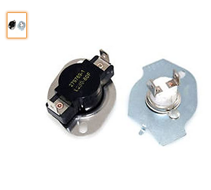

bc.gold 3,406 #3 Posted April 13, 2020 The drum belt keeps tension on the idler pulley should the belt break the idler is released then makes contact with a micro switch to break the electrical circuit or shut down gas supply. Burnt heating element check continuity with multi meter. Faulty thermo switch, usually when these fail the spade connector will show evidence of over heating. Timer could be faulty. Hidden inside the control panel you'll find and envelope that contains the wire schematic and diagnostic codes for late model machines. While you have it apart vacuum all the lint from the inside of the cabinet and the motor, add a few drops of lube onto the oil light bushings, their surrounded by a felt wick. Over time the accumulated lint sucks the oil from the wick ending in premature motor failure. 2 1 Share this post Link to post Share on other sites

bc.gold 3,406 #8 Posted April 13, 2020 4 minutes ago, formariz said: Thank you everyone. Will be digging into it tomorrow. I believe the contacts inside the thermo disk would be normally closed, if you removed the component then used a heat gun on the face if your hearing is good would hear the disk snap open then as it cools down the disk snaps back to a NC position. The multi meter is my best friend. 1 Share this post Link to post Share on other sites

formariz 12,381 #19 Posted April 14, 2020 Tested igniters resistance and its good. Its also intact with no broken or charred element. Tested thermostat #1 it has continuity\Tested reset able thermostat #2. It has continuity. Removed it and tested function by heating it. It works. Tested sensor assembly. It has continuity. There is voltage to igniter. Beginning to look like the gas valve assembly? Share this post Link to post Share on other sites
