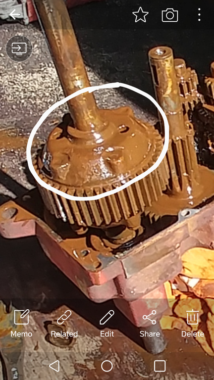

Steveasaurus,  I have a few questions, the case half I received is actually the case half that was budgeted up on mine.  I looked at it today quickly, and looks identical to mine, the case half from the 5053. So can I bolt to halves together one from a 5058, and one from a 5053, the case half that was on tractor when got.  The part in picture that circled, what is it's actually named, stamped E25, that's another piece I need
Thank you sir in advance. Darren

Darren, I was thinking the same thing.  The 2 halves will bolt together...same gasket #3912 from TORO.  I would certainly build it in the shallow side and see what it looks like.  We know the differential will fit.  The mushroom gear is a different part number between the #5053 and the #5058, but it seems to work with your differential.  The cluster gear shaft and all of the gears on that are common to both transmissions.  The spline shaft and fork gears are different part numbers for those 2 transmissions.  That may be where you run into trouble., but trying to put it together may help to determine which parts you actually have there and therefor which other parts you will have to find.  That end cap for the differential that is broke is for the left side...part #6446.  The right side is a different part number.
   I was also thinking that, if you wanted to use that horse while you search for parts, pick up the #5053 from @71_Bronco and use that.  It will bolt right in and your tires will fit the hubs with the 1" axles.  You can always sell the #5053 when you don't need it anymore.

Steveasaurus, thanks for info, so I'm thinking if two case halves I have are from a 5053, and we're pretty sure guts I have are from a 5058, then it should go back together with parts I have.  So I'm going to try to find part 6446, and get seals I think I'll need, and go from there. Thanks again for all info and help, as soon as get parts, I'll let you know, and then set a day aside to try to put together.
