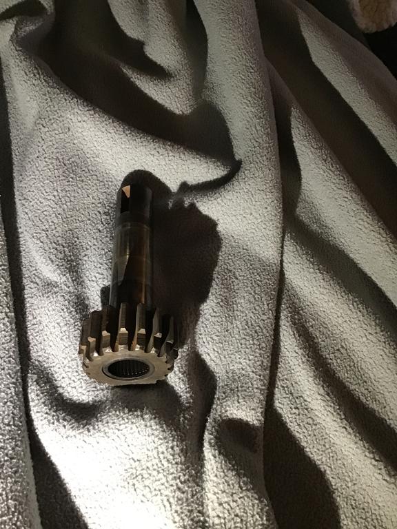

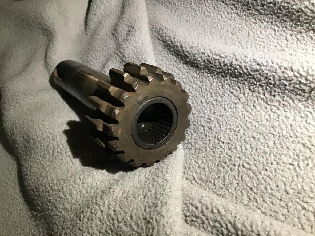

Bselectro12 0 #1 Posted April 4, 2020 (edited) I can’t seem to find out any information on how to replace this needle bearing. I’m pretty sure it’s the 1518 5/8 input shaft bearing. Any Info would be a huge help. Edited April 4, 2020 by Bselectro12 Share this post Link to post Share on other sites
953 nut 70,057 #2 Posted April 5, 2020 That bearing looks great, why do you want to replace it? It isn't subjected to any heavy loads and should last another half century, 1 Share this post Link to post Share on other sites
Bselectro12 0 #3 Posted April 5, 2020 Cool thanks for the reply. Yes the bearing is in great shape just wondering how I would replace it if I had to. Share this post Link to post Share on other sites
953 nut 70,057 #4 Posted April 5, 2020 IF it need to be replaced you would drive an awl in between the bearing and the shaft, pull the awl and use a small punch to collapse it a bit more then it will come out. 1 1 Share this post Link to post Share on other sites
Bselectro12 0 #5 Posted April 5, 2020 Thank you sir. Share this post Link to post Share on other sites

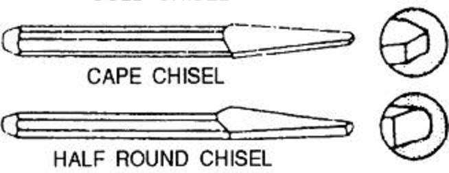

gwest_ca-(File Mod) 12,519 #11 Posted April 6, 2020 A half round cold chisel works well for collapsing needle bearings. The rounded side goes against the cast iron and little chance of causing damage. The one I have is about 3/16" wide. Also works well for removing an inner exhaust pipe from the outer if you are trying to save the outer. Cut the inner off and use the chisel between the two to collapse the inner. For blind ball bearings use a piece of hardwood dowel that just slips inside the bearing. Fill the cavity with grease, start the dowel in the hole and drive it with a hammer. It exerts tremendous hydraulic pressure behind the bearing forcing it out. It may not go all the way but enough you can slip an appropriate puller on the inside to pull it the rest of the way. Garry 1 Share this post Link to post Share on other sites
